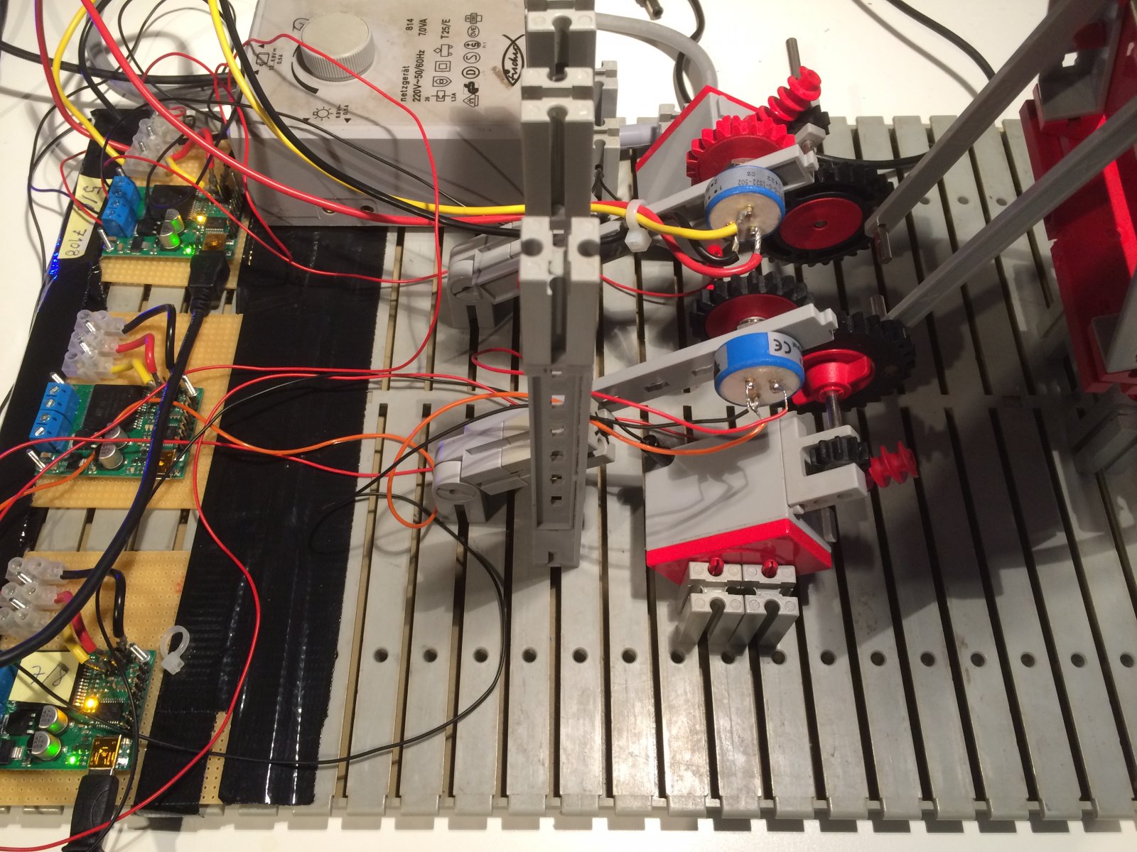

    Dear all,
    after introducing myself yesterday, let's get started with my brand new building thread.
    As you can see in the title, I am going to build a 2 DOF seat mover based on jrk 12v12 controllers.
    What I already did:
    1. I quickly built a 2 DOF seat mover model with Fischertechnik, soldered the JRKs and connected them with motors and potentiometers. (The reason for building the model instead of starting with the big thing right away is that I want to see the complete setup working before spending weeks of construction.)
    2. I configured the JRKs with the JRK Configuration Utility.
    3. I did the interface settings and axis assignments in the SimTools software.
    Now I am able to control the motors with the SimTools Game Engine (Output Testing).
    All together I have spent about 4 evenings up to now. So far so good.
    The next step will be going into the first game and see my model mover move in sync with some virtual vehicle. My first choice is the No Limits 2 rollercoaster. I already patched the game, but got stuck with the error message "Motion not supported, &H1B048D45".
    In another thread I read that I may have a non-supported version of the game (it is the Steam-based version). Maybe I find some other hints.
    After I have managed to get NLR2 running, I will connect a third JRK for producing an airstream.
    And then I will finally start building the real thing! I have already bought most of the equipment, like wiper motors, a cardan joint, a power supply etc.
    That's all for now.
    No, wait. I forgot the most important thing which is to express my excitement about the phantastic SimTools software and this incredibly supportive community which enables non-pros like me to get a (model) system running in a couple of hours. You are doing a phantastic job, folks!
    I will keep you updated about my progress and I am sure that I will also ask you for some support soon.

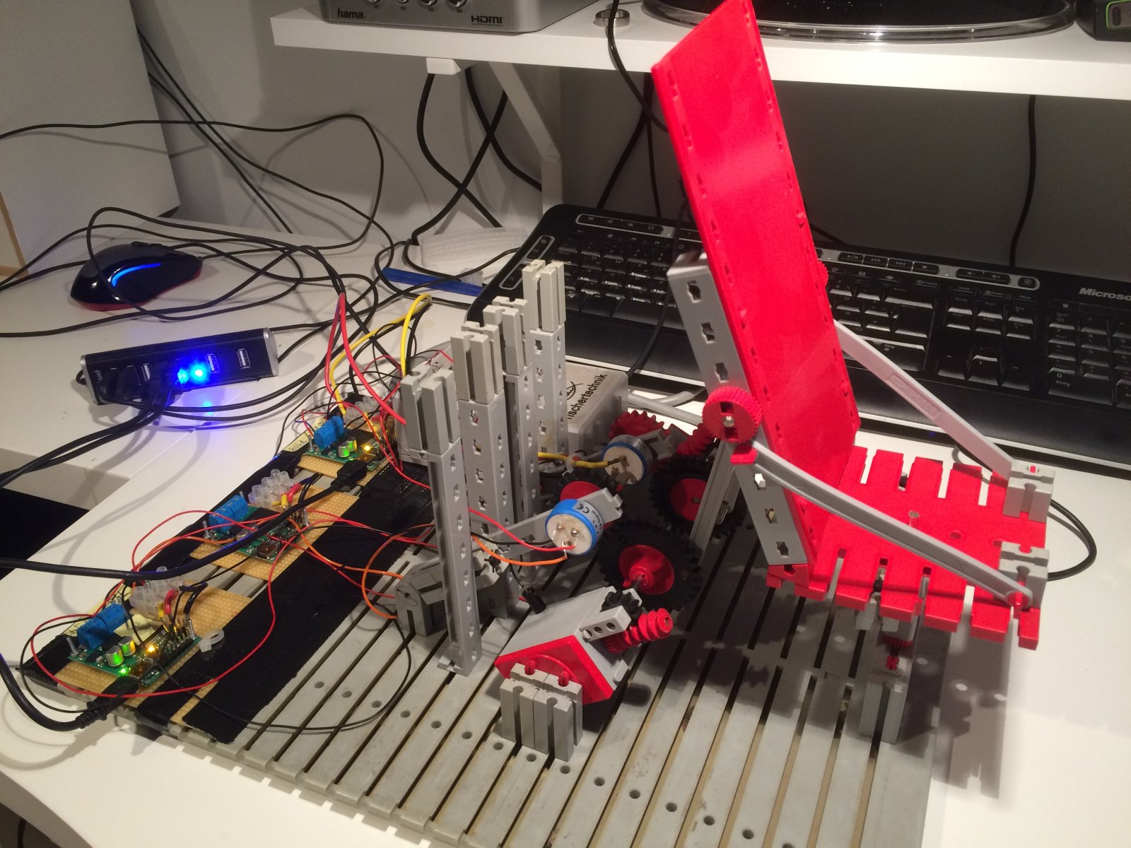

  3. MarkusB
    Jun 30, 2015
    552
    4,214Coins
    +597 / 2 / -0
    Hi David,
    here are two images of the model.
    About isolating earth from the wiper motors: Thanks for the hint. I read about it and already had mine open for checking all the earth contacts, but did not cut them yet.
    Actually this should only be needed if the two wiper motors are connected via a metal parts, right? I will probably build a wooden platform and make sure that the motors do not have any electrical contact with each other.
    And thanks about the NLR2 hint. For today I gave up, since I have to get up early tomorrow. I updated the plugin and at least got rid of the error message. However, no motion yet. Maybe I am overlooking something obvious. Guess I will check the threads as you suggested.

    Hi again!
    In the meantime I successfully finished the feasibility study with my Fischertechnik seat mover model. I spent some time with configuring the axis/forces mapping, so that you can now recognize that the seat movements are fairly aligned to the coaster ride. I ended up with a combination of 50% sway and 70% surge which is still far from being perfect, but my stuffed panda test pilot was satisfied, and so was I. I also made a little video before noticing that it is far to big for uploading it here (even after downsampling), and actually it is not worth creating a youtube channel just for this movie.
    Now I will turn my attention to my actual seat mover project. Since I will be very busy with other activities for the next weeks, it may take some time before I get started.
    Besides I am rethinking some aspects, like whether I really want to use wiper motors or rather look for something stronger from the beginning on. We will see.
