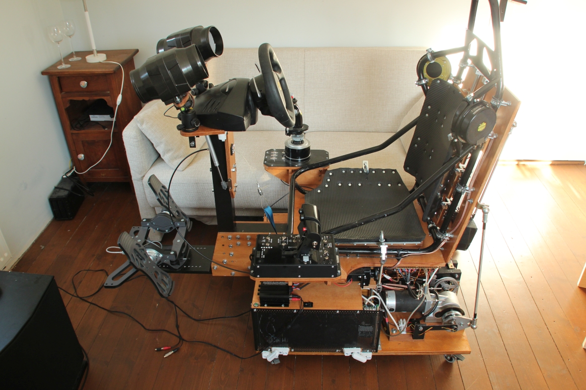

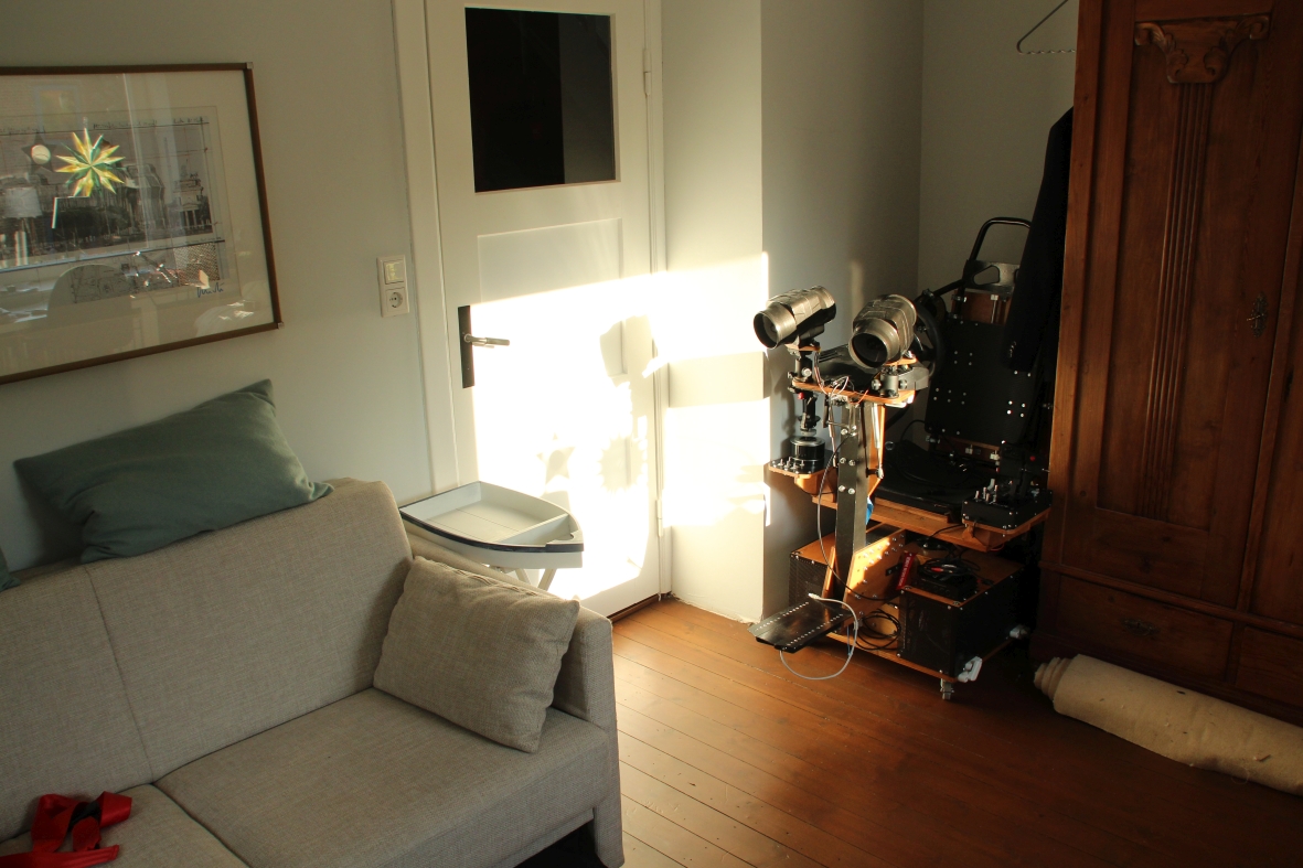

    Hi folks,
    after finishing my first rig (see my first build thread), I took it apart again and started from scratch. Too many things had to change, so that it was not possible to go on with what I had.
    My second build is again a 2DOF full frame simulator with integrated G-Seat, but with quite some improvements compared to the first one. The most important aspect is that the 2DOF and the G-Seat motors are much stronger than before.

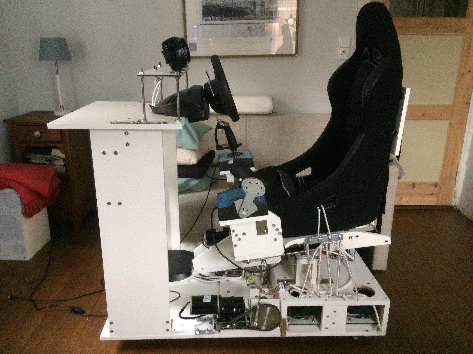

    This was my old rig:
    And that’s the new one:

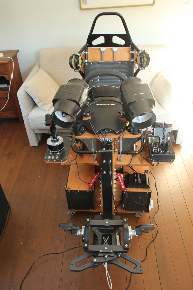

    Only the seat is still the same as on my first rig. Well, at least its steel frame, because I ripped off all the fabric.

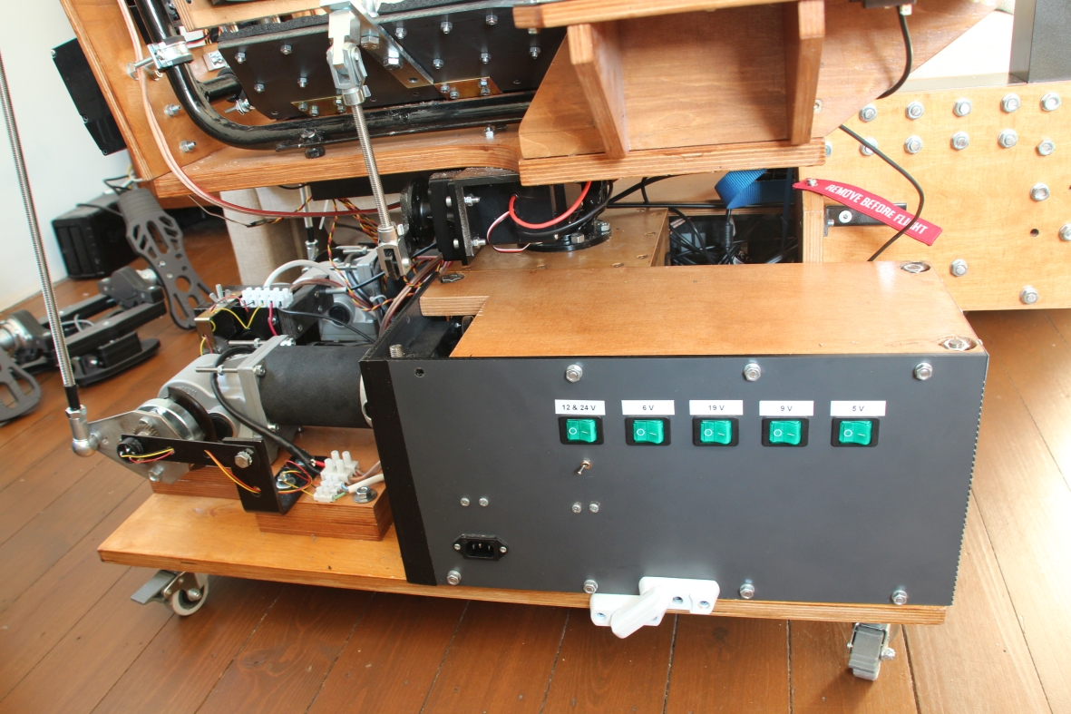

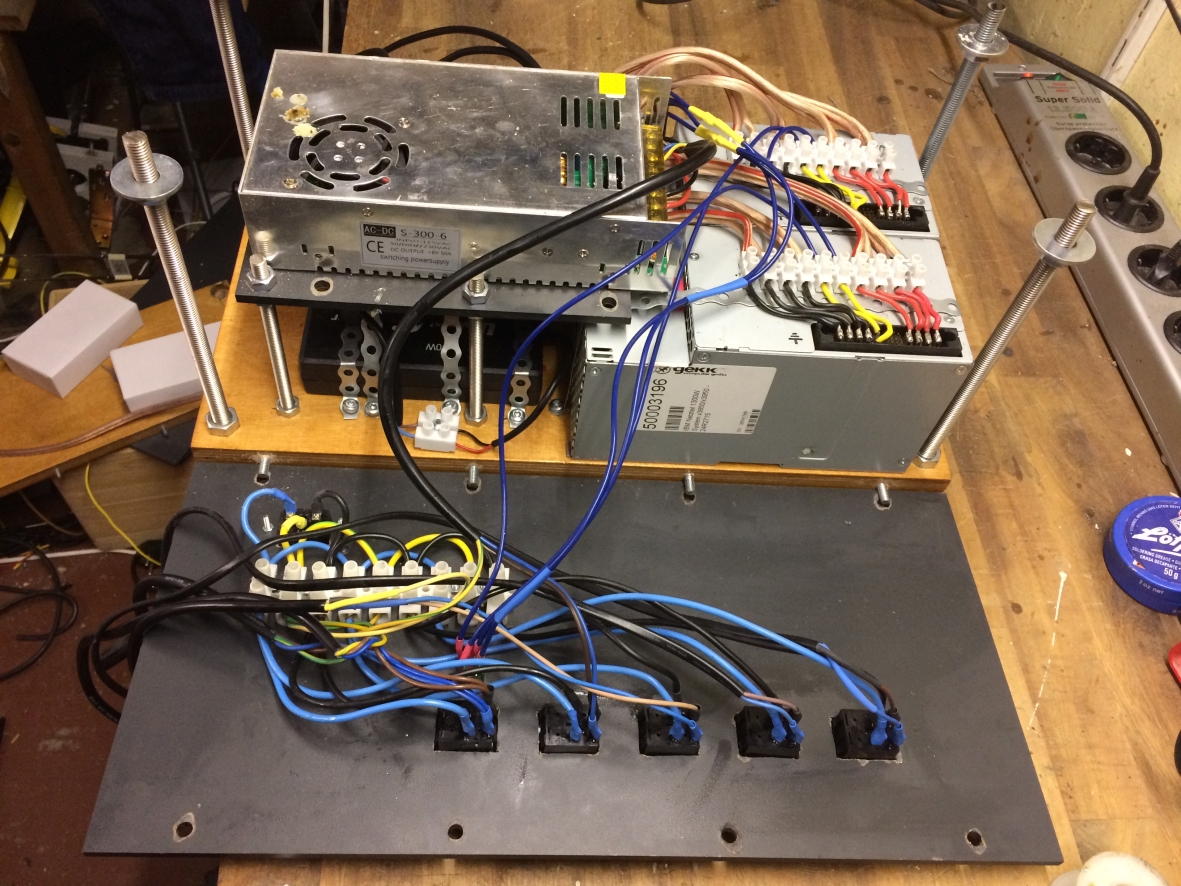

    You see two kind of boxes, one on the left and one on the right side of the rig.
    The right box contains all the power supplies, which can be separately switched on and off:
    • 24 V: needed for the wheel chair motors and the Super500 servos
    • 19 V: needed for the force feedback wheel
    • 12 V: needed for the Seaflo blowers, the cooling fans, and the bowden cable motor
    • 9 V: needed for the Arduinos
    • 6 V: needed for the 33kgcm servos
    • 5 V: needed for the signal lines of the Super500 servos

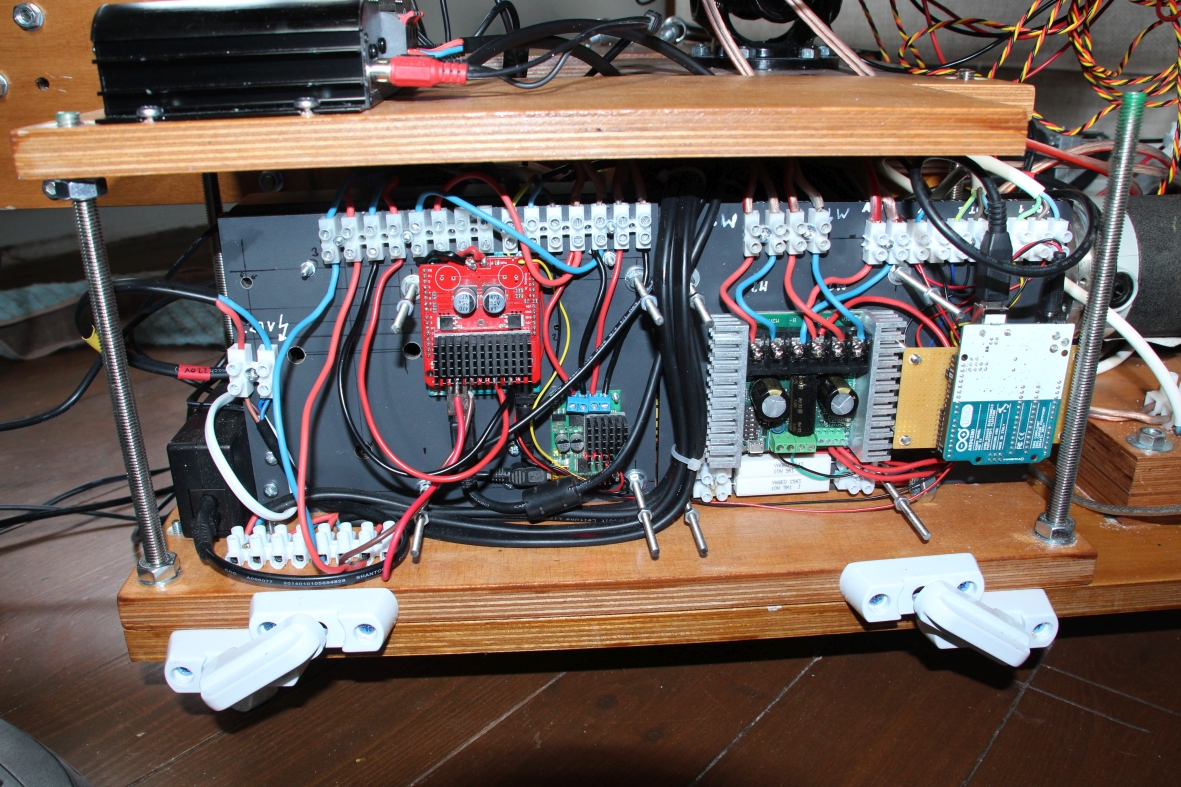

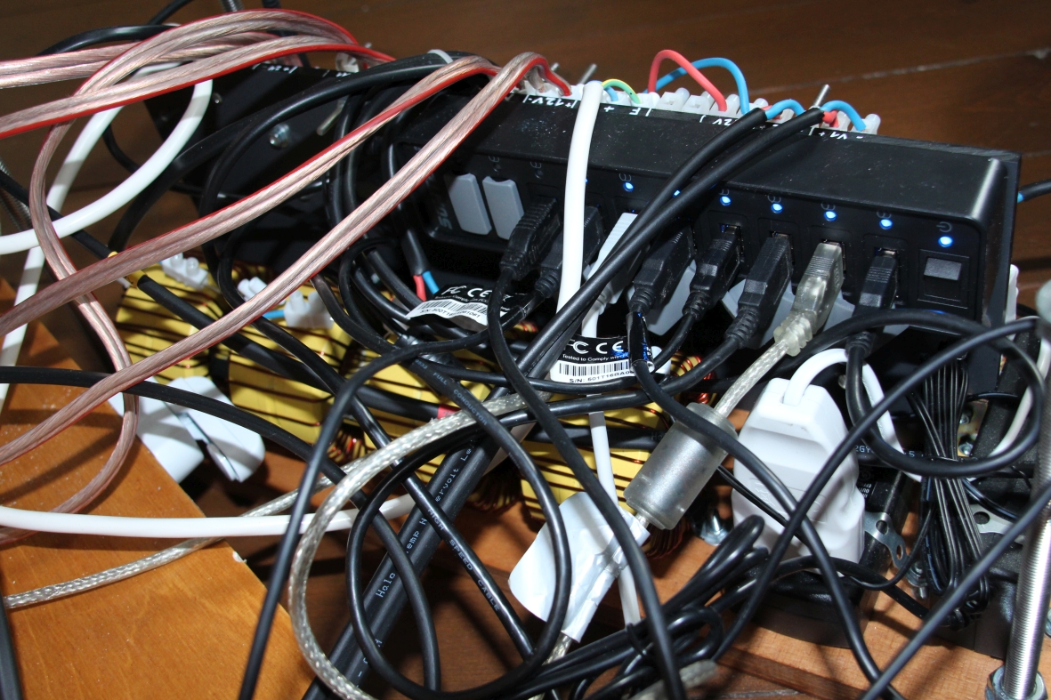

    And the left box contains the main parts of the electonics: The sabertooth 2x32 for the wheel chair motors, a JRK12v12 (had this one from my first rig) for the bowden cable motor, 2 Arduinos, and a 10 port USB3 hub:
    ElectronicsBoxMounted_s.jpg ElectronicsBox_Front_s.jpg ElectronicsBox_withFans_s.jpg ElectronicsBox_Back_s.jpg

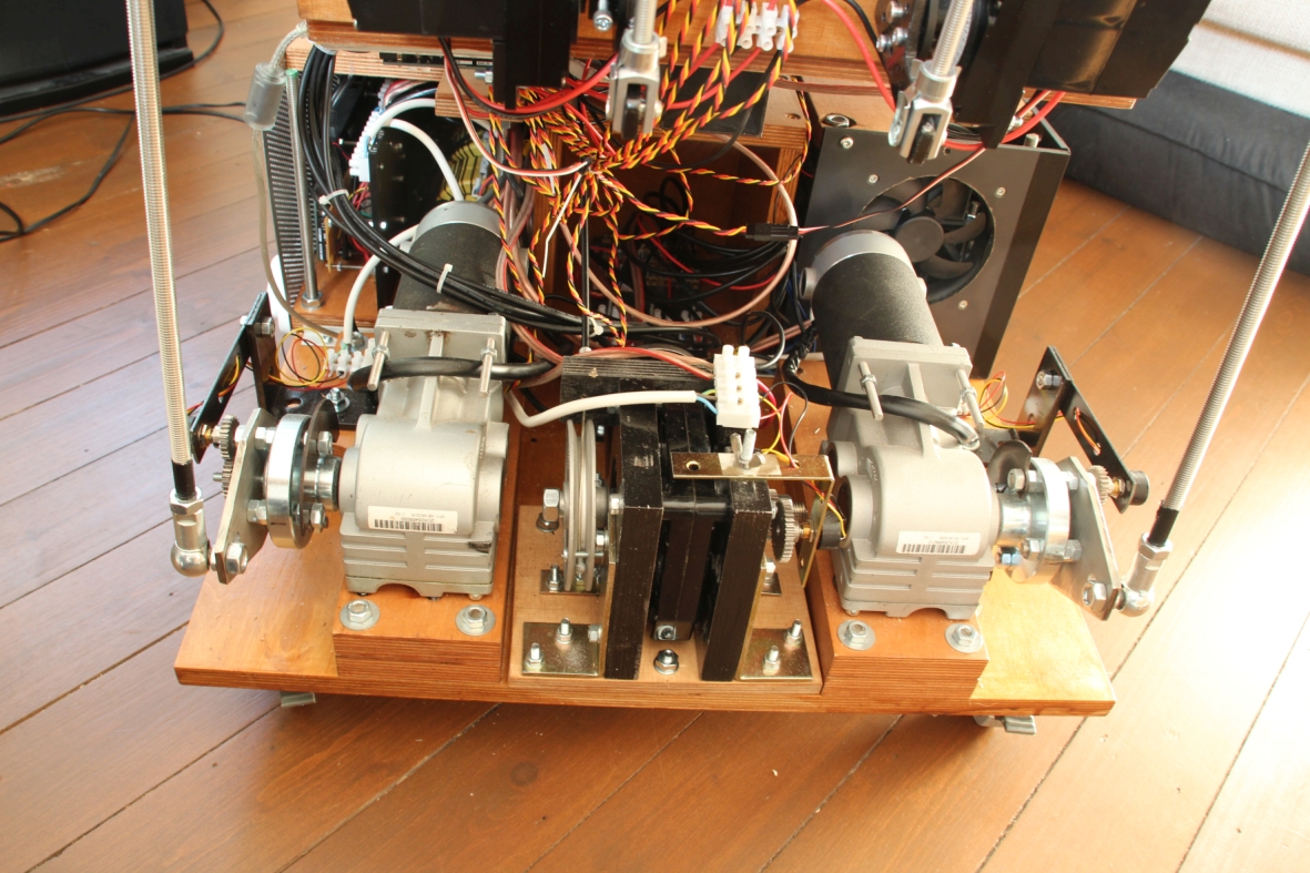

    Here are the 2DOF motors. I am using second hand wheel chair motors, which really have plenty of power.
    They are controlled via an Arduino and a Sabertooth 2x32.

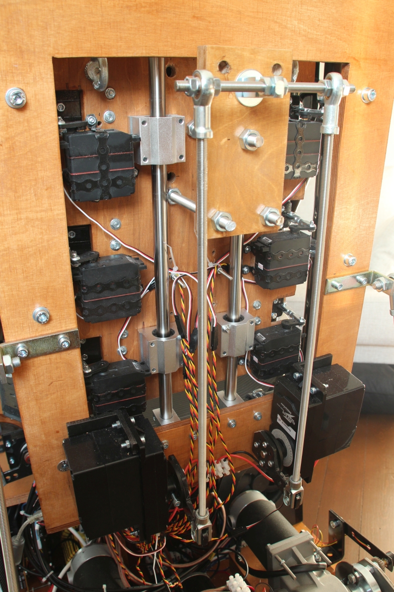

    Each surge flap is powered by three 33kgcm servos, ...
    ... and each heave flap has one Super500 servo connected:

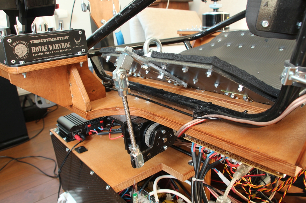

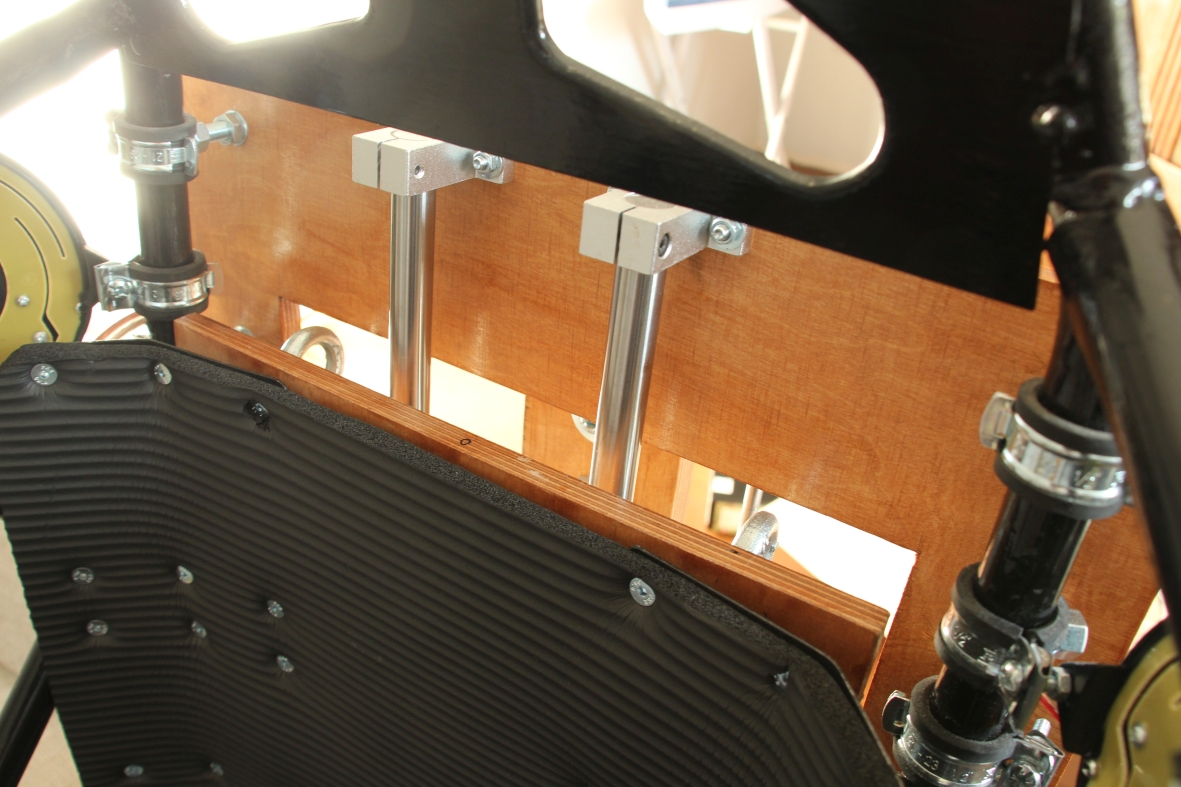

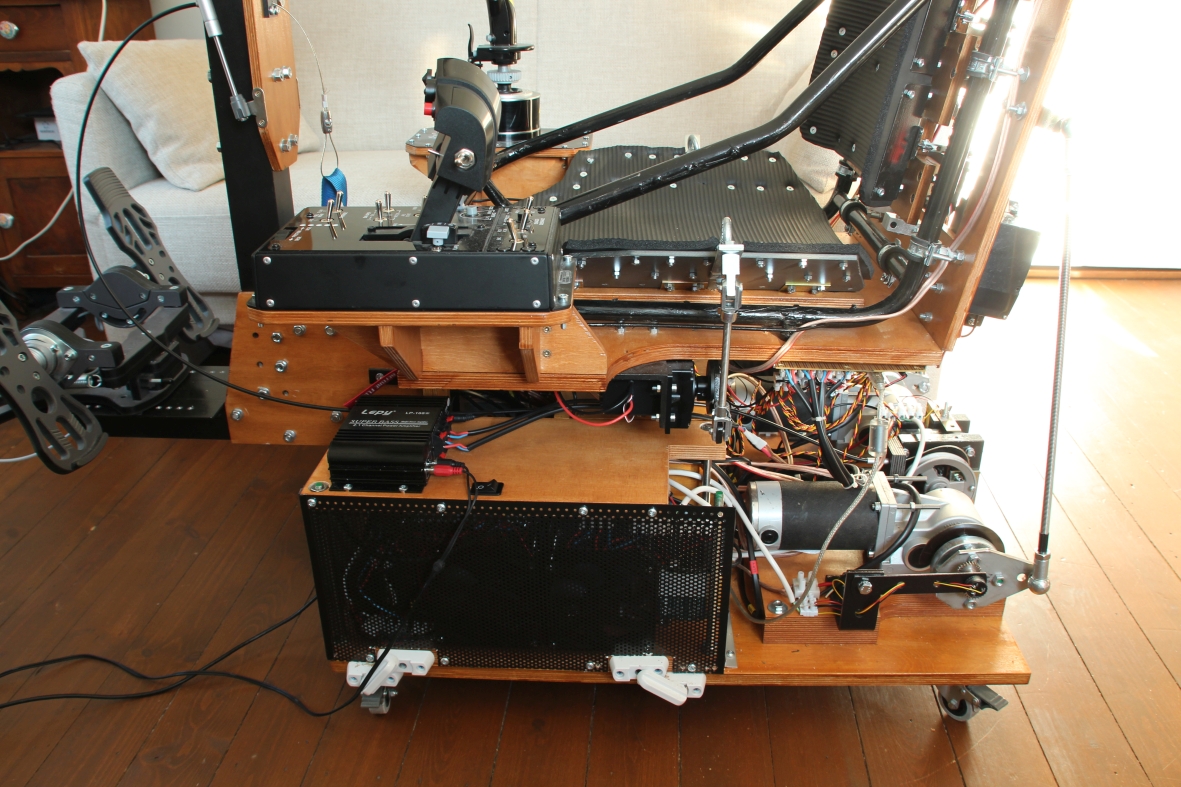

    One special thing about my G-Seat is that the backrest including the surge servos moves up and down. This shall increase the impression that you are pressed into the seat (when the backrest moves up) or lifted out of the seat (when the backrest moves down). I got this idea during a real flight, when I observed in which way I sensed the different forces. Here are some pictores of the lift mechanism, which is powered by two Super500 servos.

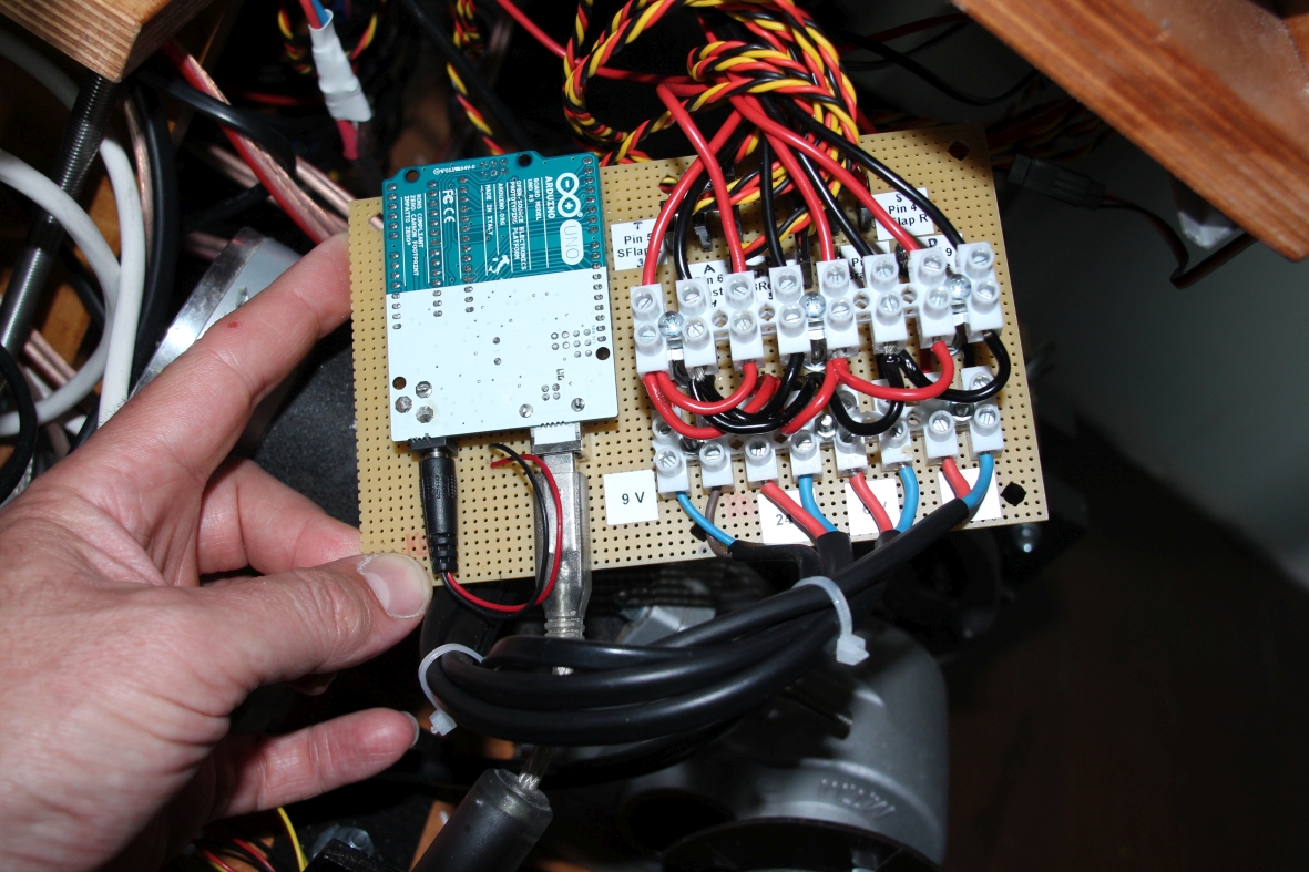

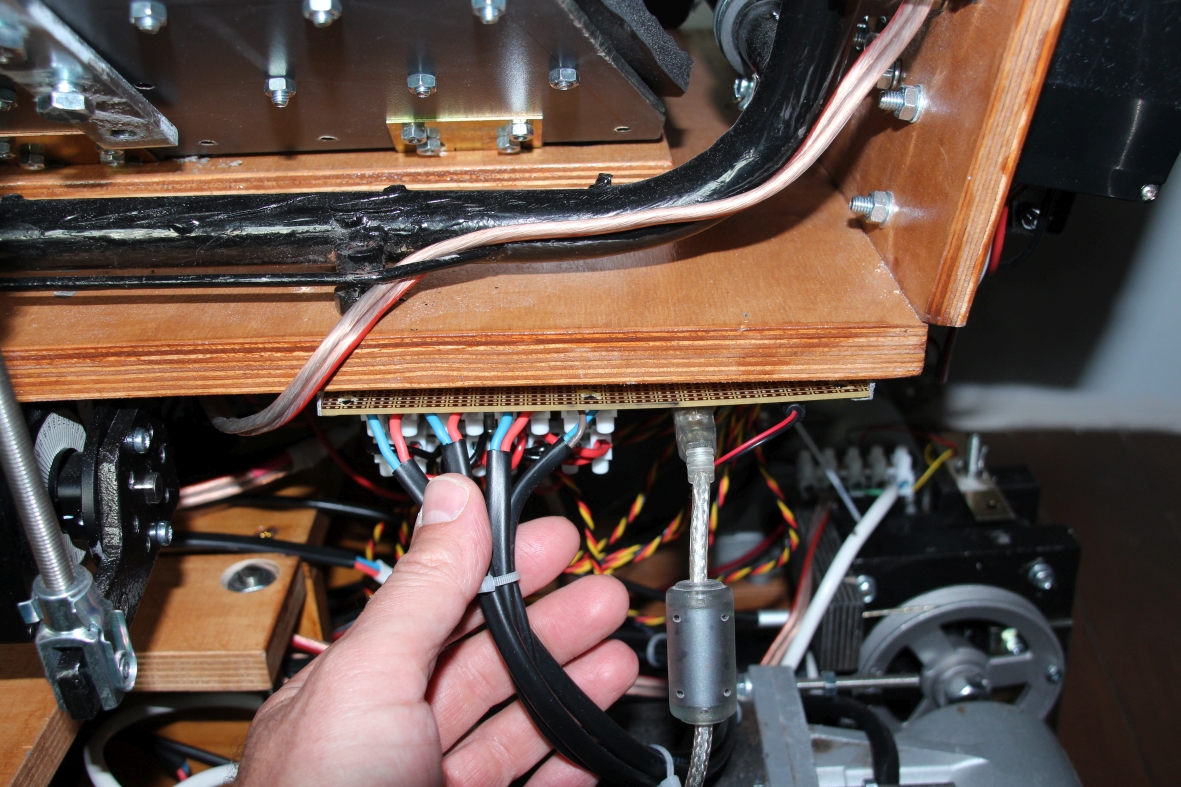

    All 10 servos are controlled by a single Arduino board:
    The Super500 servos need 24 V for the motor and 5 V for the signal, the 33kgcm servos run with 6 V, and the Arduino gets 9 V. So this circuit board is connected to 4 different power sources.

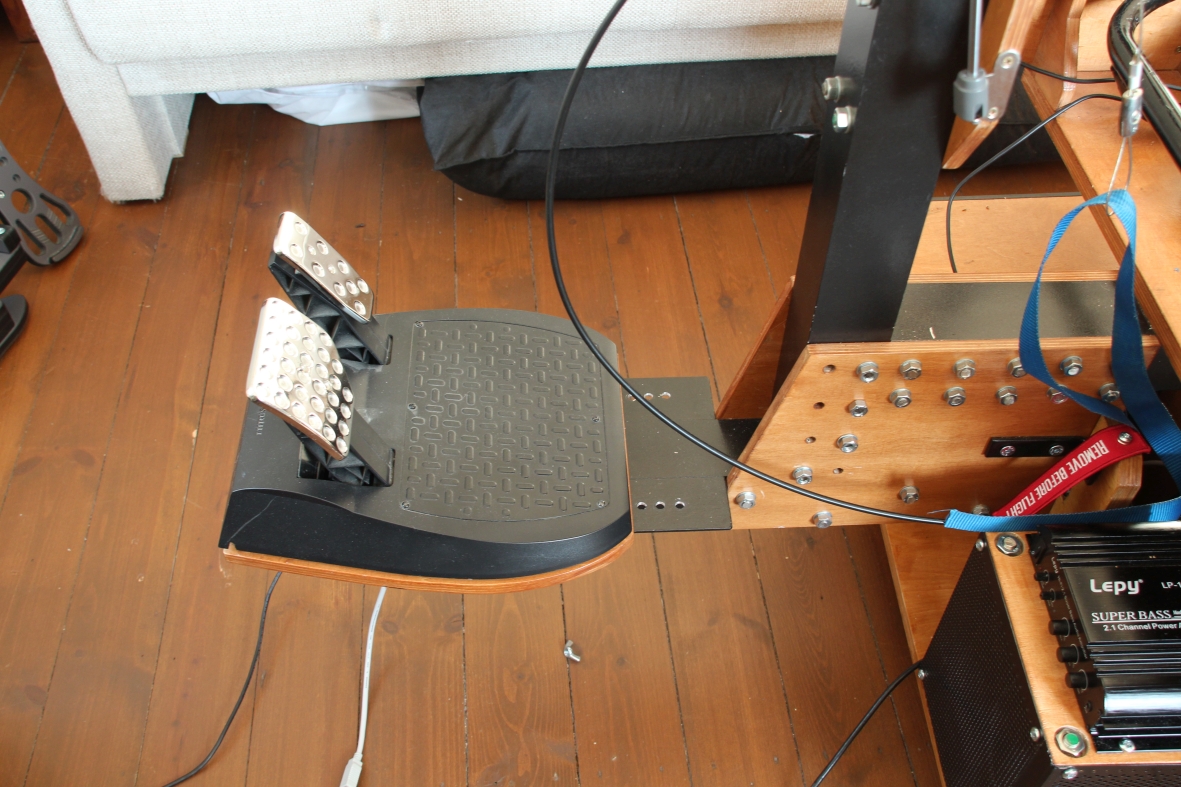

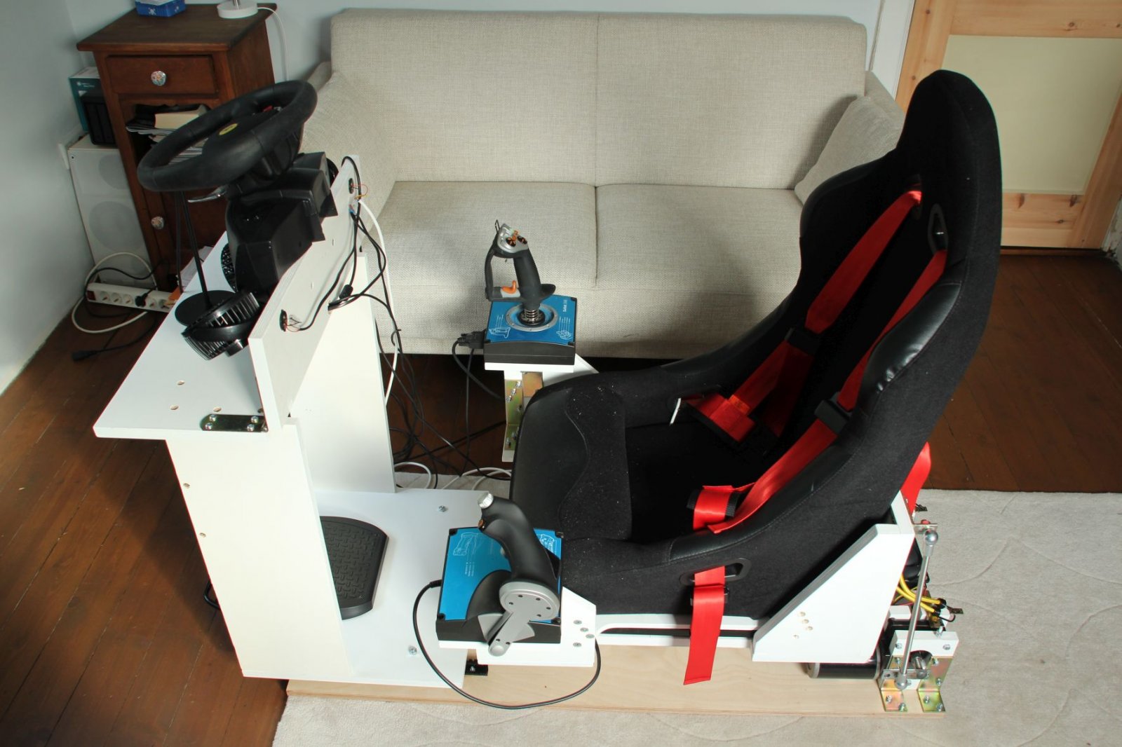

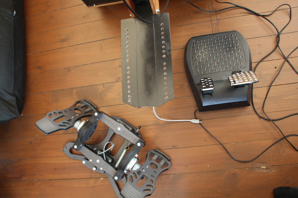

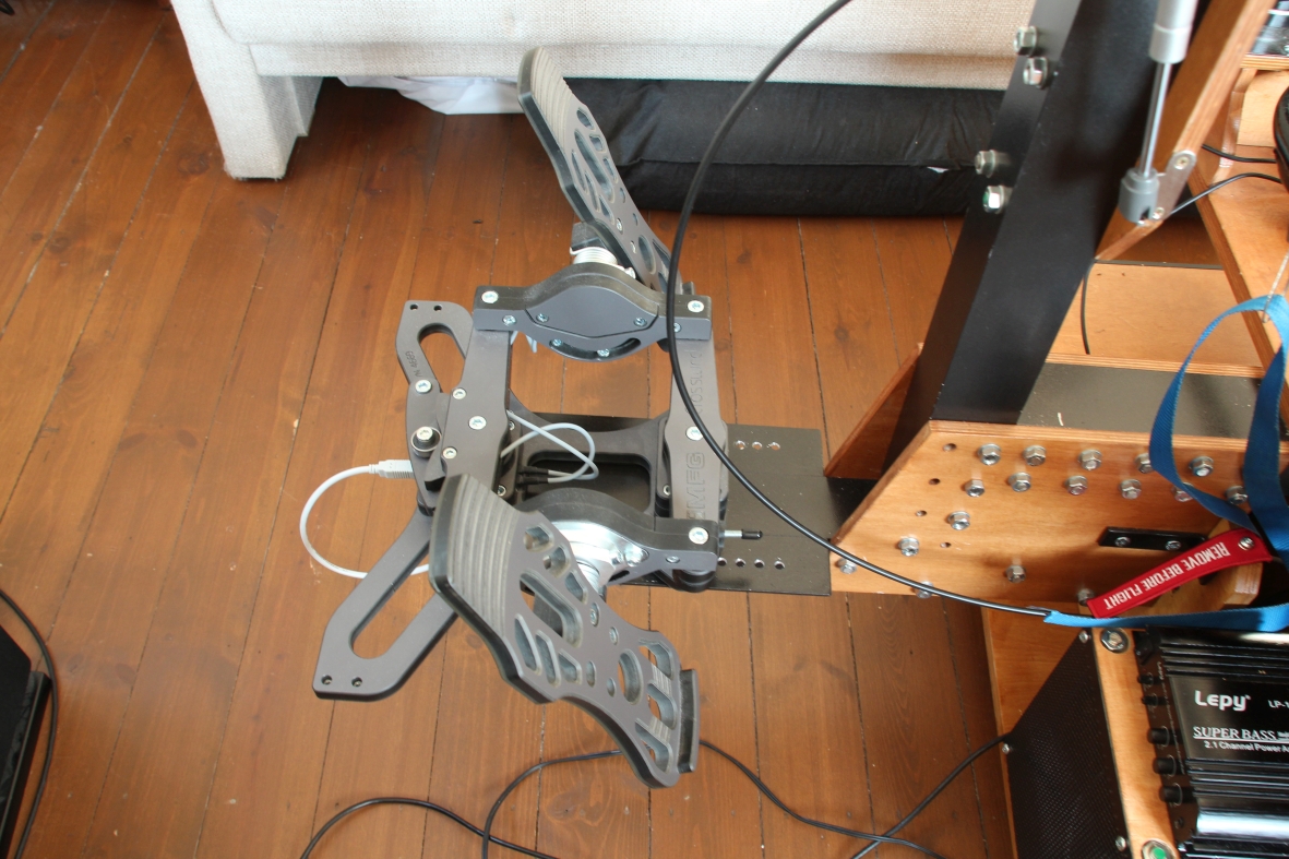

    Although my focus is on flight simulations, I also want to try some racing. For this purpose, I can easily exchange my flight pedals with racing pedals. (In contrast to the flight controlers, my racing equipment is rather low-end. I got it marked as 'defect' from ebay, though it still works.)
    01 Pedal Mount_small.jpg 02 Flight Pedals_small.jpg 03 Racing Pedals_small.jpg

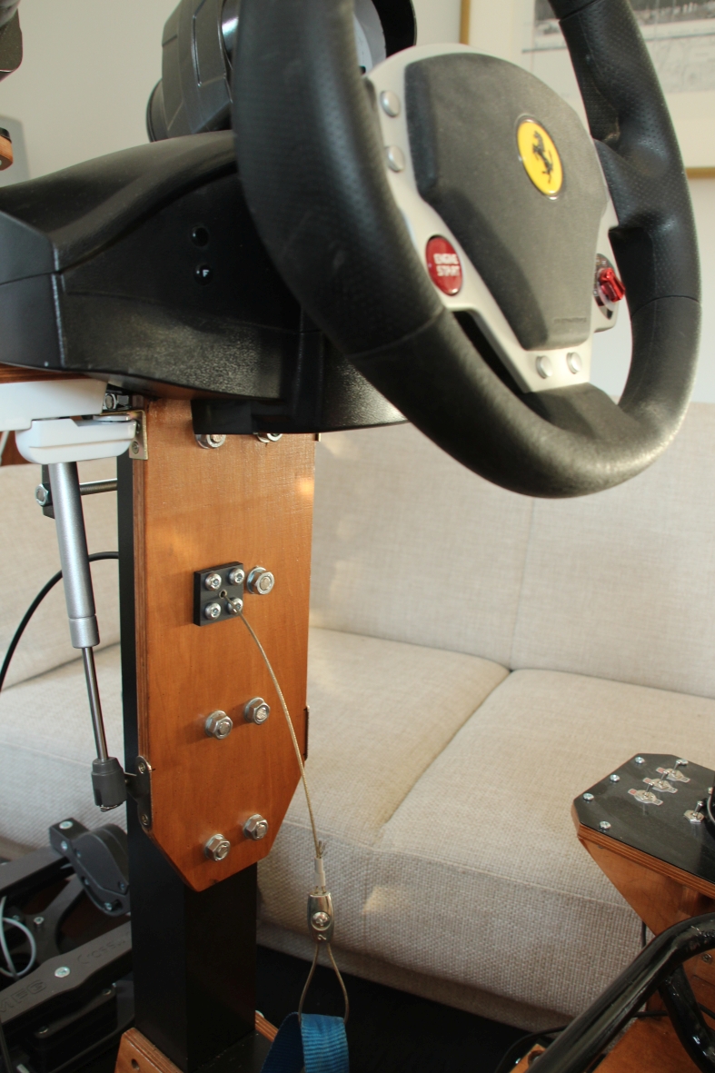

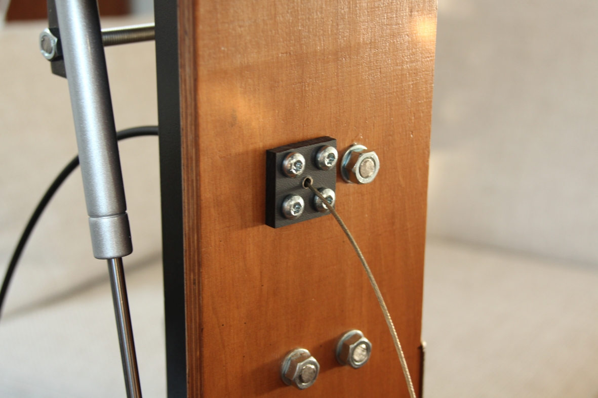

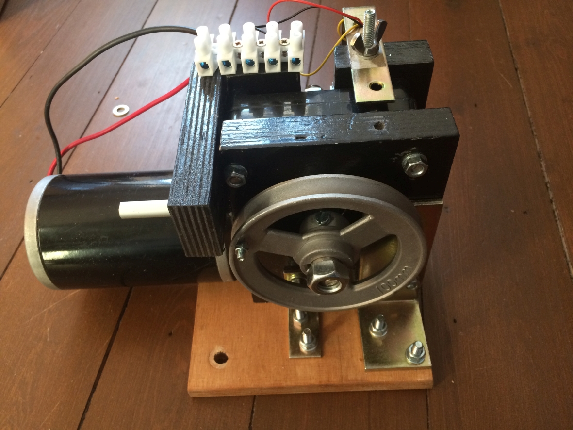

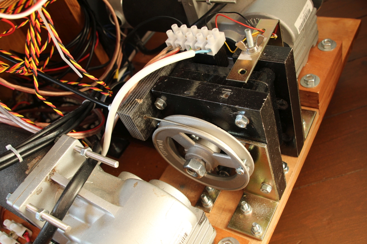

    Oh, and then - inspired by @SeatTime - I added a bowden cable for simulating negative surge forces (i. e. braking). For this purpose, I re-used one worm gear motor from my first rig, added a wheel, and connected a bowden cable that goes to the front of the rig.
    BowdenCableMotor_1s.jpg BowdenCableMotor_2s.jpg BowdenCableOutput_1s.jpg BowdenCableOutput_2s.jpg

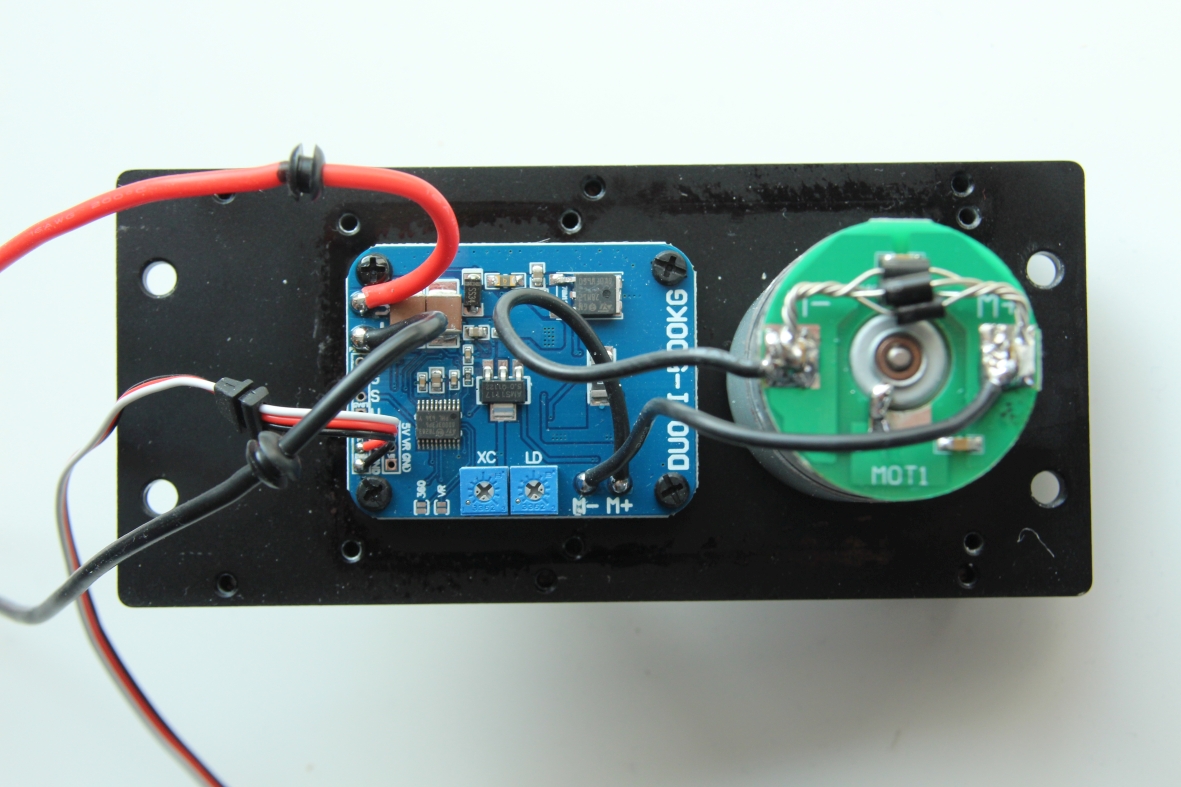

    My current problem with this component is that I don't have a suitable harness. I tested a shoulder belt that is meant for carrying a saxophone, but this did not work. I feel the belt tighten around my shoulders instead of my body being pulled forward.
    If I don't find something suitable, I will use the bowden cable for a usual seat belt tensioner. For this purpose, I just need to lead it to the top of the backrest instead of to the front of the rig and connect it to my seat belt. (So luckily I am not finished yet. :))

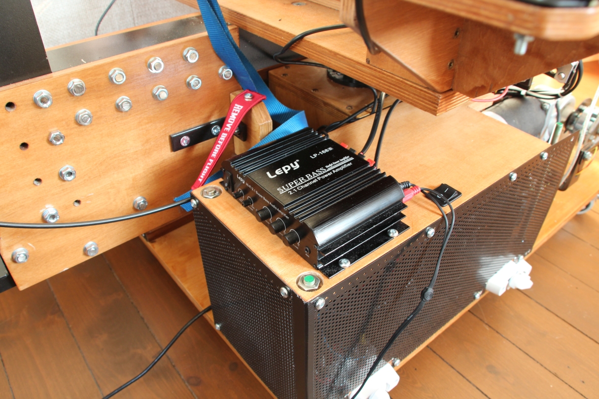

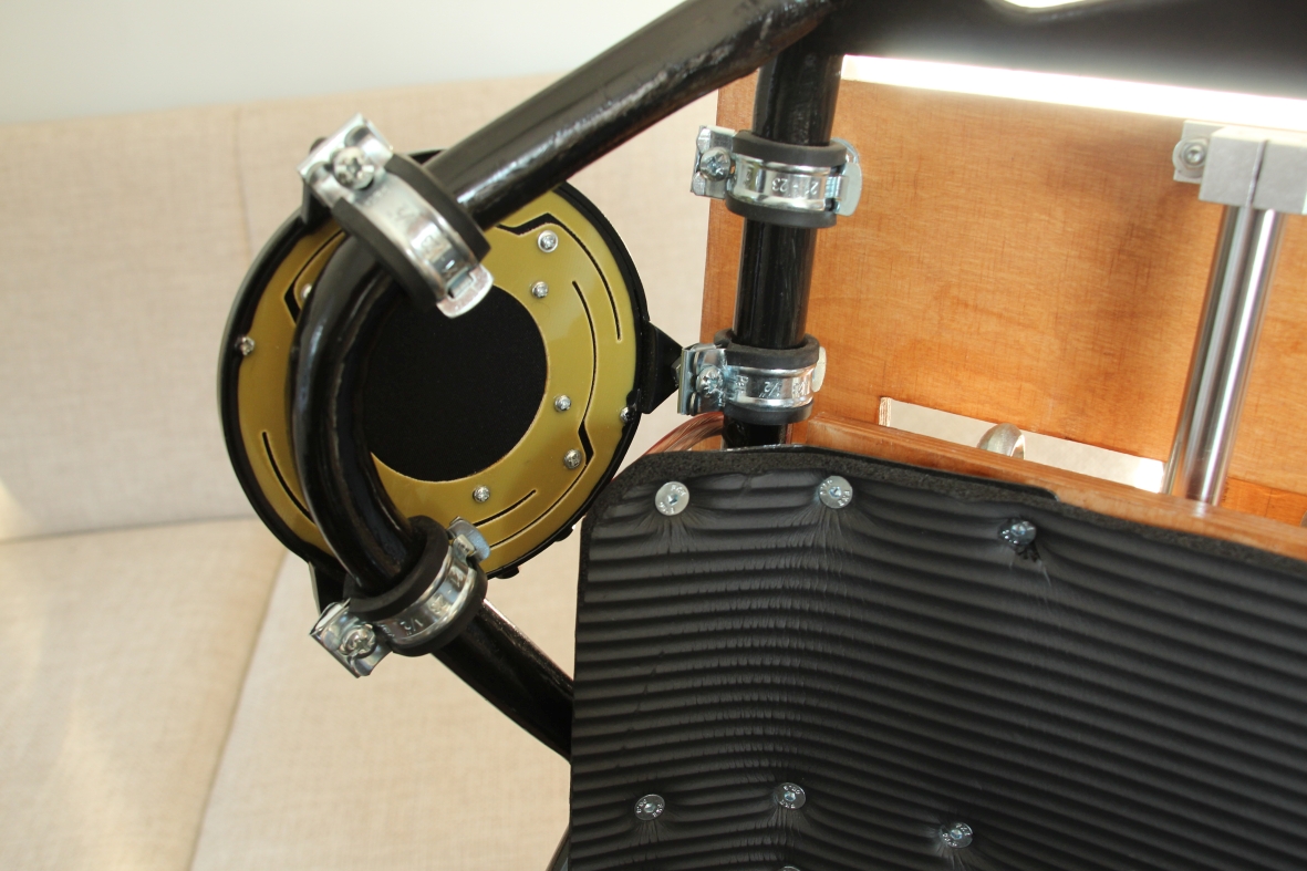

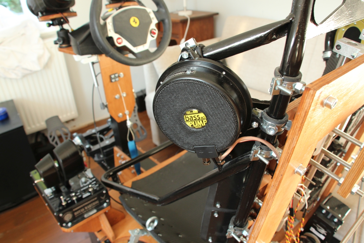

    With my previous rig I used rumble motors for simulating engine vibrations. Now that @yobuddy has relased the ingenious Game Vibe software, I changed to this one. For now I just have a very basic setup with one amplifyer and two bass shakers that are mounted to the backrest:

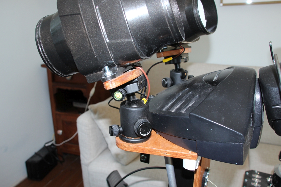

    And finally, I added two Seaflo blowers for getting an airstream, based on @SilentChill's phantastic thread:

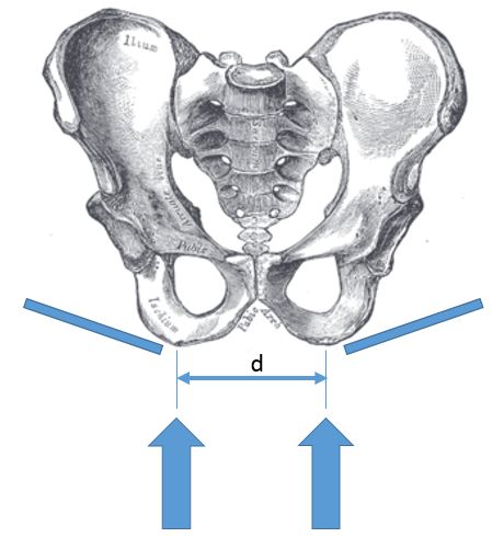

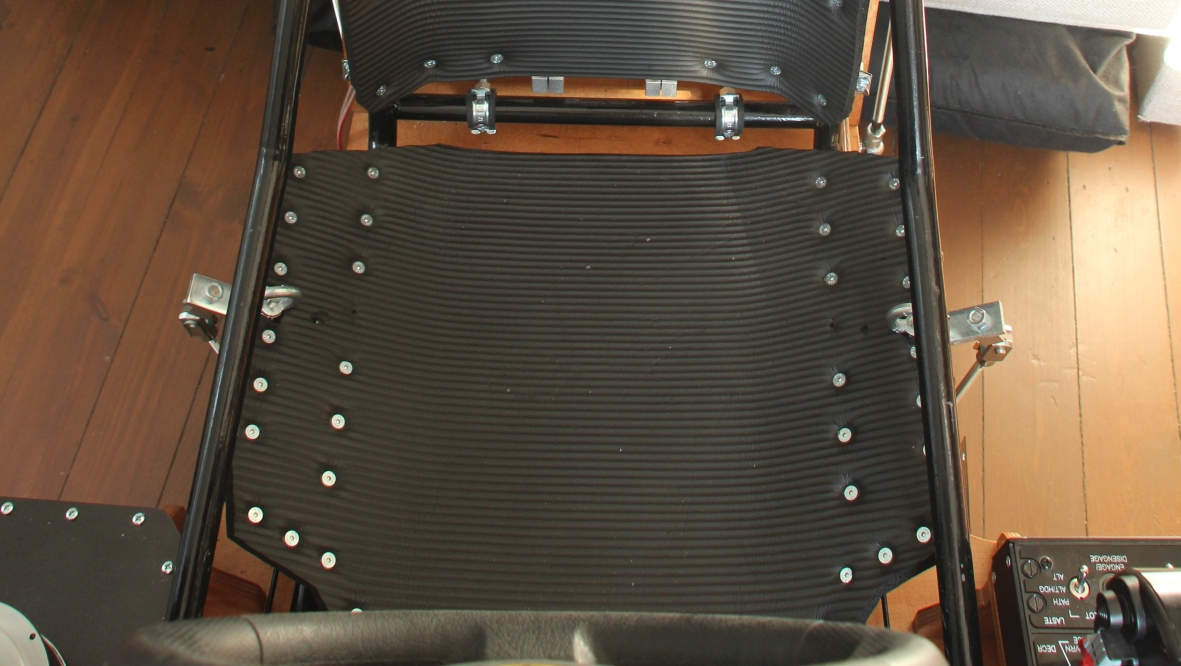

    Heave Flaps

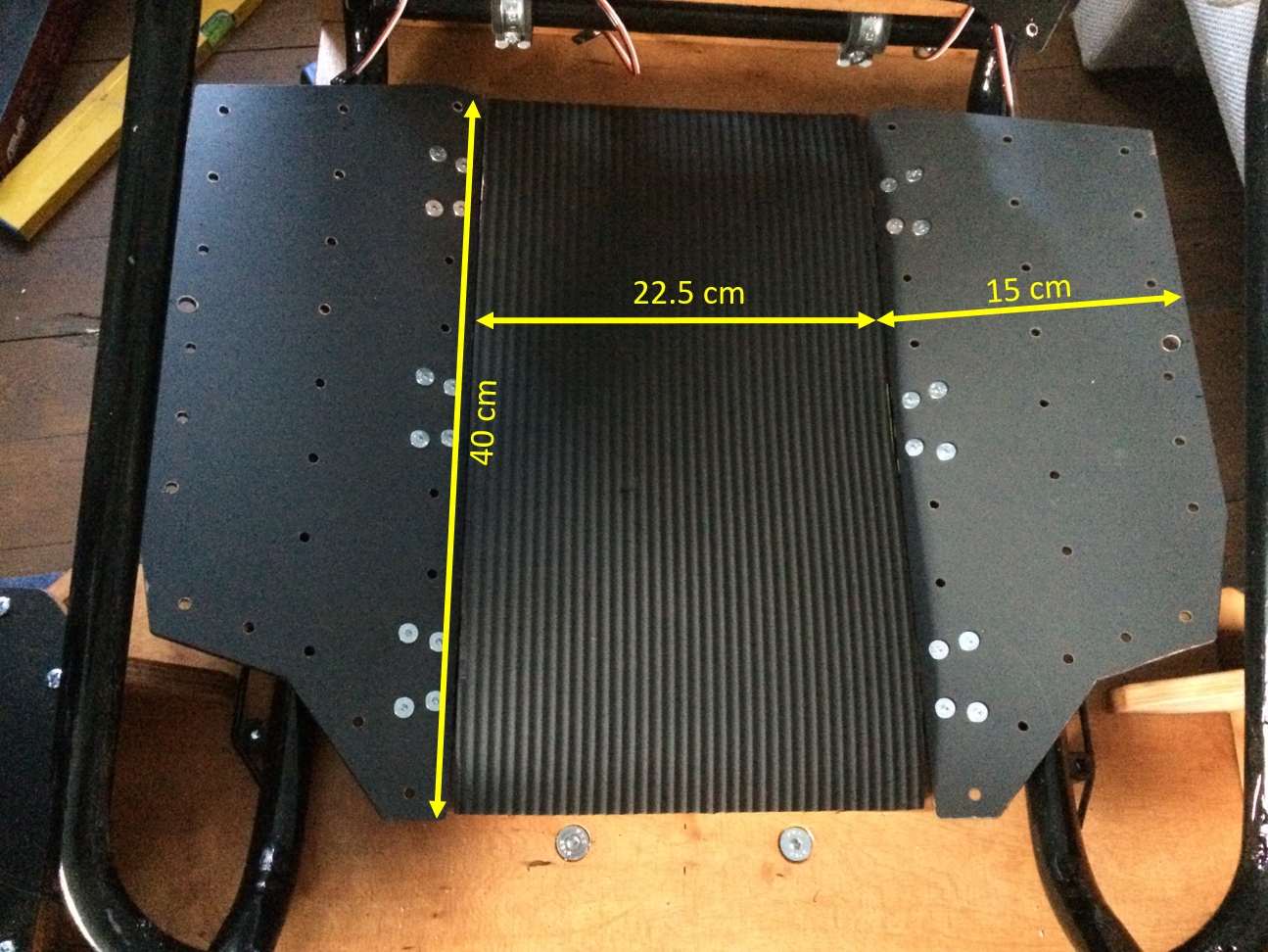

    From time to time I will add some more details about my rig. Today it's about the 'heave' flaps of my G-Seat.
    In order to make it easy for the servo motors, I mounted the hinges of the flaps 22.5 cm away from each other, as shown in the picture below.
    The distance of 22.5 cm is a bit more than the distance 'd' in the picture below, which I measured on my own body.
    In this way, the flaps don't need to lift me, but instead only squeeze my body. For me the effect on flight simulators as well as No Limits 2 is quite convincing, so that I will keep it this way.
    The flaps have a width of 15 cm. This is the maximum width that makes them still fit into the seat frame, but it is also large enough, because less than these 15 cm get in contact with my body.
    The next image shows the flaps with their coating, which I cut from a camping mat.

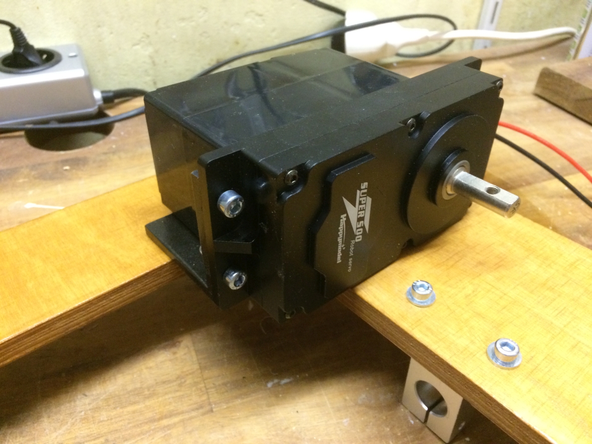

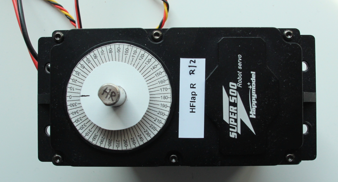

    The "Super500" Servos
    I am using high torque servos called "Super500" for the 'heave' flaps as well as for the movable backrest of my G-Seat.
    You can get them via ebay or amazon, where amazon (at least in Germany) has the advantage that toll is already included.
    Since these servos are kind of special, here is some information about them.

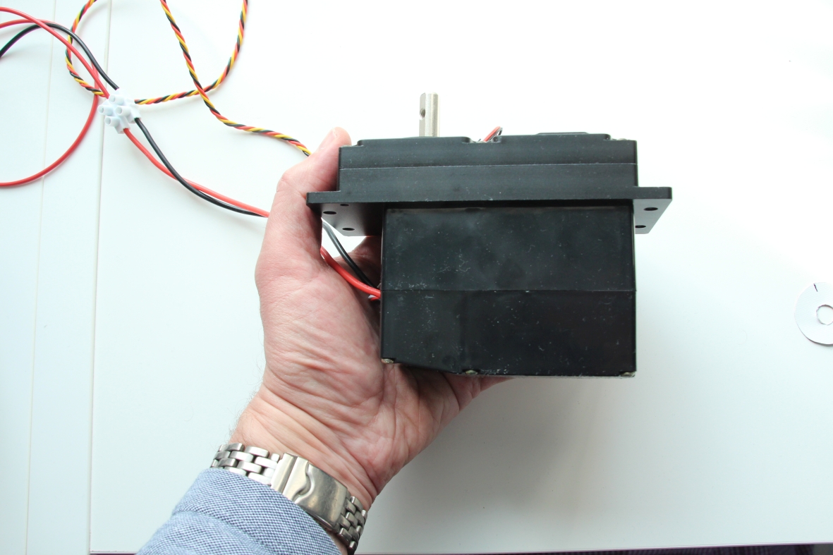

    First thing: They are really big:

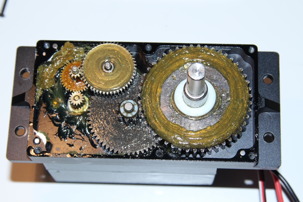

    Second: They are the strongest servos with usual RC connectors that I found: The manufacturer claims they provide a torque of 500 kgcm. I did not check this though.
    Third: They are quite slow, which means they need about 0.5 sec per 60 degrees. But as I mentioned in my first post, this is ok for me because I am focusing on flight simulations, and the pressure effect during take-off is really good.
    Now about the setup. At first I tested them with the Arduino sketch provided by @Spit40 and found out the following:
    • They only move in a value range between 50 and 150. Thus you need to adjust the value mapping accordingly in the Arduino code.
    • Initially, the rotation angle was really large (something between 270 and 360 degrees if I remember correctly), which is too much. For adjusting it, you need to open the servo cover (see below).
    • Main drawback: The target angle differs depending on the move direction. So when the servo is at position 50 and you set the angle up to 100, the final position is different from when you move the servo from position 150 down to 100. The difference can be 5-10 degrees, which in my opinion is really essential. I don't know how these servos can be used for robotics, since a robot arm will probably miss its target. However, for my rig also this drawback is not critical.
    • Another drawback: The axis has one side flattened, and the position of this flattened side differs between the servos. So you only have one way to mount the servo wheel to which you connect the lever, resulting in different lever positions. I solved this by drilling multiple holes at different position on each lever.
      Note: I also tried to open the gear part and manually turn the axis, but this did not help. After closing the gear box and powering the servo, the axis moves into is original position. The reason for this is that the position detection is done via a little magnet that is glued to the inner end of the axis.
    The gear box:

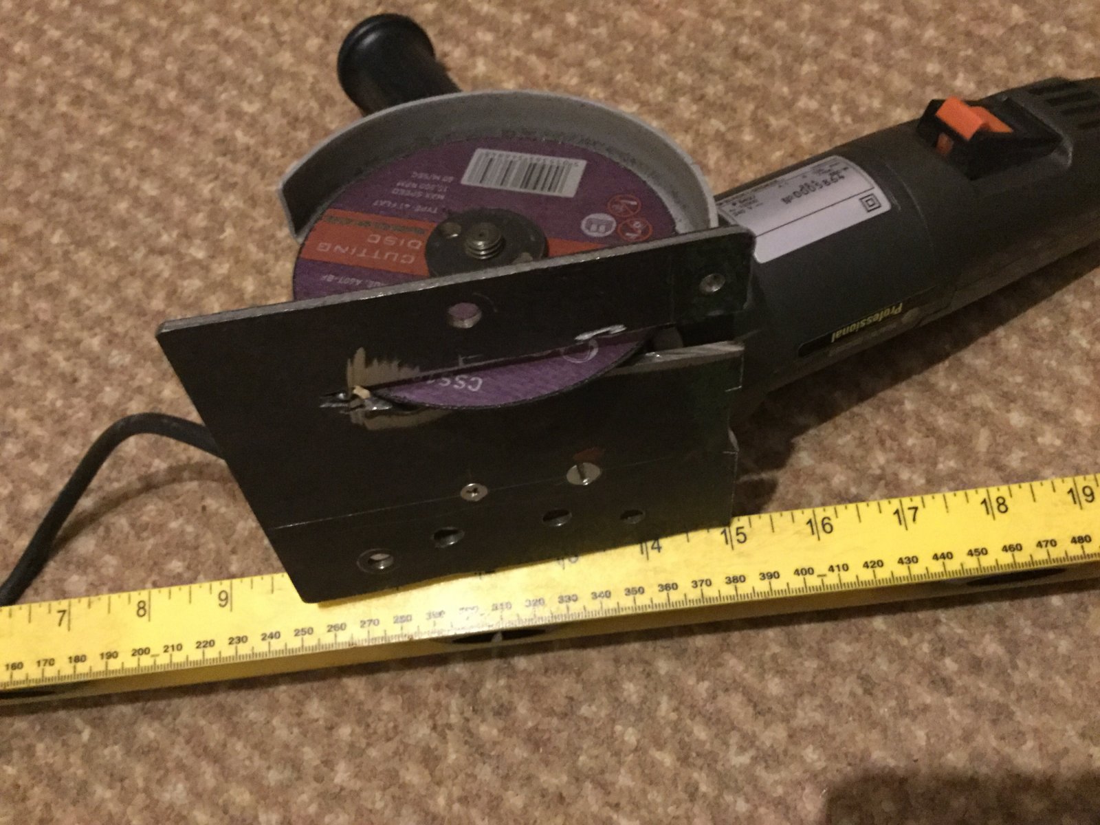

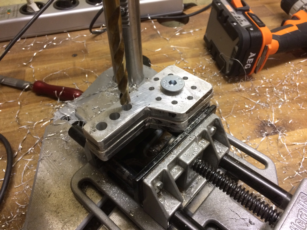

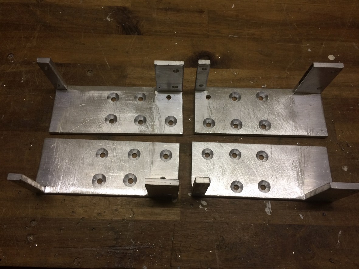

    Here is a picture of the levers I cut from 5mm aluminum:
    Adjusting the rotation angle

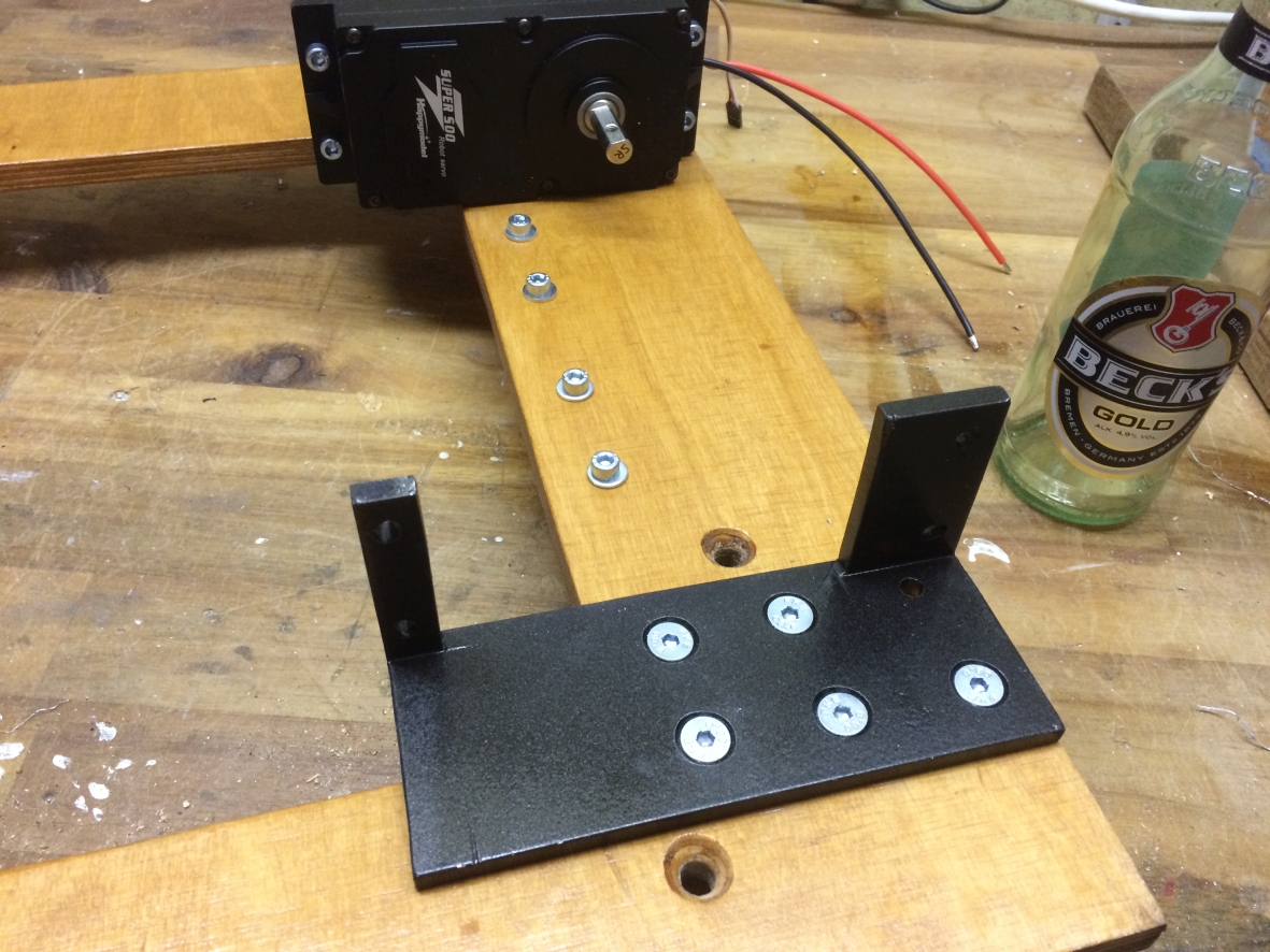

    For adjusting the rotation angle, you need to open the servo (6 screws need to be removed) in order to get to the board. There you find 2 potentiometers: one for the speed (already set to max speed) and one for the rotation angle (see picture below).
    Adjusting the angle is done by turning the pot, which was a bit cumbersome. In order to get the same rotation angle on both servos, I made a circle with a scale from 0 to 359 degrees and another circle with a pointer (see the picture below). Then I adjusted the pot until I got the desired moving range.
    For mounting the servos, I build some brackets from 5mm aluminum:
    01 Building servo mounts_small.jpg 02 Servo mounts_small.jpg 03 Mounted Super500 Servo_small.jpg
    Until now all 4 servos do their job, and I really hope that they are durable.

    Very clever idea on the back scrubbing up and down. What was the max range of movement for best effect?
  18. MarkusB
    Jun 30, 2015
    552
    4,214Coins
    +597 / 2 / -0
    The maximum movement range from neutral position is about 3 cm up and 3 cm down, which feels good to me.
