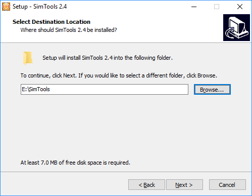

  13. Corporatezombie
    Corporatezombie Member SimAxe Beta Tester Gold Contributor
    May 14, 2015
    38
    Leicestershire
    148Coins
    +18 / 0 / -0
    3DOF, SCN5
    It seems that Simtools installs to C: drive no-matter if you tell it to install elsewhere. Just sayin... :)
    Sorry I didn't mean this to come across as sarcastic. Just that it wasnt a big deal. I mean even Nvidia dont let you install to a different drive.

  14. yobuddy
    51,741Coins
    +5,205 / 19 / -0
    I just installed it on my games (E) drive no problem.
    You simply select the path you want when you install it.
    Take care,
  15. Kranky Pantz
    Kranky Pantz Active Member
    Sep 9, 2018
    362
    Canada, Eh!
    1,288Coins
    +297 / 0 / -0
    Follow @yobuddy's steps outlined above to select the drive + path of your choice.
    SimTools is sitting happily on my D: drive within my other directory of Sim related apps & programs.
    Just sayin'... ;)
  16. Corporatezombie
    May 14, 2015
    38
    Leicestershire
    148Coins
    +18 / 0 / -0
    3DOF, SCN5
    How strange that I browsed to the drive and then watched as it installed to C instead. I'll uninstall it and try again.
