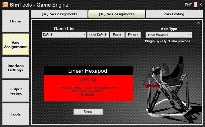

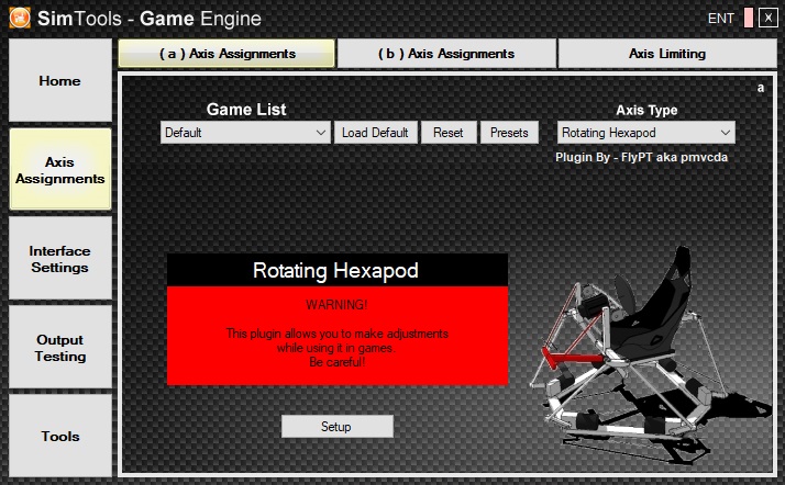

    New SimTools inverse kinematics 6DOF Beta Axis Assignments Plugins
    (Special thanks @pmvcda aka FlyPt!)
    Linear
    https://www.xsimulator.net/community/marketplace/linear-hexapod-plugin-beta.231/
    Rotating
    https://www.xsimulator.net/community/marketplace/rotating-hexapod-plugin-beta.230/
