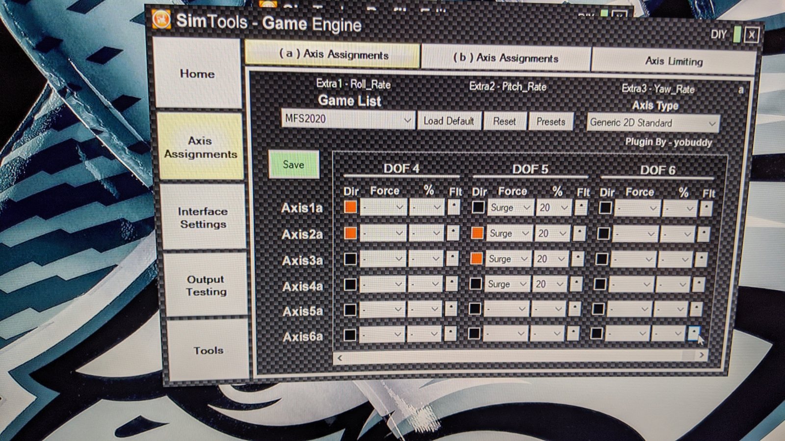

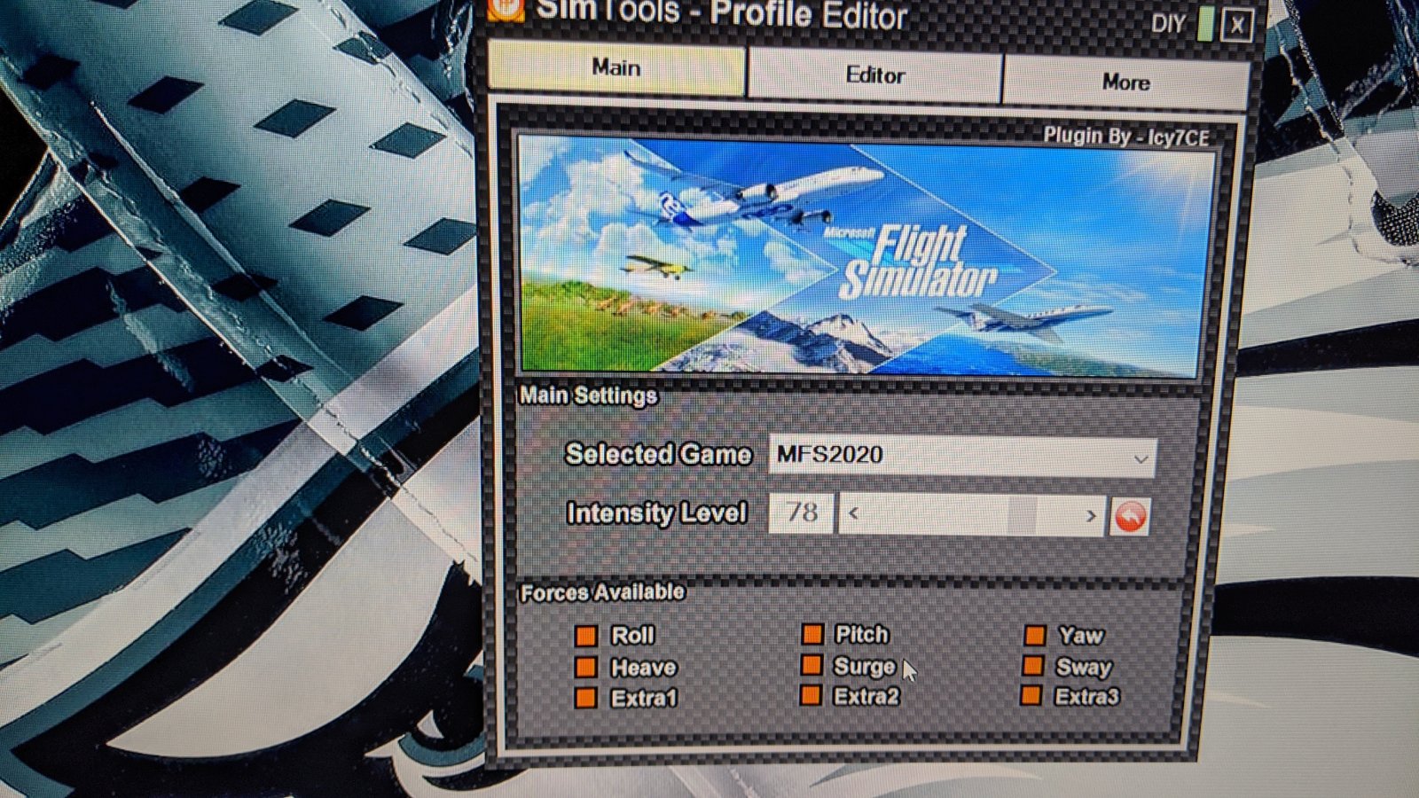

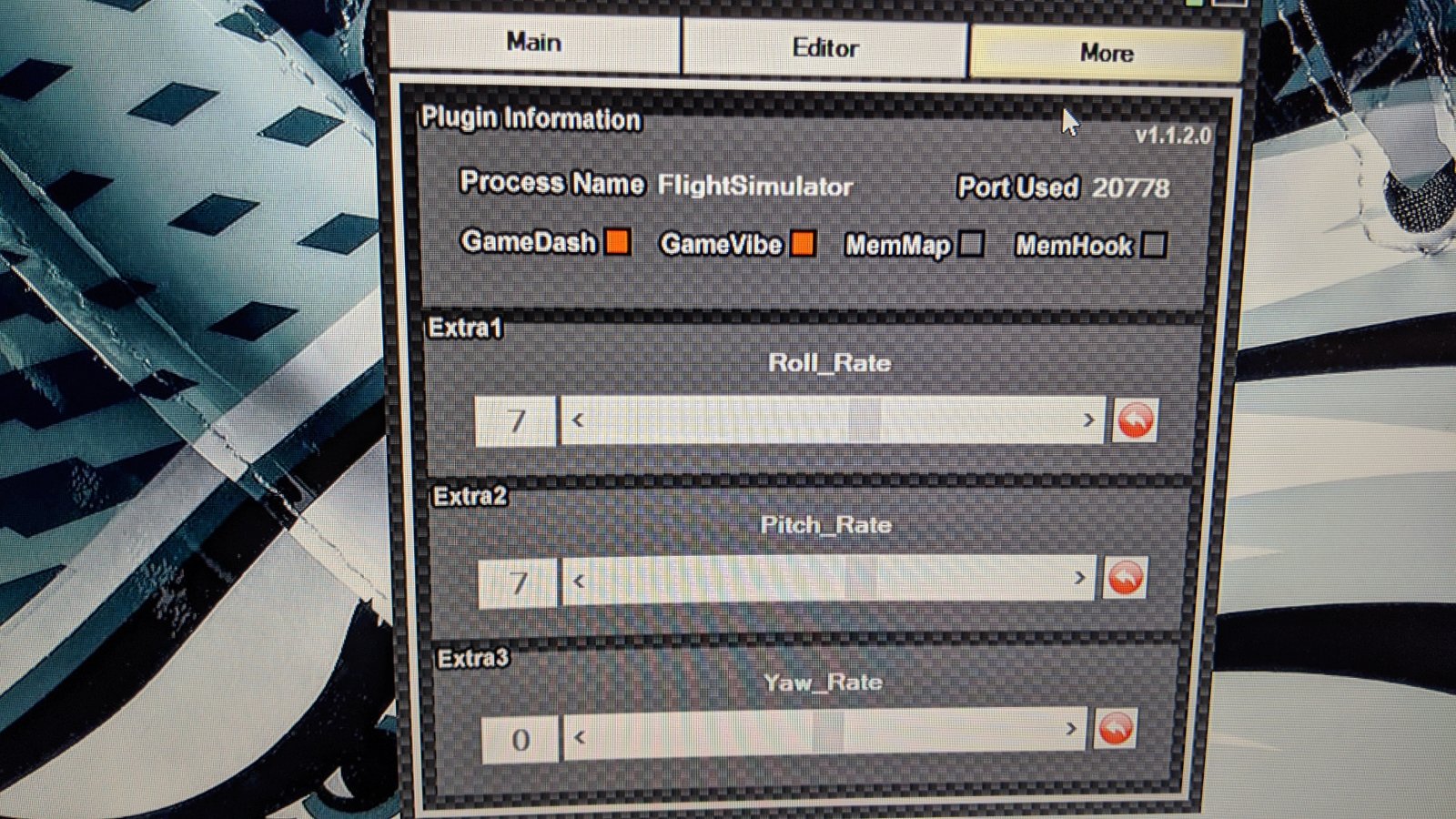

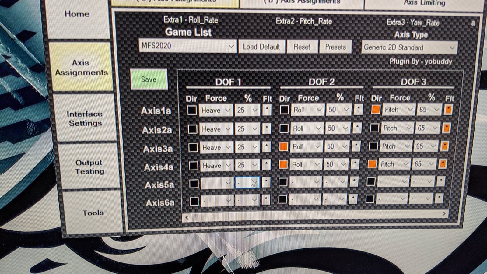

    Can you please post pictures of all of your GameDash and GameVive settings, that way @Icy7CE may be able to advise.
