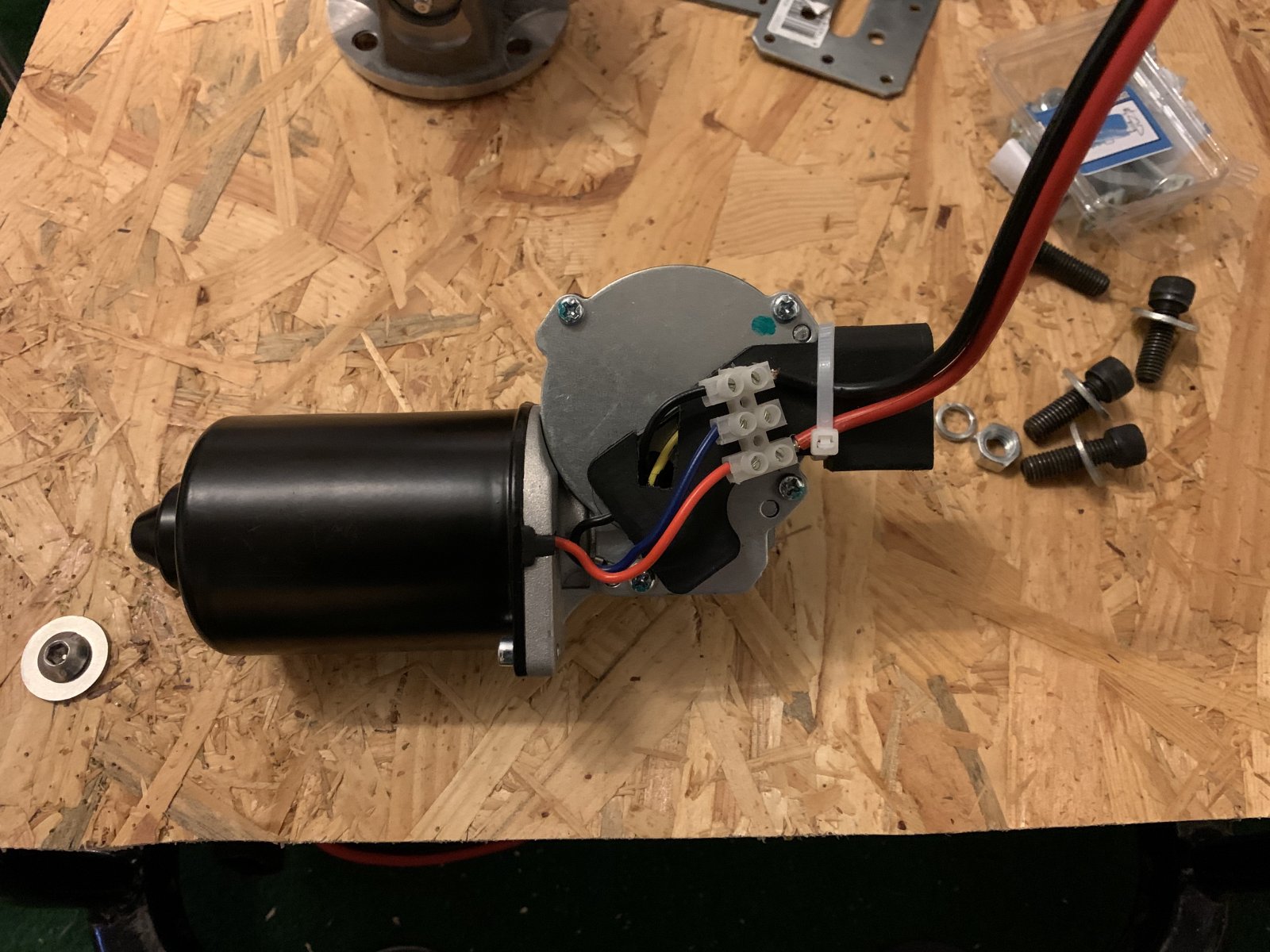

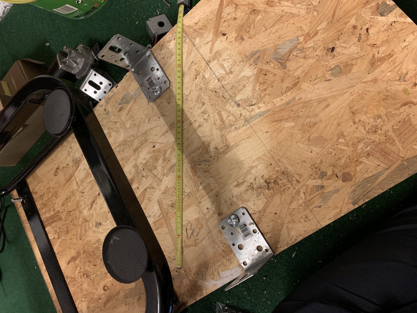

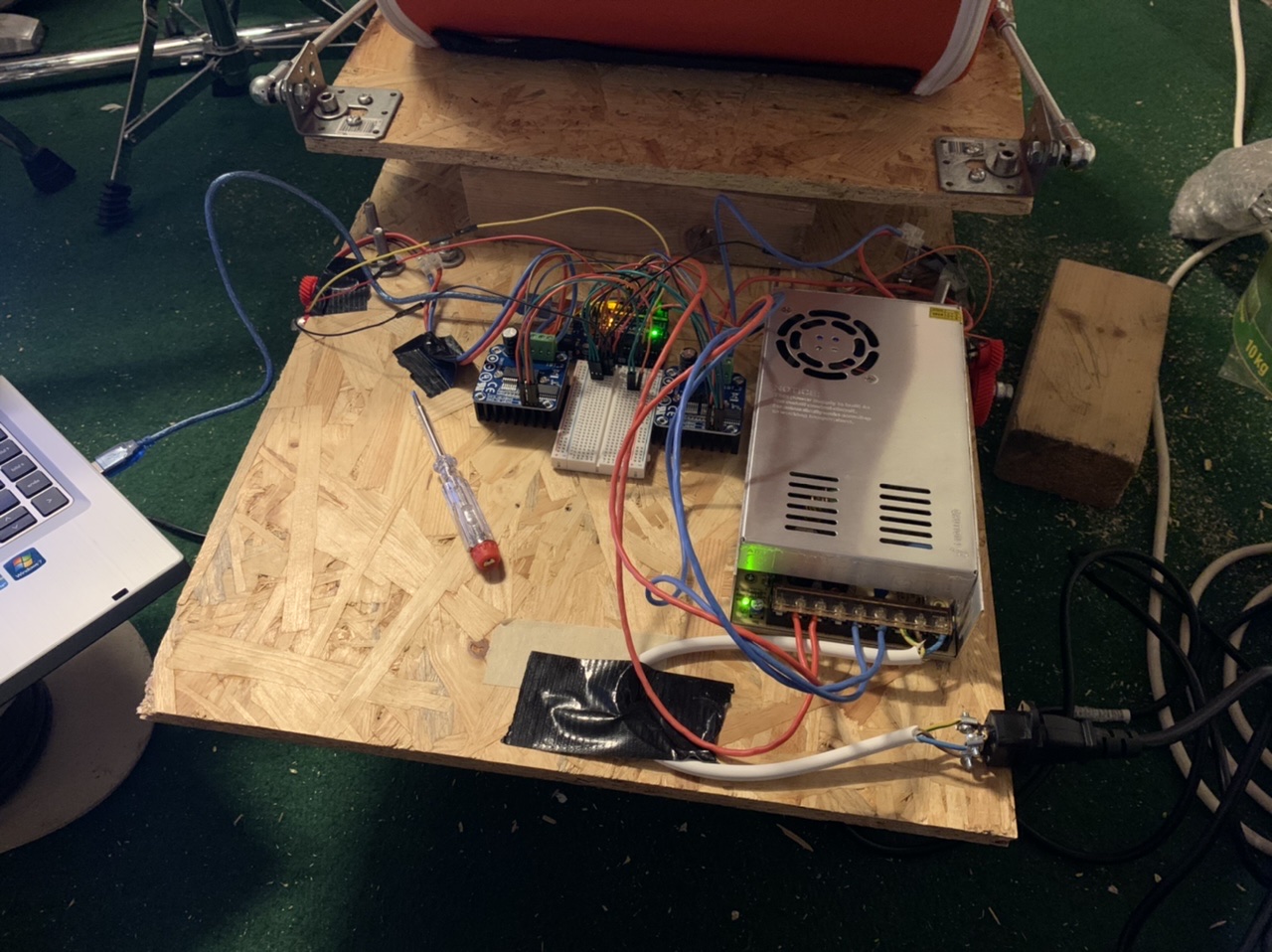

    after reading a few weeks I want to start my own 2-dof project.
    I'm pretty new to all this simulation stuff so I will try to keep things simple at my first build.
    I decided to go with two 12v wipers from Ridex
    two IBT-2 motordrivers
    two 10k endless pots
    arduino uno r3
    12v 360w power supply
    some wood, bolds and a lada 1988 u-joint
    to convert my fk rig to a seatmover.
    this is where it began:

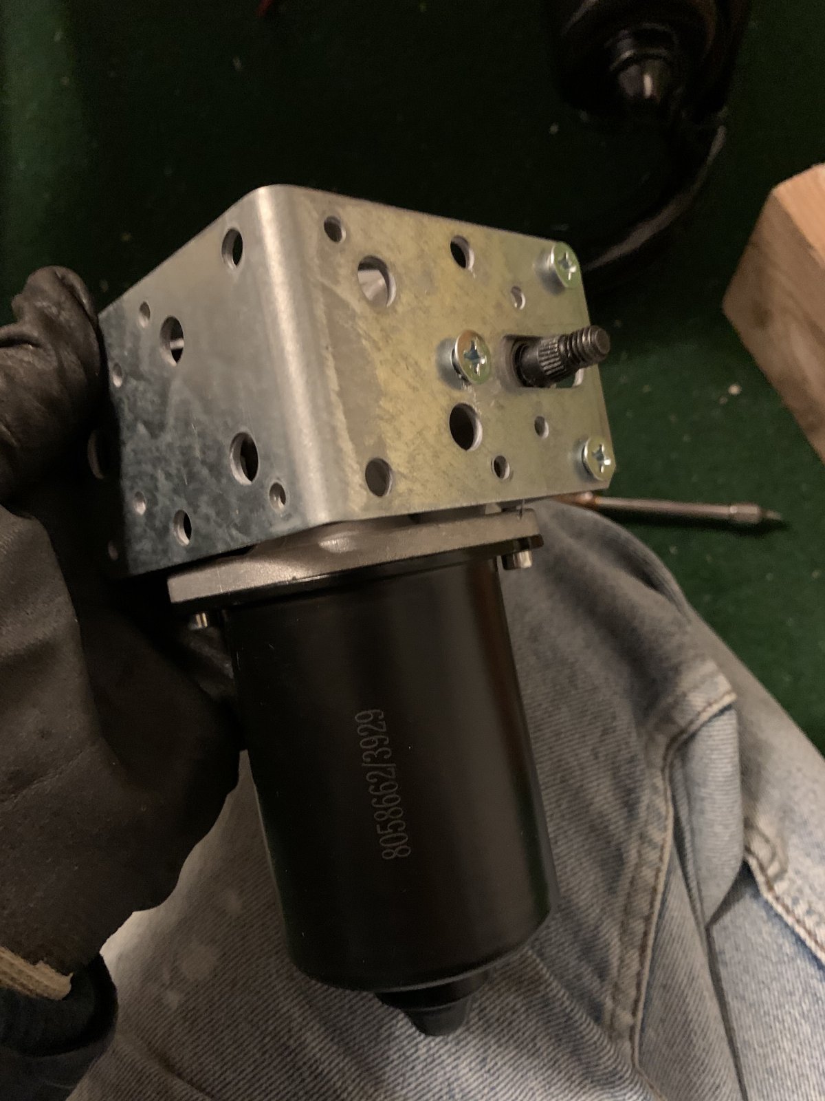

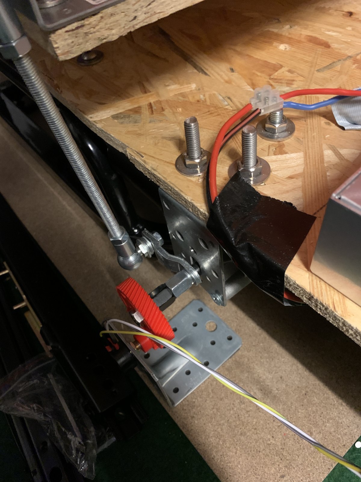

    i connected the motors with the brackets on the bottom plywood board.

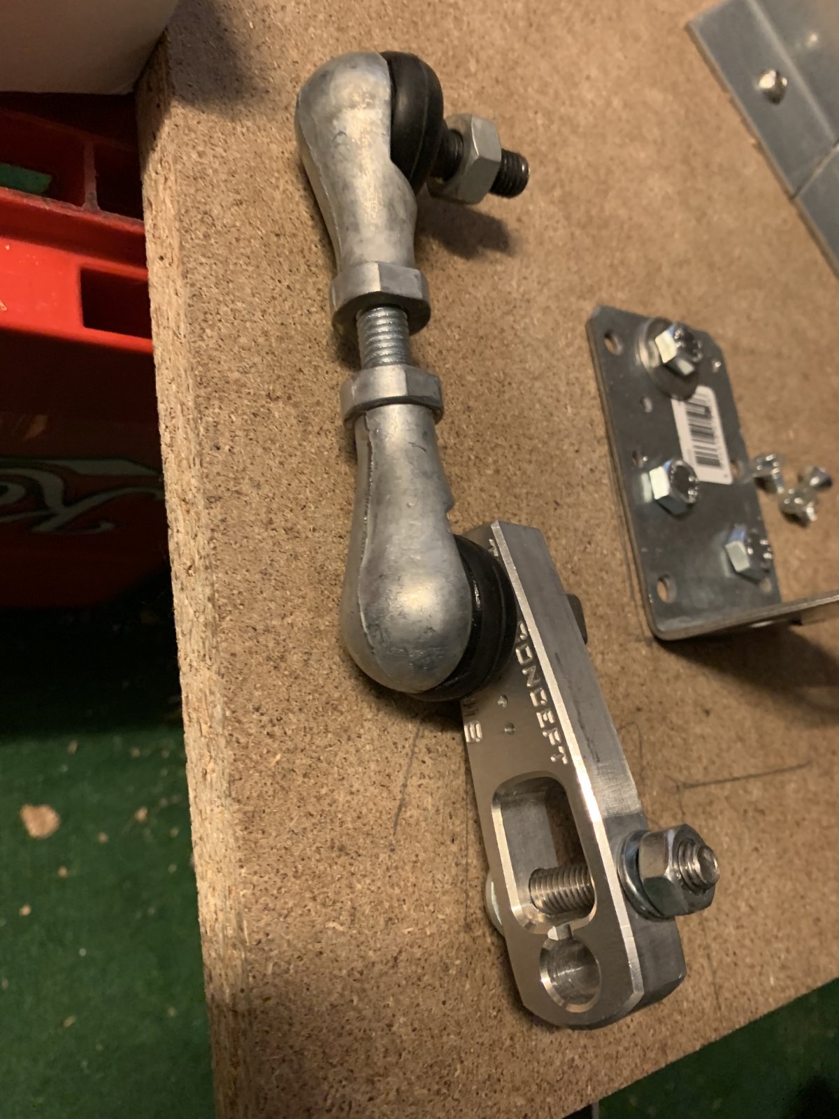

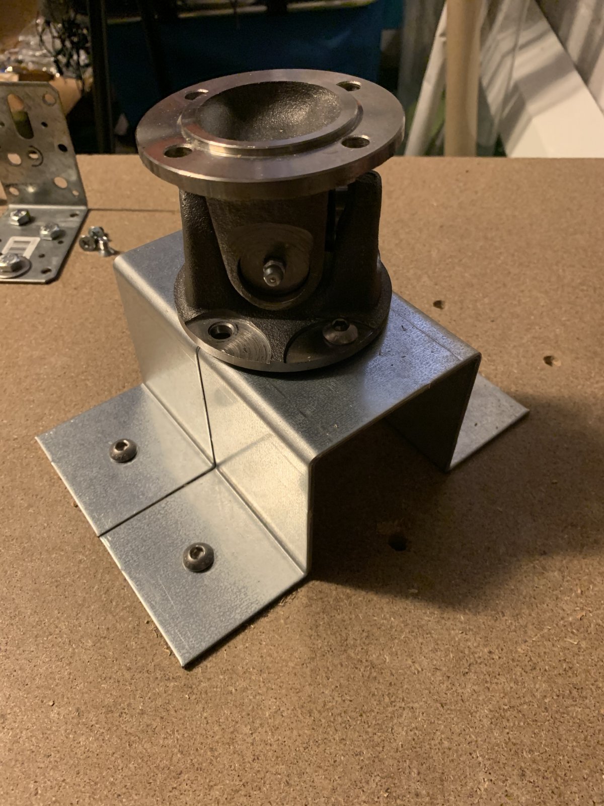

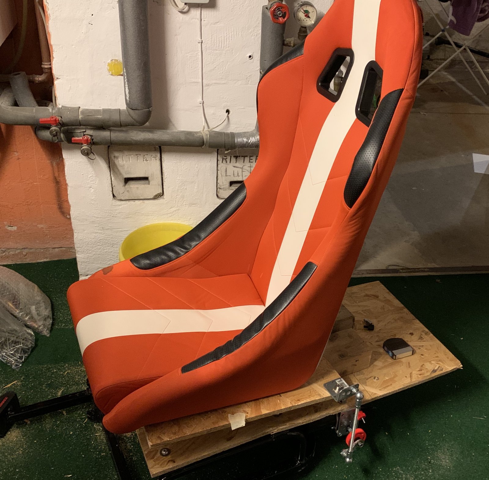

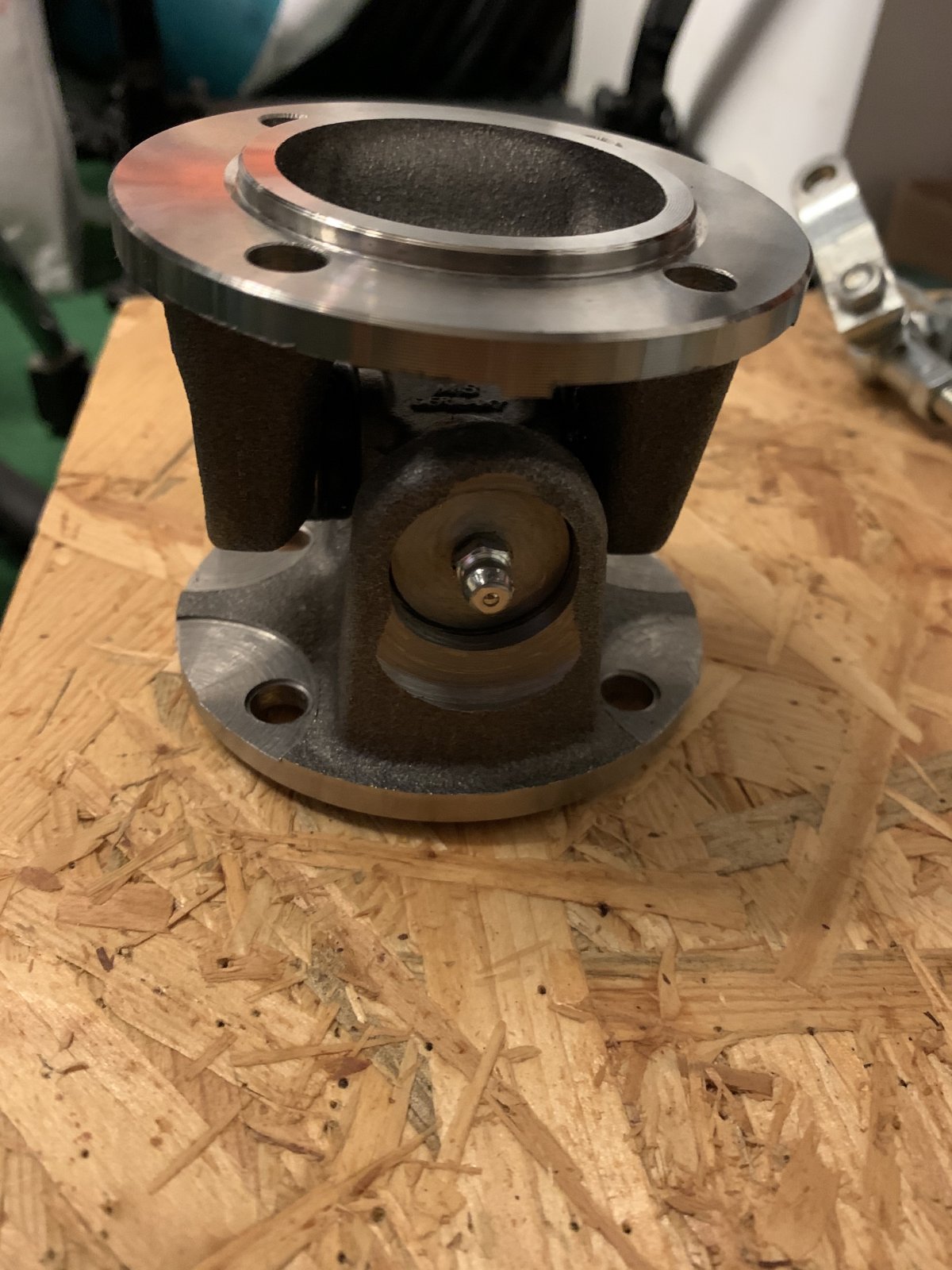

    i used a lada u-joint to connect the bottom and top panel with the seat on it.

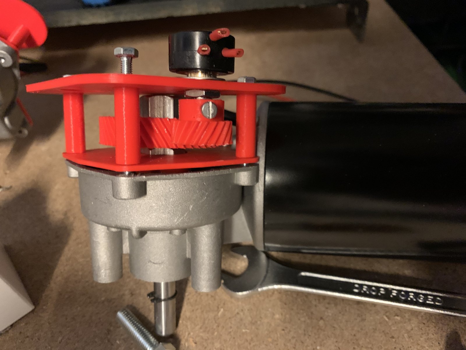

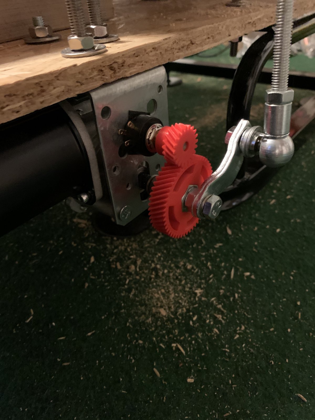

    this is how i connect the plywoodboards with the motorshaft.
    i used two simukit gears to connect the pot.
    i extended the motorshaft to give the possibility of a full rotation.

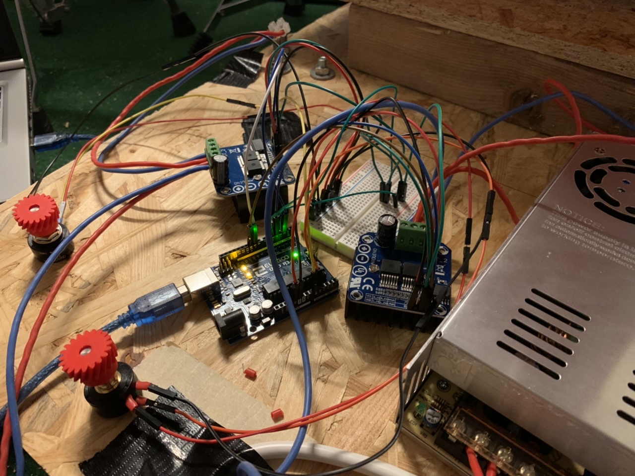

    311A9A91-4F93-43A4-8DB7-6888C848A2F3.jpeg 8DF4779A-0E03-4861-88B7-A8F51F7AFCDE.jpeg

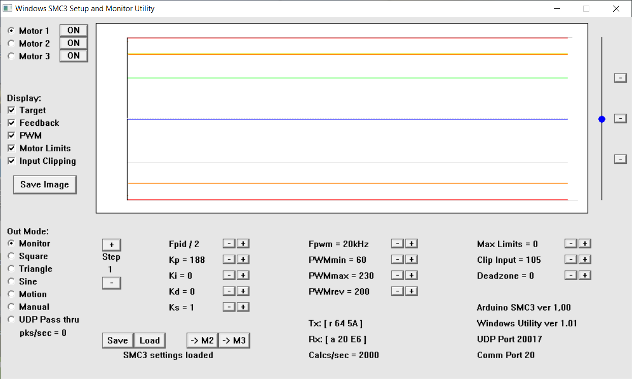

    wiring is done!
    motors are moving with the smc3 code in smc utility manager.
    more to come... ;)

    thanks noorbeast!
    yes, i already grounded the wipers.
    you´re right, on the picture the brackets are only connected with one bold, i already improved it to three per bracket.
    i wonder if a pot connected to the motorbracket is a smart move?
    maybe there are some problems with the positionreading, because of motor vibration...
    21,722
    152,045Coins
    +11,063 / 56 / -2
    Consider the thickness of the bracket as well, as they are subject to a lot of force and need to be rock solid, and if they are the pot should not then be an issue, but could be if the brackets flex under load and rig reversals.

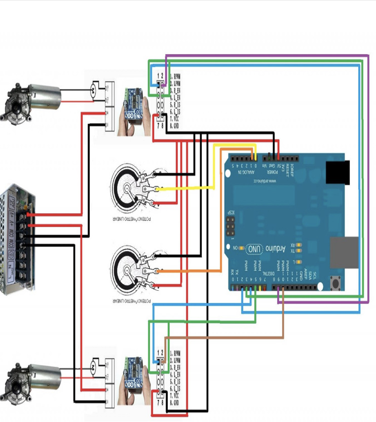

    small update:
    controlbox is wired.
    making my first steps with smc3 now, running in mode2 with my ibt‘s, thats correct isn‘t it?!
    lines are moving, motors dont.... :/
    21,722
    152,045Coins
    +11,063 / 56 / -2
    Yes mode 2 for ibt‘s.
    Are the motors connected to the pots, I am presuming they may be under the board?
  8. dieser
    dieser Member
    Jan 20, 2020
    54
    372Coins
    +12 / 0 / -0
    yes the motors are under the board and connected. the motors are the thicker red and blue cable coming out of the cable clamp...

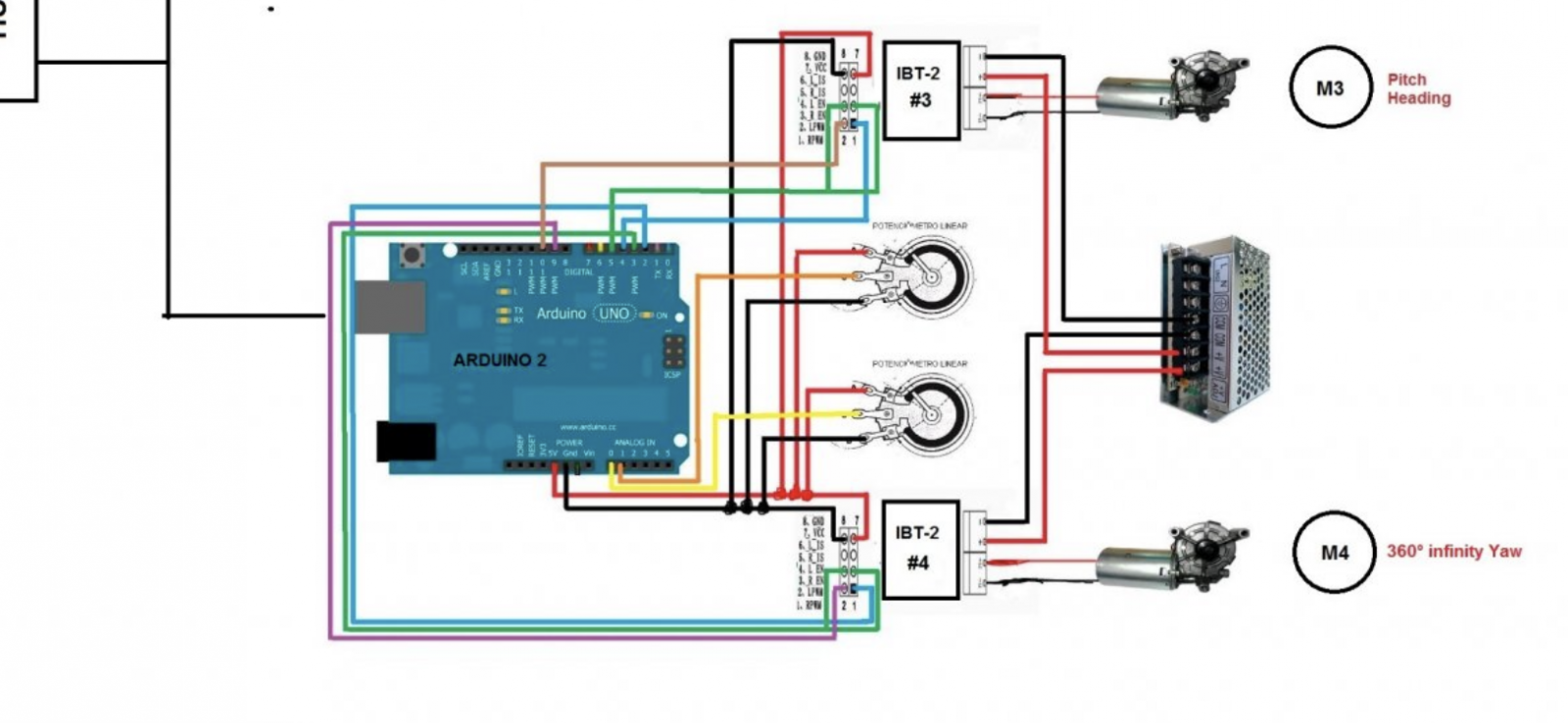

    i wired everythings like that:
    motor 2 is showing „off“ the whole time in smc.
    maybe i have a broken ibt or the pots are not connected firmly ( it‘s not soldered yet, for testing purposes )
  9. dieser
    dieser Member
    Jan 20, 2020
    54
    372Coins
    +12 / 0 / -0
    ok, i rewired everything and tadaaa: it‘s working! motors are moving in smc-tool and i can control the direction and speed with the pot‘s!
    it‘s a big step in building my own sim and it feels good. :)
    what makes me doubt is:
    when the pot‘s are in my hands motors move and i can control them, but when i attach the pot to the motor like i did in the startingpost nothing is moving.
    can this be a problem later?
    tomorrow i will try it with simtools demo...
  10. dieser
    dieser Member
    Jan 20, 2020
    54
    372Coins
    +12 / 0 / -0
    ok, i got movement thru simtools now, also when using lfs...
    unfortunately i have to change my potdesign now.
    locknut is loosing when seat is under load.
    i have to move the lever in front of the pot´s .
    maybe i will order a two sided motor next days.
    I was thinking about using more powerful engines anyway...
    i will report then!

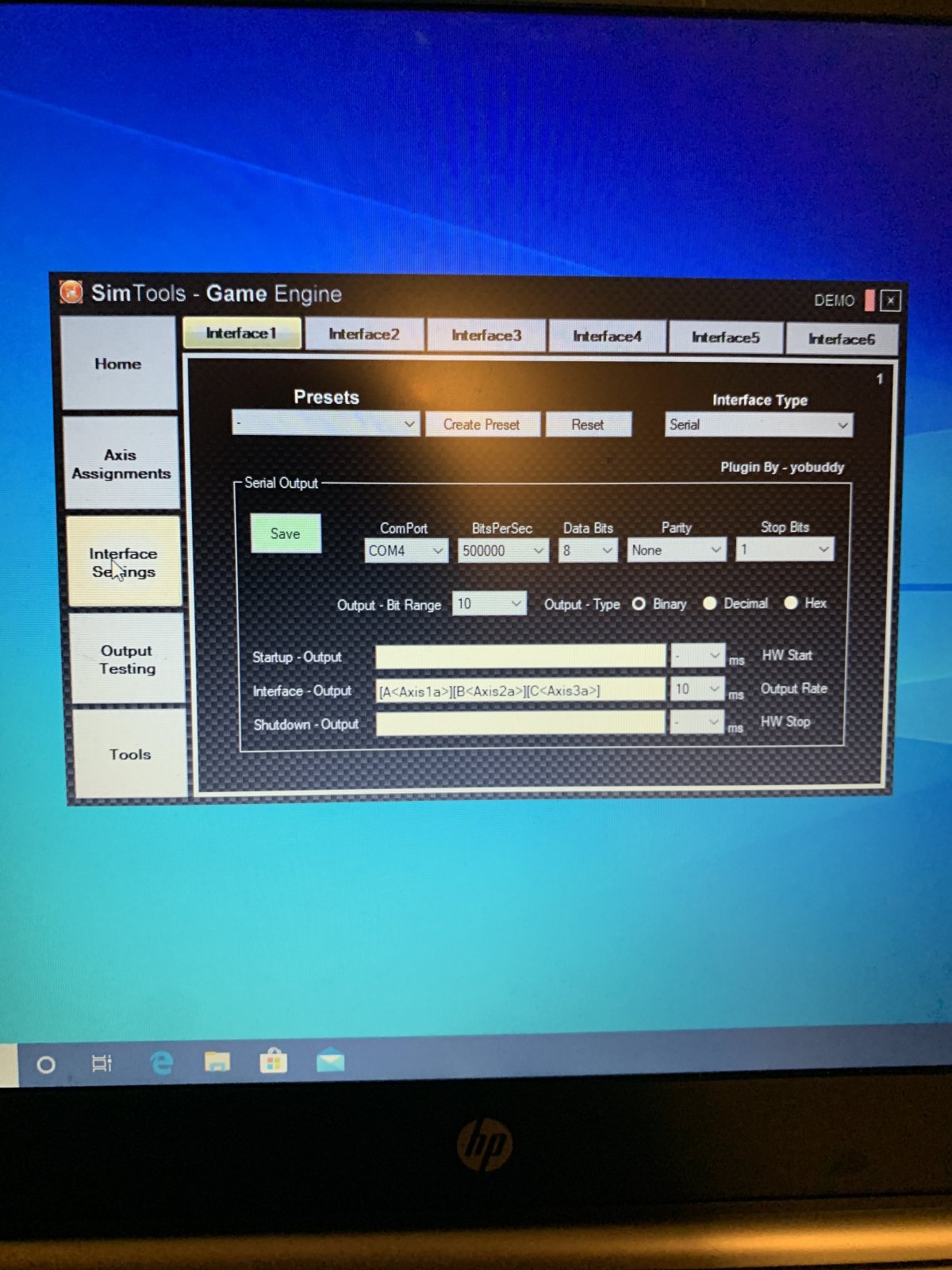

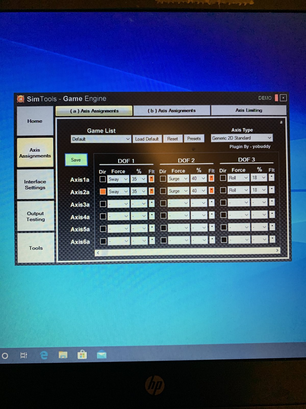

    i‘m waiting for my new motors at the moment.
    in the meantime, i changed my potdesign and try to get firm with simtools...
    seat is moving, but struggling on simtools-settings right now...
    seems like my direction setting is wrong?!
    move left/right when accelerating or breaking...
    can anybody help to set a good simtools config to get started.
    thanks guys!
  12. noorbeast
    21,722
    152,045Coins
    +11,063 / 56 / -2
    I normally suggest filters not be used until there is a refined base profile.
    The Dir boxes being checked orange or not determines which way an axis movers, and this is what SimTools expects: https://www.xsimulator.net/community/faq/which-way-to-set-simtool-axis-movements.230/
    Roll Dir setting should be the opposite of sway, and I would expect a higher Roll axis allocation.
    But total Axis allocation % should not be too high: https://www.xsimulator.net/community/faq/axis-assignment-percentage-totals.120/
    Here are some tips on refining a motion profile: https://www.xsimulator.net/community/faq/steps-to-create-a-motion-profile.228/

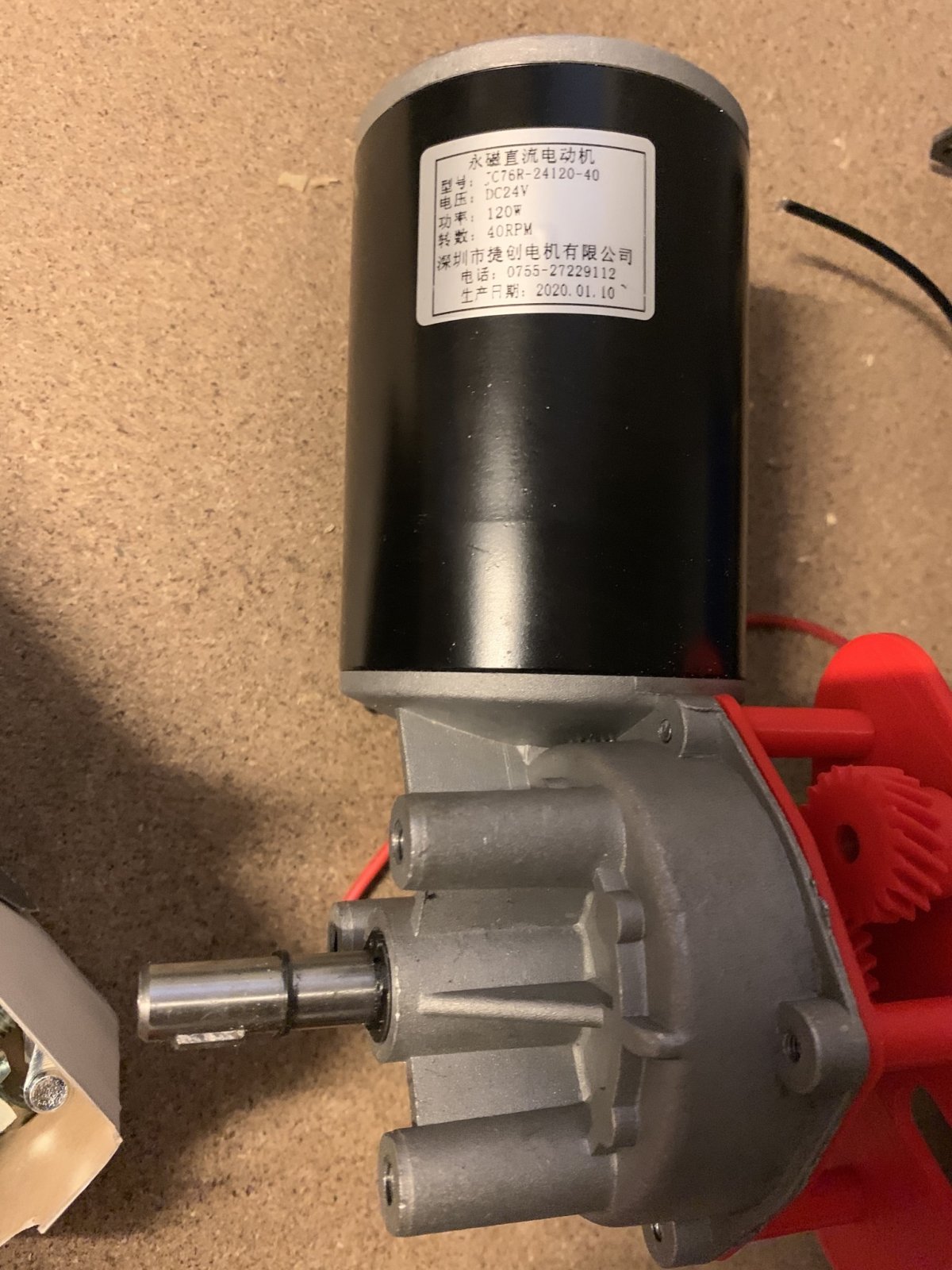

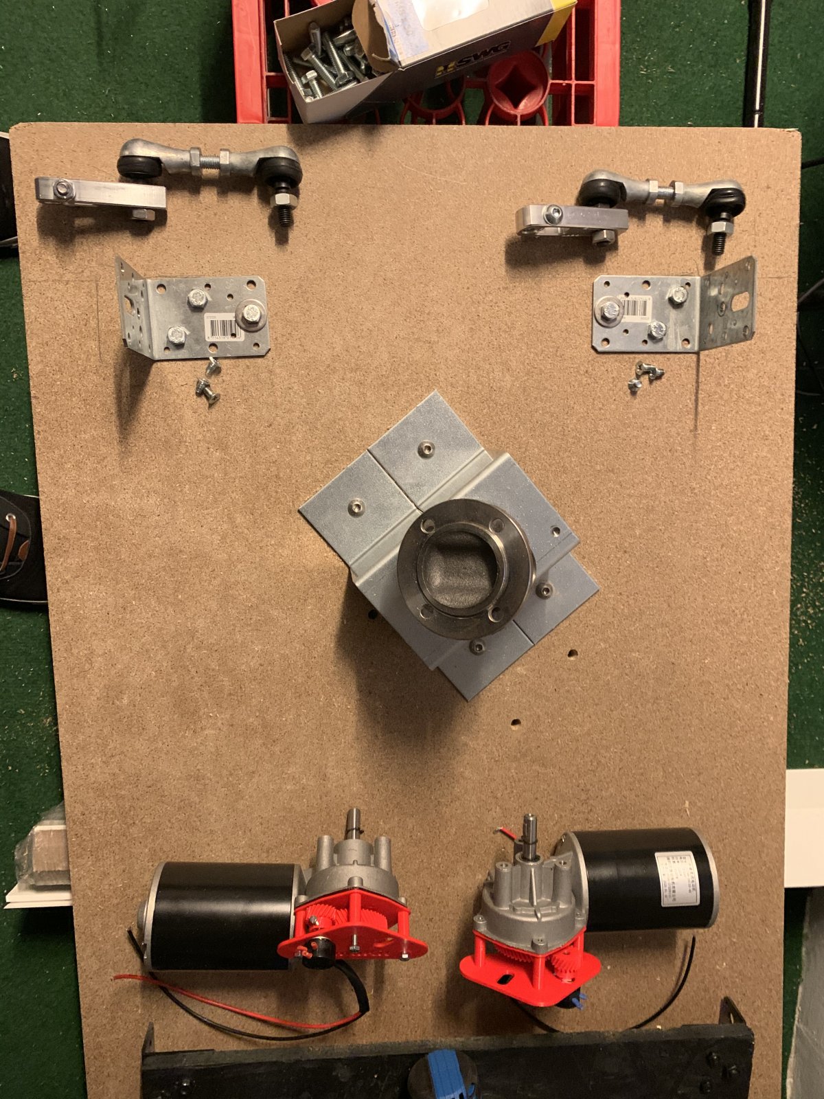

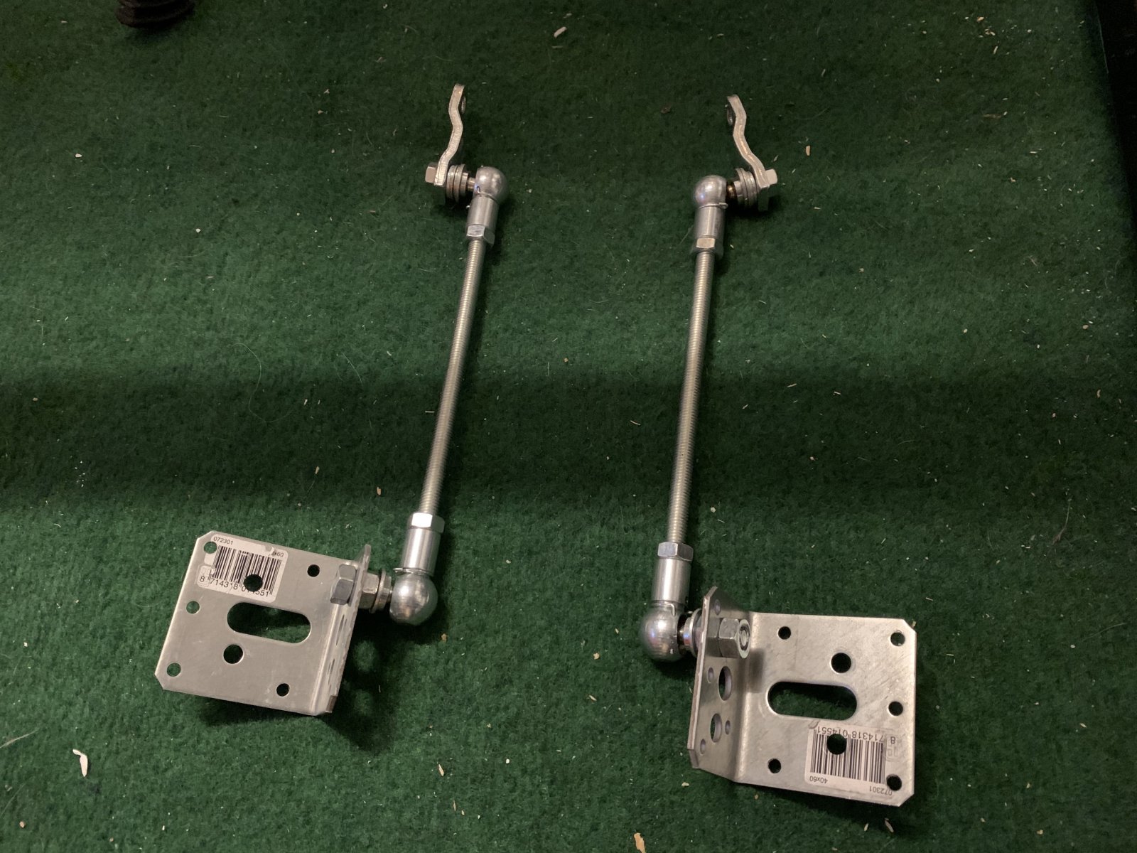

    just started my redesign in the last couple days.
    i will change the startingpost shortly...
    i got inspired by @mimi67 for this kind of seatmover :thumbs
    new motors arrived:
    24v 120w 25nm 40rpm
    new potholders and crank by simukit
    830C8654-B0FA-4057-B2B1-D6F13A3623DA.jpeg DBDA5722-2815-443C-988B-1E45C4615F99.jpeg
    putting the u-joint on this metalclamp which acts as a pedestal to create space between the seatboard and the new bottom board.
    the motorbrackets moved on the bottomboard too.
    wired everything under the seat
    second psu is for the fans which will be mounted on the backside and for bass-shakers i will add later...
    next days motors get wired up and doing first motiontests.
    and i will build a case around the bottom board
    still a lot work to do! :)

    When you get it moving check those thin brackets for flex, as motion rigs generate a surprising amount of force.
