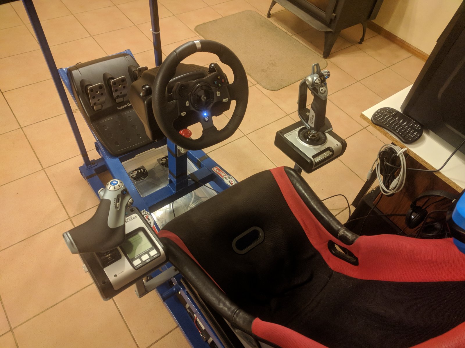

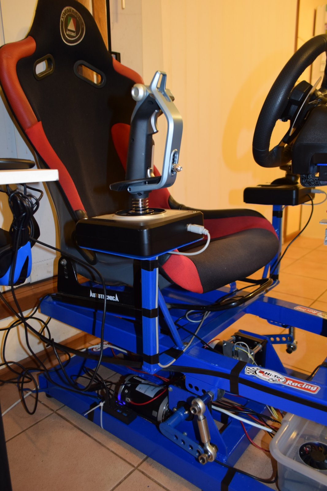

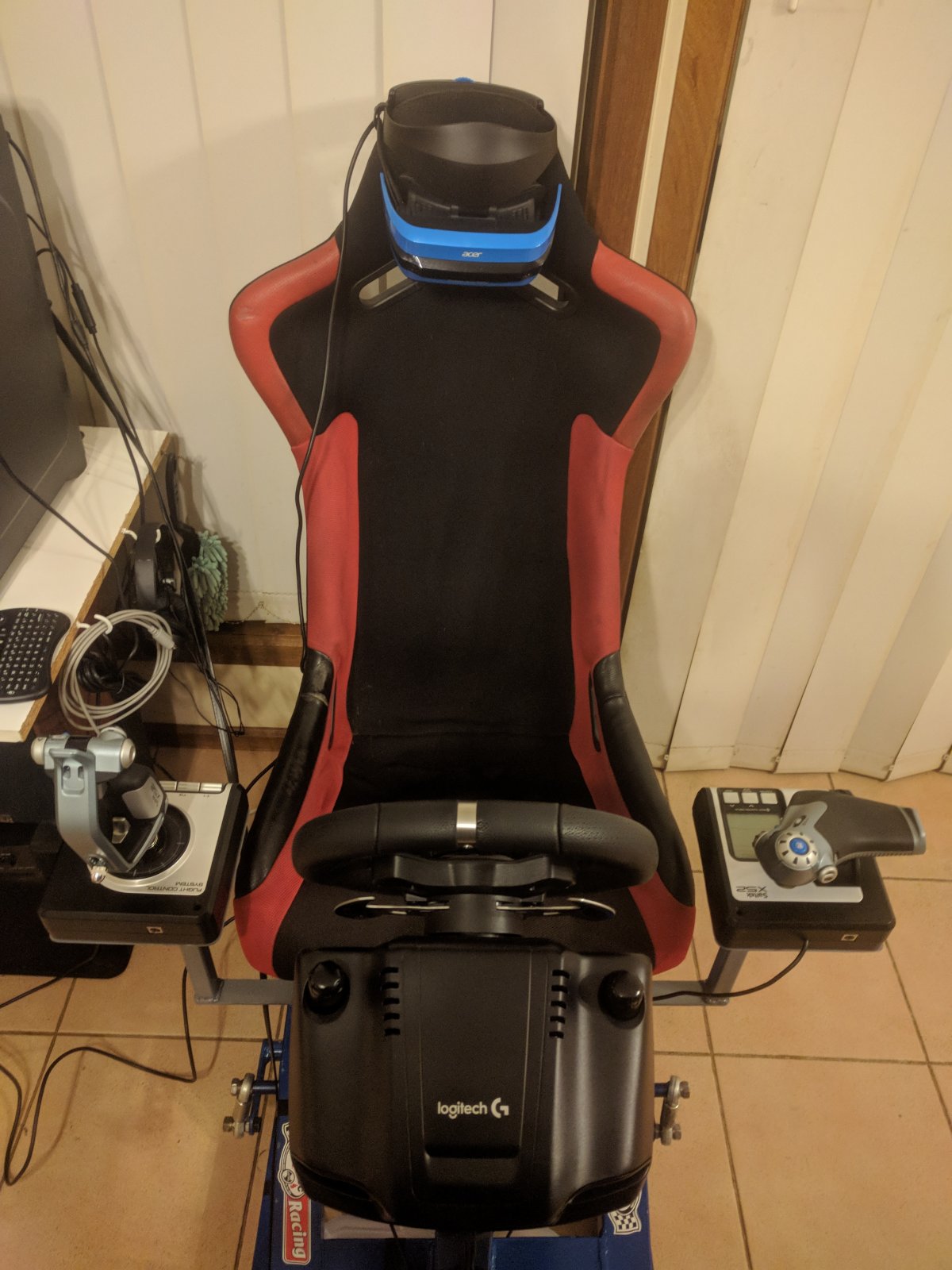

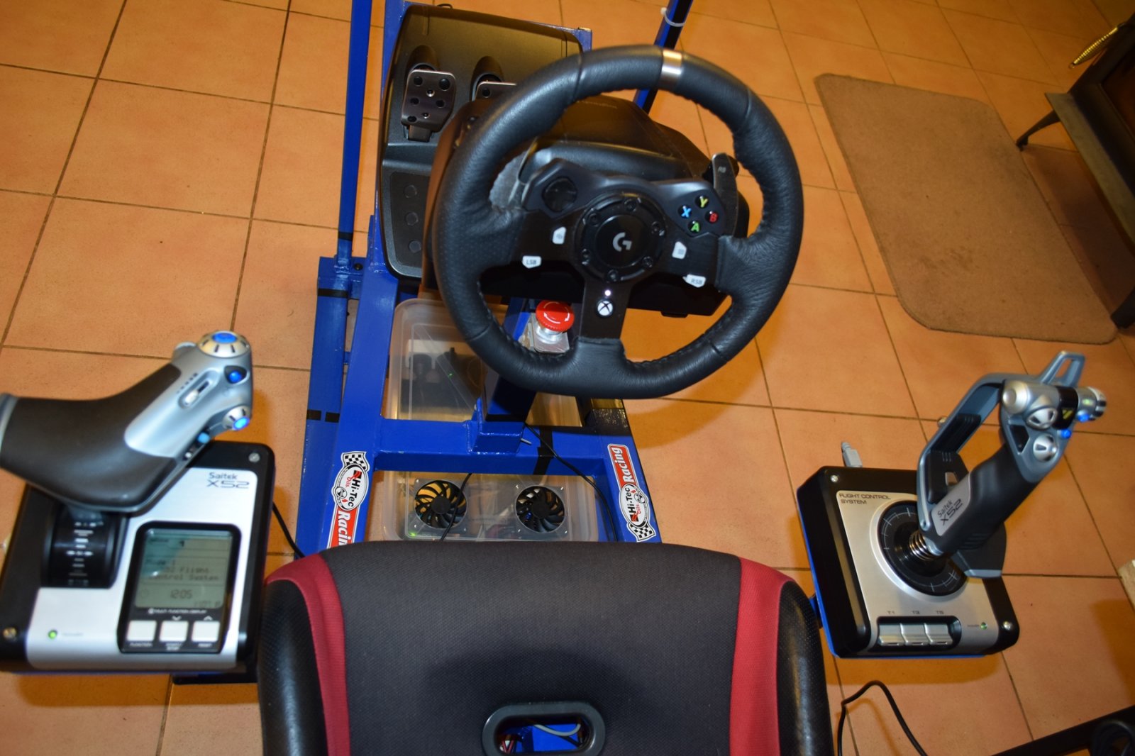

    I'm slack I know but still no motion because I have been making a mount for the HOTAS system that I got yesterday so that I can try some flight & space sims.
    It's only an Saitek X52 but it will do what I need and it was cheap.
    It's all very cosy but they are easy to reach and I'm skinny anyhow so if I can fit is all I care about.
    It is easy to remove, just two wing nuts and It will come off as one complete unit.
    So I am happy with the fit etc so it will get a coat of blue jam tomorrow to match the rest of the frame.
    My VR headset is visible as well.

    Looking sharp my man!!!!
    I see that you've added a couple of fans to the lid of your electronic box as well, or has it always been like that?
    You'll have a blast with flight/space sims in VR on that rig of yours.

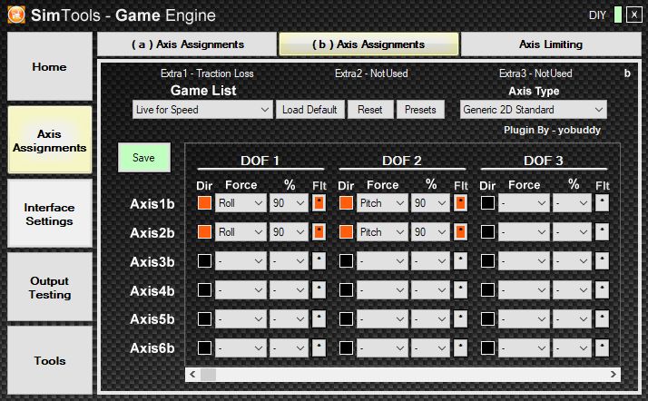

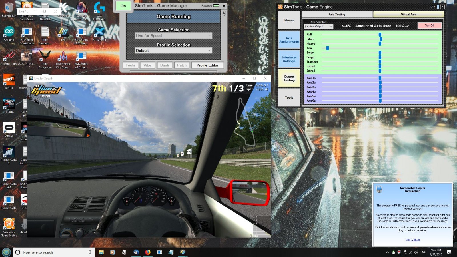

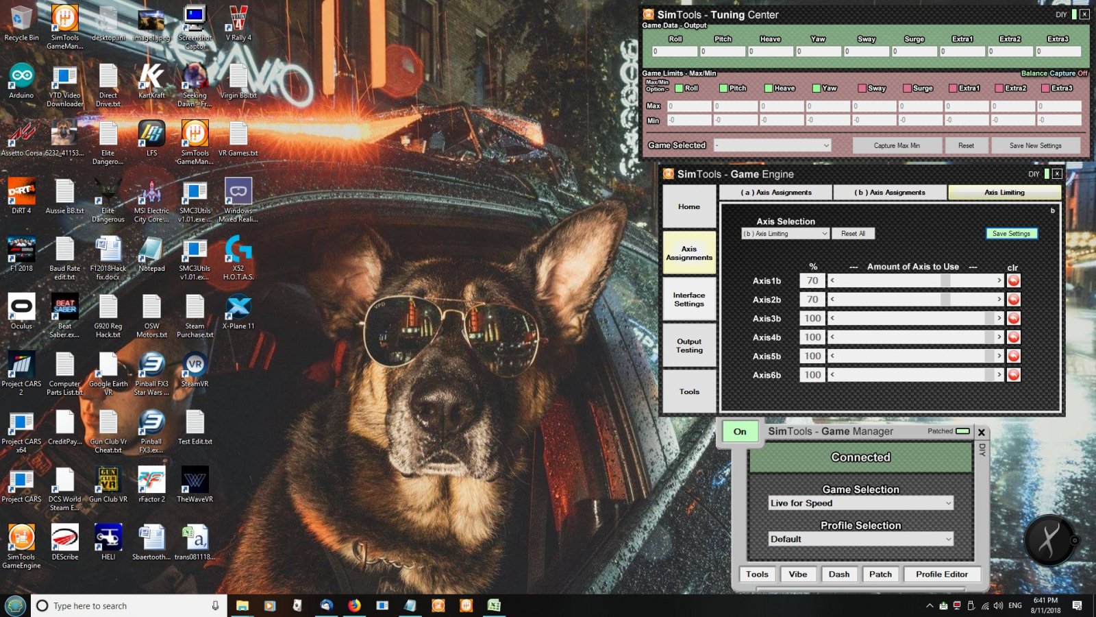

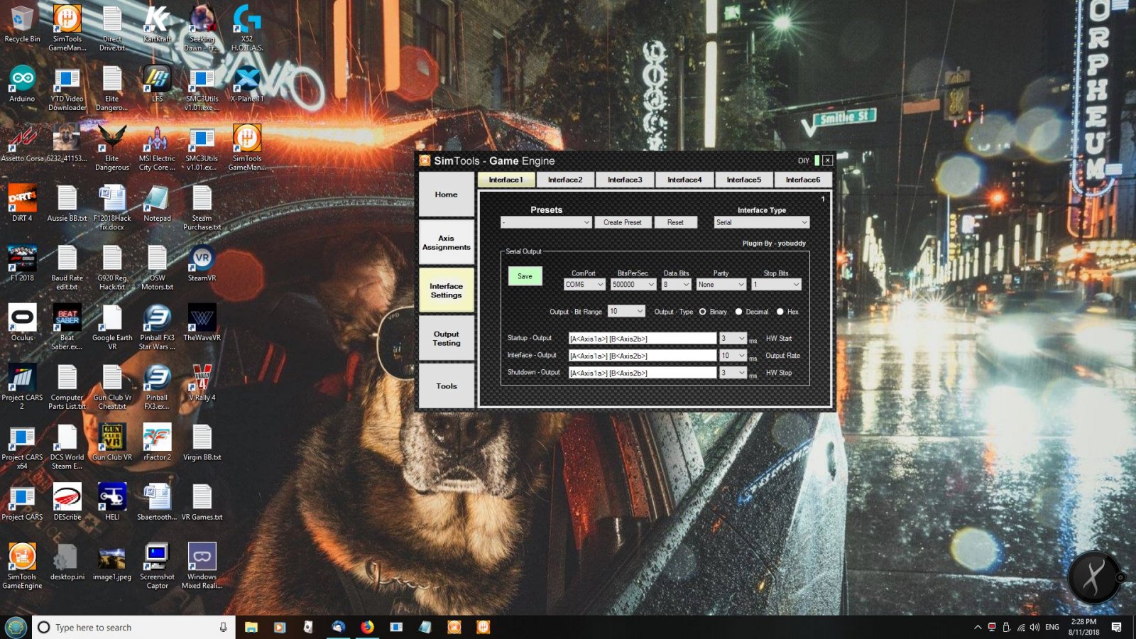

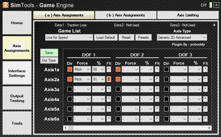

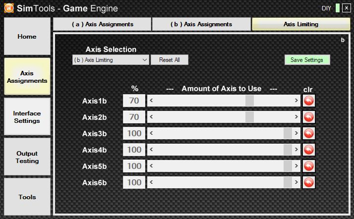

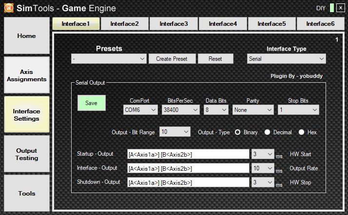

    I'm very slowly trying to get Sim Tools setup and working but I must have buggered up somewhere as I gone through the manual and followed the steps and
    I have LFS running and the capture data on and also live data is working in Virtual Mode and the sliders are responding to my imputs, but I am getting no movement from
    either motor.
    So can some one look at my screen shots and tell me where I might have goofed please.

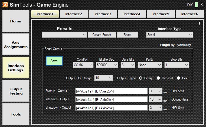

    The Interface Output should be like this: [A<Axis1a>][B<Axis2a>]
    Clear the Startup-Output and Shutdown-Output fields for now.
    LFS has to be run for a couple of laps in first person mode to generate some necessary files. So if you did not run LFS prior to patching them un-patch it, shutdown SimTools, start LFS and drive a couple of laps, exit LFS, re-start SimTools and patch LFS.
    You will also need to refine your motion profile, doing one axis at a time: https://www.xsimulator.net/community/faq/steps-to-create-a-motion-profile.228/

    No luck so far. I did what you said unpatched Did some laps, Repatched and ran the game LFS and captured data and it was showing in Vitual output pan on both axis , saved those new settings, the tried Manual output and SFA movement when I move the sliders.
    I think that I'm close and the motors are getting power and slightly quivering when idle so i think it is comms problem or setting but I do have the port setting right and the baud rate etc, rotational output selected.
    Are the settings kept in one profile file that I could send as get you to see if anything obvious is out of whack ?
    And as usual it's late , 2.40 am so my brain needs a rest :confused:

    Set the baud in Simtools to 500000. 38400 is arduino to your sabertooth rate and 500000 is Simtools to arduino rate.

    Noorbeast, I changed the baud rate in Sim Tools as you suggested and turned on Axis tuning and motor A started to rotate on it's own and would not stop.
    So it's the same old problem or setting at work.
    Motor B did not move at all.
    So I guess it's back to SMC utility to see what's going on.

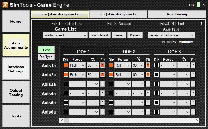

    Back again.
    Noorbeast I checked my pots and they were out a bit so fixed that and now I am getting movement from bot motors in Manual Testing.
    When you run LFS and you have Vitual Testing ON is the rig meant to follow the game inputs ? as the sliders are moving in the window
    but no movement from the motors.
    BTW I have NOT modified the sketch yet, it is as it was.
    Can you spot anything out of the ordinary in the pics. ?
    Last question is how do you get each motor to it's home position ?
    Is it done with the pot position or in software setting as my pots are out orf home position and each by about 45 degrees which makes me think that the position in SMC is meant be the same position, as in above or below the Target line ?
    Thanks.

    Update.
    I did something ? but now I have both axis responding to the LFS in Virtual Testing but is hard to see how much it's moving and drive LFS at the same time.
    I think the only problem now is working out how to get both axis in sync and start from a common home position which they are not doing atm and they are
    about 90 degrees apart .
    Sop as I suggested I think I need to move the pots to the same position ? YES or NO :sos

    You need to sort your hardware out in the SMC3 utility first, adjusting pots and settings so that movement follows commands: https://www.xsimulator.net/communit...driver-and-windows-utilities.4957/#post-48121
    Please configure your Interface Output as per my earlier advice, your B axis is incorrectly using a b designation, as it should be a: https://www.xsimulator.net/community/threads/diy-2dof-budget-build.12377/page-4#post-165810
    You should not need Axis Limiting, leave it at 100%.
    The DIR box being checked orange or not in Axis Assignments determines which way each axis moves. It would normally be one is checked and the other not for roll, and sway would be the opposite, so yours need sorting out, this is what SimTools expects: https://www.xsimulator.net/community/faq/which-way-to-set-simtool-axis-movements.230/
    Axis assignment percentage total allocation for all axis should be around 100%, it can go a little over as not all axis may be fully extended at the same time, except in a crash, but having 180% allocated for just 2 axis, when you also need to add heave sway and surge, is too much: https://www.xsimulator.net/community/faq/axis-assignment-percentage-totals.120/
    Everything should be configured and checked as working properly in Output Testing in terms of expected movement before moving on to the game motion profile.
    Follow the steps here to refine motion profiles, doing each axis one at a time: https://www.xsimulator.net/community/faq/steps-to-create-a-motion-profile.228/
