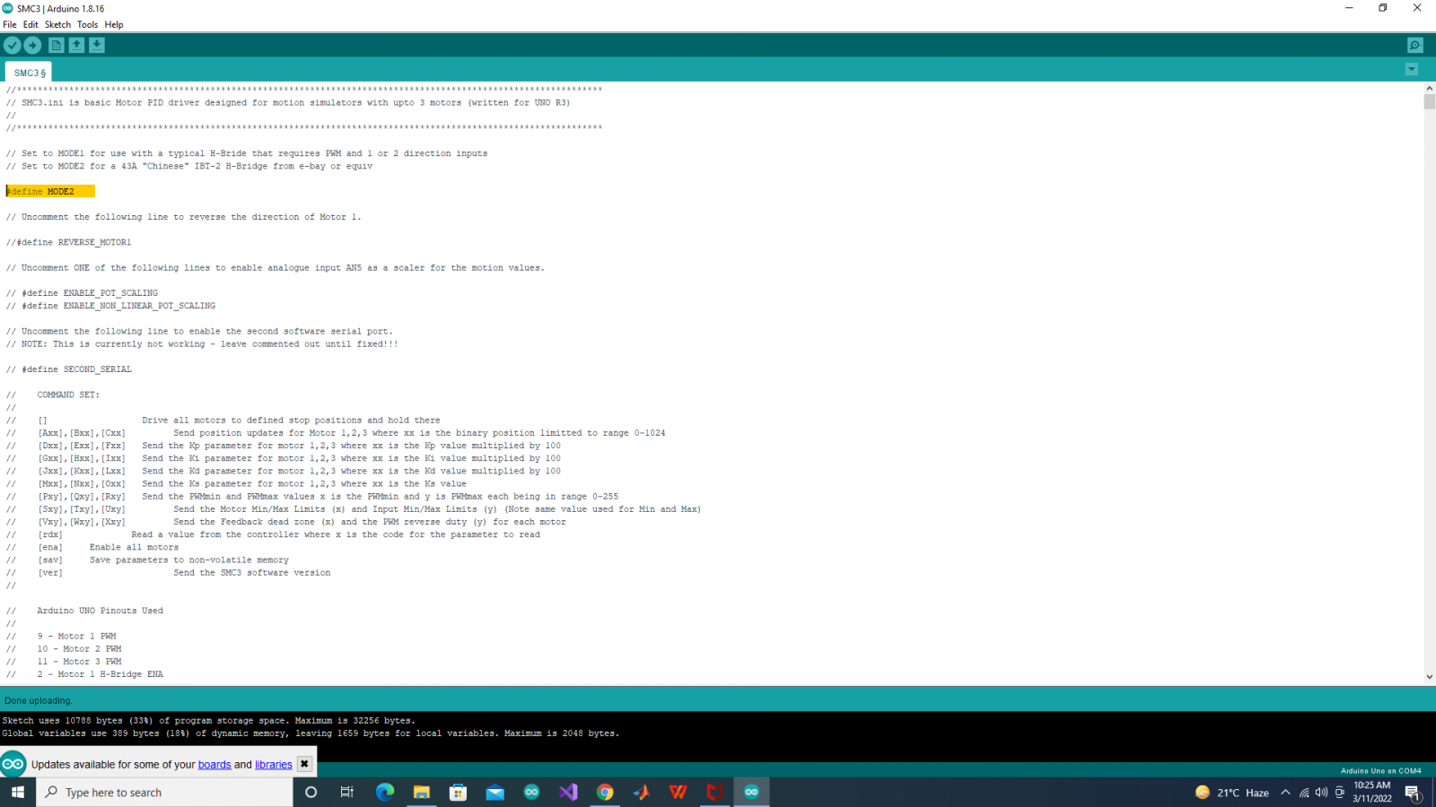

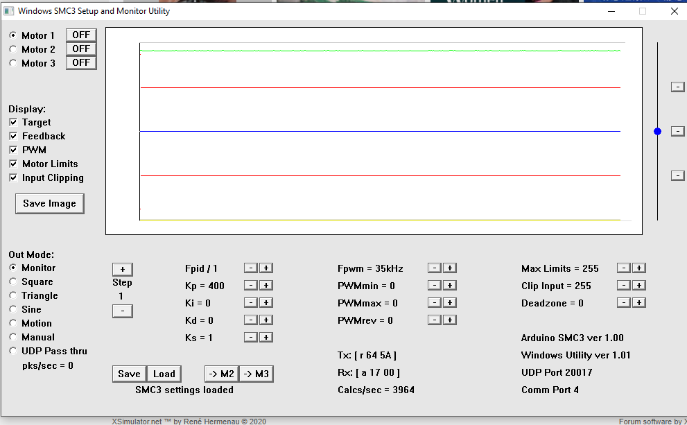

    It looks like you have not increased PWMmax, as per the SMC3 instructions:
    8. Set Kp to about 400
    10. Do the above for each motor

    Bring the green feedback line back within limits via the potentiometer and then enable them to ON
    21,907
    153,053Coins
    +11,117 / 56 / -2
    At rest the green line should be in the middle, so disconnect power to the motors, loosed the connectors to the pot and rotate the pot by hand until centered in the graph then re-tighten the connection.

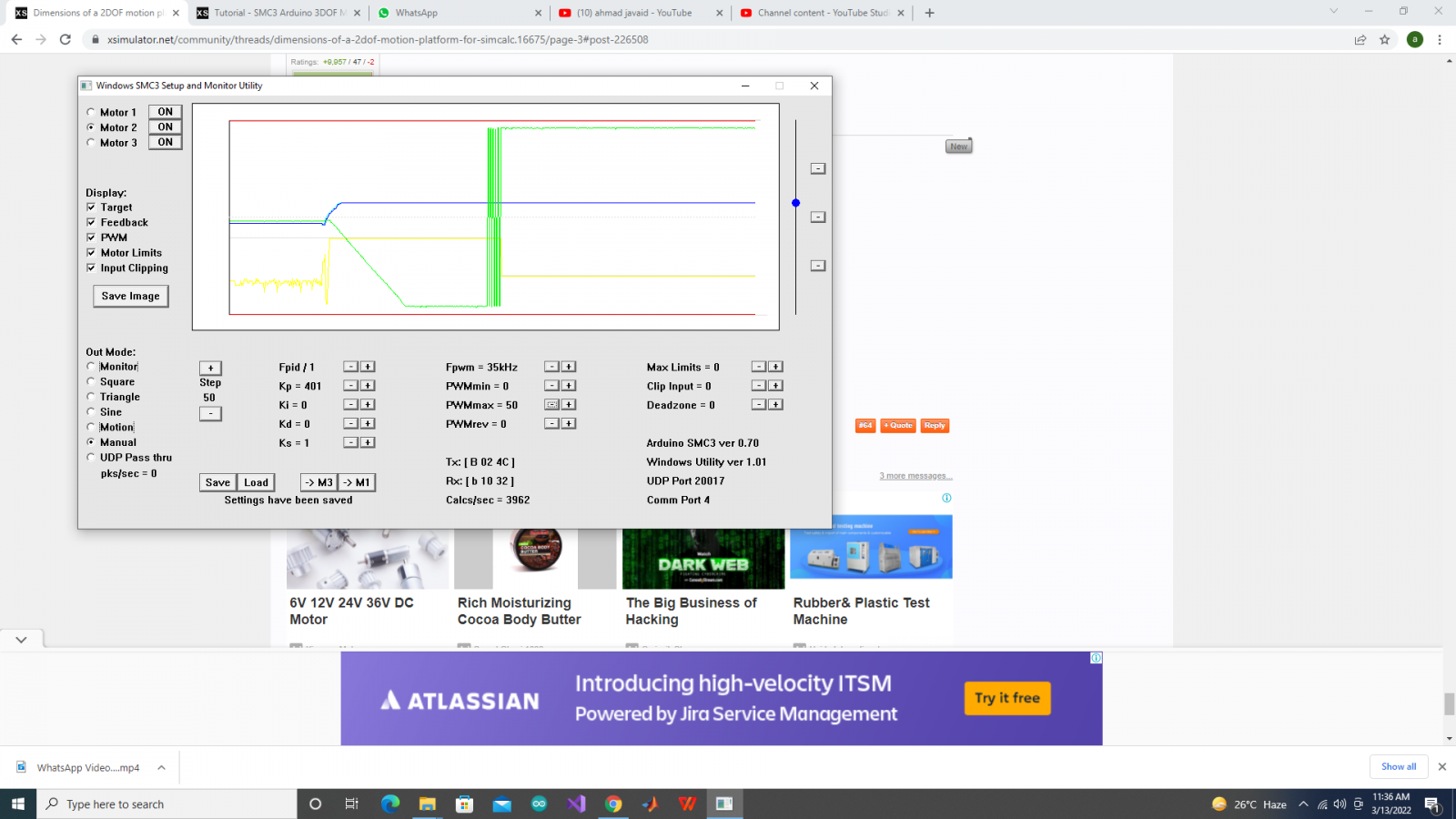

    As I drive the motor through manual command the green line of the potentiometer does not follow the blue line and the motor suddenly stops after vibrations. why green line is not following the blue line

    thanks I got it. Its not about you set limit to 255 any number other than zero can do the job. But its good to set it on 255. After setting to 255. You need to go to the manual command so that the green line becomes in line with blue line . As the green line comes parallel to blue line the motor stops. Now when you will rotate the motor manually the green line will follow the blue line

    there is huge gap . How I can solve it now. What should be the PID values I should use top keep a good track
    21,907
    153,053Coins
    +11,117 / 56 / -2
  10. SteULM
    SteULM Active Member
    Nov 13, 2021
    226
    Alla ricerca di cose nuove da imparare.
    600Coins
    +149 / 0 / -0
    Try increasing PWMmax and set PWMrev as PWMmax or similar

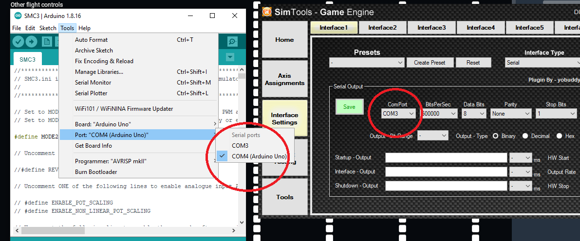

    Does these two ports needed to be same ?
  12. noorbeast
    21,907
    153,053Coins
    +11,117 / 56 / -2
    Yes the ports do need to be the same, as Windows assigns the port to the Arduino and any program that needs to use it needs to know what port it is on.

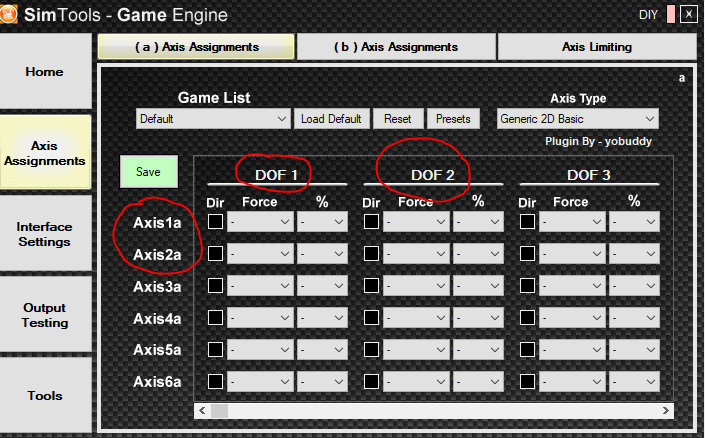

    I have read and watched simtools guide from the following links
    https://www.xsimulator.net/simtools-complete-documentation/
    https://www.xsimulator.net/community/threads/xplane-11-setup-guide-simtools.11087/
    But still unable to understand about the axis assignment in simtools game engine. So far I only knewt hat for my 2 dof I have to use 1dof and 2 dof column. And axis 1a and axis 2a represents the motion caused by the motor in certain axis(pitch or roll). I knew I have to use Extra 1 and Extra 2 for my 2dof flight simulator. But I don't understand how to assign extra 1 and extra 2 to the axis1 and axis 2 in 1dof and 2dof column
    21,907

    Looking at your LIMITS.. the red and orange line,, Right now the POT reading (green) appears to have exceeded the Red limit line.. When that happens, my motors shut off. If you can move the green line (you dont need the motors on for it, just connection to arduino and SMC3. the green line (pot reading) must be residing within the clip and max limits.. (orange or red lines).. DMAX

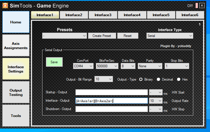

    I am using these settings but motors are just producing a humming sound and not moving . What is the issue

    Just checking, all SMC3 issues must be resolved and SMC3 properly configured and working as expected before meeting with SimTools. So are are all SMC3 issue resolved and is it properly configured?
    Once SMC3 is sorted SimTools should be tested with a properly configured Default profile in Output Testing, before messing with any plugin.
    This is what SimTools expects in terms of configuration: https://www.xsimulator.net/community/faq/which-way-to-set-simtool-axis-movements.230/
    After that a game can be patched for motion and a motion profile configured for it in Axis Assignments, see the Tuning Tips in the FAQs: https://www.xsimulator.net/community/faq/steps-to-create-a-motion-profile.228/
    Also grab the SimTools manual and keep it handy for reference: https://www.xsimulator.net/community/faq/rtfm-start-with-the-official-simtools-documentation.117/

    I have rechecked the smc3 and its working fine. But on simtools they are producing a humming sound and not moving. there is no interface issue as arduino led turns on when I turn on the output testing mode on
  20. noorbeast
    21,907
    153,053Coins
    +11,117 / 56 / -2
    If SMC3 is properly configured and is working as expected have you setup a Default profile in Axis Assignments and checked it in Output Testing?
