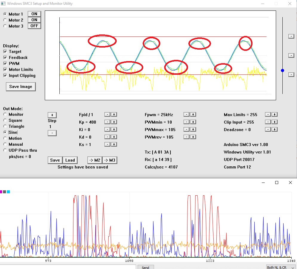

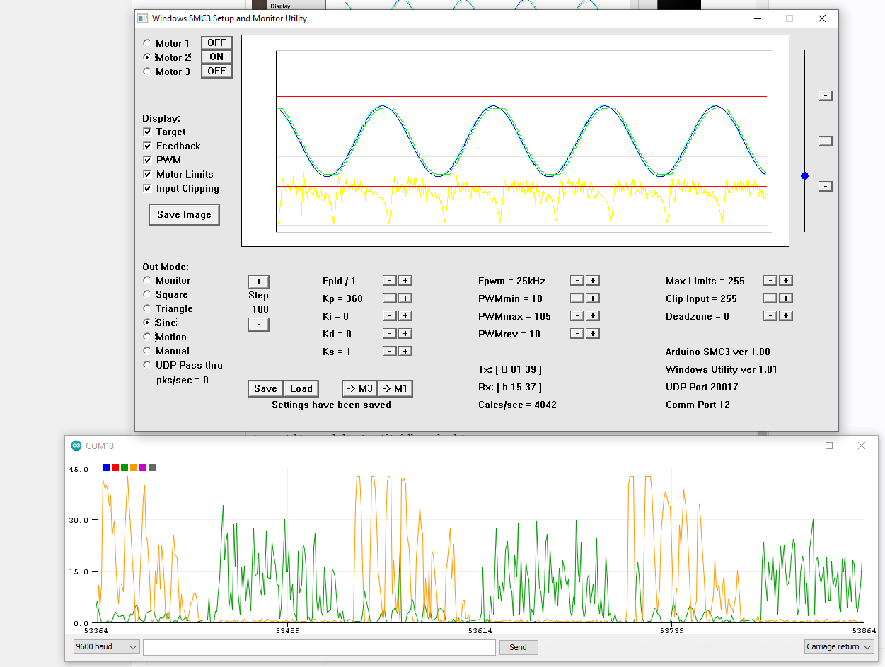

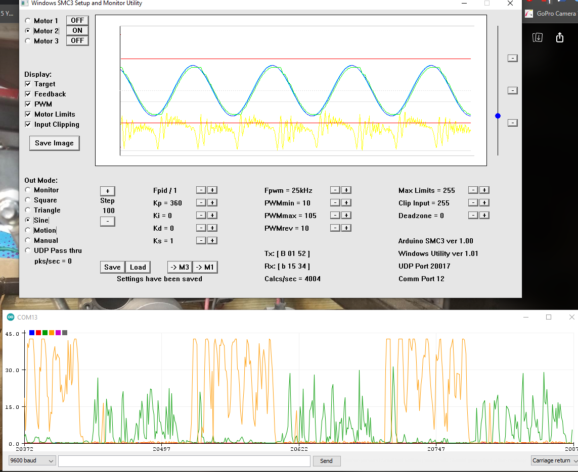

    I spent some time working on my set up tonight, after migrating to hall effect sensors and I'm still having some issues.
    My motors are Jazzy style wheel chair motors. The brand seems to be Quantum Rehab. They have a part number of 64-006-002. There is also a Pride Part No. of DRVASMB7110010. They have a continuous power of 350 watts (24v x 14.583A, right?) and a peak power of 1,250 watts (24V x 52.083A). They actually list a voltage of 22.5V
    My control box uses as many as 4 cheap 24v 15A power supplies. I've spent most of my testing before tonight using only 2 power supplies, all of which are bussed together in parallel. Tonight at the end of my testing session I bumped it up to 3 supplies and seemed to have better results. I was having other electrical issues in the house while also working on these so I'm monitoring that as well.
    I'm also using the IBT-2/BTS7960 motor drivers, an Arduino Uno, and the latest SMC3 firmware. I havent done much in the way of tuning my PIDs but my motors will just sometimes shut down, unsure if this is due to too many amps being pulled through my drivers or due to momentum extending the motor arms beyond the digital limits as set by SMC3.
    I decided to grab another Arduino and use it more or less as a datalogger, and I wired two of its analog read pins to the current sensing outputs from one of my two motor drivers (initially set it up to read two analog signals, one for each driver, then realized that each driver has two current sense pins). Based on probing with a multimeter and reading the BTS7960 datasheet, it seems that the pin should output about 0.117V per amp, or roughly 5 volts for 42.5 amps, right near its 43 amp limit. While running sine wave or motion, it wasnt uncommon for the current to spike and hit max current, but only for an instant. I know when I sold RC cars for a living, our speed controls were rated in continuous current, with a peak current typically higher than that, same with our lipo batteries. For the price, I gotta believe that the IBT-2 actually has an undisclosed continuous current and a max peak of 43A. I plan on integrating this current sensing or maybe even shunt resistor current sensing into the finished control box, outputting to an LCD or a 7 segment LCD set.
    I've got a bit of a deadline I'd like to meet and some folks had mentioned other motor drivers. I feel like lots of folks have great luck with the BTS7960s but I'm guessing they're maybe pushing less aggressive motors? And so, I'm left wondering whether I should keep trying these, try to find a reliable source on some good ones or try and find a different, more reliable driver altogether.

    I think it likely helpful if you give some further details.

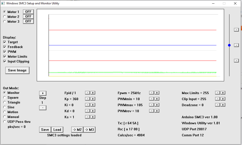

    Can you please post pictures of all of your SMC3 settings, say for a sine wave.
    What are the exact specifications and a link to the PSUs you are using?
    Try and determine why it shuts off, is it a USB disconnect (usually sound notification), PSU shutdown (check if PSU running), control board or motors over heating, or out of range?
    If you swap hardware side to side does a problem follow?

    At least once tonight during my testing, the output of the one motor I was pulling current info on pegged at 5V, which I dont think is actually a constant 43A but instead a diagnostic indicator. I'll see if I can find the datasheet I was reading, and see if it has a truth table. I know only one of the two sides of the h-bridge was pegged, and it was the side that is tasked with pushing my seat "up", ie, never has the assistance of gravity pulling anything down.
    At least once tonight as well, I had an instance wherein that same motor was extended beyond my preferred range, surely beyond my software limits.
    With respect to SMC3, its a bit late at night right now for me to power things up and not wake roommates but I can show you my PIDs and all other settings. Ignore the buzziness of the green line, my pots arent actually hooked up right now and I assume thats just the ambient ADC noise without any pull ups or pull downs.

    Please run a Sine and square in Out Mode of SMC3 and post the results.
    On the face of it I would have expected PWMrev closer in value to PWMmax, and refined Max Limits and Clip Inputs, see the SMC3 setting explanations here: https://www.xsimulator.net/communit...driver-and-windows-utilities.4957/#post-48121
    I am also interested in why it shuts off, is it a USB disconnect (usually sound notification), PSU shutdown (check if PSU running), control board or motors over heating, or out of range?

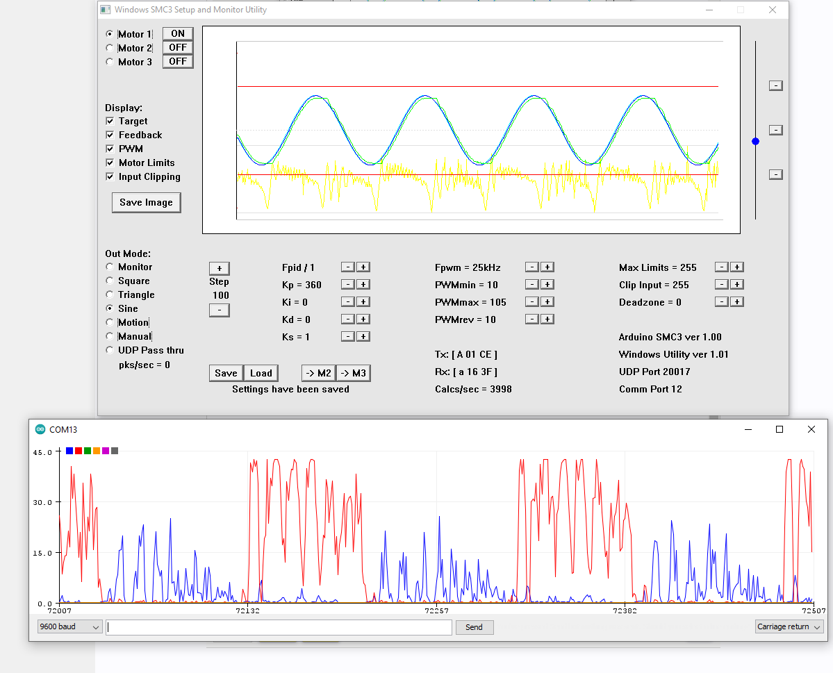

    Ok, just got off work, starting to produce images requested.
    (Long post incoming, I dont want to get flagged at all for spamming)
    Some photos of my rig, its an unashamed near-clone of the original DOF Reality H2/P2 design.

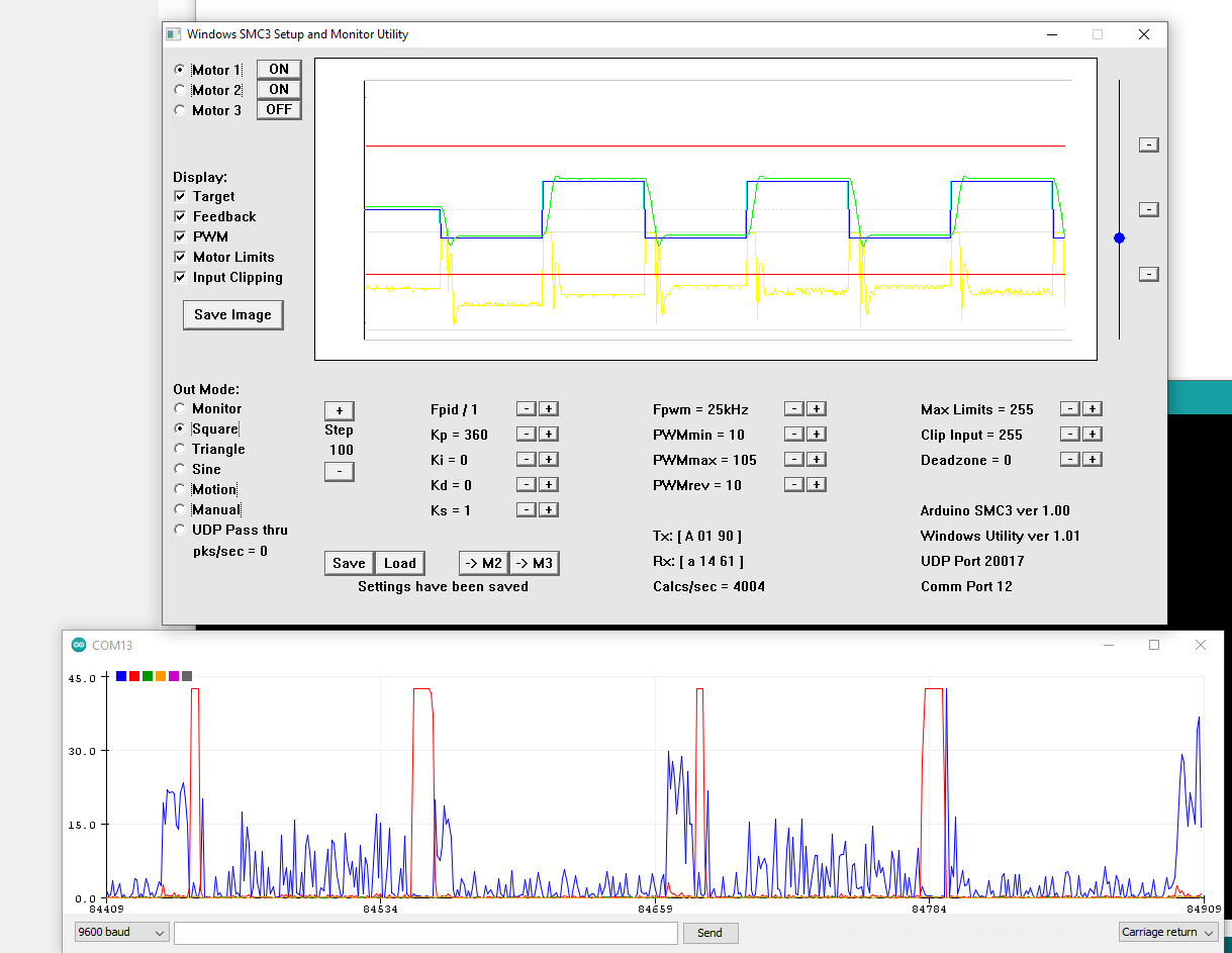

    First test of the evening, hooked everything up, ran sine wave test on motor 1, within the second full waveform the thing flatlined.
    Note that the COM13 graph below is not scaled horizontally to match the graph in SMC3, and its still a prototype sketch on that arduino, and therefore its accuracy is still questionable. Whats important to note is that the reddish color is the amps drawn while pushing that side of the simulator upwards, and that it pegged the same time the motor stopped responding. Note that SMC3 still has the motor as "on" so it hasnt exceeded any limits that would warrant a shutoff.

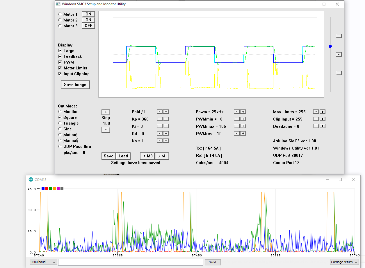

    https://youtube.com/shorts/9V737wDXwzk
    Note no real issues. Orange line represents the upwards direction on this bottom graph, green represents the downward direction.
    It also seems like I almost always have issues with motor #1's control, I feel like the one I replaced a few weeks ago was also motor #1, and so now I'll go ahead and swap them to see if the problem follows the motor (potential internal short) or if it follows the driver.

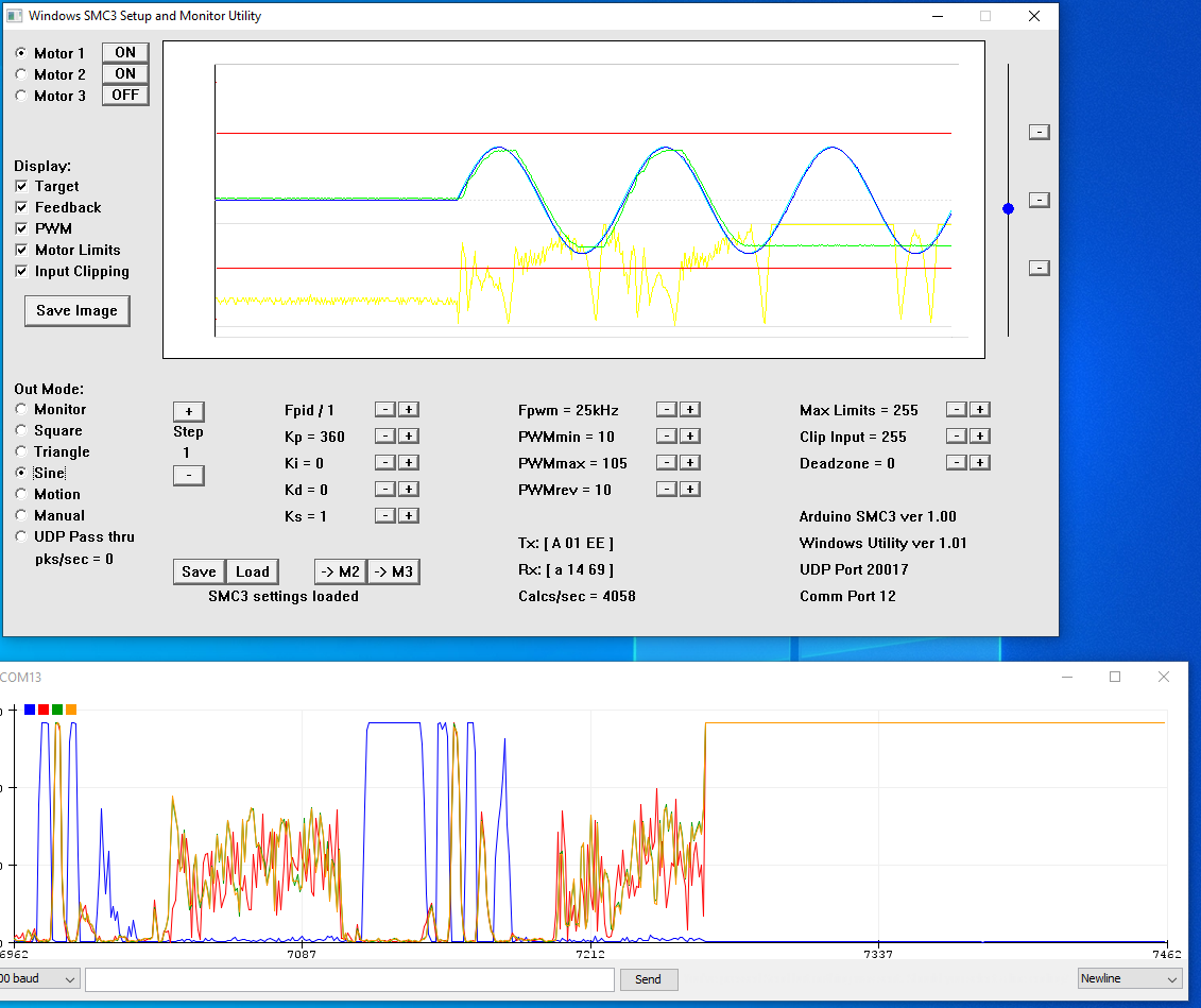

    Motor 1 test on Motor 2 driver
    This wasnt wholly scientific. I swapped motor and pot wires between the two sides and ran the test on Manual mode first just to make sure polarity was fine. Found that when centered, my Motor 1 was a bit high, and so when I started pushing it even higher, it would near this point in the arm rotation where I believe it was reaching an imposed mechanical limit. I recentered the pot and ran the test again, as seen above, with no issue. I will say however that the motor arm will hit the steel structure on the bottom of the travel before hit hits the red Max Limit/Clip Input lines above, which I believe means that the game may try to push the hardware beyond its physical limits. I'm thinking of maybe shortening my connecting rod a little bit and moving my "center" position on the motor a little higher (currently set at 9'oclock, maybe move it to 9:30 or 15 degrees above horizontal). I could also maybe alter the potentiometer code a little bit so as to "expand" the range of it to get it to effectively hit those limits.
    But that leaves the question of motor driver 1 on motor driver 2:
    It would seem rather foolishly that my issue was related to my centering, as I've been able to run Motor 1 on Motor 2's driver and Motor 2 on Motor 1's driver no issue. I'm gonna revert these conditions, get motors 1 and 2 on their respective drivers.
    Square Wave Tests with motors back on correct drivers, motor 1:
    Motor 2:

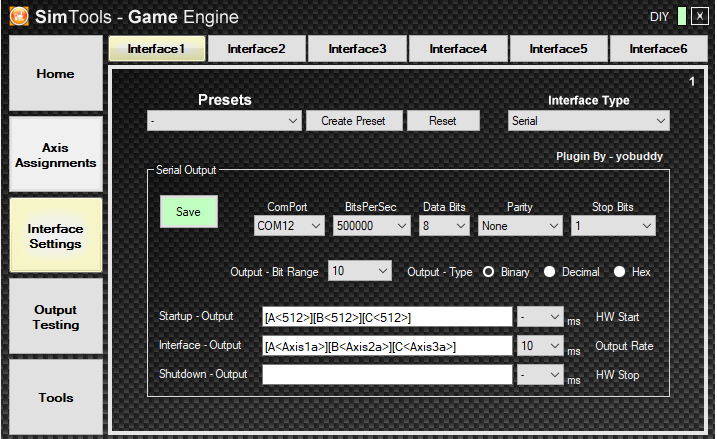

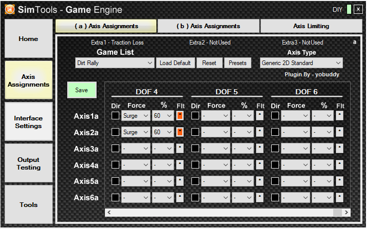

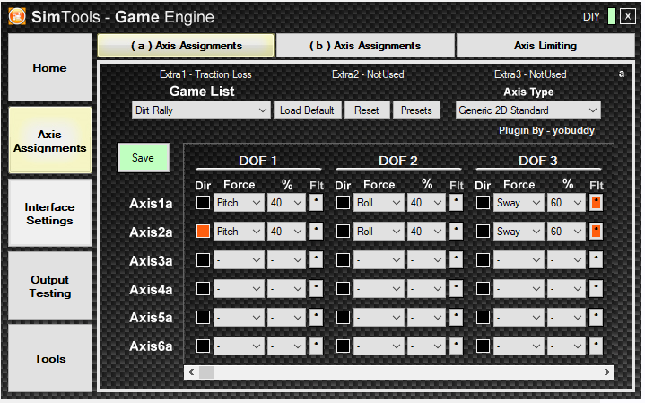

    Sim Tools Settings:

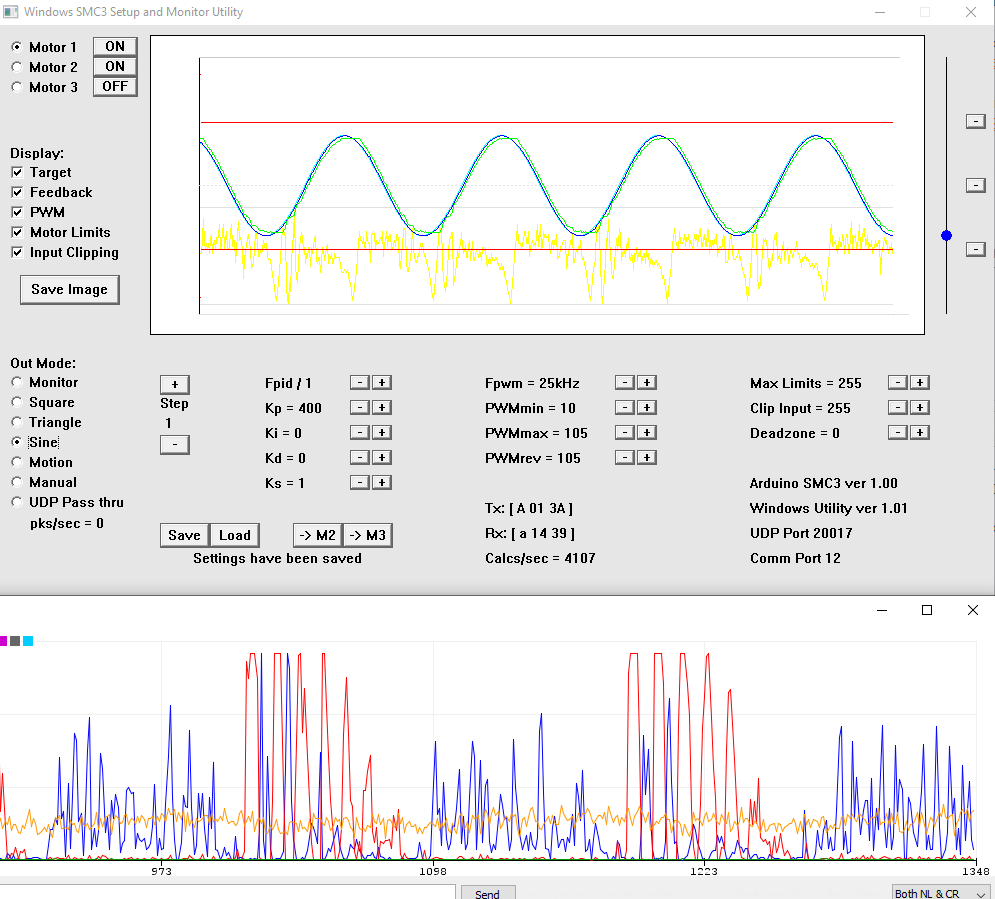

    Just some suggestions, just taking a stab try raising kp to 400, set PWMrev to the same value as PWMmax, lower Max Limits and Clip Input to set a sensible range.
    The effective utilisation of torque with a lever falls off dramatically over about 38-40 degrees up or down.
    SMC3 should be fully sorted before messing with SimTools.
    Everything should work in SimTools Output Testing before messing with a game.
    In SimTools your Axis Allocation should be around 100% total, yours is 200% which is way too high and will induce clipping: https://www.xsimulator.net/community/faq/axis-assignment-percentage-totals.120/
    Do not use filters until a base motion profile is dialed in properly, see the tuning tips here: https://www.xsimulator.net/community/faq/steps-to-create-a-motion-profile.228/

    Working on the Sim again today. Great information and I'm taking it all into account.
    I started by setting my Kp to 400 and set my PWMRev same as PWM Max.
    I went into my garage and grabbed the digital angle finder I use for my table saw blade. According to my current sensor output, "centered" is about 4.3 degrees down. I then zero'd the angle finder to test how far I swing the arm in either direction and yeah, its pretty close to 40 degrees in either direction. It hits roughly 35 degrees on the bottom end before it hits the frame.
    Updated Settings, Motor 1:
    Initial testing shows that my current seems to be coming down. The red line here is my downward direction, presumably spiking because of the extra PWMRev I dialed in. The Blue line represents pushing the rig up against the force of gravity.
    Already things are performing better but I need to do more reading on tuning SimTools still. Unsure when I'll be at a point in SMC3 tools to move on though. Ie, when are things "sorted out"?

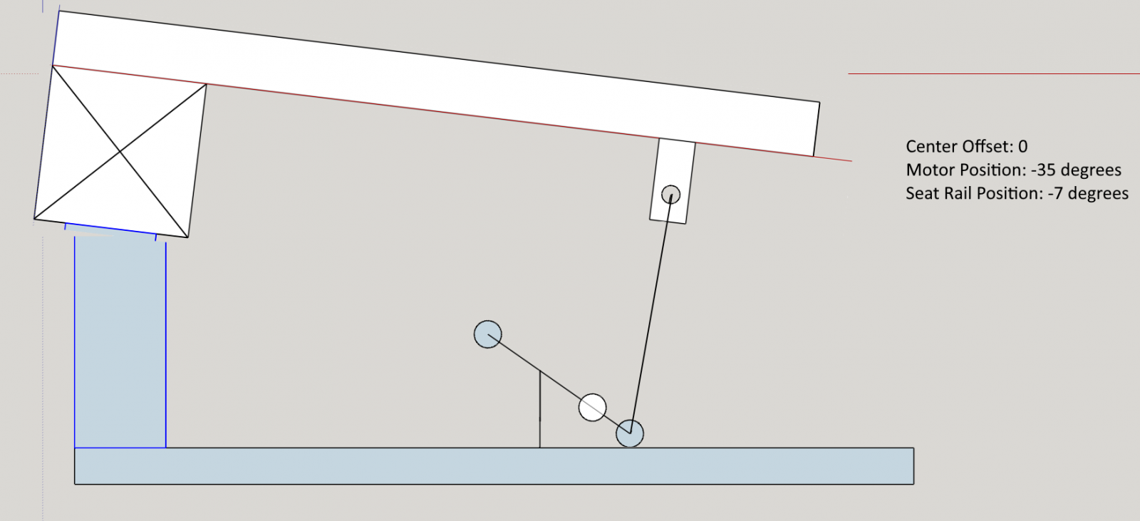

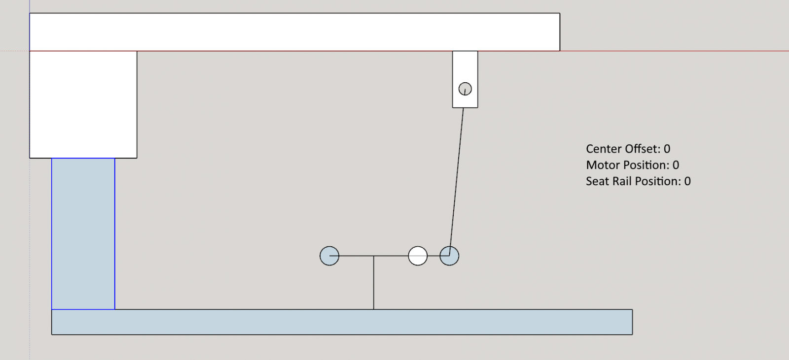

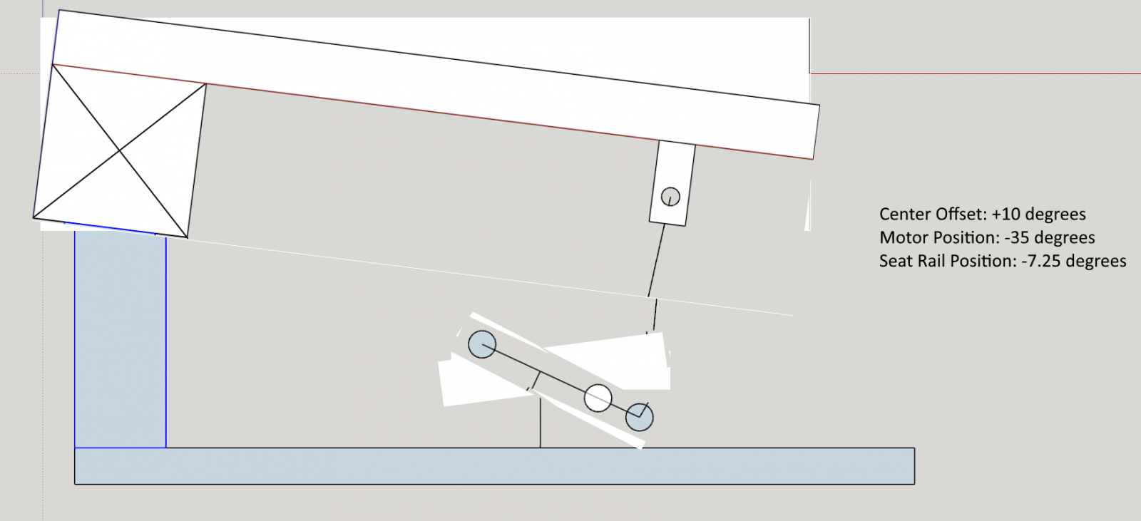

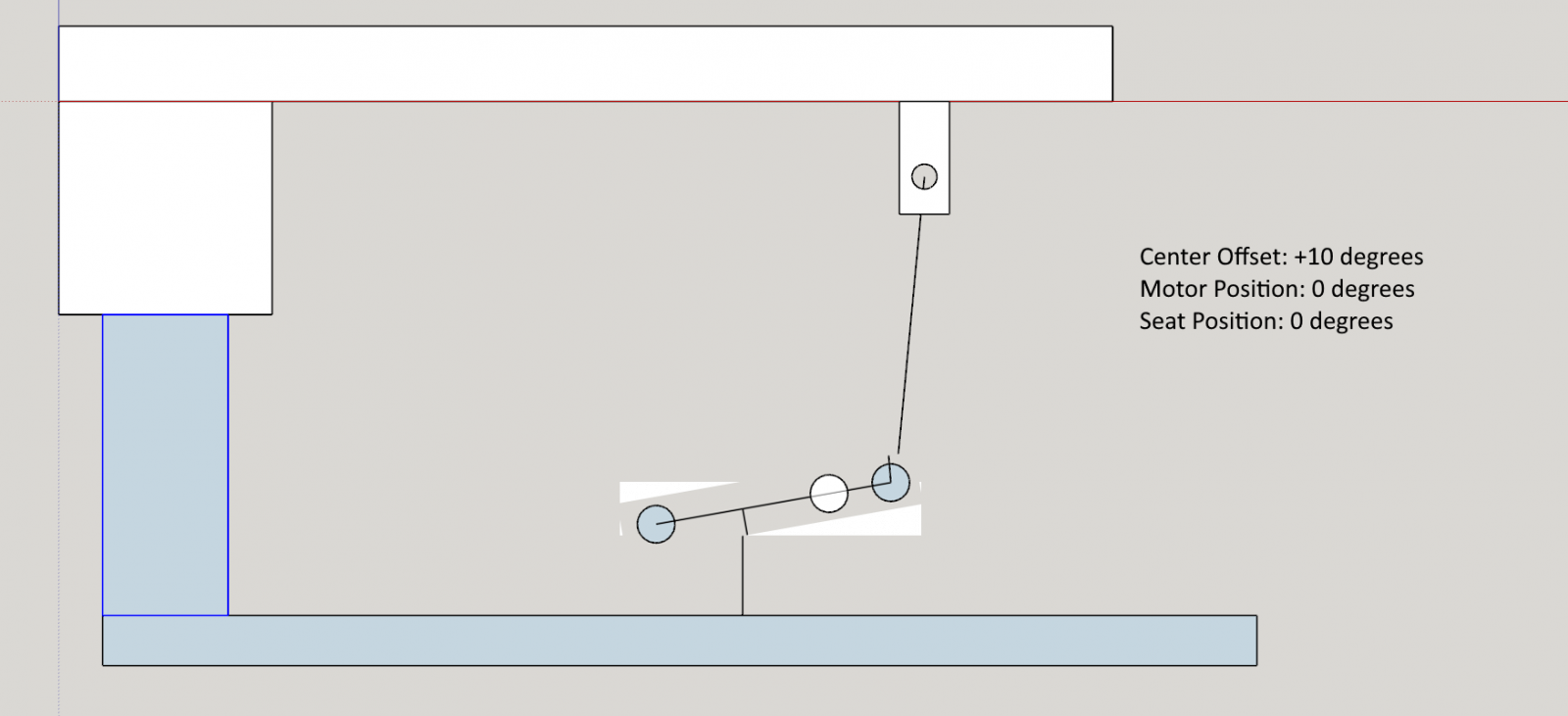

    I did some quick math to figure out if I could bypass my problem with hitting my chassis rail by cutting my tie rods shorter and making my motor arms centered a bit higher, ie, offset the center of the motor arm by x degrees.
    I quickly modeled all the important bits of this calculation in a profile view in Sketchup. My motor arm point to point is about 6.25"
    I then screencapped this and put it into Paint.Net because I dont know how if at all this simulation can be done in sketchup easily, with moving parts and pivot points, etc. Note, the white square box in the upper left is my U joint

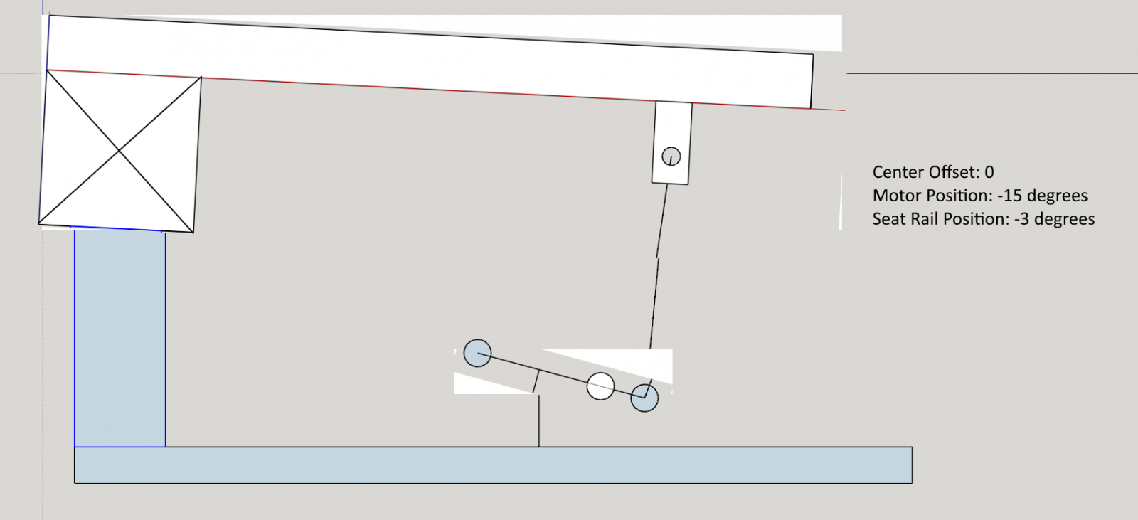

    I then moved the motor arm to -15 and -35 degrees, -35 being about where it would hit the chassis arm.
    I found that my simulator has about a 5:1 ratio of motor arm movement to seat rail movement. I cant recall what trig I would need to use to express this as a complete formula, but that doesnt matter at the moment.
    I then decided to see what would happen if I offset the center position of my motor arm by +10 degrees:
    The resulting linkage would be shorter by about 3/4" of an inch. Next, I simulated it again for -35 degrees from center position:
    and I found that my seat rail moves just a fraction of a degree more because of this. I have some spare threaded rod and could cut shorter linkages but reducing by that little I would have a lot of thread left in my rod end and would just need to jam nut it, so I think I will do that today as well.

    Just some comments, to consider:
    Moving pedals rather than a seat often has less effect on the COG, as long as the pedals are not too heavy, you can use seat sliders to create adjustable sliders.
    Obviously the heavier a user the greater the effect on a COG. You are correct, a COG should be determined with the user and all peripherals on board.
    Honestly for random users the rig needs to be very robust, over engineered in fact, and where possible be adjustable for load. But refining a rig to do all that takes time, depending on the budget and the design you are working with.
    I have not used it for many years but you can control Sketchup models with SimTools: https://www.xsimulator.net/community/faq/how-to-animate-sketchup-3d-model-with-simtools.209/
