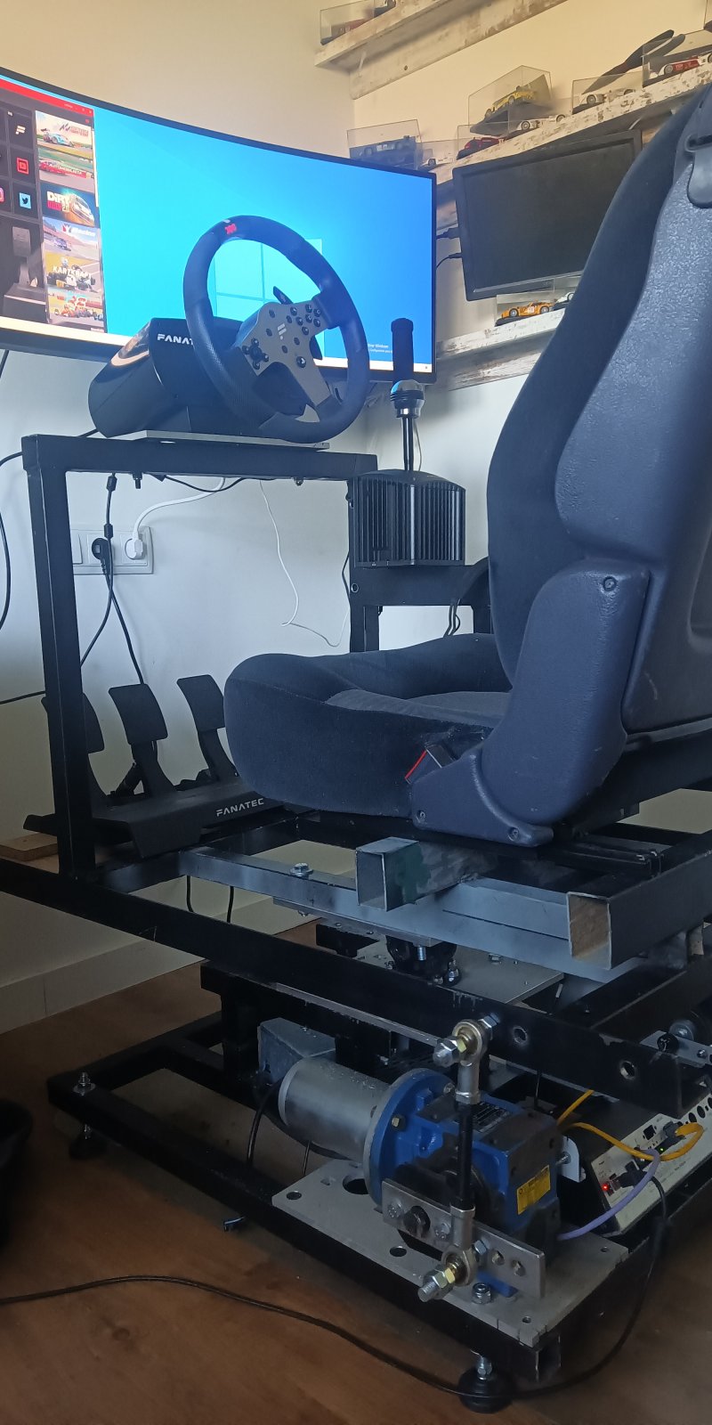

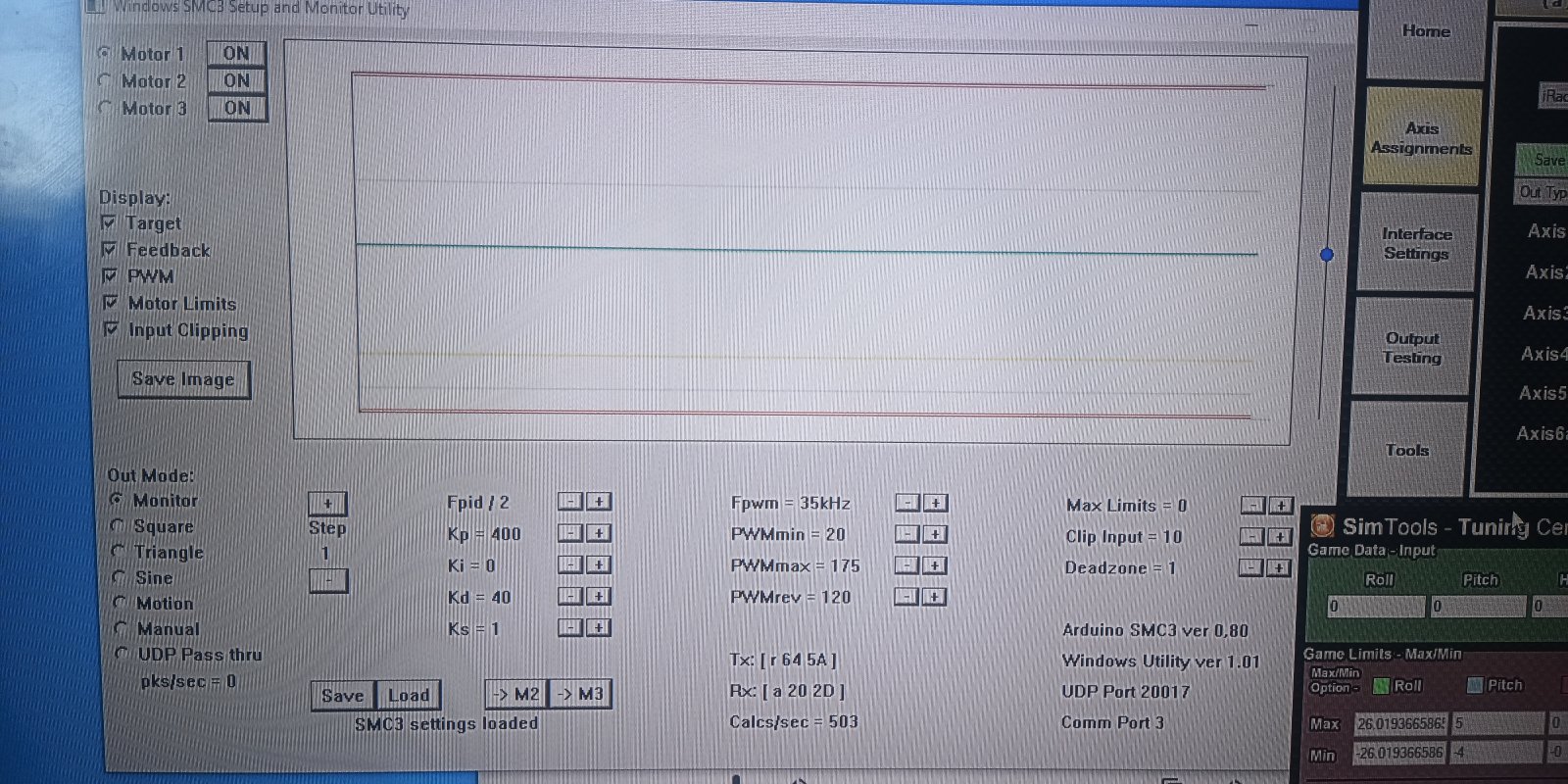

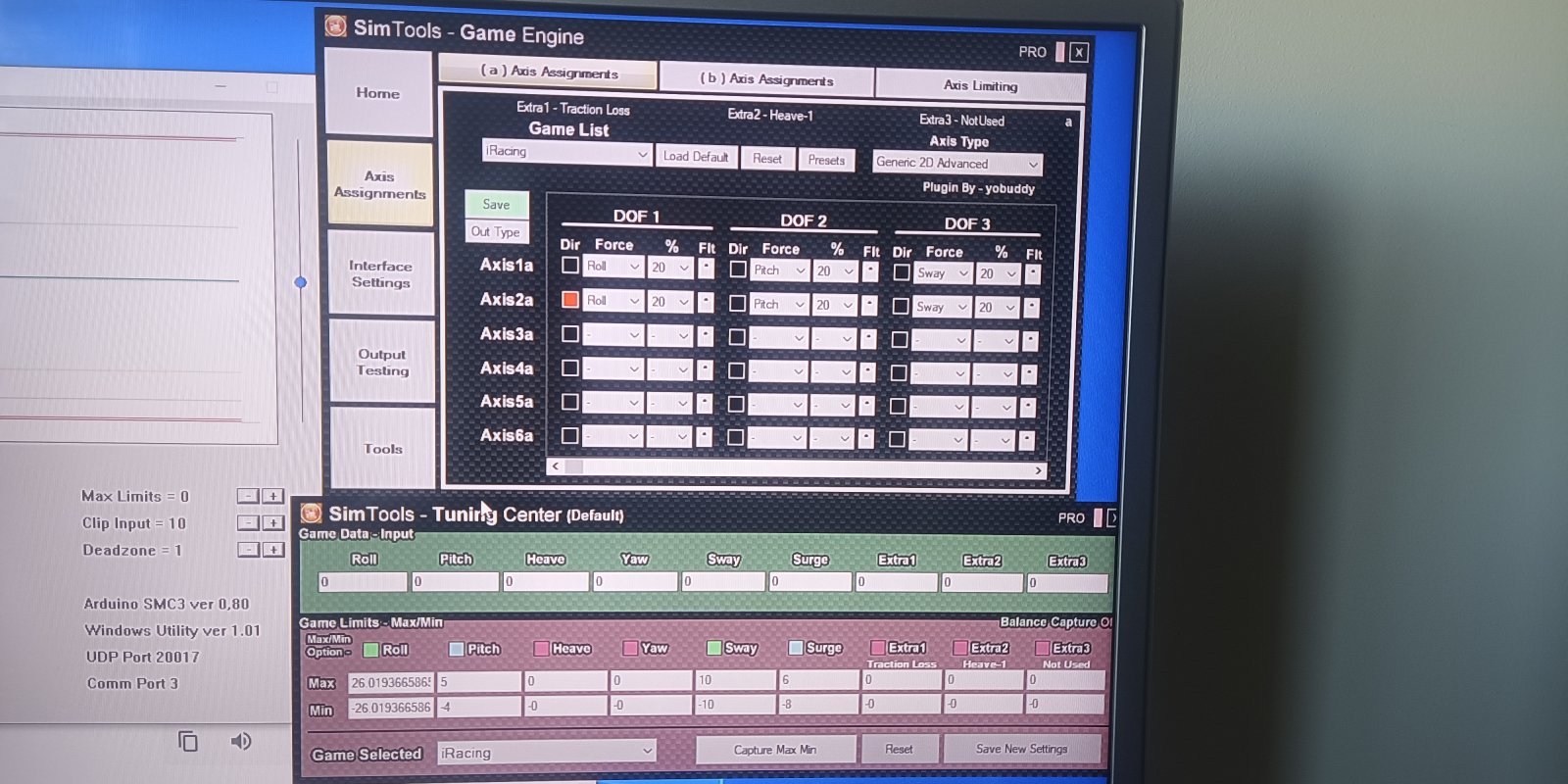

    Hi people. I am using Arduino with Sabertooth 2x60 with SCM3 codewith 2 motors of 24 v. I am configuring the sim but I have problems. Whith the Sway force generate some retroalimentation. I test some posibilities and the only way I find is in the tunning center, but if i down the movement in the tuning center of Sway force, i have only a bit of movement. I check some posibilities but I need help now D)

    Yes, i am using @BlazinH code. The test of smc works good in manual, triangle.... If only works the sway axis, i have the same problem. Only can have a bit of movement in tunning center before the motor are crazy

    You need to set your Clip and Max limits, then likely refine you settings in SMC3: https://www.xsimulator.net/communit...driver-and-windows-utilities.4957/#post-48121
    Clip Input Used to create a band at either limit of the target range beyond which any values sent to the SMC3 are clipped. In addition to this clipping, if the motor feedback does move beyond this range (typically through inertia), the SMC3 will attempt to brake the motors hard by driving them in reverse until they are back out of this limit zone. The value can be anything from 0-255 (however can’t be less than the current limit setting). Reverse braking is applied in the band between the Clip Input and the Max Limit settings. Reverse braking can be disabled - refer to PWMrev.
    Max Limits Used to create a band at either limit of the feedback range beyond which if the motors move (typically through inertia) the SMC3 will automatically shutdown the drivers and keep them disabled until reset. This is essentially a safety mechanism if something goes wrong. The value can be between 0-255 (however can’t be greater than the current clip setting).

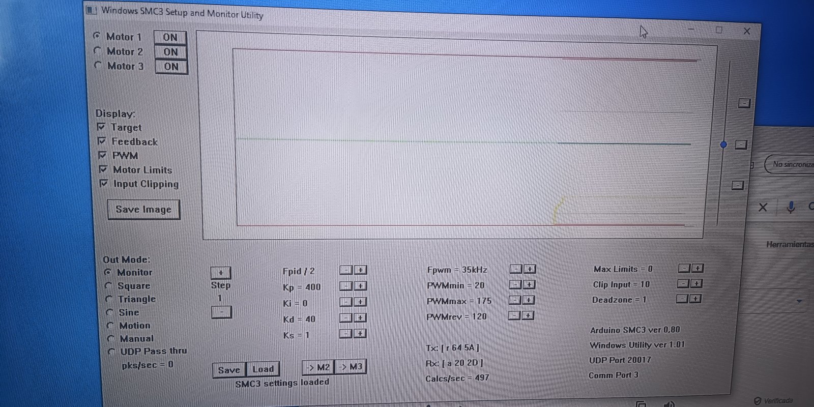

    I find the solution but don find a good movement of the sim. And I dont understand what is better when the motors tremble. I dont know if is needs up the limits, down the limits, up the clip input or down up the PWMmin, up the rev PWM or.....
    I try many posibilities but dont found....

    First follow the initial SMC3 setup steps:
    1. Set the Kp, Ki, Kd, PWMmin, PWMmax, PWMrev to 0 for ALL motors (This will make sure the motors don’t move)
    2. Set Clip to 255 (you need to do this first) and Limit to 255 (This will give you plenty of margin if something goes wrong while setting up)
    3. Turn on the power to your motors – nothing should move at this stage!
    4. Set Kp to about 400
    5. Now slowly, increase PWMmax… at some point the motor should start to move. When it does check the “Green” feedback line is moving toward the “Blue” target position.
    6. Do the above for each motor
    Then carefully read through the subsequent post of the link previously provided, which explains each of the tuning options: https://www.xsimulator.net/communit...driver-and-windows-utilities.4957/#post-48121

    Once SMC3 if properly configured you can move on to SimTools, first download the SimTools manual and keep it handy for reference: https://www.xsimulator.net/community/faq/rtfm-start-with-the-official-simtools-documentation.117/
    See the motion profile tuning tips here: https://www.xsimulator.net/community/faq/steps-to-create-a-motion-profile.228/

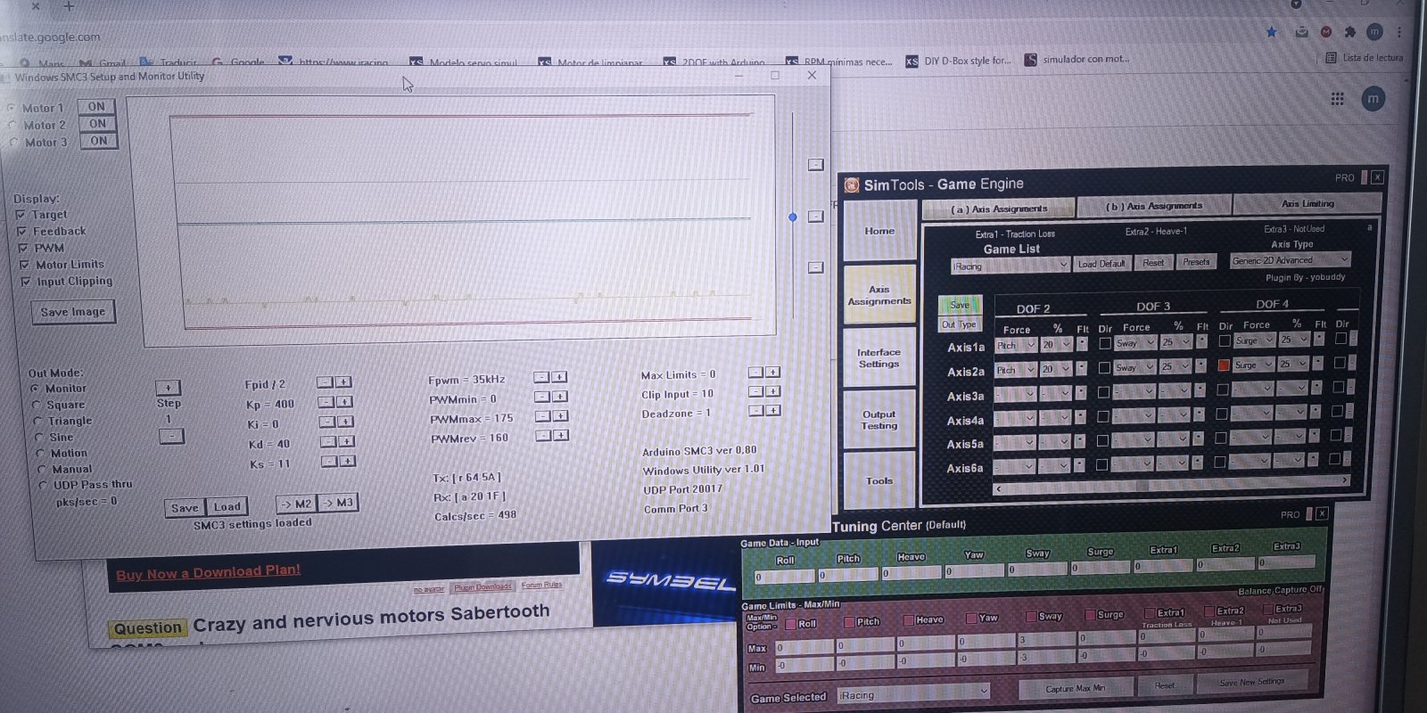

    ok boss. My SMC3 works correctly. I think all its ok but i drive 2 or 3 laps and start theproblem. Restart SMC3, touch in limits, clips, PWM depends the ocasion, go to drive and the problem starts before, or later... depends.... it´s difficult, I touch many things but dont found the solution. I have the manual in paper, I read many opinions about configurate the movement but its difficult....

    If your configuration is not adequate the motors can likely be pushed outside the control bounds, likely triggered by some spike event like hitting something or a crash.

    The SMC3 settings provide the control parameters, the settings can't be so aggressive that inputs can push past the limits set, see my previous post about understanding the SMC3 settings parameters and also the basics of PID: https://www.xsimulator.net/communit...otors-sabertooth-scm3-code.16430/#post-220078
    Your SimTools setting could well be exacerbating the lack of control via SMC3 settings. It is not a proper fix, but if the trigger is as it seems to be, spikes caused by a hit or crash, then lowering the Intensity Level in Profile Manager of Game Manager will likely lesson the likelihood of exceeding the SMC3 controls, as it effectively acts as a sort of global smoothing. But that is just masking the real issue, that your SMC3 plus SimTools settings need further refinement.
