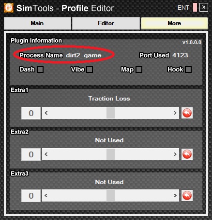

  1. yobuddy
    51,681Coins
    +5,204 / 19 / -0
    Turns out the trigger is already in this plugin. 2.0.0.3. :thumbs
    Although, there is another rally plugin floating around that does not support the oculus version of the game.
    And that is what the problem was here.

    Imo if would be good if valid .exe triggers are stated on the plugin's page too so people are aware ahead of time if their version works or not. It would save their time and ours. They would also know for sure which version to purchase if they haven't bought it yet.

  3. yobuddy
    51,681Coins
    +5,204 / 19 / -0
    All game triggers are listed on this page.
    If the plugin has multiple triggers, it will flip thru them all.
