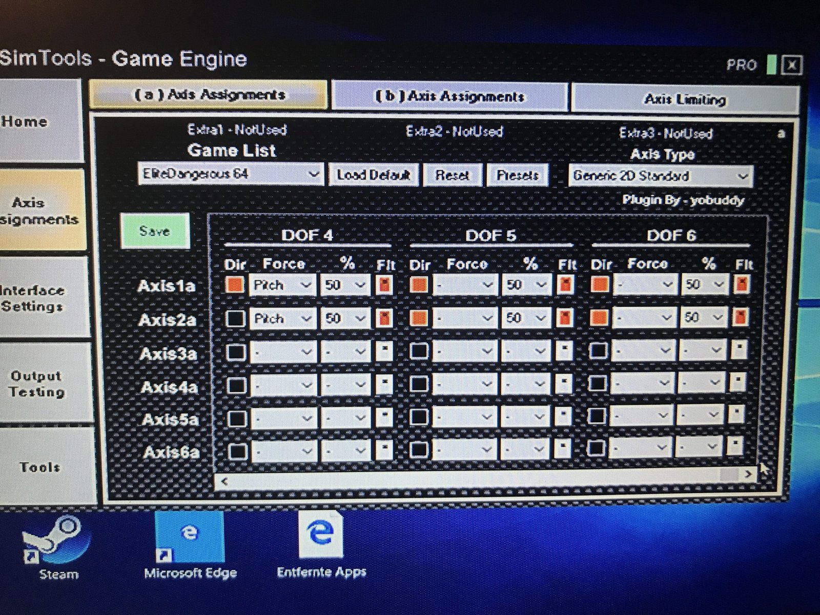

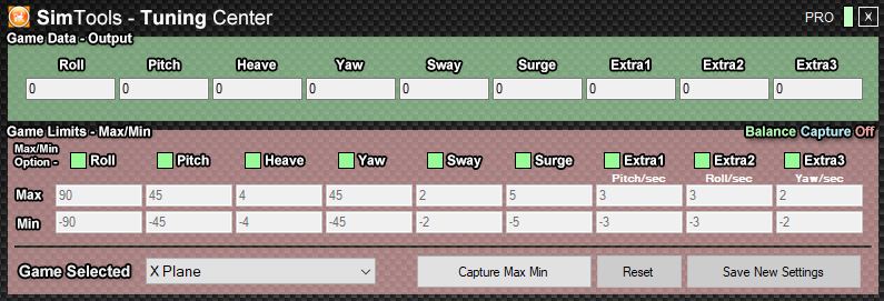

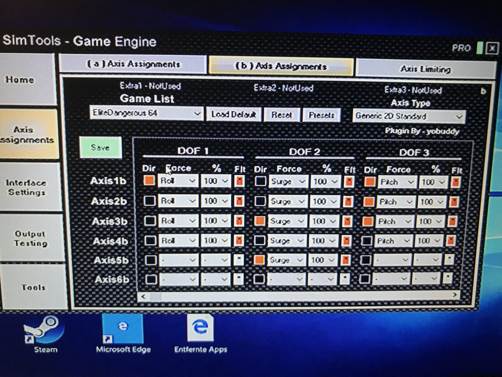

    Newest settings (H3/P3) for X-plane. Should also work for H2/P2 out of Extra3
    Unzip under C:\Users\<yourUser>\AppData\Local\SimTools\GameEngine\AxisAssignmentsPresets\Generic2DStandard_Presets\ and load it in the Game Engine under Axis Assignments. After that set the values in the tuning center according my screenshot.
    BR
    Fabian

    for the settings in the a-axis, the values are so high to check the effects of the individual movements.
    with the settings in the b-axis my g-seat servos are controlled. an override is not important.
