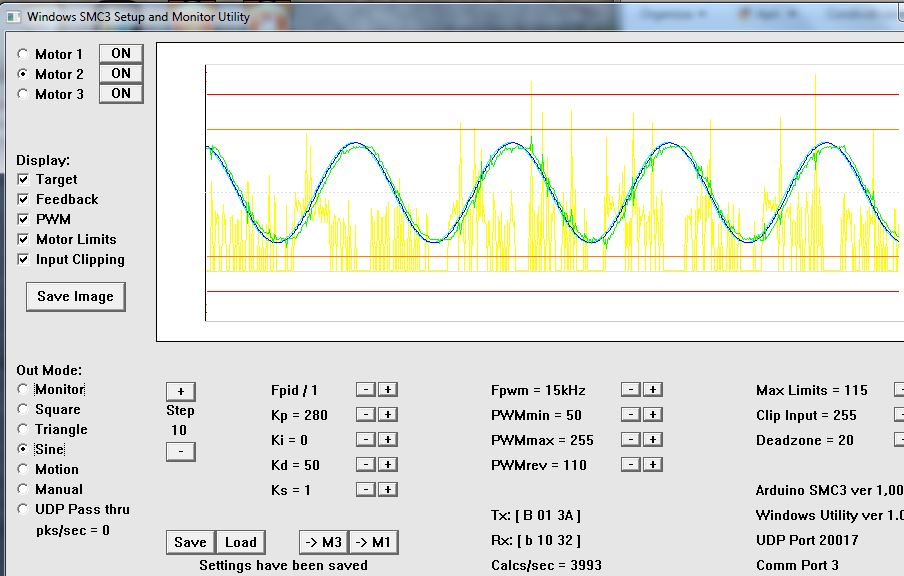

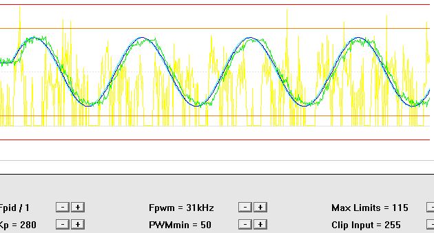

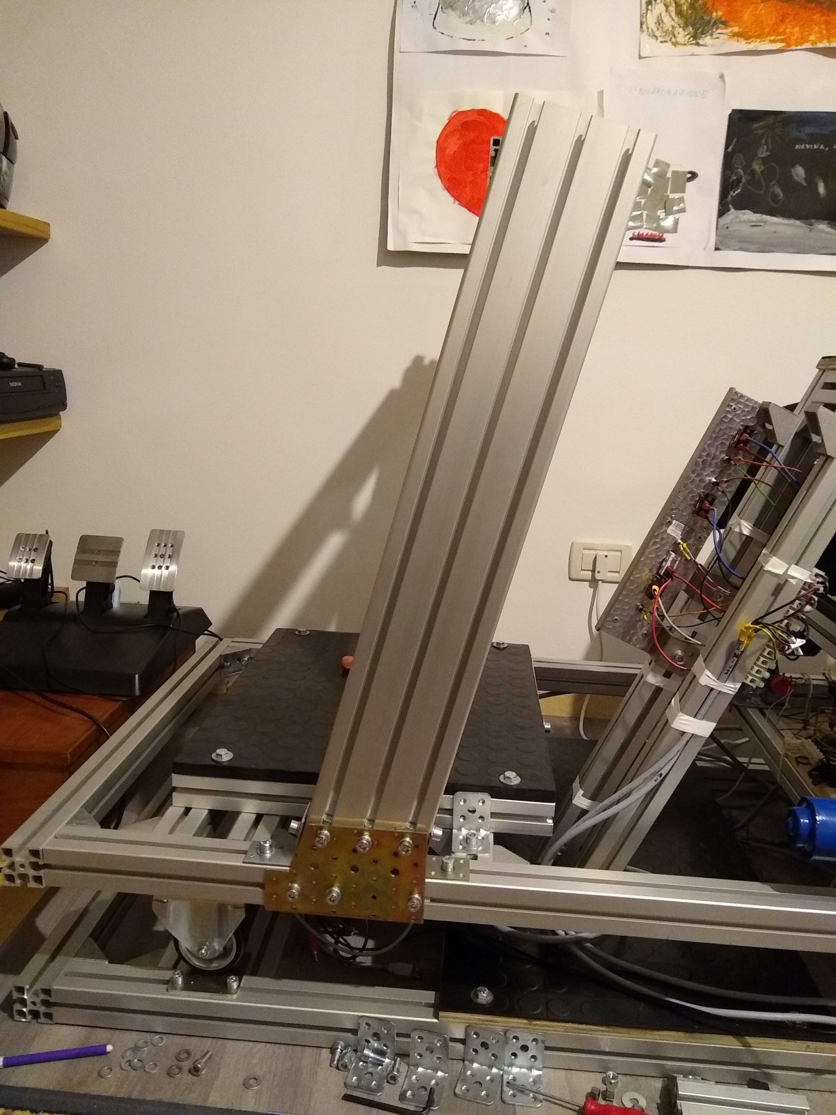

    I hope to go ahead with the work even if the engine bracket lingers.
    You see my greatest result in the attachment. I think the optimization that I am reaching in the exploitation of the wiper motor to such anointed is sensibly visible, that the sensation and the vision of the movements of the position I think are clearly improved. So much so that now I feel distinctly the roughness of the lawn and gravel, I also managed to bring 100% to the main editor, I think it is called so in simtools, while the axis limiting is 53%.
    The fact that makes me nervous is that the No. 2 engine is more difficult to optimize, I would like an opinion on the parameters set on SMC3.
    Thank you
    See you soon.

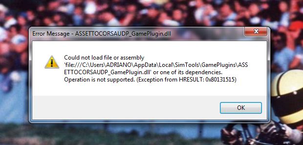

    I 've managed to improve the motor n°2 and the now it's very similar to motor n°1.

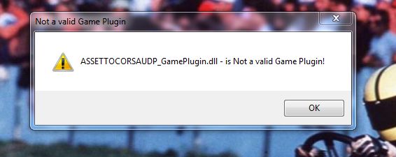

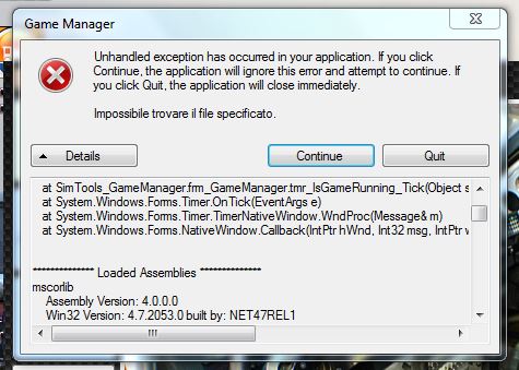

    Now, I bought the Assetto corsa game because I try to complete some other project, but above all becasue some mounth ago I download the plugin UDP to play with a PS4 and my dynamic playseat, like Project cars 2.
    Yesterday I try to connect the console and the palyseat with the UDP plugin but when I start the plugin by Game Manager main editor there's an error and the program crashes.
    Do Someone help me?
    Best Regards
    Francesco

    I think I downloaded the correct file.zip about the plugin UDP AC to PS4, the link is:
    https://www.xsimulator.net/community/marketplace/assetto-corsa-udp-consoles-manual-plugin-start.199/
    and in:
    https://www.xsimulator.net/community/threads/assetto-corsa-udp-consoles-manual-plugin-start.11101/
    There is a short instruction about the software setting, for example I need to write the console IP in file.xml.
    I hope it's correct, I try to start today, if I won't succes I try to download an AC upgrade in internet.
    In game option menu I don't find how I set the UDP, so I think I need download the AC upgrade; the same way I did for PC2.
    Best Regards

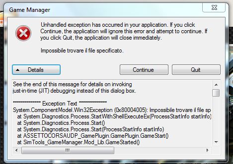

    I have some problems to use the plugin Assetto corsa UDP for PS4, see the attachments.
    I'd like to download the file another time, but I don't enable.
    May You help me?

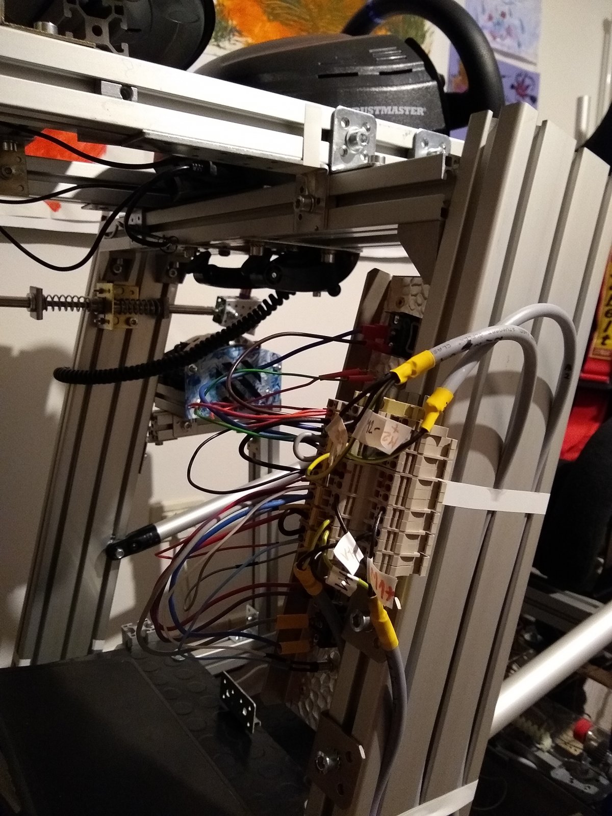

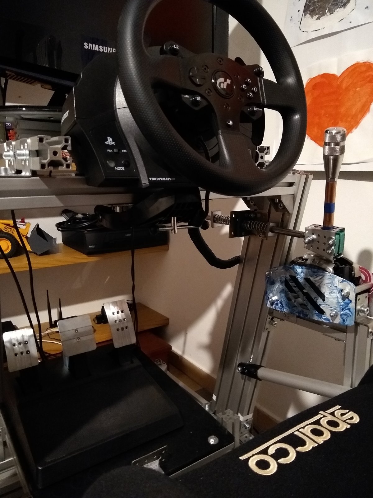

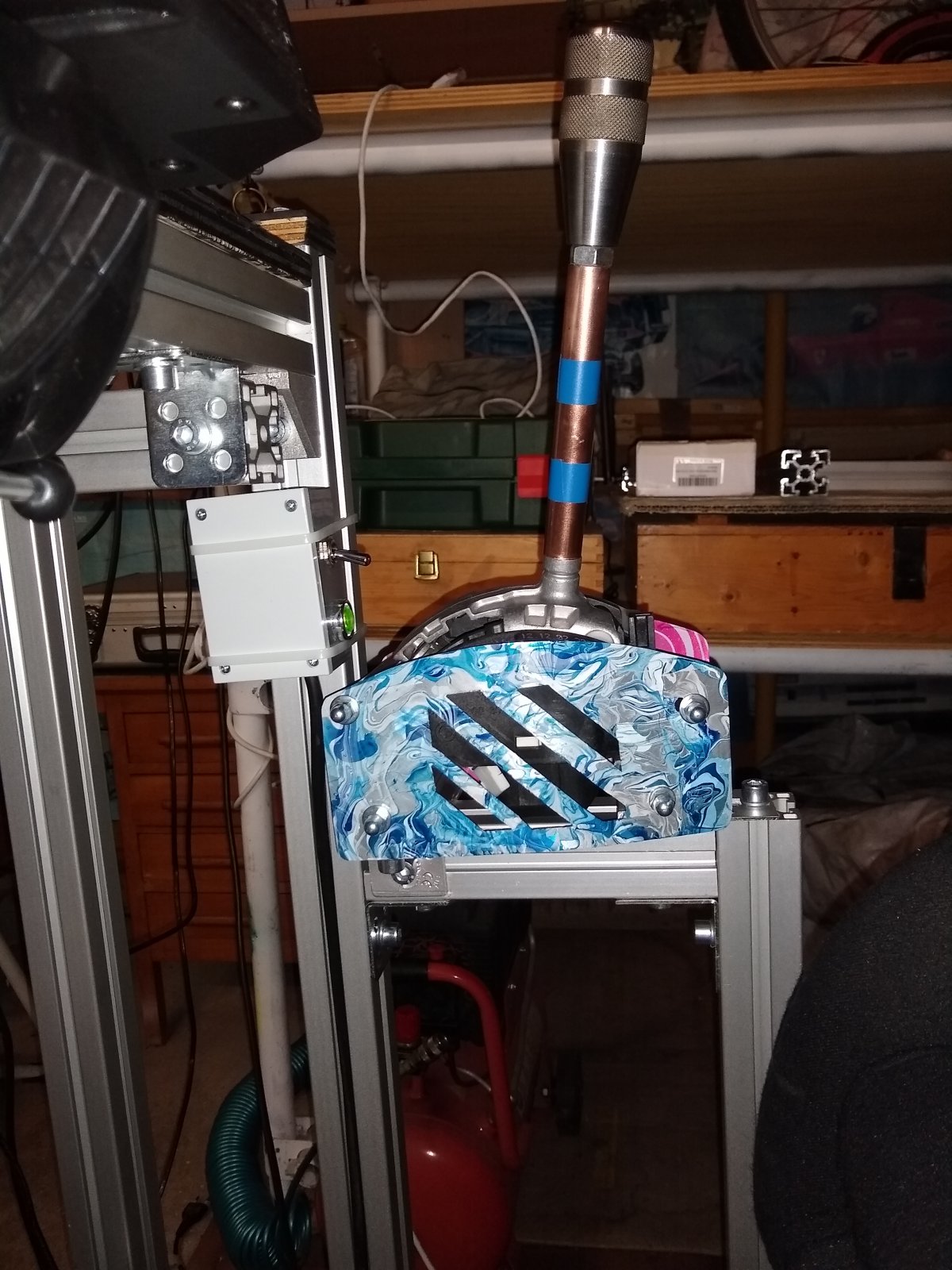

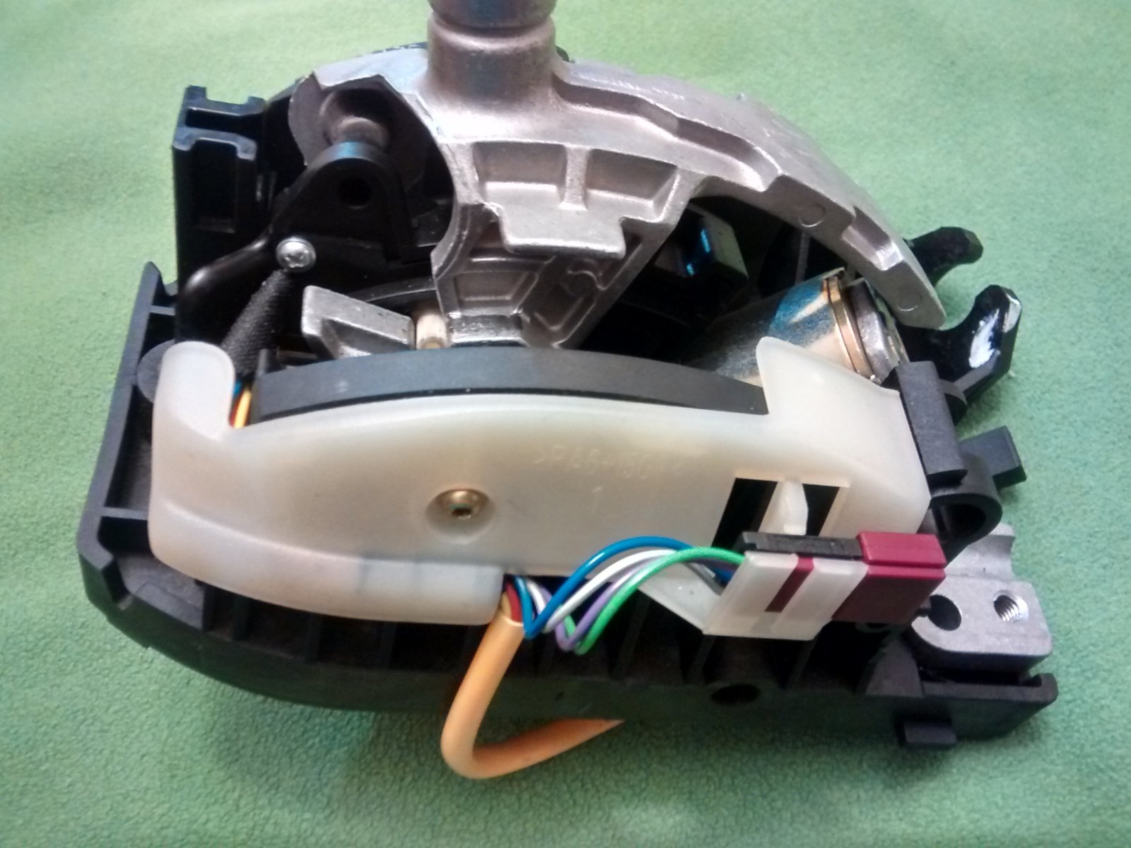

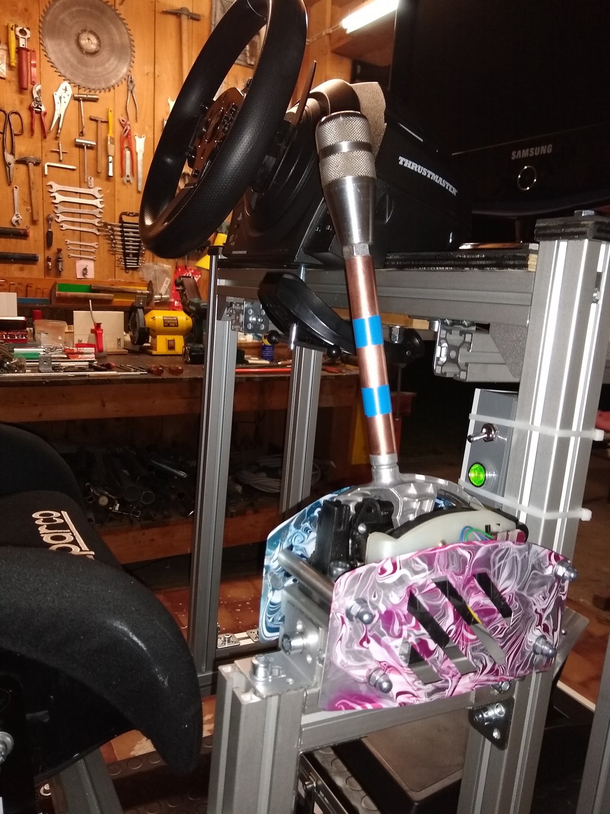

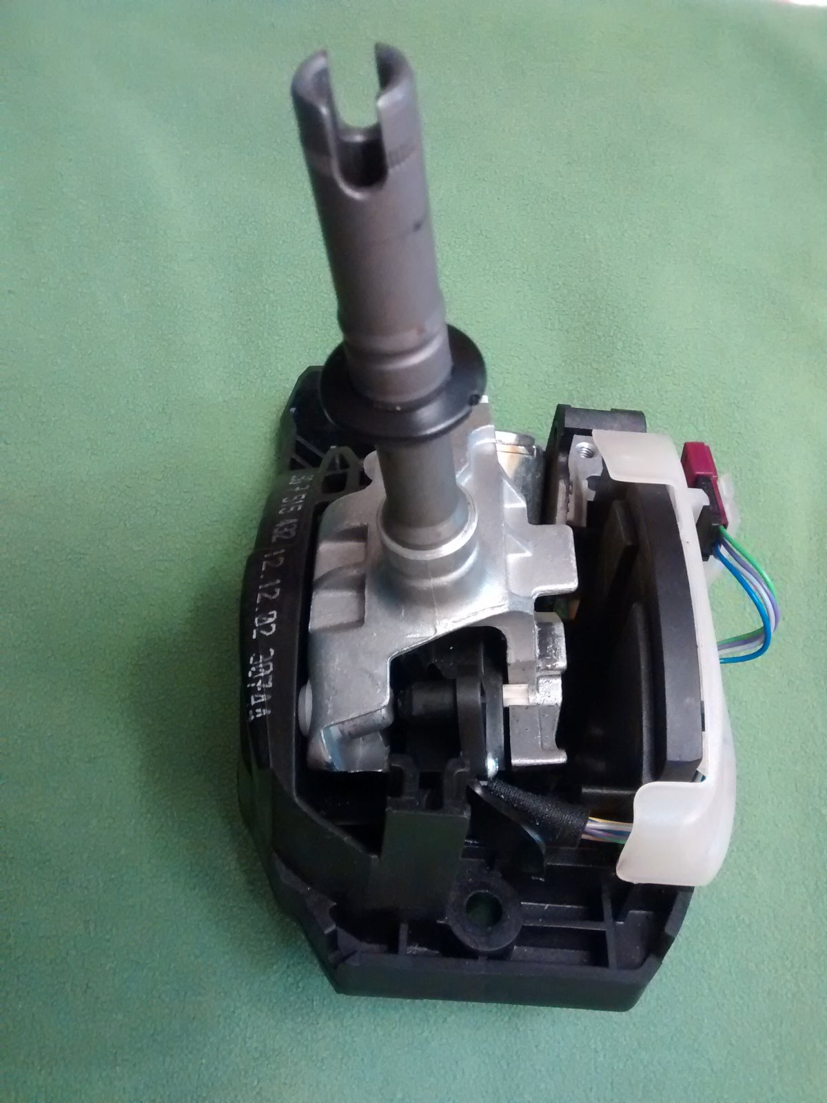

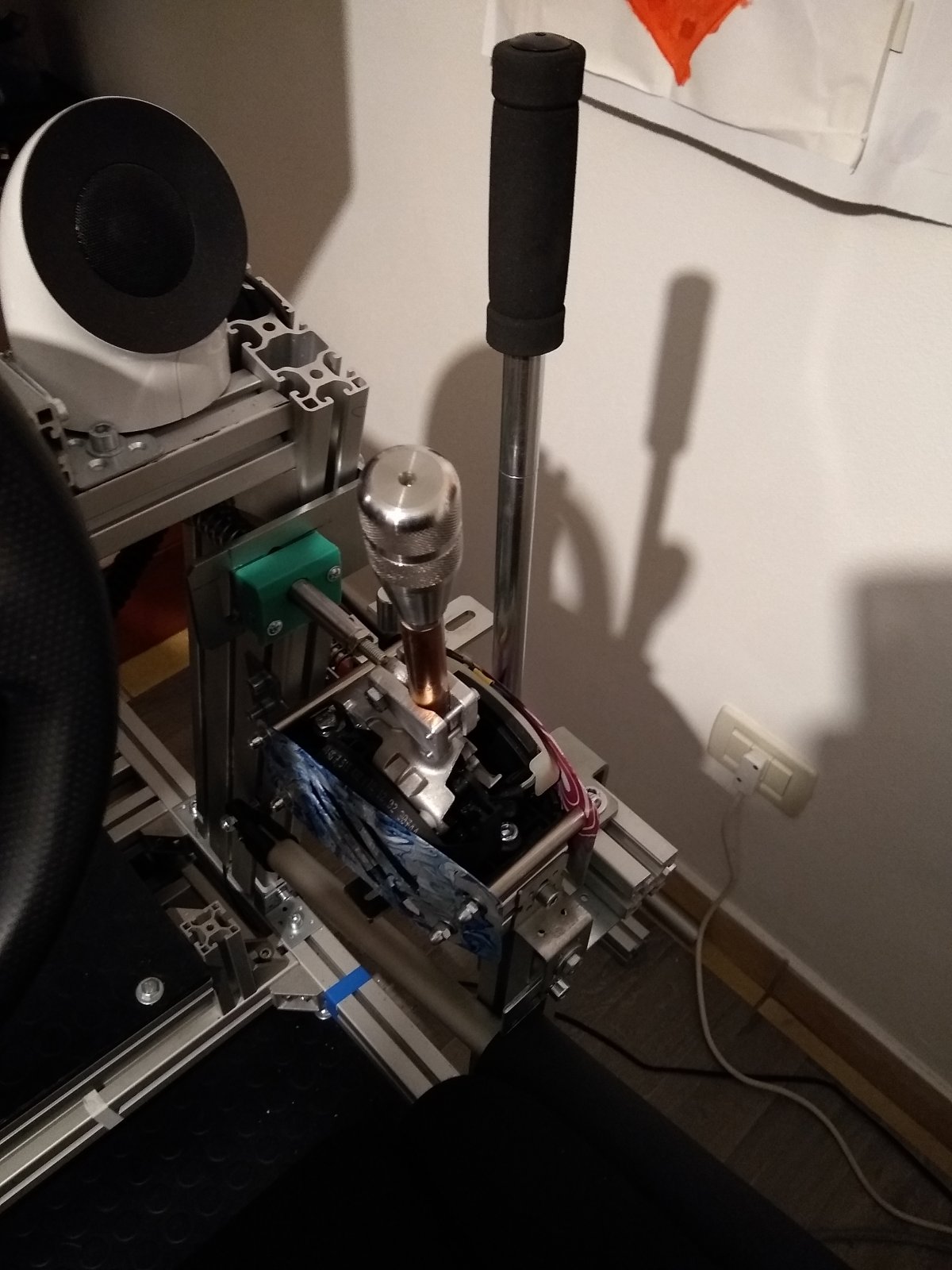

    Meanwhile the activities continues and finally I manage to install the third motor, wiper motor like the others, so the playseat , now, is 3 DOF.
    I try to find a solution about the motor 12 V, 190W with a gearbox 1:49, but this want a 80A corrent to start.
    Any tips?
    In the attachment you can find a video and some photos about the project, I like the colors about the sequential shifter carter, I make this with swirling technique.
    The mechanism is a BMW X5 sequential schifter.

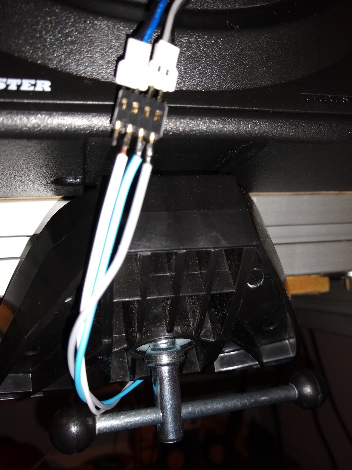

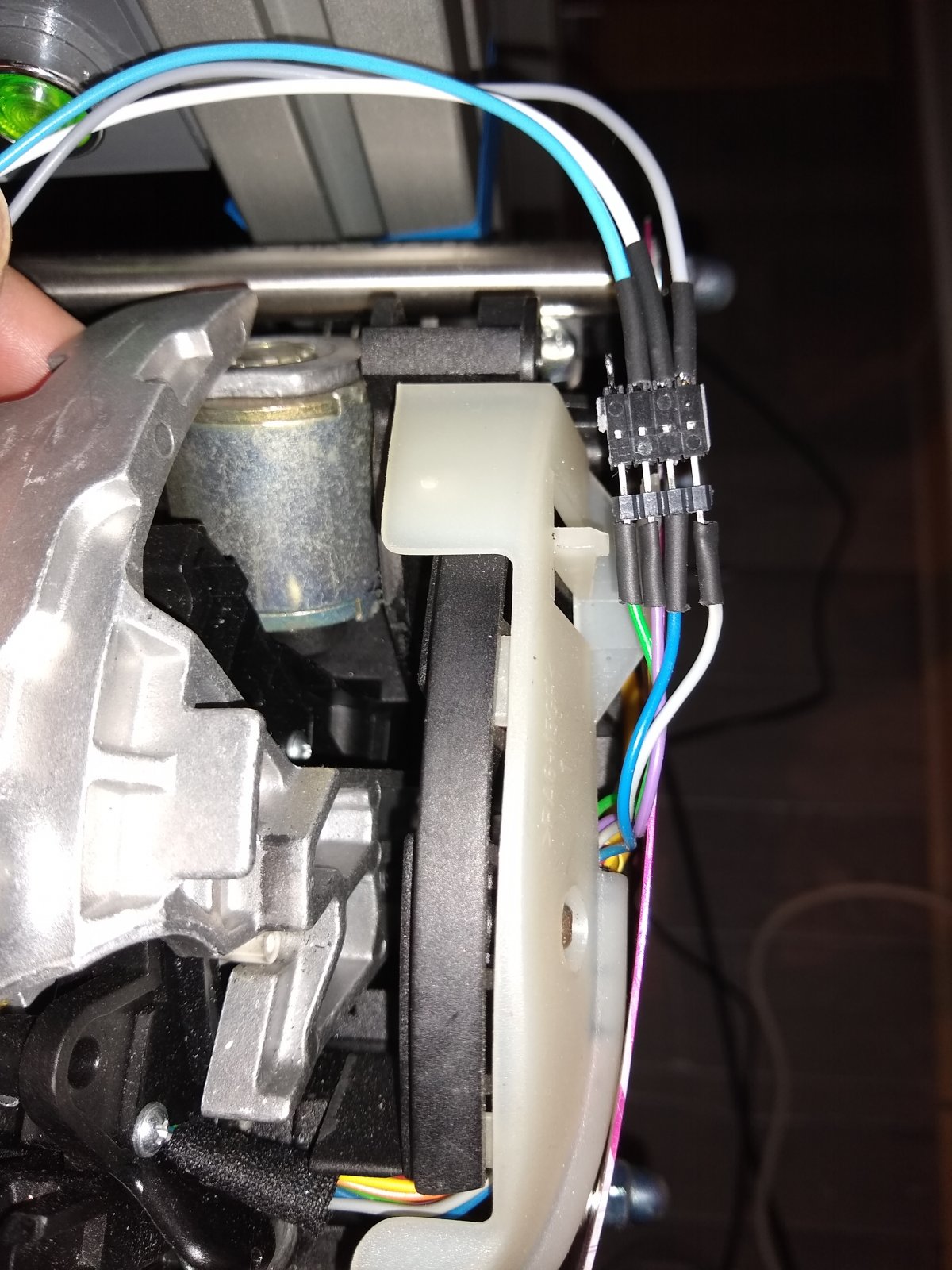

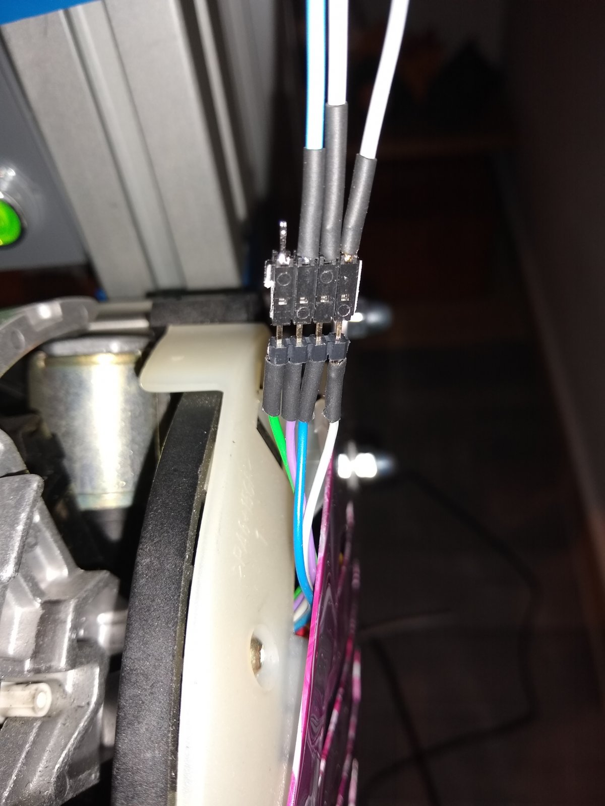

    I managed to find a solution I would say brilliant to command the sequential change dyi, as documenting I found that on the steering wheel T300 RS there were 4 wires two blacks, one blue and one gray separated by two connectors. Just remove the steering wheel, remove the crown behind this and with considerable surprise I found these threads held by a rubber band and unused. It was enough to understand with a tester what their function was and connect them to the corresponding wires on the mechanism of the steptronic gearbox purchased on the advice of Spyderwash.
    The solution is very little invasive compared to the excellent result on the functionality of gear shifting; without the levers behind the steering wheel being disabled.
    But above all without going to solder wires on the boards to use for example the keys L2 and R2

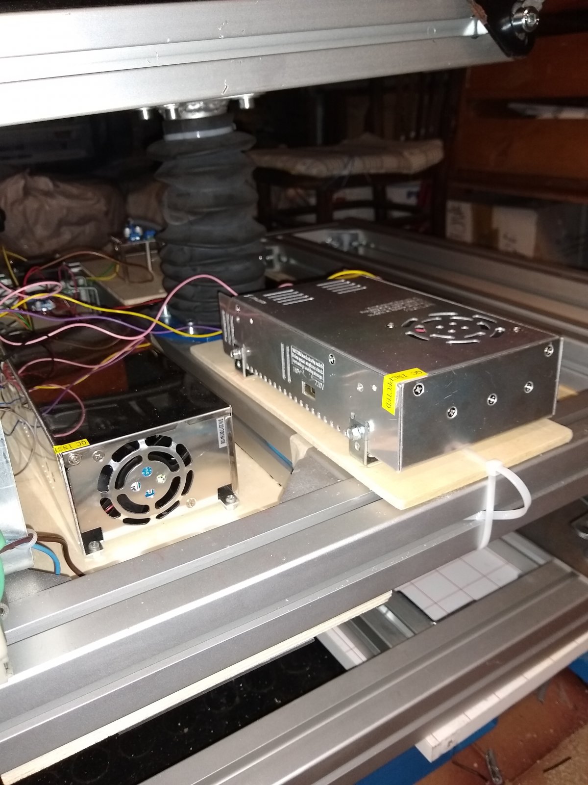

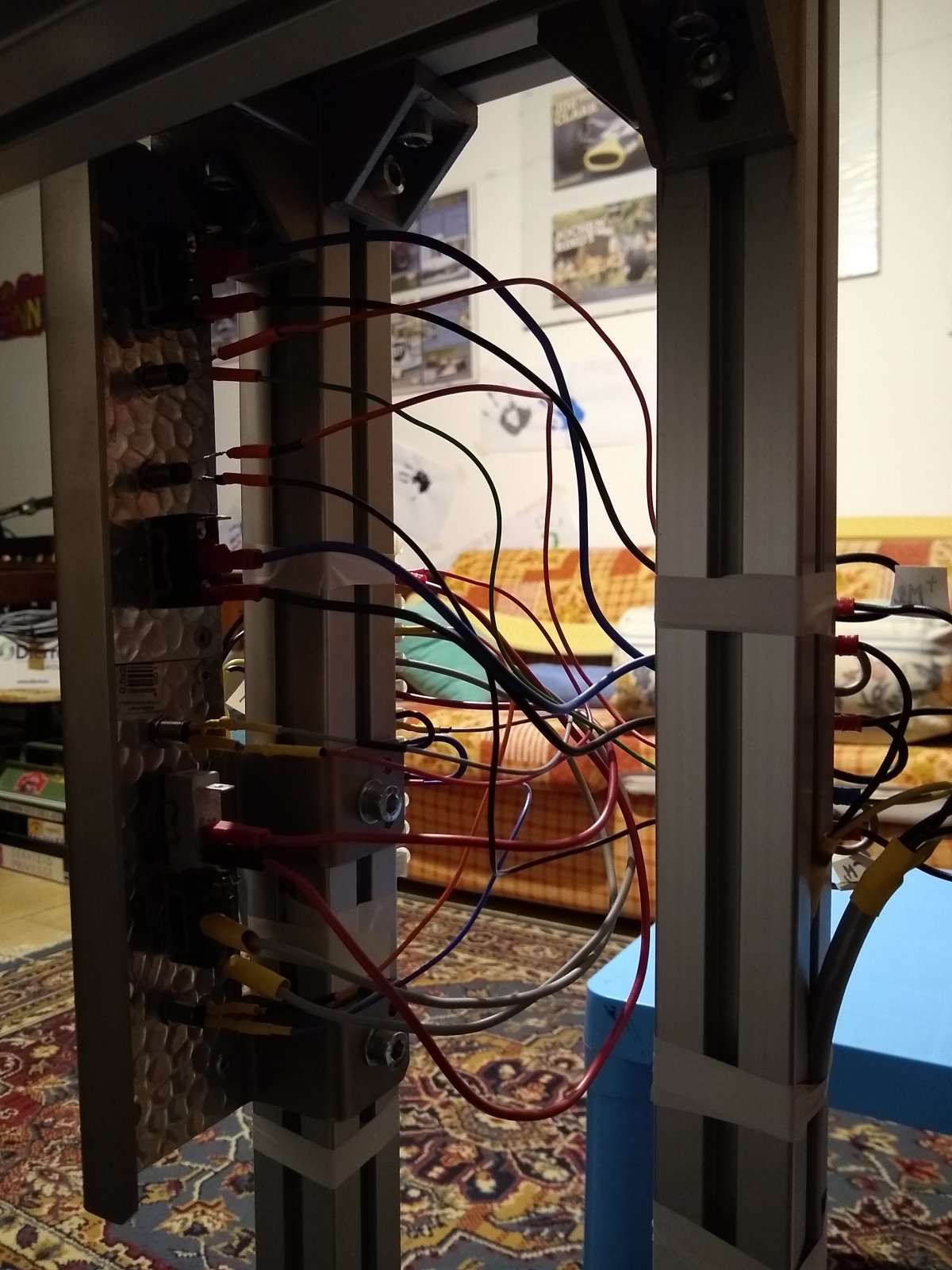

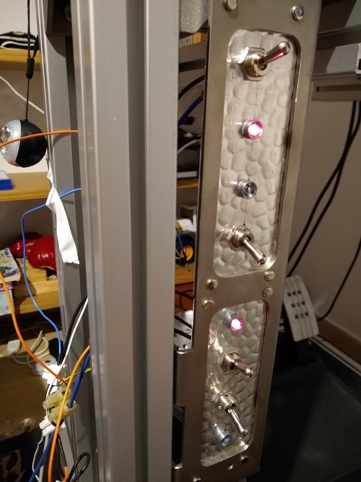

    I successed to assembly a diy button box to start the two power supplies and their cooling fans to motormoster.
    I'd like a spartan look like the racing cars assembled in the garages, but I promise that i improve the connection but first I try to assembly this to understand if I can.
    Here some photos

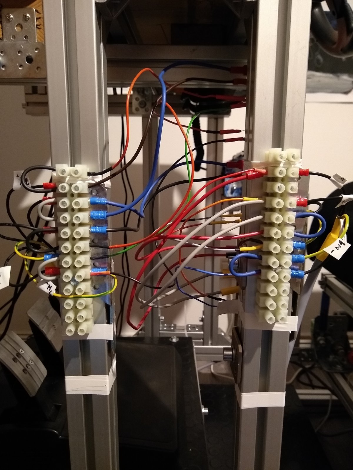

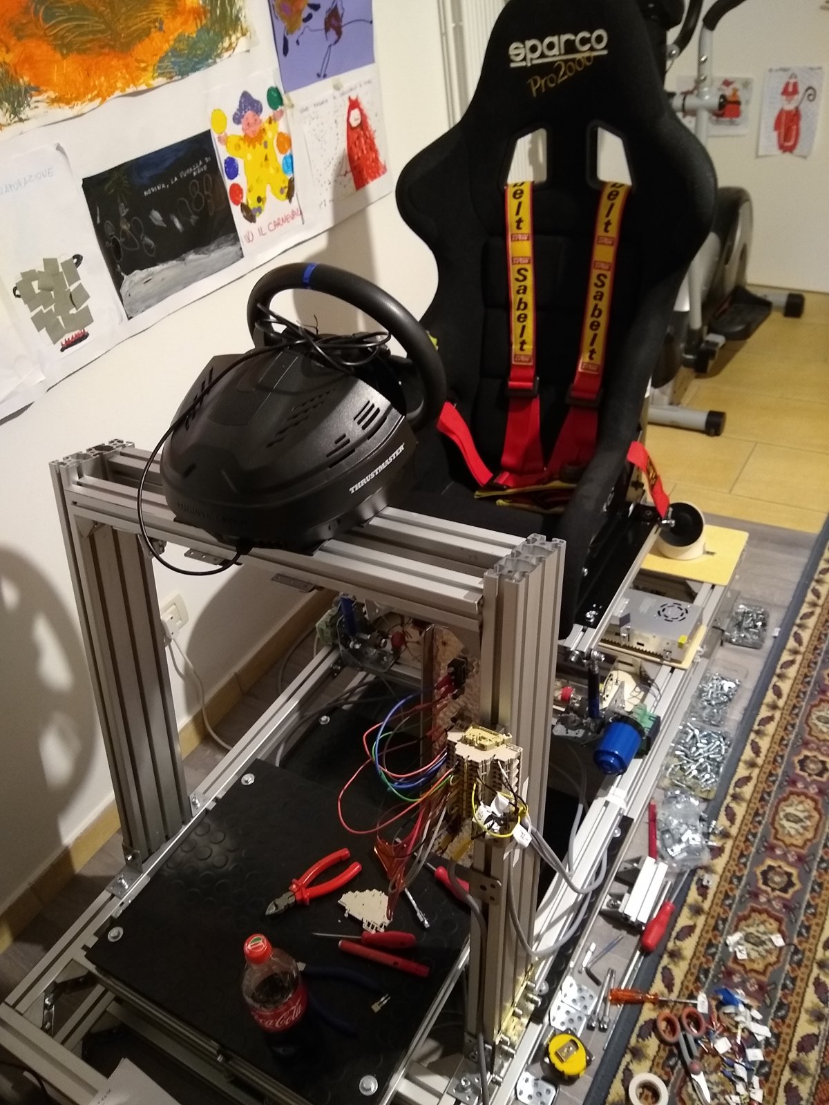

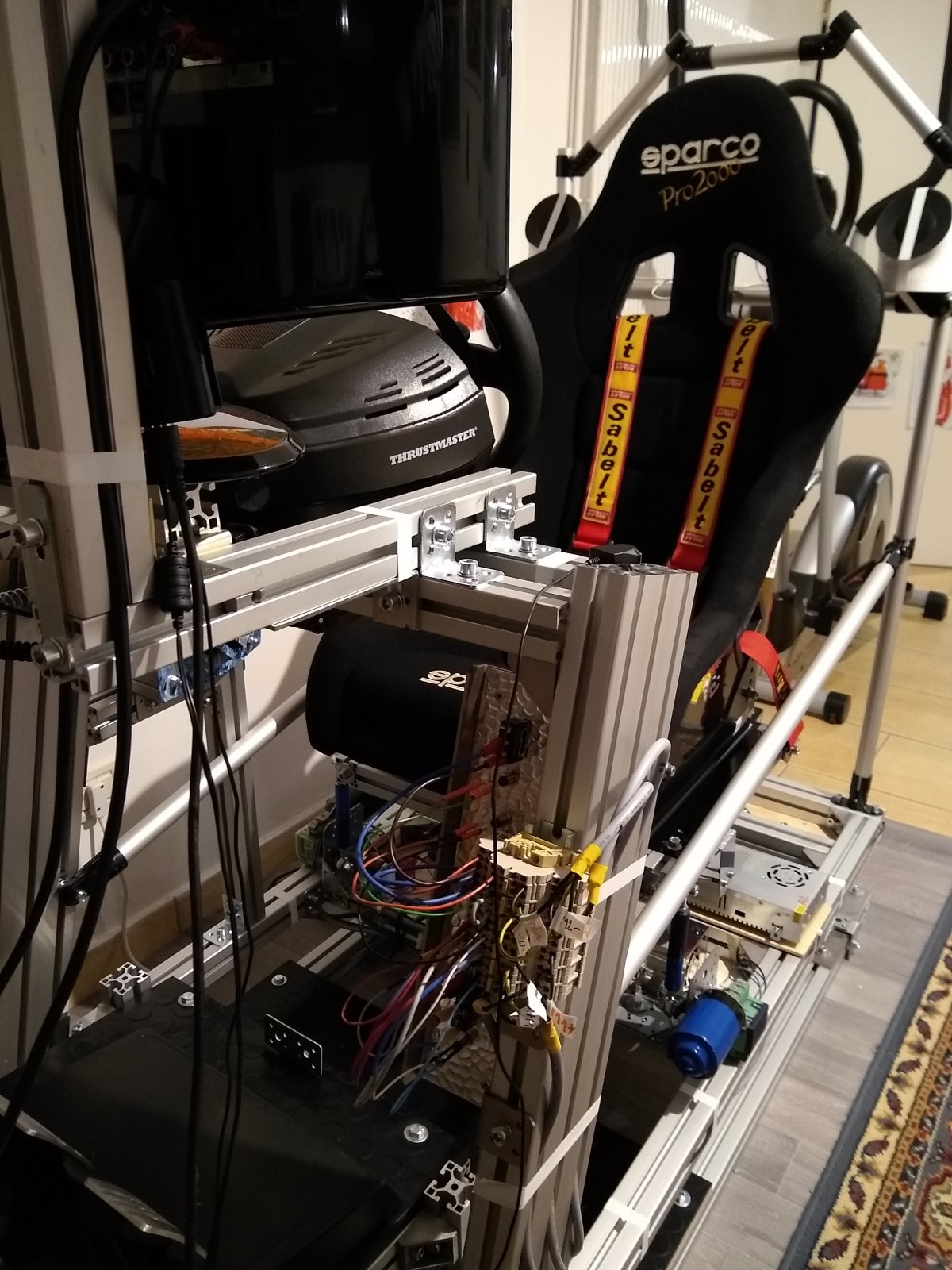

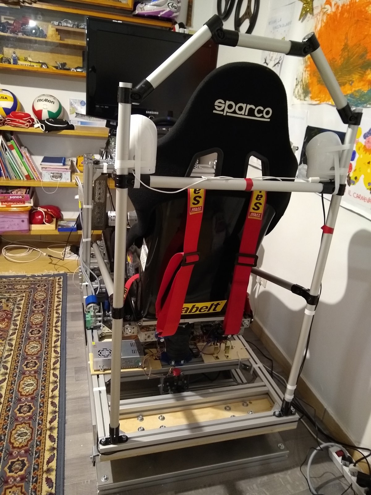

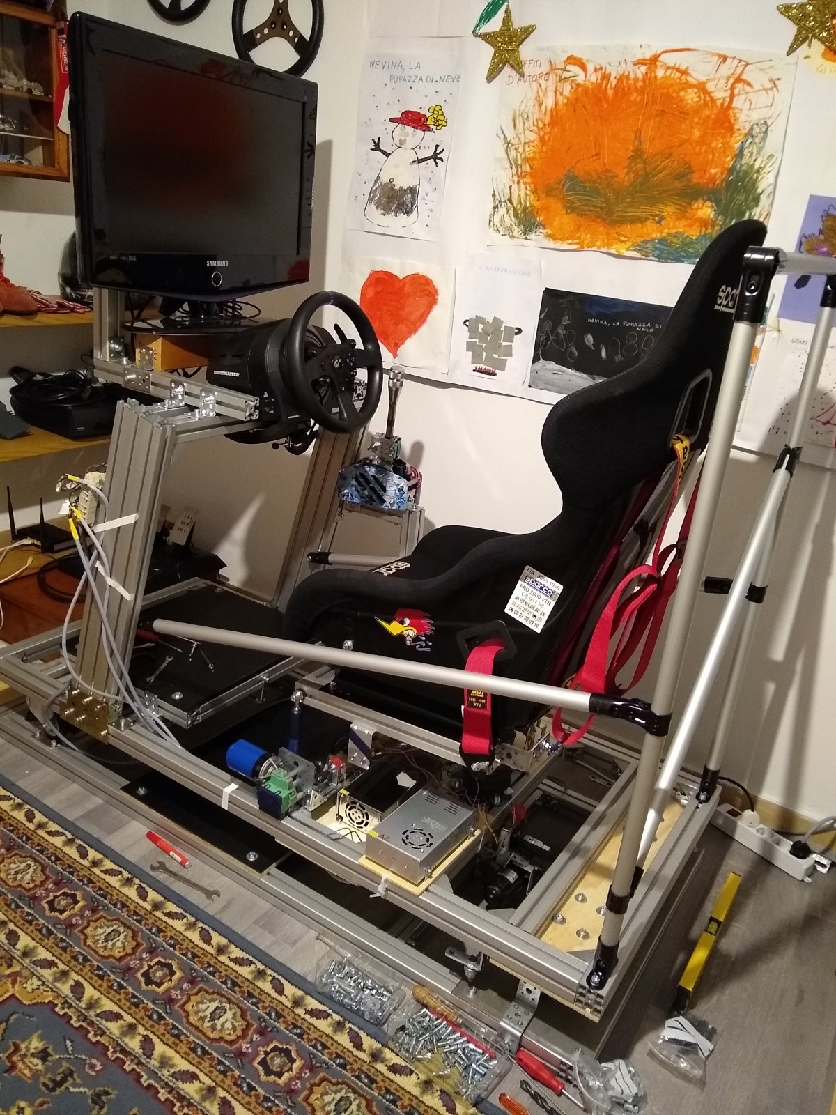

    After some time I'd like to show my progress about the playseat.

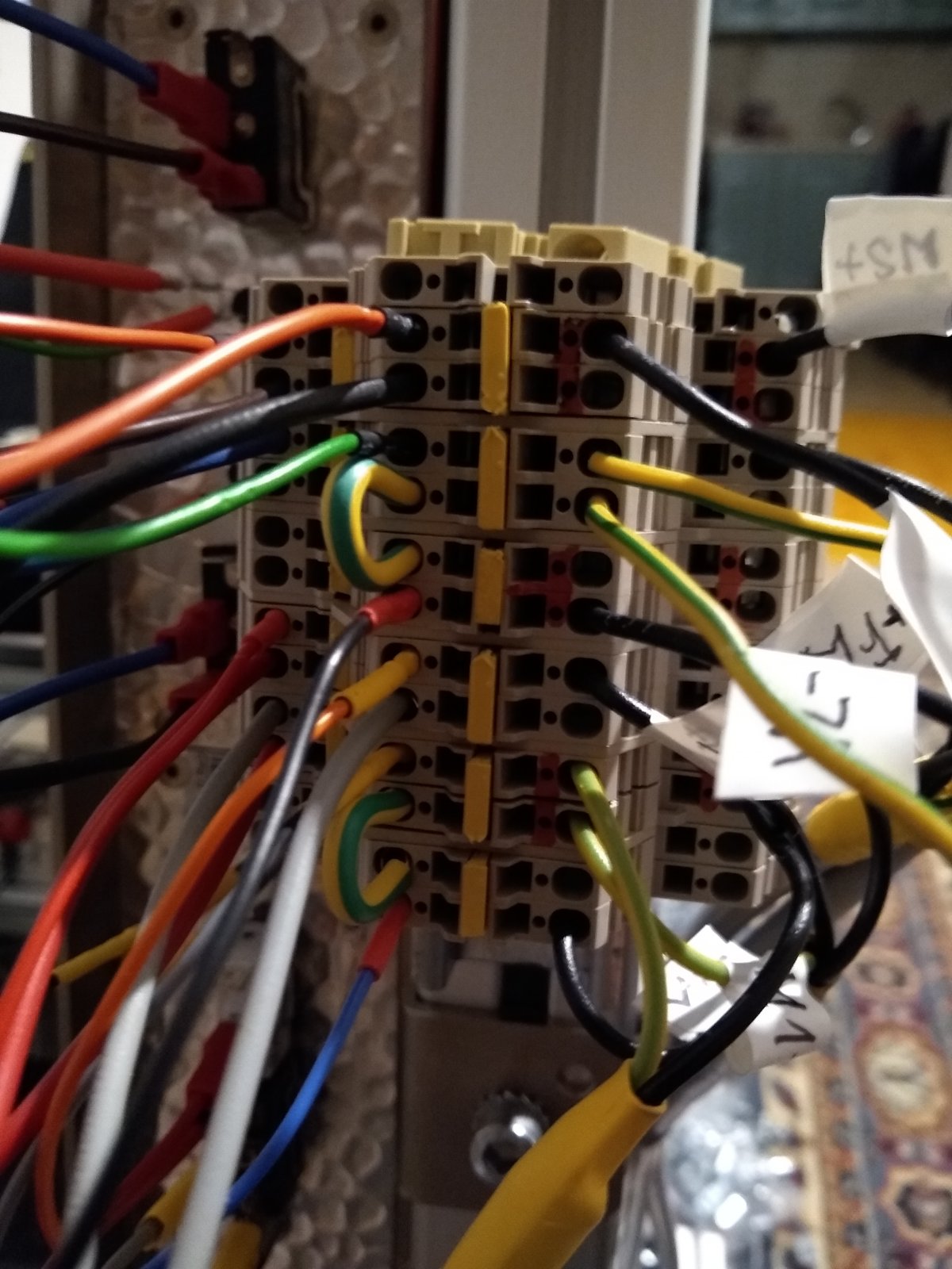

    I made some updates about the electric circuit and about the frame.
    In the attachment some imagines about this update.
    Best Regards

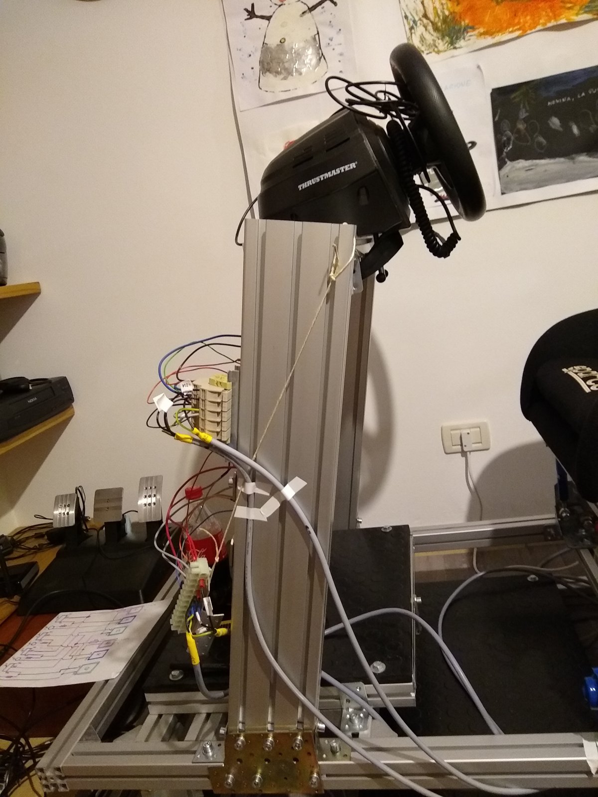

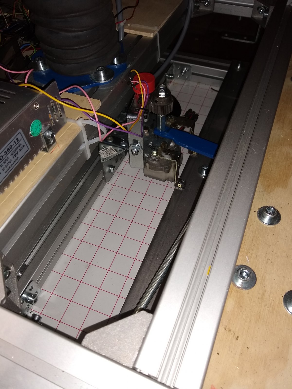

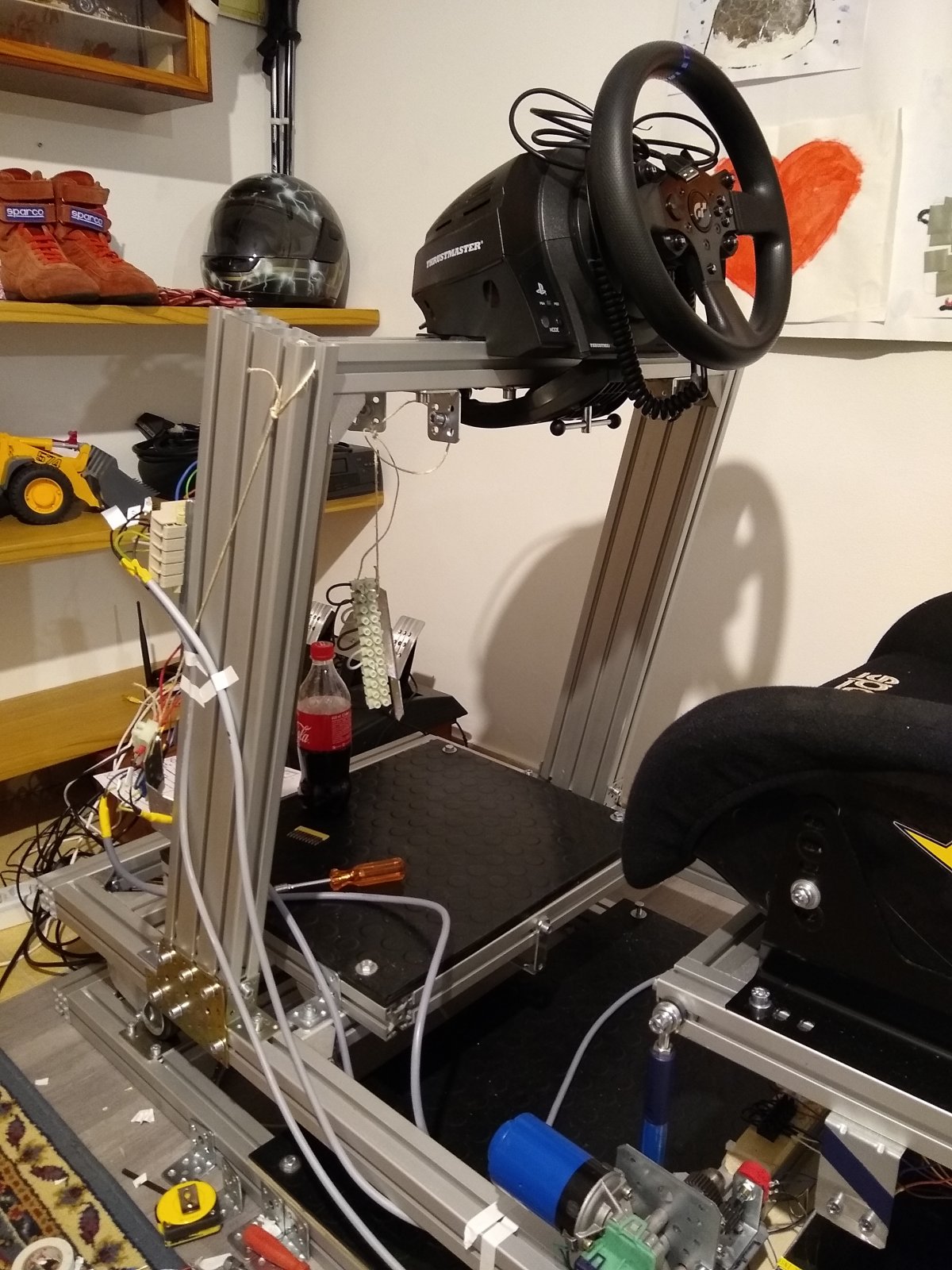

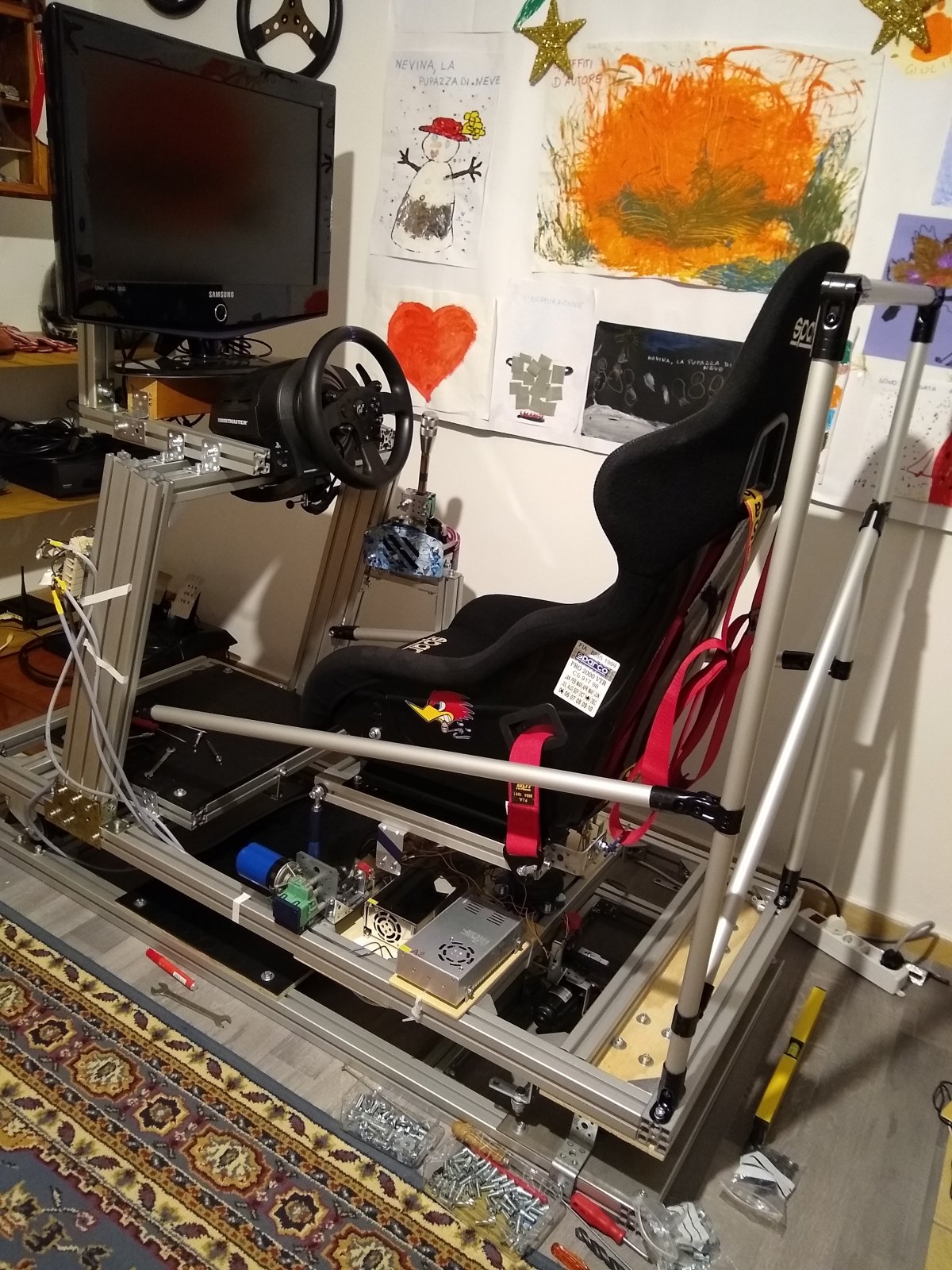

    I've updated my palyseat frame and I've made some modifications about SimTools setup.
    You can watch the new solutions in the attachments.
    Now I'd like some informations about pc desktop technical features, because I'm going to buy a new pc; this will have a windows 10, so I'd like some informations about the Simtools version and its compatibility with W10

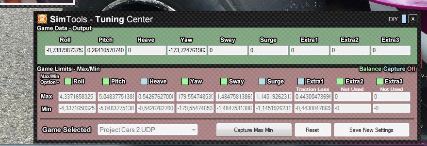

    I'm really in trouble. The forum is very rich in informations and experiences, nothing to say.
    But sometimes I can't reach my goal because my inexperience prevents me from finalizing everything for the best result.
    For example, for the traction loss I set the extra axis at 100%, but the movement of the playseat was not satisfactory as it seems to me that there are unwanted movements; I finally found that by introducing a value of 1 smoothing and 5 of deadzone the skid effect seems more truthful.
    Here I realized that I didn't understand much about the use of filters and Tuning Center.
    Also for the other parameters, like sway or surge, I have not set any filter.
    Could we have parameters of the set of examples as a starting point?
    I would like help also with regards to the SMC3 software parameters for the setting of motors managed by arduino.The imagine about Tuning center is a test result with:
    Project cars 2 PS4
    Lamborghini Huracan GT3
    Monza Circuit
    Thank you
    Greetings
    21,581
    151,100Coins
    +11,029 / 56 / -2
    Just an observation, the motion profile should be fully refined before using filters, doing one axis at a time: https://www.xsimulator.net/community/faq/steps-to-create-a-motion-profile.228/
    There are tips here for tweaking traction loss: https://www.xsimulator.net/community/faq/traction-loss-in-simtools.175/
    The SimTools filters are covered in the SimTools manual: https://www.xsimulator.net/community/threads/official-simtools-user-manual.12424/
    You may find the Axis Analysis app handy for refining and seeing the effect of tuning changes: https://www.xsimulator.net/community/faq/axis-analysis-app.282/

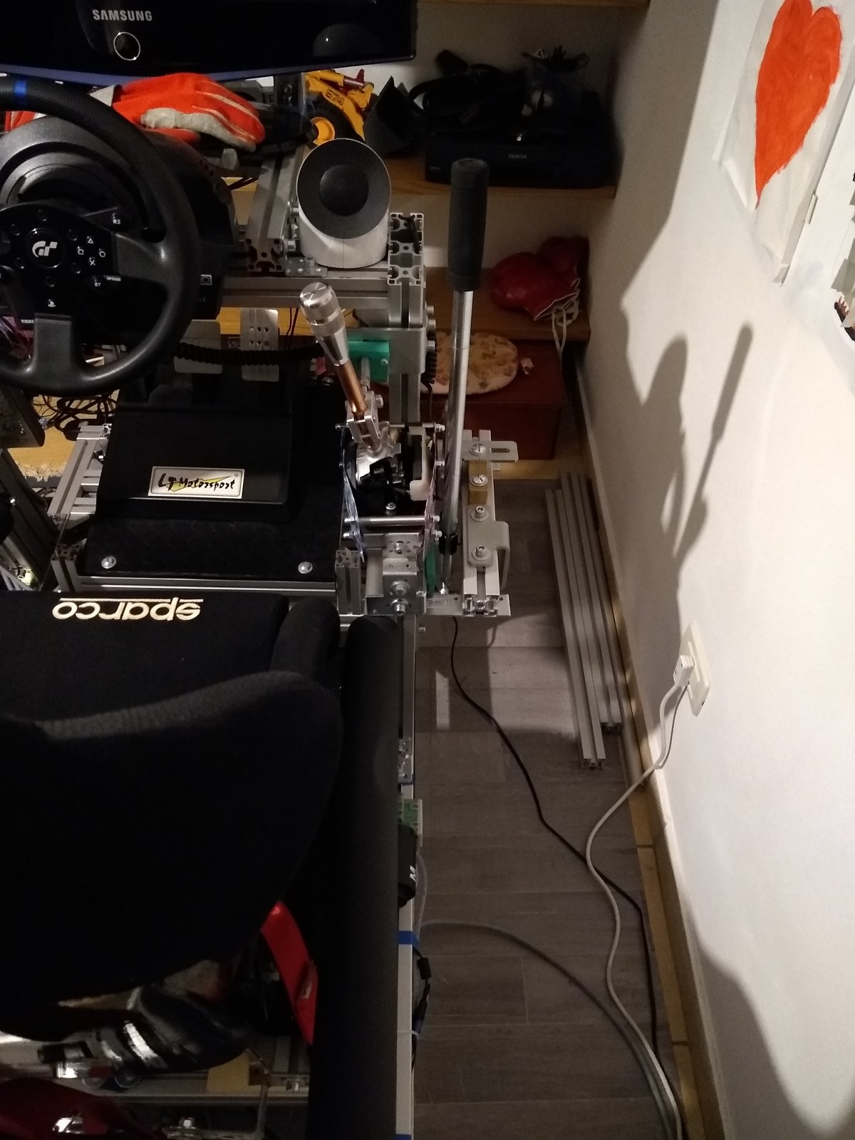

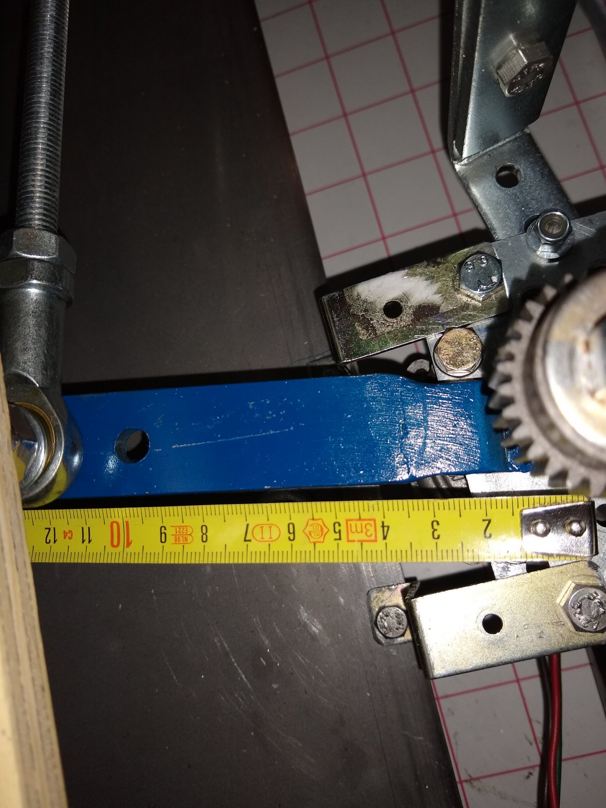

    I'mtrying to assemblythe DIY Handbreak. In attachment you can see the result, now I'm starting to carry out the automation part.
    cheer
  16. FrancescoRoberto
    FrancescoRoberto Member
    Mar 31, 2018
    87
    Italia
    86Coins
    +25 / 0 / -0
    I'm trying to assembly my first DIY handbreak, the mechanical part is finished, more or less; now I'm starting to carry out the automation part. See the attachments.
    Cheer
