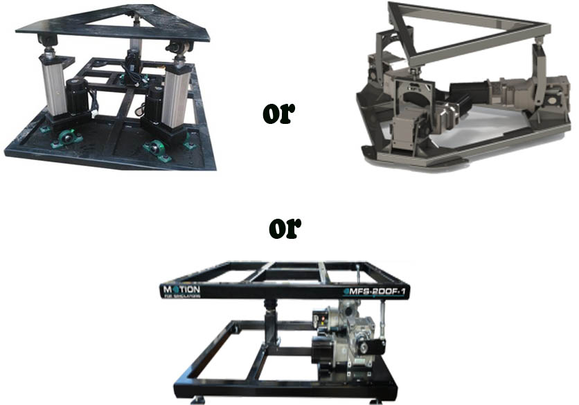

    Hello. I'm from Manila Philippines and I'm just newbie here. I'm planning to build 3DOF for my flight simulator. Can anybody here guide me on where to find the exact motor that fit with my plan? Thank you and looking forward to a positive response.
    21,723
    152,051Coins
    +11,063 / 56 / -2
    You will need to finalise your design choice first and a little bit of research is time well spent, so check out the FAQs: https://www.xsimulator.net/community/faq/
    In particular the Design section: https://www.xsimulator.net/community/faq/design-considerations-resources.24/category
    And use SimCalc to help you get your head around the trade off in Design Vs physics: https://www.xsimulator.net/communit...e-linear-speed-and-forces-of-your-design.270/
    SimCalc covers 2DOF, like the design in the bottom of the picture you posted.

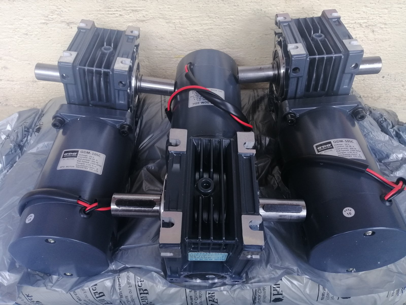

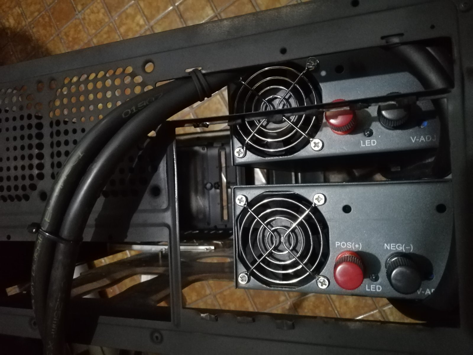

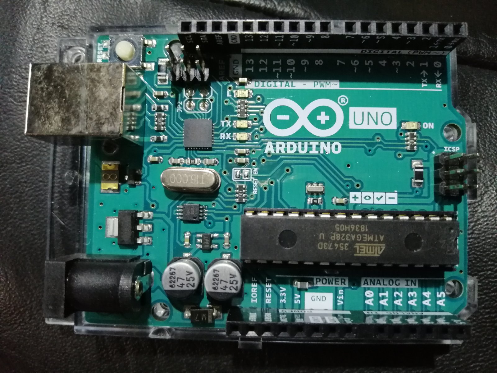

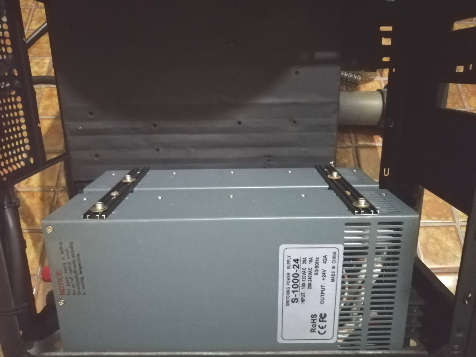

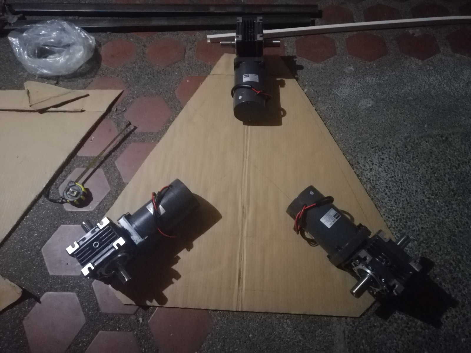

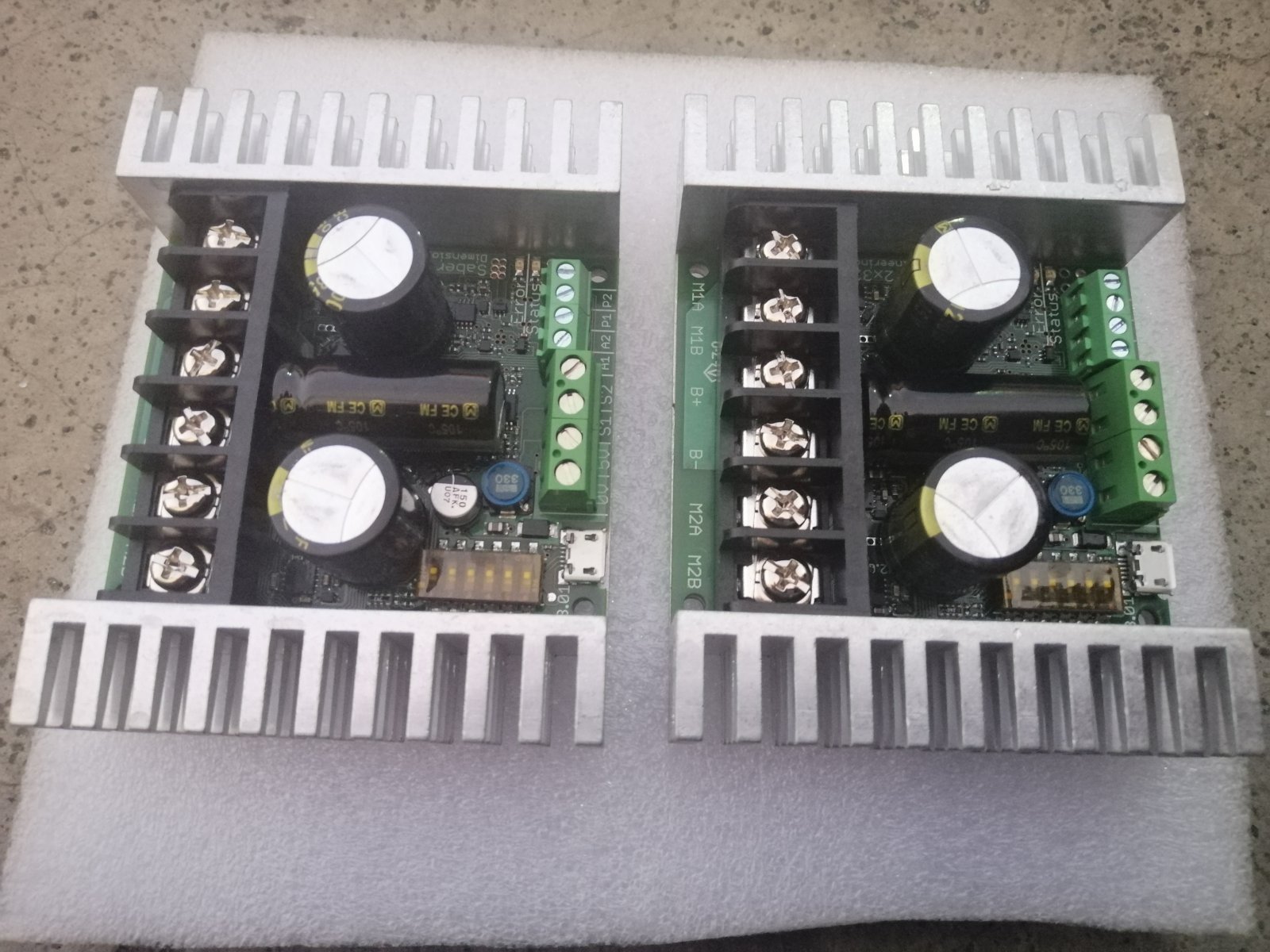

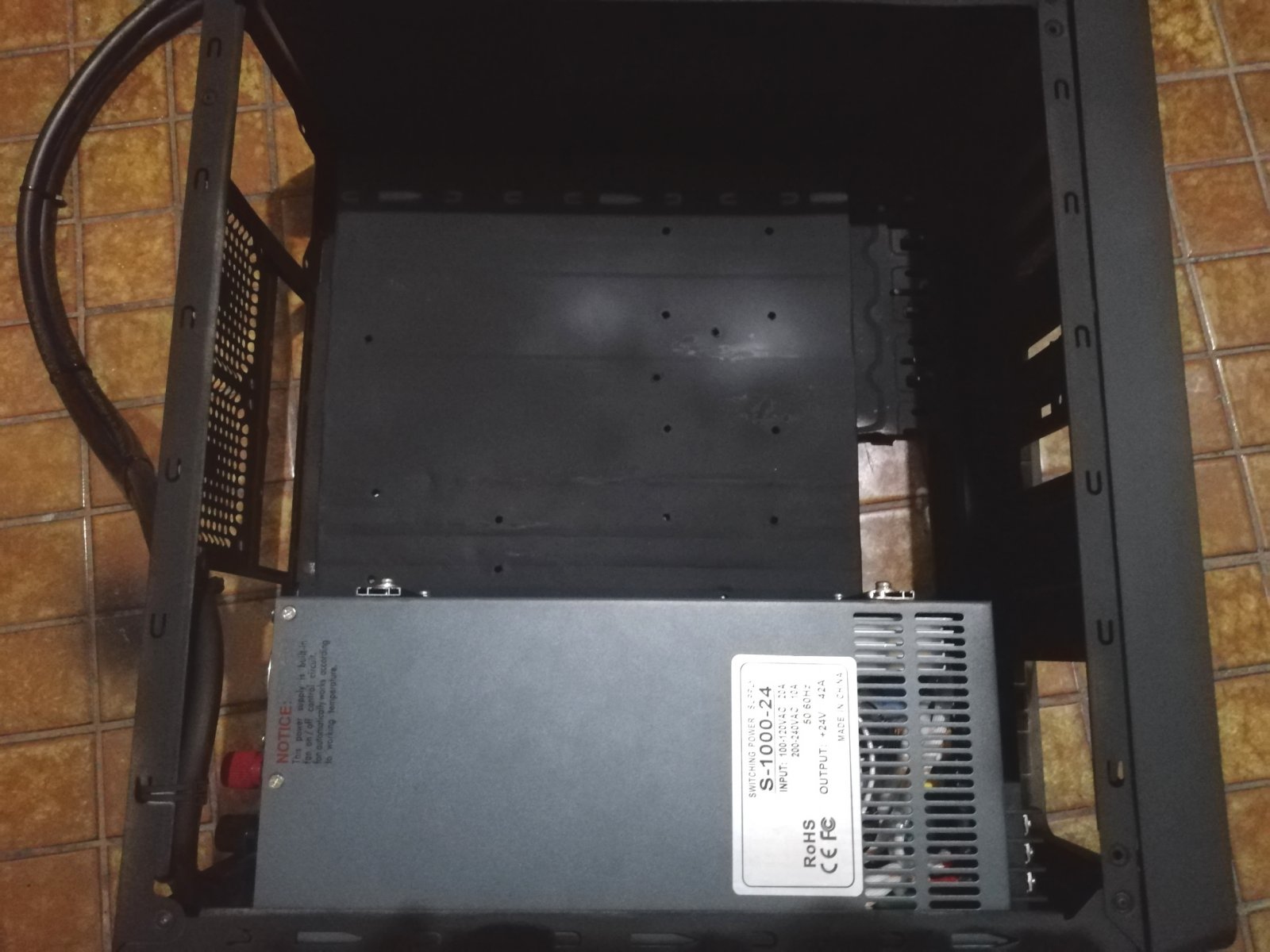

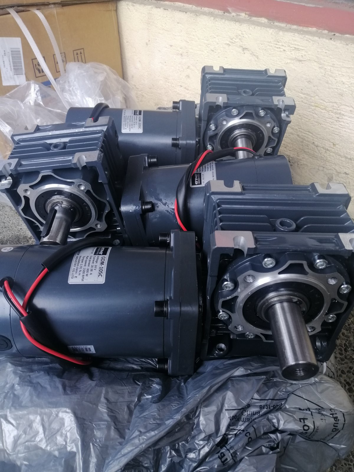

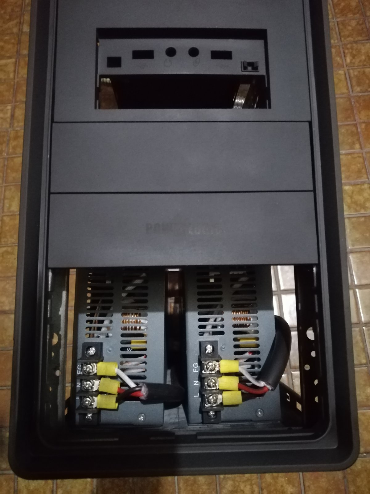

    Finally, I’ve got received my items for my 3DOF Flight Sim Project. Thanks to @MilaniFabio project https://www.xsimulator.net/community/threads/new-diy-3dof-dynamic-workstation-project.13102/
    and for some advises https://www.xsimulator.net/community/threads/new-diy-3dof-dynamic-workstation-project.13102/page-4

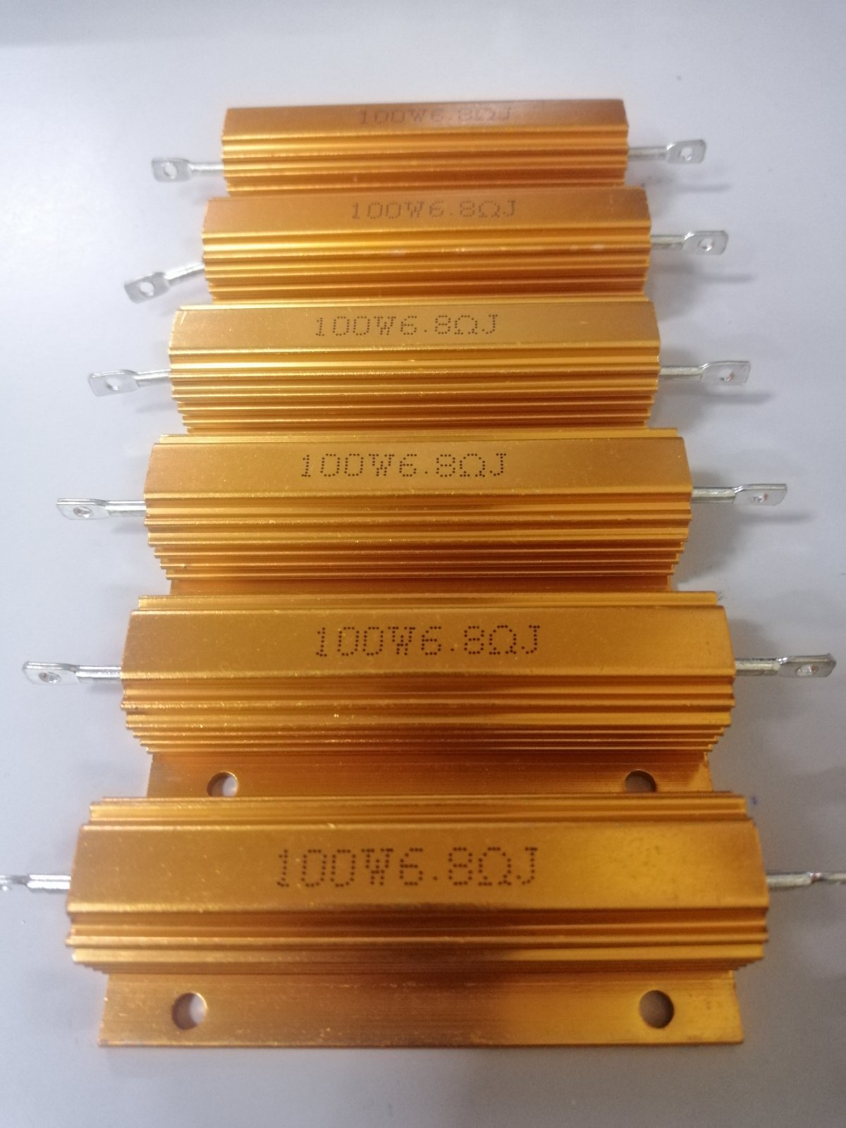

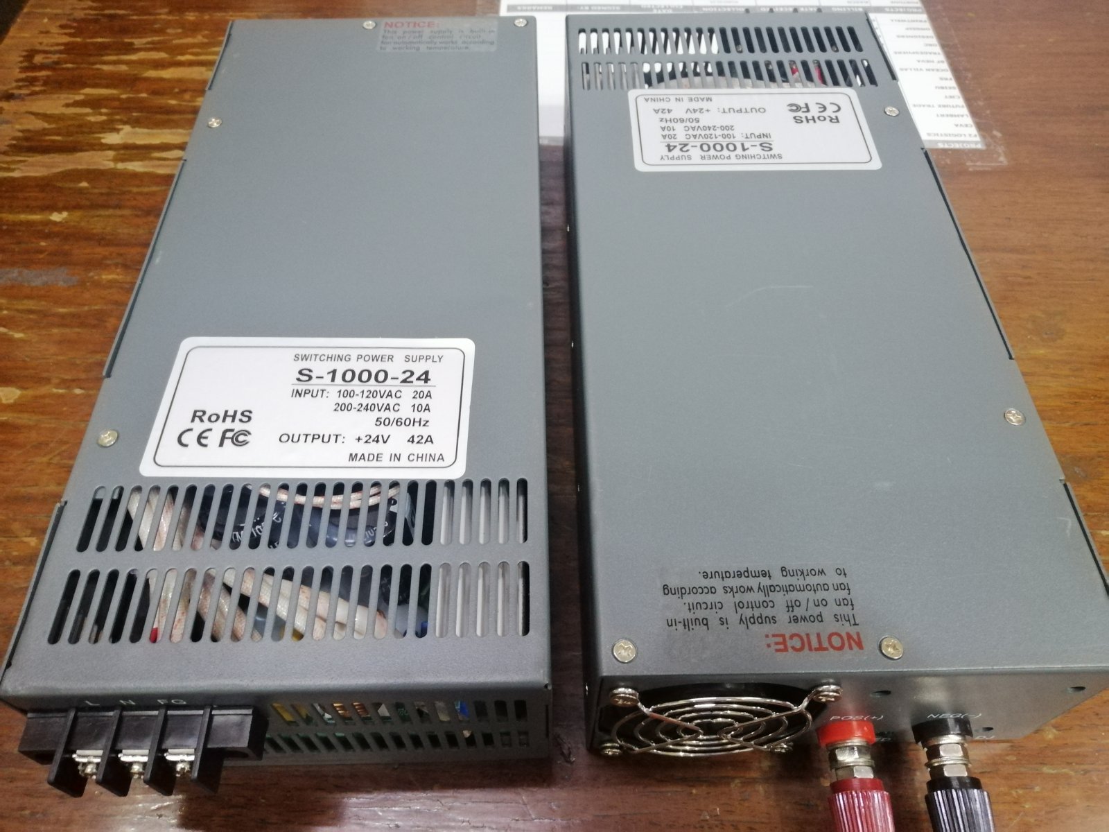

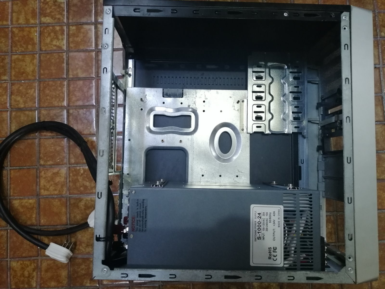

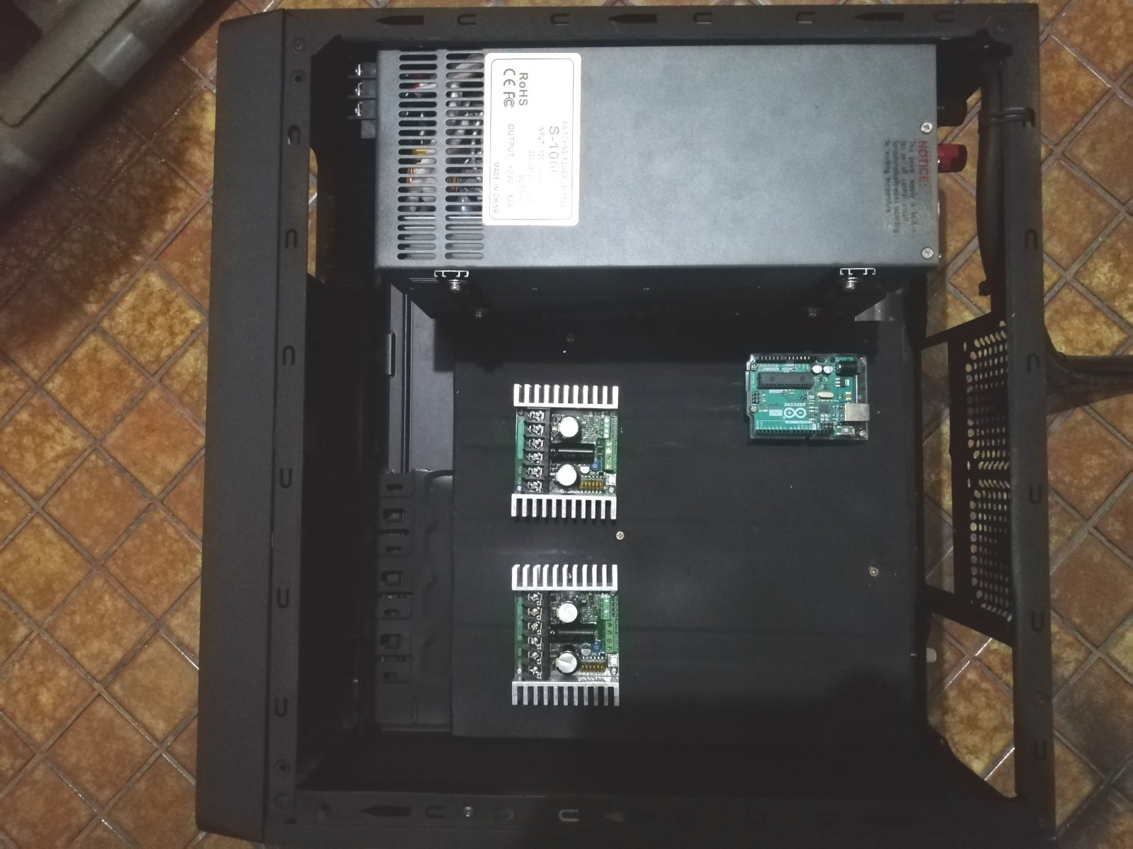

    My project is about to shape. Here’s the list of components that I purchased. (It’s a bit expensive, but I’m sure it's worth it)
    3 units GDM-10SC 300w-24-3000rpm with the final output speed of 50rpm https://www.alibaba.com/product-det...l?spm=a2700.7724838.2017115.64.4cc64e18dFY3W9
    1 unit Arduino UNO rev3 https://www.ebay.ph/itm/Arduino-Uno...755592?hash=item23c3ad1508:g:Xa0AAOSwos5dVxr5
    2 units Sabertooth 2x32 https://www.ebay.ph/itm/Sabertooth-...006961?hash=item33f0c88bf1:g:Z~oAAOSwHSdcUyGw
    2 units Power Supply S-1000-24 https://www.aliexpress.com/item/32322666199.html?spm=a2g0s.9042311.0.0.73b04c4dlMm95Q
    3 units Potentiometer 10K
    6 units Resistance 100w 6.8 ohm https://www.aliexpress.com/item/32872294703.html?spm=a2g0s.9042311.0.0.73b04c4dlMm95Q

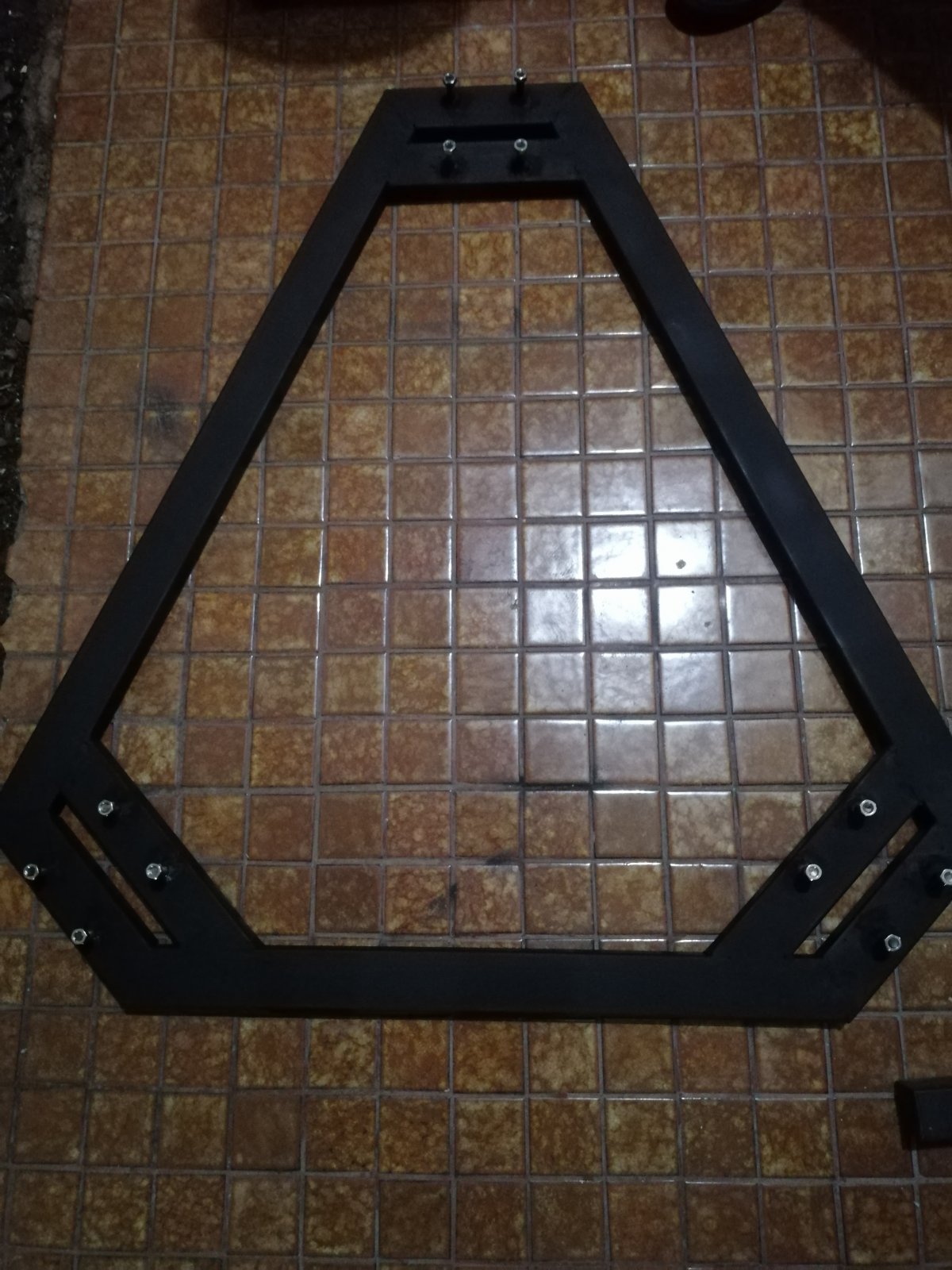

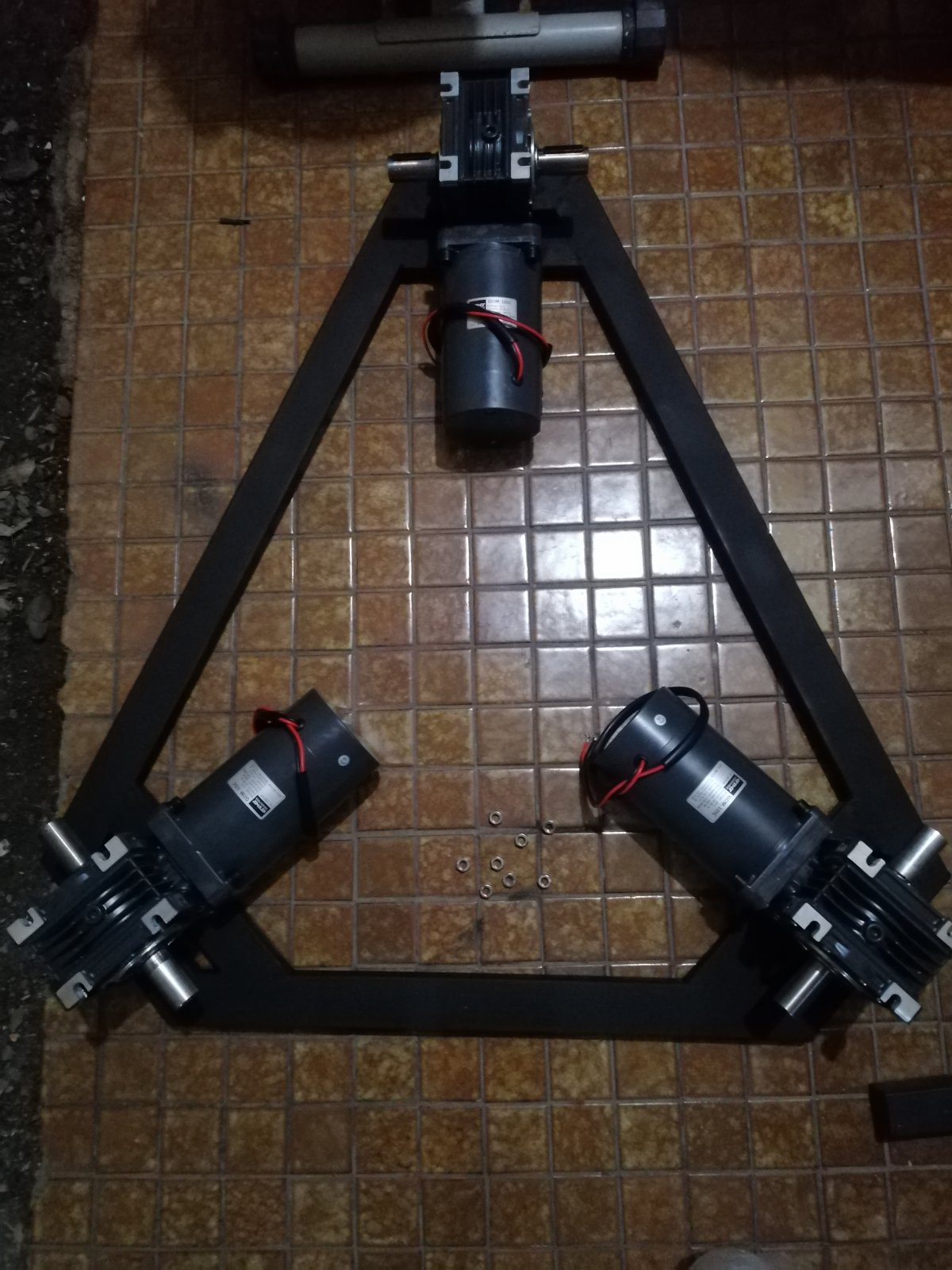

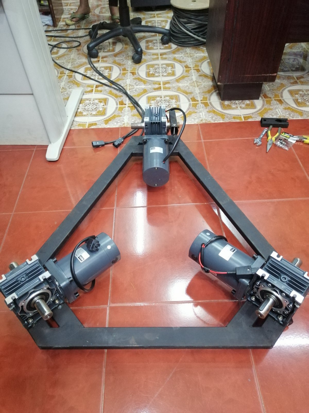

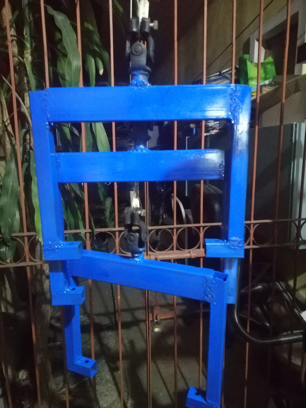

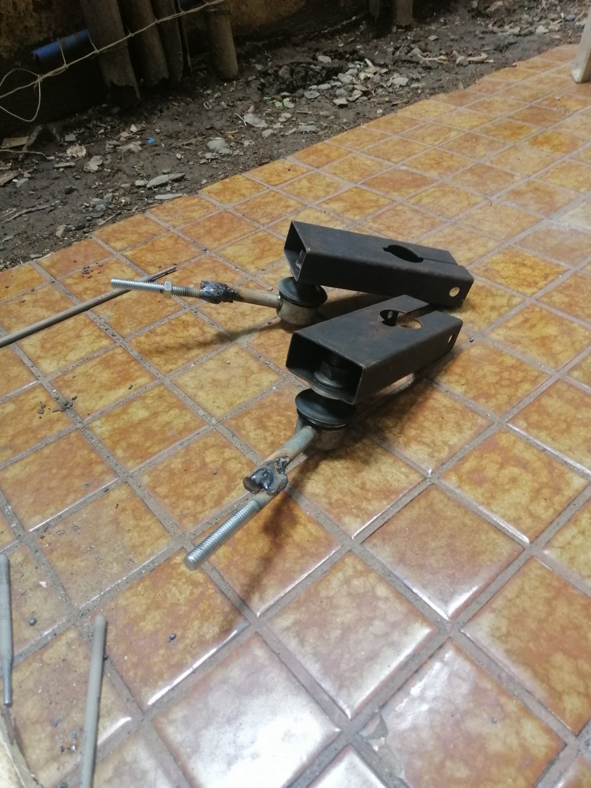

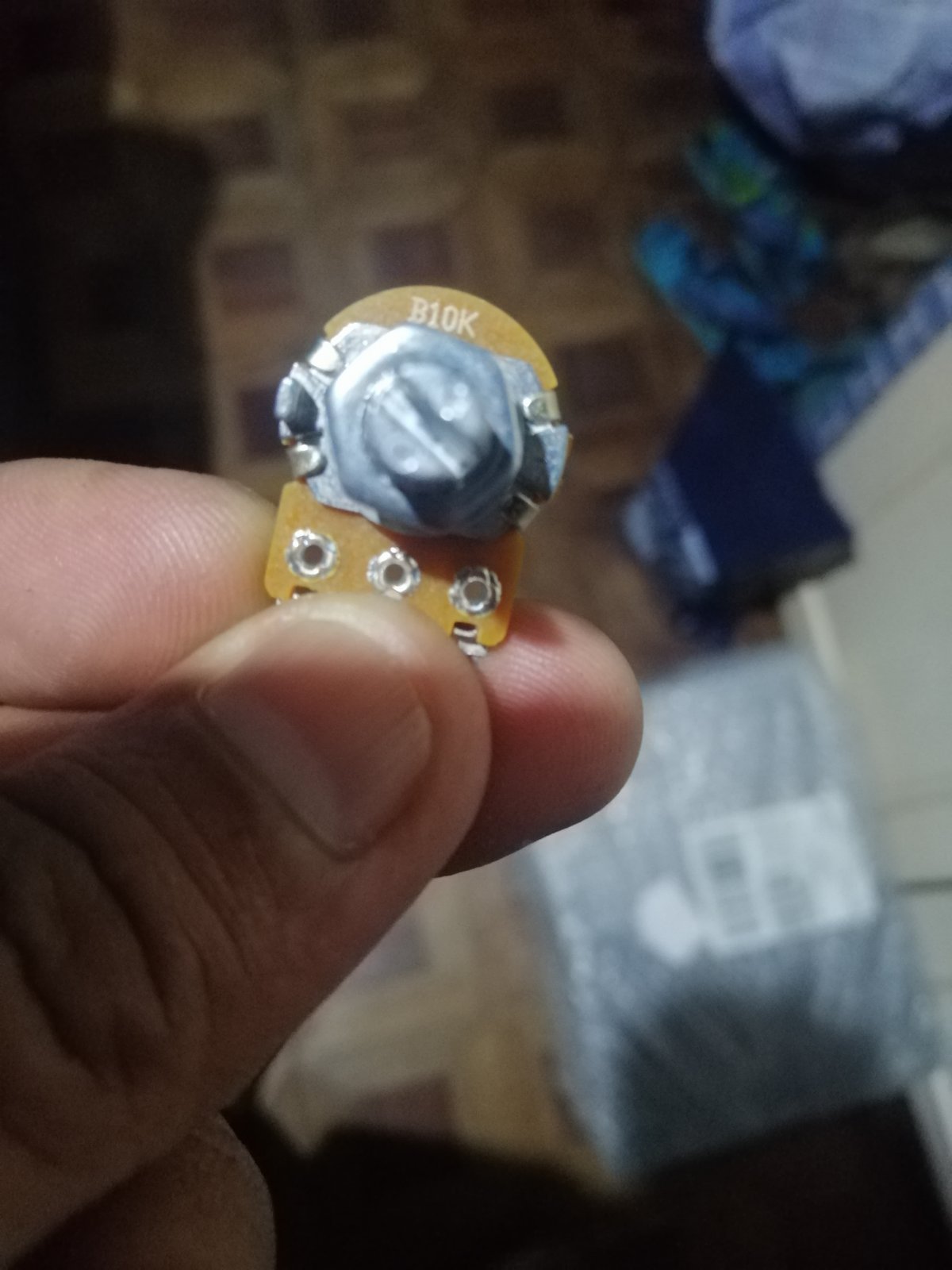

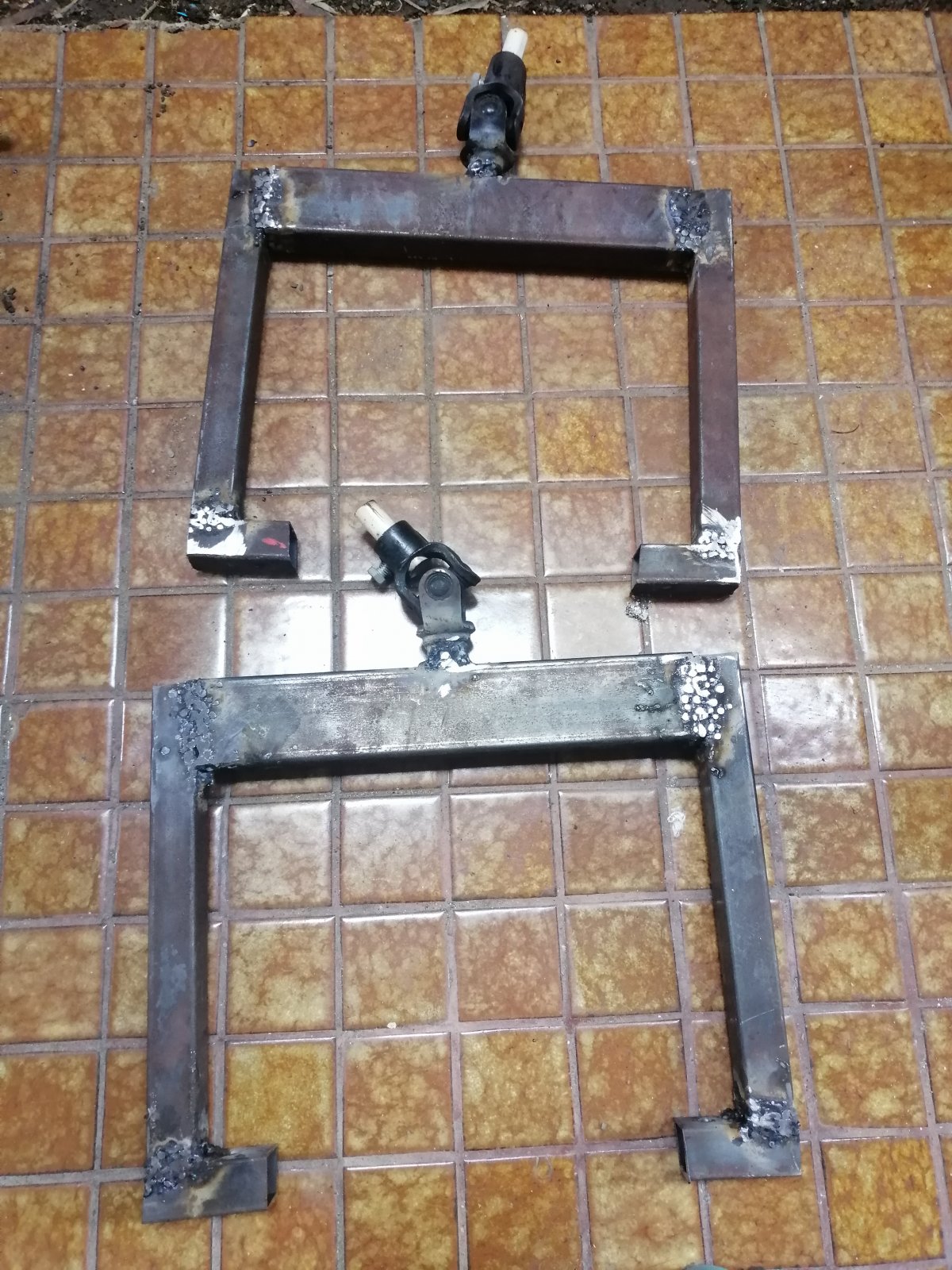

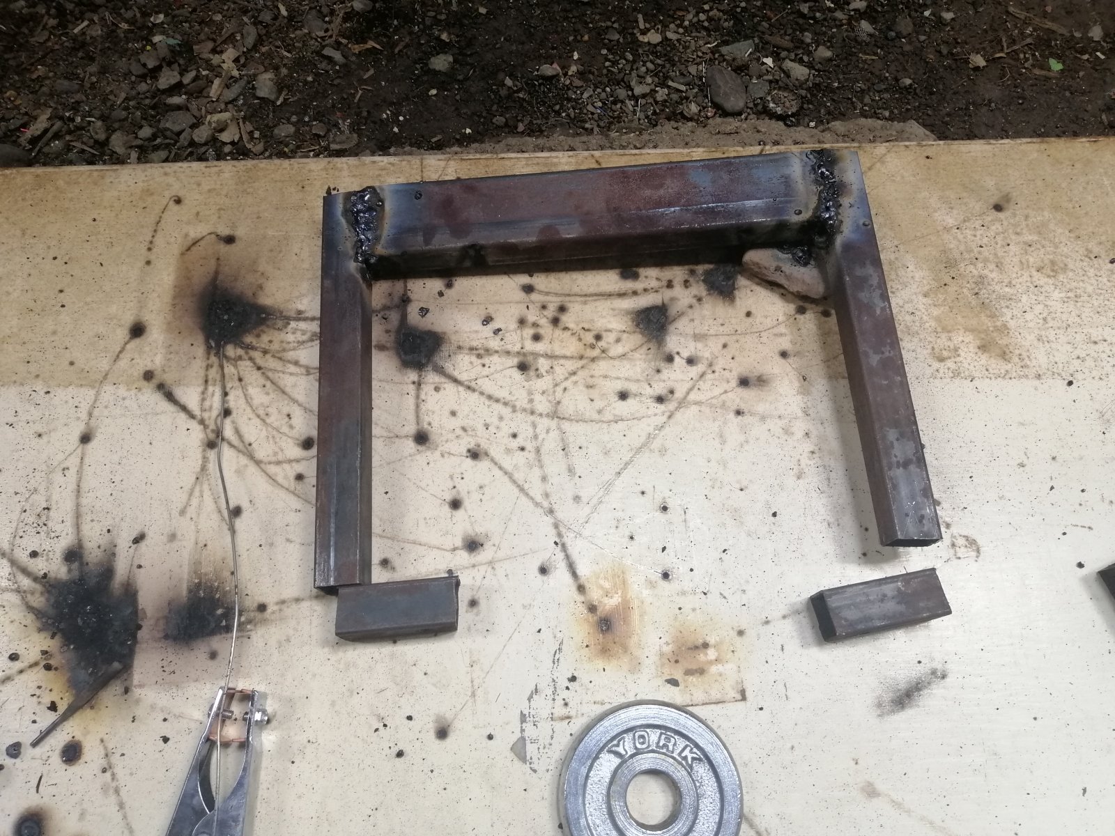

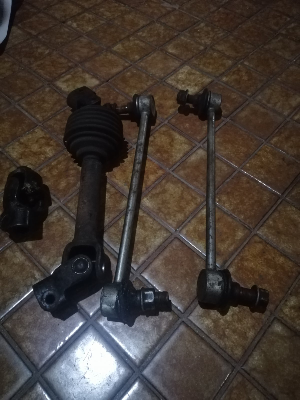

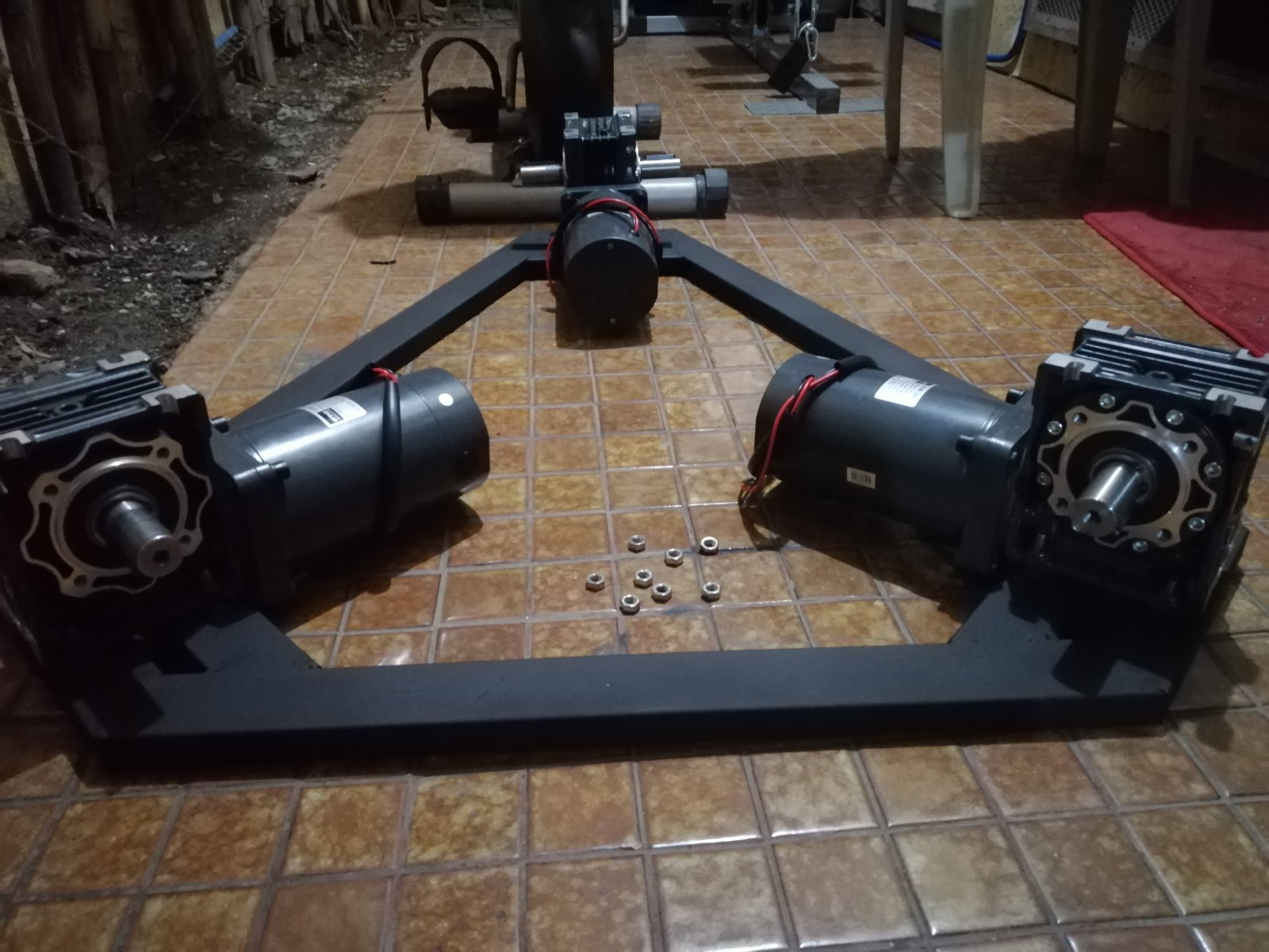

    Hello guys,

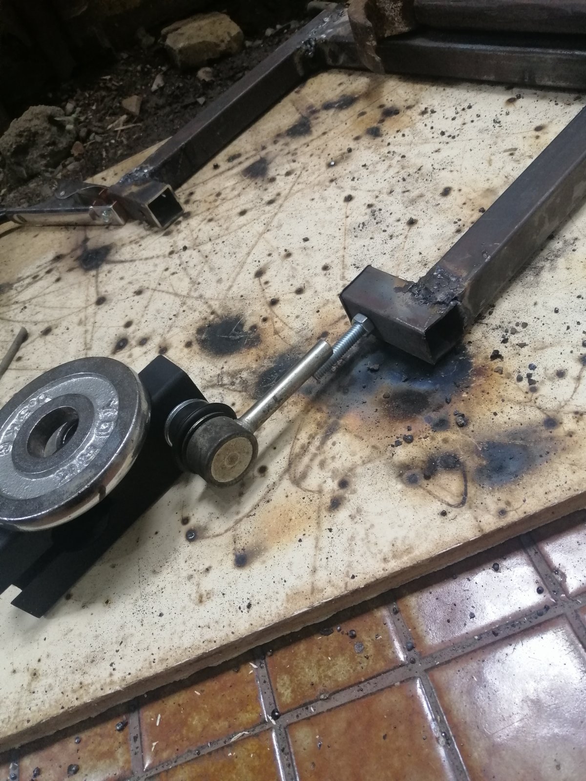

    Here's some progress with my project. Just arrived my lever arm together with flatform for the engine. I also bought used cross joint and ball joint. I just doubt my potentiometer 10k with 180 degrees will fit my project? any suggestions?

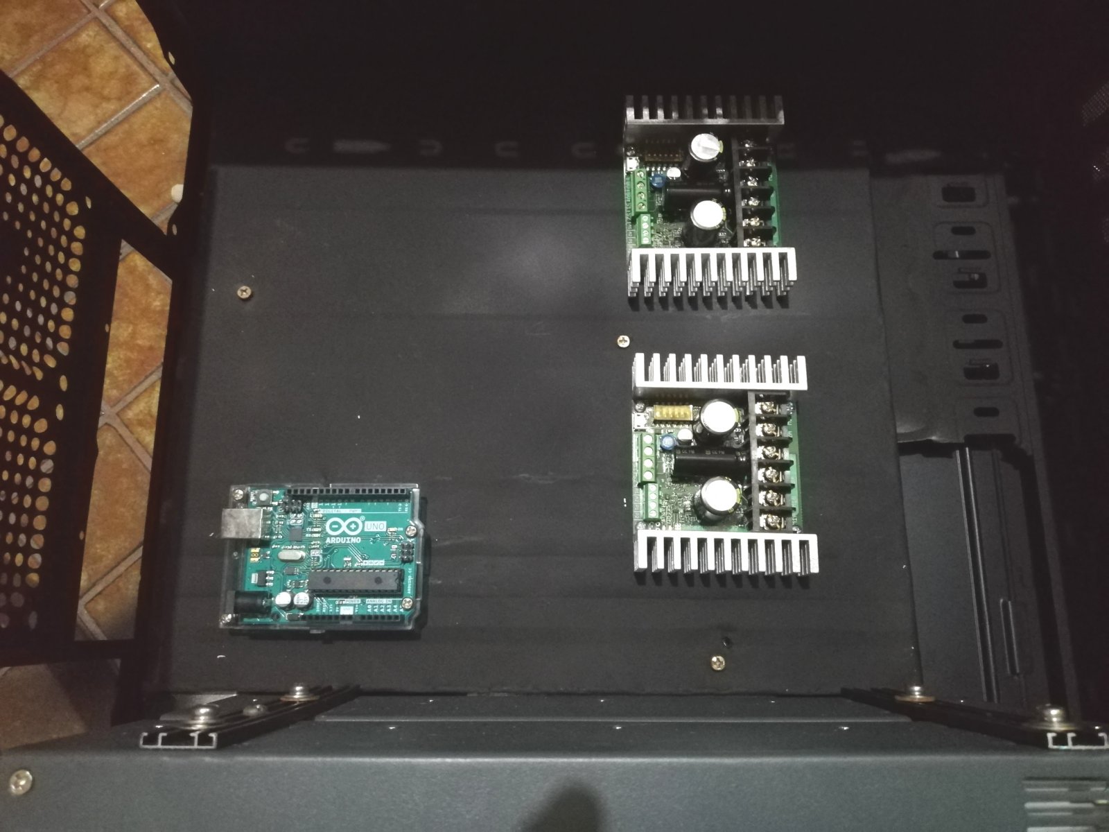

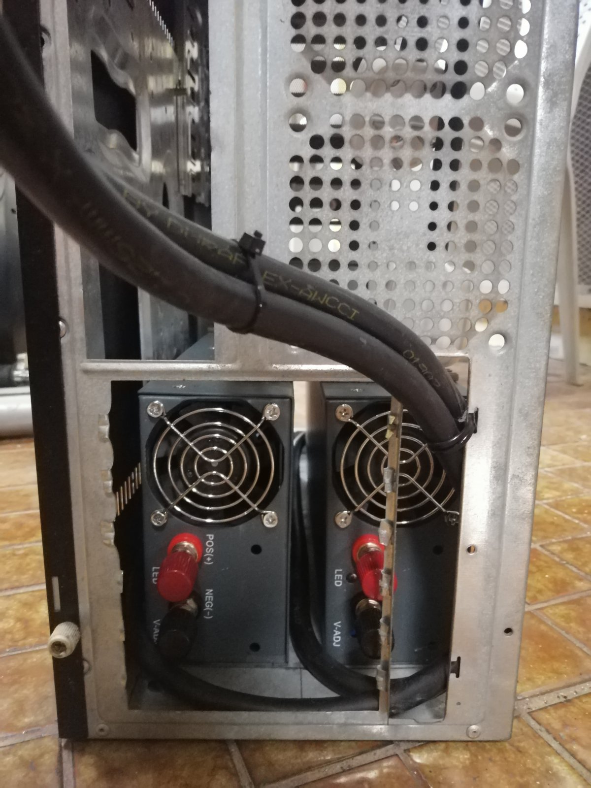

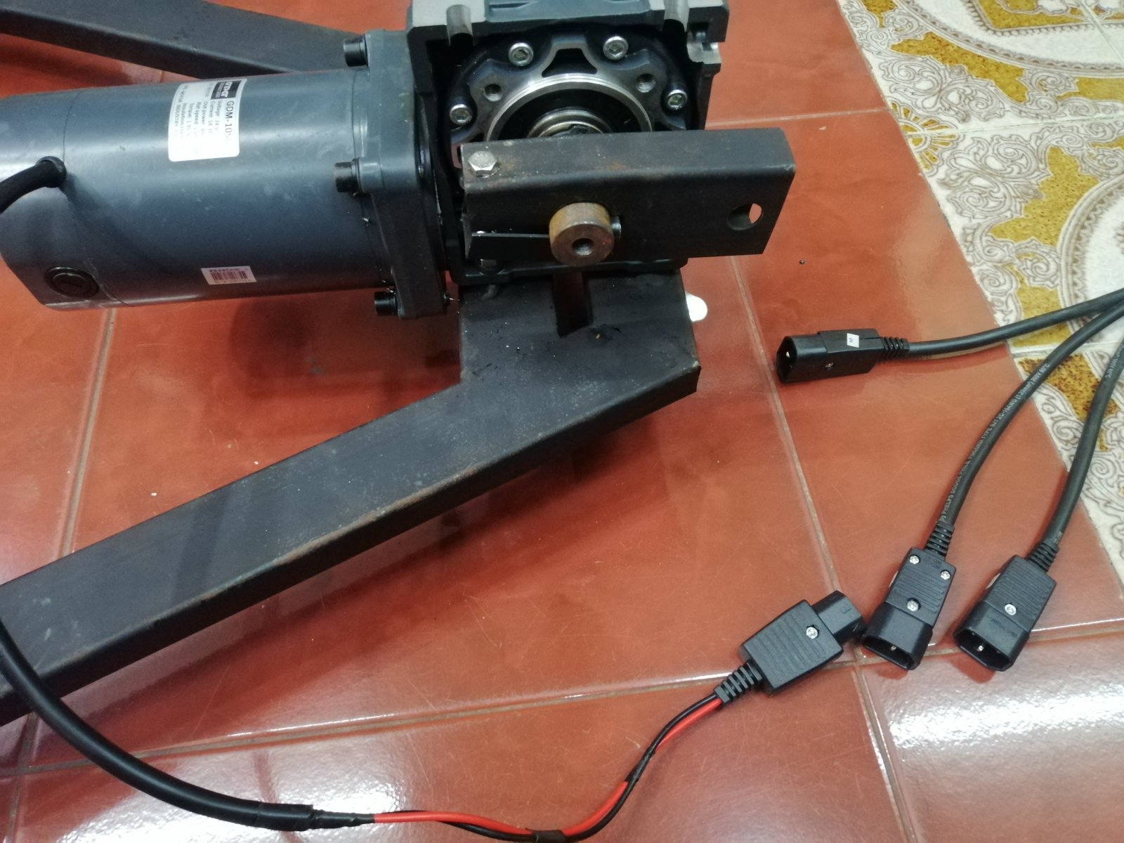

    Hello, an update nor progress with my project. Temporary I place the potentiometer near to Arduino because my gears haven't arrived yet and to see if its work. But suddenly during the testing the motor 2 & 3 moving slowly, I guess because I haven't yet installed the plugins, I keep on searching but I can't get through coz I have a demo sim tools only. Is there anyone who can share plugins for Flight Simulator? (Thanks in advance). I also added female and male inline rewirable plug connectors for the motors itself, for me to easy detached the wire if I have to relocate my sim. IMG_20191124_210904.jpg IMG_20191124_210943.jpg

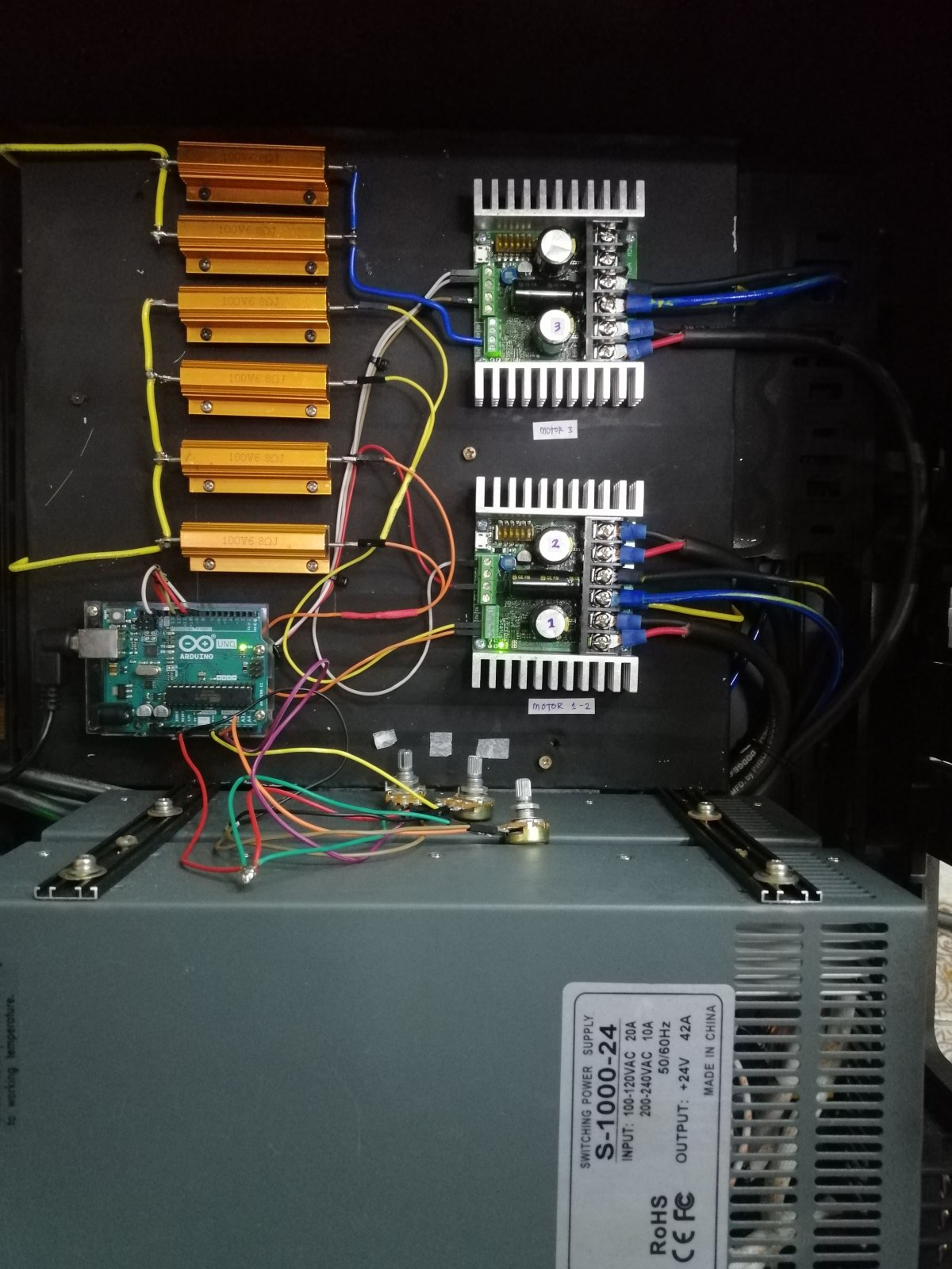

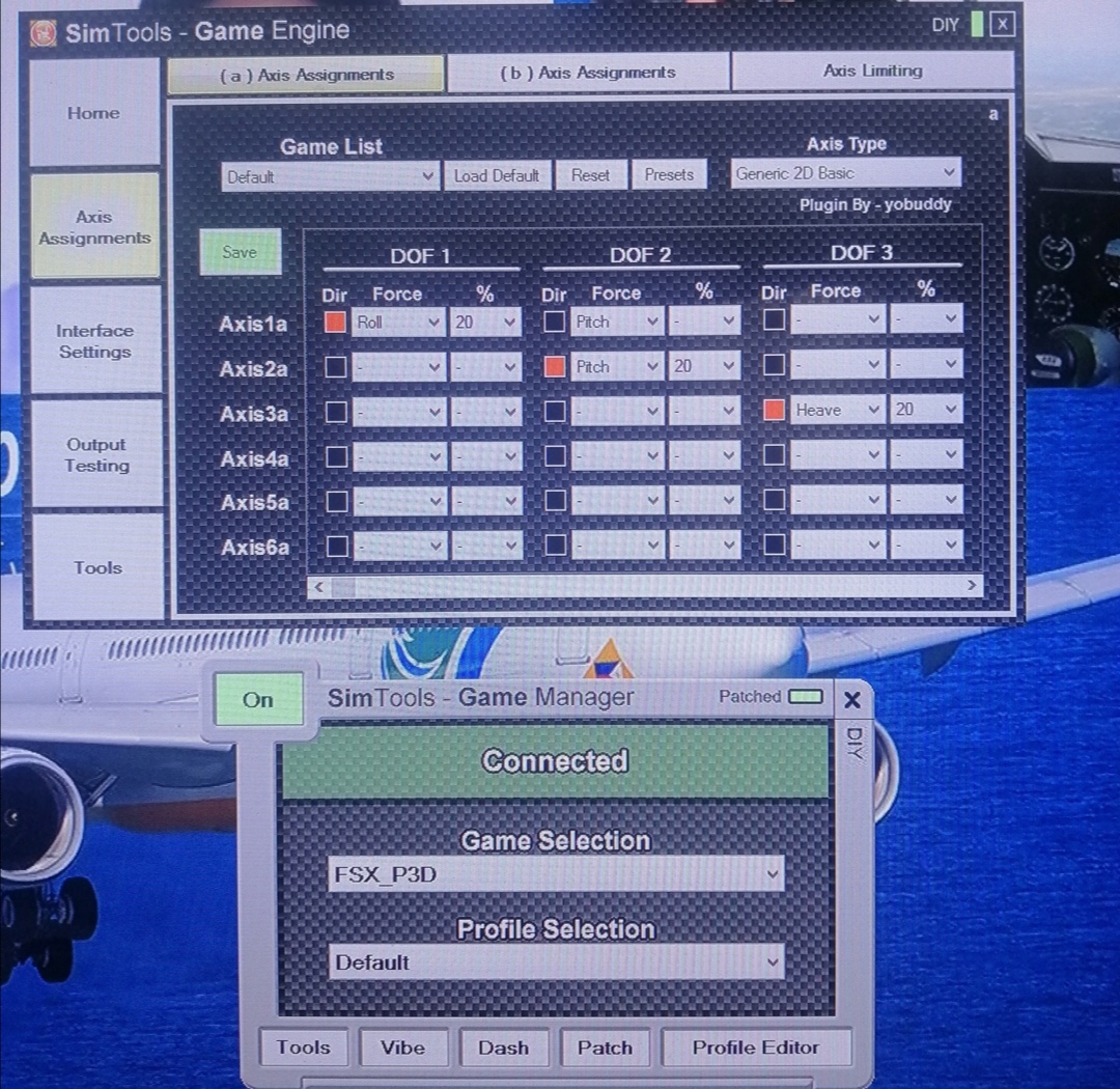

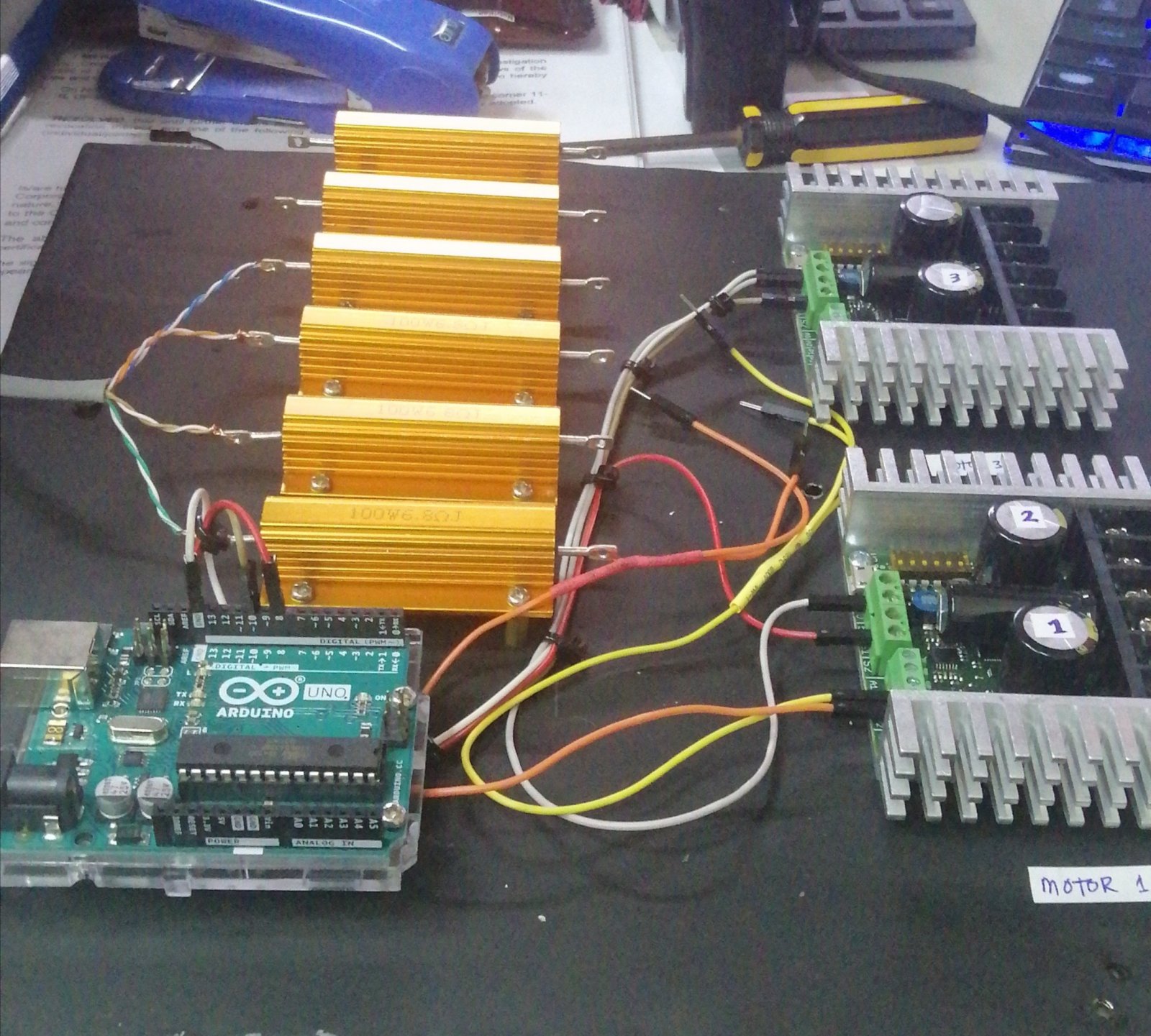

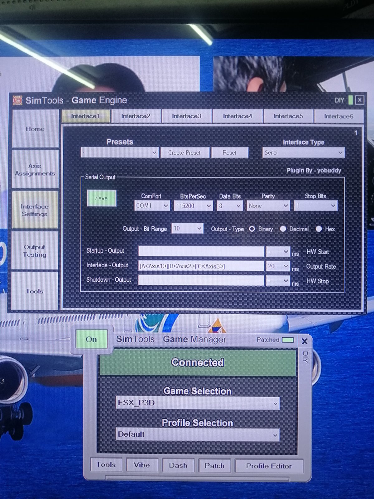

    Having a problem with the simtools to communicate with motors. I already upload the code XPID_SimTools1_71_6motors_2x32_serial_UNO @Wanegain but the same problem encountered. I really have no ideas if this is correct settings. See the below photos for reference. Can anybody help me to solve this problem? Thank in advance.

    First off are pots or Hall Sensors connected and the Arduino code properly configured, as there is no point messing with SimTools until the control hardware and code are properly configured.
    SimTools 2.0 Input Settings - The difference from SimTools 1.3 to SimTools 2 (which you are using) in setup is that in the Interface Settings instead of axis defined like this <Axis1> it now has designate grouping for a or b in SimTools 2 for each axis assignment, like this <Axis1a>

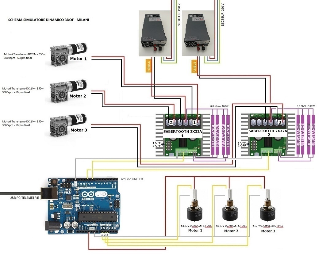

    Thanks for your quick response. I think I did the diagram correctly as seen below. When I started to turn on the device, the motor itself continuing to rotate. How does it happen?

    Got it, but i usually intend not to mounted temporary to see if the motors actually move and if does the pots will not damage coz my potentiometer is not 360 rotation. Eventually, as i expected the motor rotate by itself and i cant control it thru the simtool.
  17. noorbeast
    21,723
    152,051Coins
    +11,063 / 56 / -2
    SimTools can't control motor position by itself, the pots have to be mounted and the Arduino code properly configured.

    But how about this @Milani Fabio they did not connect the pot to the motors? but still, it's working.
  20. noorbeast
    21,723
    152,051Coins
    +11,063 / 56 / -2
    That video is just the motors rotating, it is not controlled via SimTools for motion.
