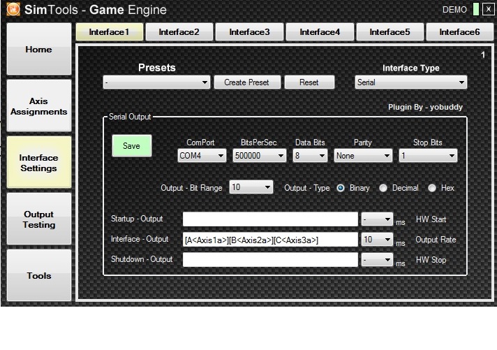

    SimTools 1.3 s depreciated and plugins are not maintained for it, so for that reason alone you should switch to SimTools 2. There is also a slight difference in Interface Settings which could be the reasonnSMC3 does not work.
    SMC3 should be fully configured and work as expected prior to using SimTools 2: https://www.xsimulator.net/communit...3dof-motor-driver-and-windows-utilities.4957/
    The SimTools 2 Interface Settings are configured as per the instructions, depending on the number of Axis:
    [A<Axis1a>][B<Axis2a>][C<Axis3a>]
    Set for 10bit binary output
    Baud rate 500000 , N , 8 , 1 (10ms delay)
    LFS needs to be run in first person mode prior to being patched for motion: https://www.xsimulator.net/communit...run-in-first-person-mode-before-patching.345/

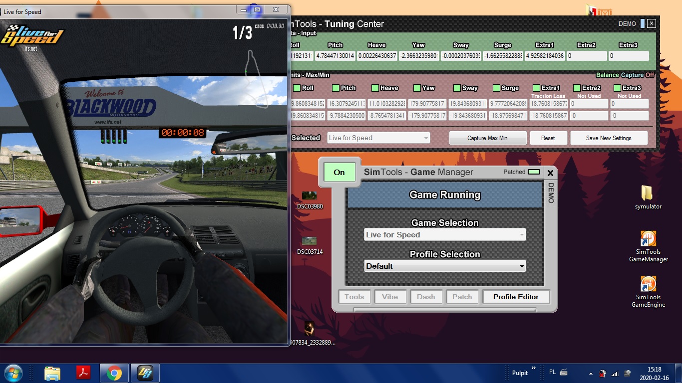

    I followed exactly these tips.
    The game is set up with SimTools but my engines stand still
    is it possible that I have to the paid version of Simtools - no not a demo like now ?
    21,592
    151,215Coins
    From the data in the tuning center input (at the top), SimTools is working, but you need to refine your motion profile, see the tips here, and initially start by doing one axi8s at a time.
    LFS also needs to be run once in first person mode before patching for motion: https://www.xsimulator.net/communit...run-in-first-person-mode-before-patching.345/
    If you did not run LFS un-patch it, run it in first person mode, then re-patch LFS for motion.

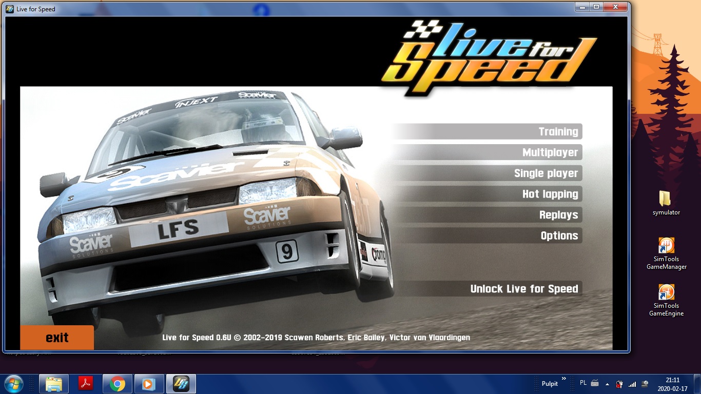

    Which means :
    "If you did not run LFS un-patch it, run it in first person mode"
    can you show me this option - where can I find it in the game?

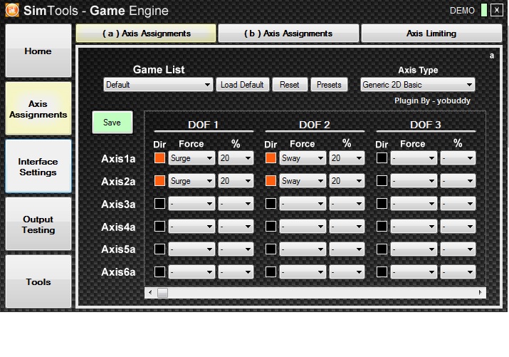

    maybe the problem is somewhere else because I can't test moves via the Game Engine?
  12. noorbeast
    21,592
    151,215Coins
    Are you saying that Output Testing does not work as expected?
    Is SMC3 properly configured and work as expected?

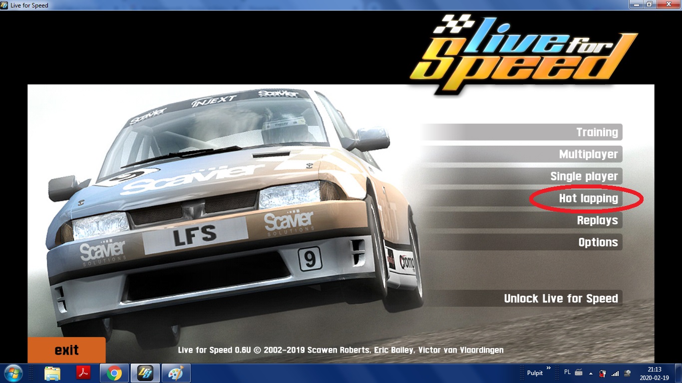

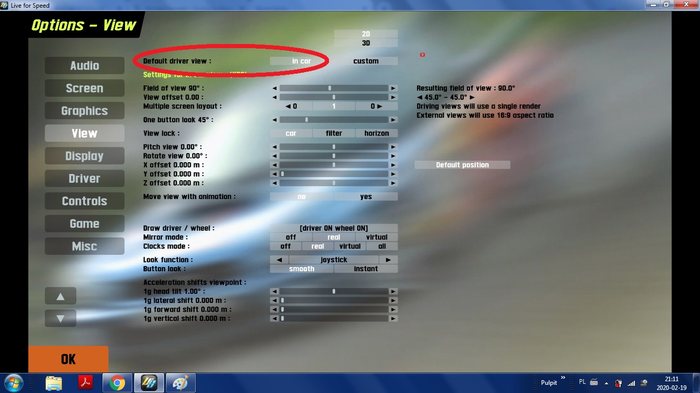

    21,592
    151,215Coins
    No you do not need a licensed version of SimTools for testing with Live For Speed.
    In the LFS menu choose Options -> Default Driver View : In Car. Then Back to the main menu and select Hot Lapping, choose the car and driver then run some laps.

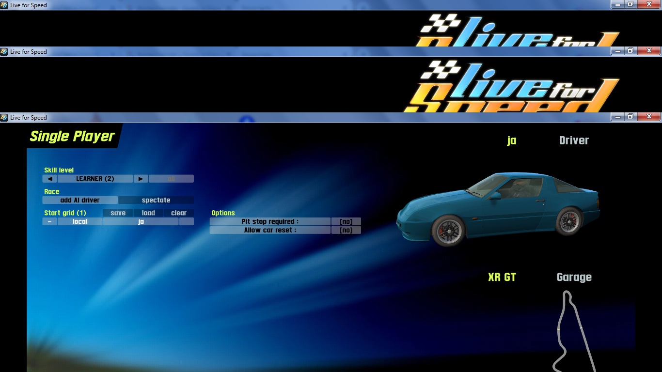

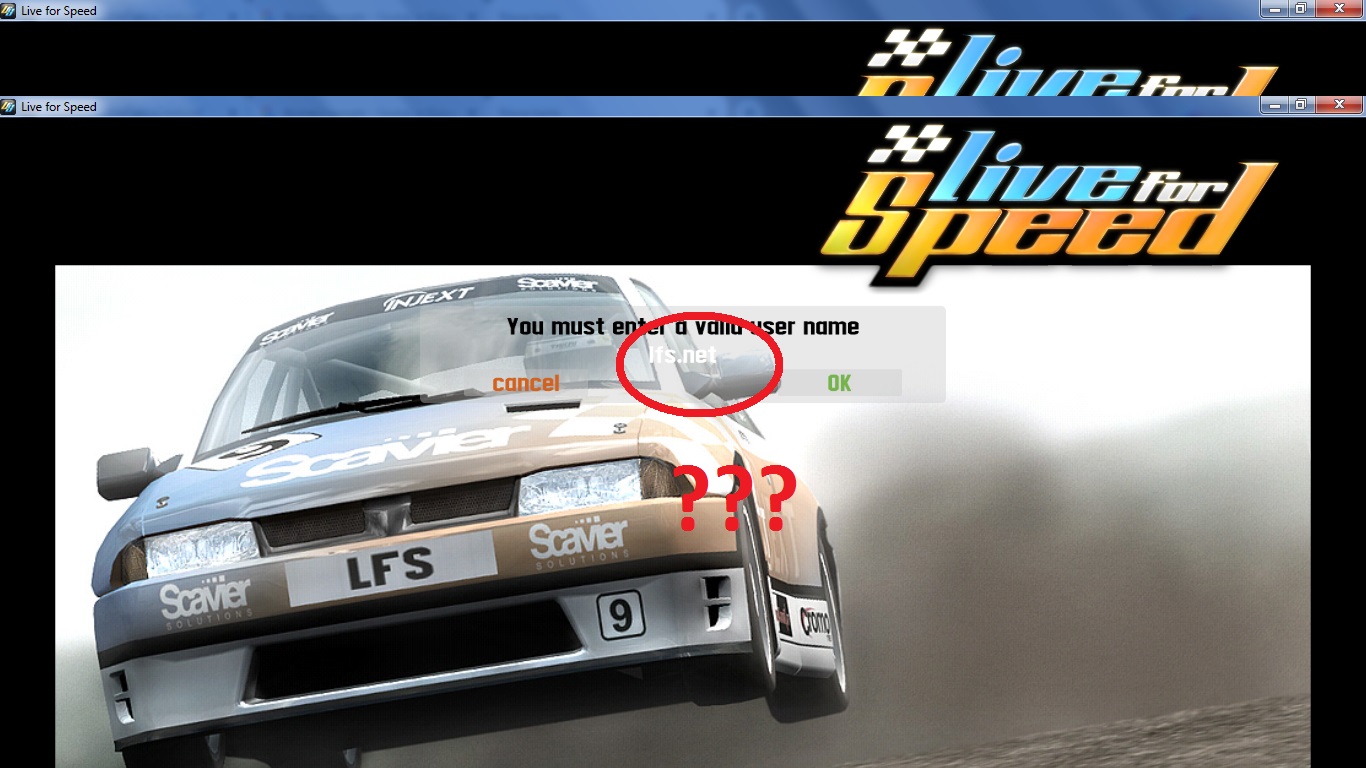

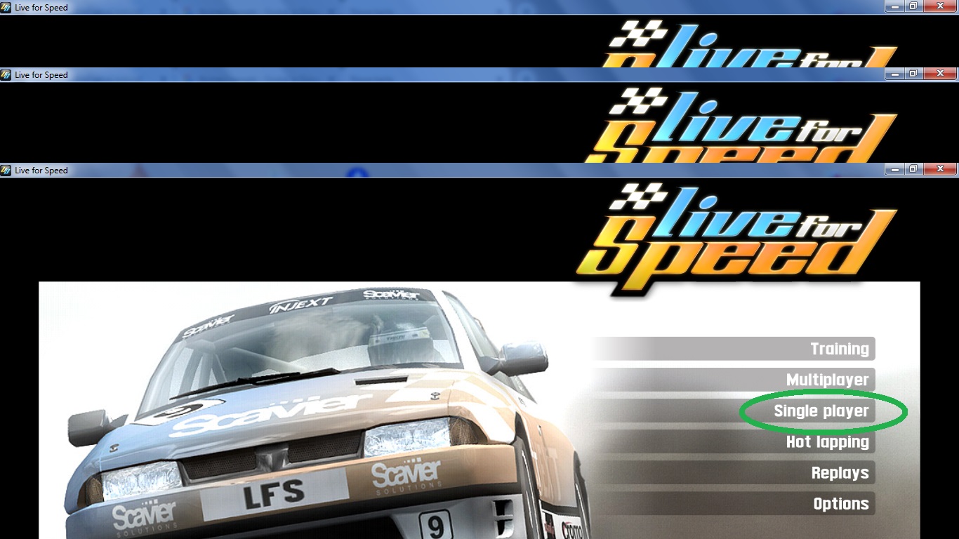

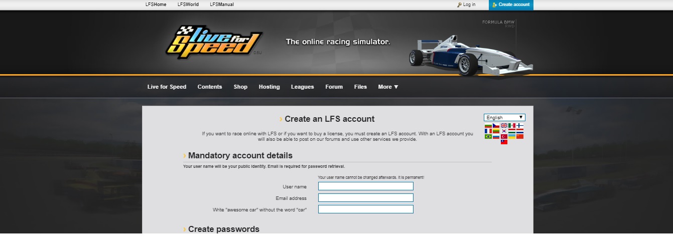

  15. Wojtek12
    Wojtek12 never say never
    Feb 9, 2020
    16
    mechanic
    Poland
    199Coins
    Ok
    But I have to register to continue :
    I understand a single player like this:
    then I can choose a driver, a car, do a few laps and as I said Simtool has readings from the game but not a simulator, I wrote it before. There are various suggestions on the forum that are contradicted
    https://www.xsimulator.net/community/threads/old-simulator-a-new-beginning.14291/
    , I did not know any step-by-step description, everyone has different problems and Simtools is one?
  16. noorbeast
    21,592
    151,215Coins
    Single player mode should be fine, I have a registered version so did not realise LFS needs registration for a hot lap.
    The SimTools manual is here: https://www.xsimulator.net/community/faq/rtfm-start-with-the-official-simtools-documentation.117/
    First make sure you have a Default profile setup in Game Engine, then check that the rig moves in Output Testing, this must work before bothering with anything else. If so configure which way each axis moves, as SimTools expects: https://www.xsimulator.net/community/faq/which-way-to-set-simtool-axis-movements.230/
    If that goes OK then un-patch LFS using Game Manager, do a race in LFS, re-patch LFS. You should then have basic movement in LFS. Then follow the profile refinement tips here: https://www.xsimulator.net/community/faq/steps-to-create-a-motion-profile.228/

  20. CrazyNuf
    CrazyNuf Road & open-wheelers
    Jan 22, 2020
    23
    NDE
    Charlotte NC
    - 57Coins
    +8 / 0 / -0
    2DOF, AC motor, Motion platform
    @Wojtek12, did you take a look at the tuning center while the game is running? It should show you the game input values as they are happening. This should then show you what you want to put into your axis settings
