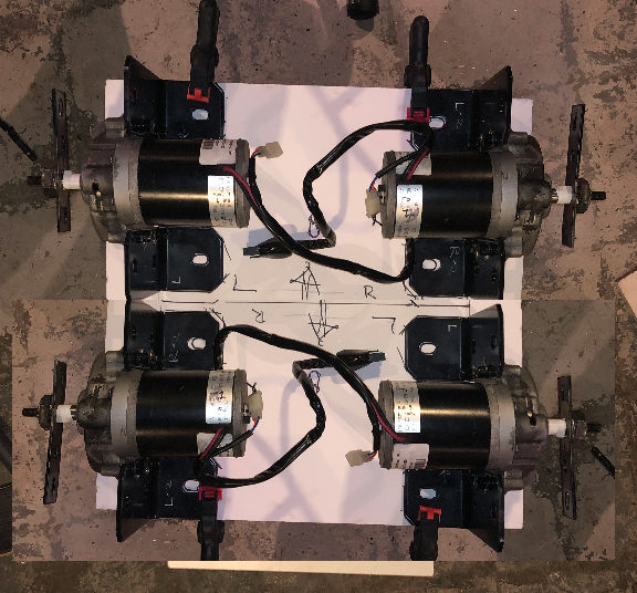

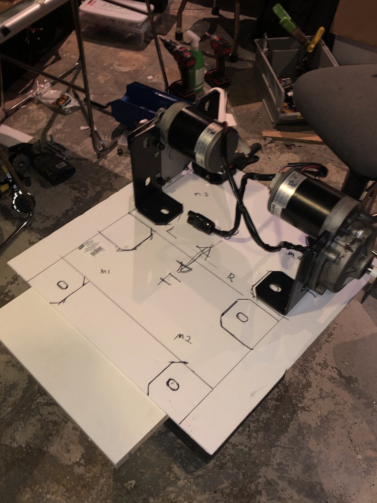

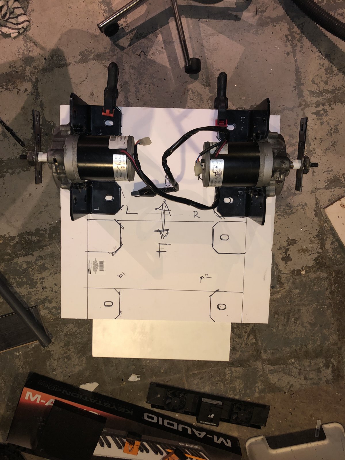

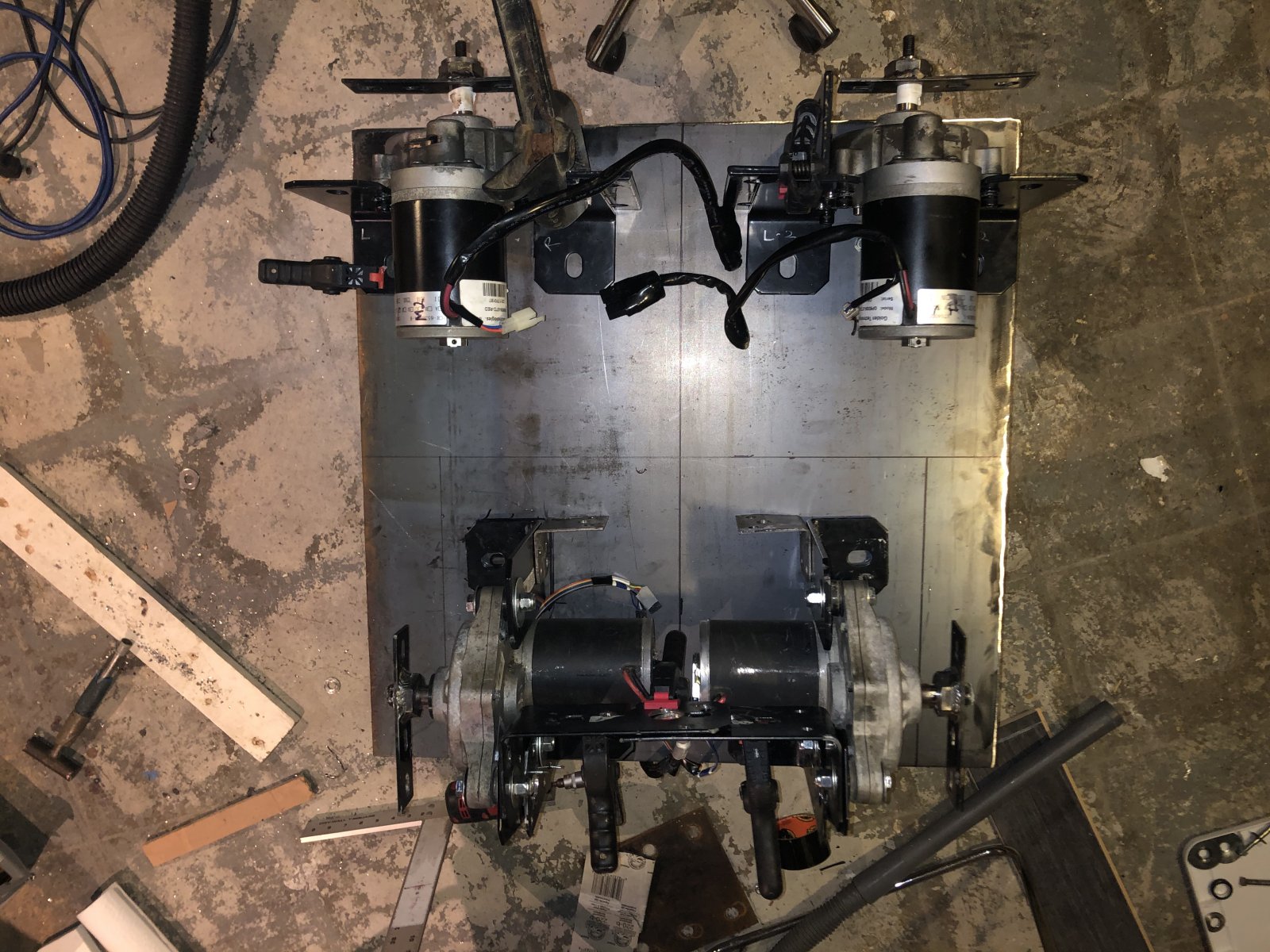

    THX YOU SOOOOO MUCH.. this is perfect.. few questions before I whip out the torch..
    Q1 is the Mega cable of running 2 Sabertooth 12/32?
    Q2 @noorbeast you had said that the need to be equal distance i have attached some pics
    Q3 will this design give me full DOF, if not what will it give me
    Q4 IF I had 2 more motors should i add them or will the 4 bee good for Drive/flight
    I'm planning on a 1/8 24x24 sheet of steel, weld motor mounts to sheet and weld in bracing for the motors, attach arms to 24x24 platform above
    I haven't decided on hight from the base thoughts?
    I'm looking for AS much (design input) and suggestions as possible.
    THX ALL

    Use an Arduino per Sabertooth.
    The design, as I understand it, will be 3DOF, as it includes heave, but it could be 3DOF + sway, as per design comment and video below.
    Motor wise you need enough power to drive a given design at a desired performance level, hard to say what the motors are capable of and the design trade offs. Either experimentation or calculation will be needed.
    The base needs to be suitably braced so there is no flex.
    Design wise I would suggest a pivot frame , there are a number of ways it could be done but here is one example by @prilad:

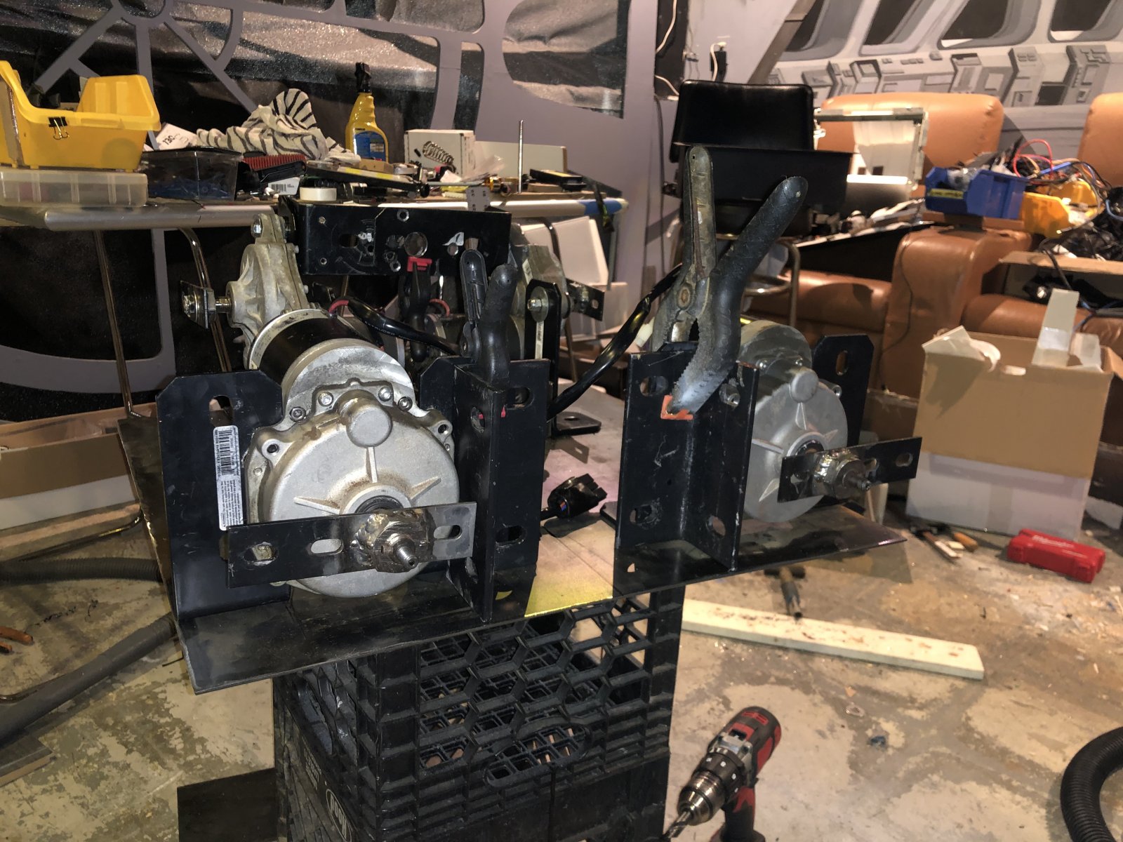

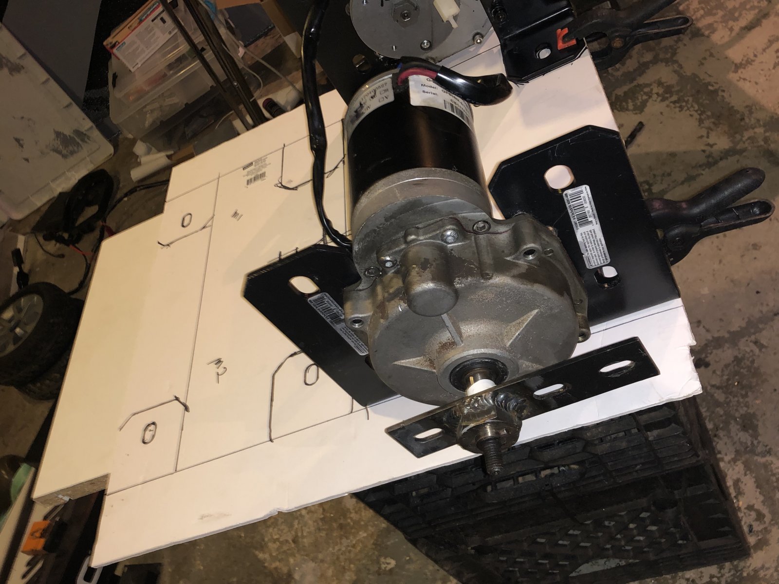

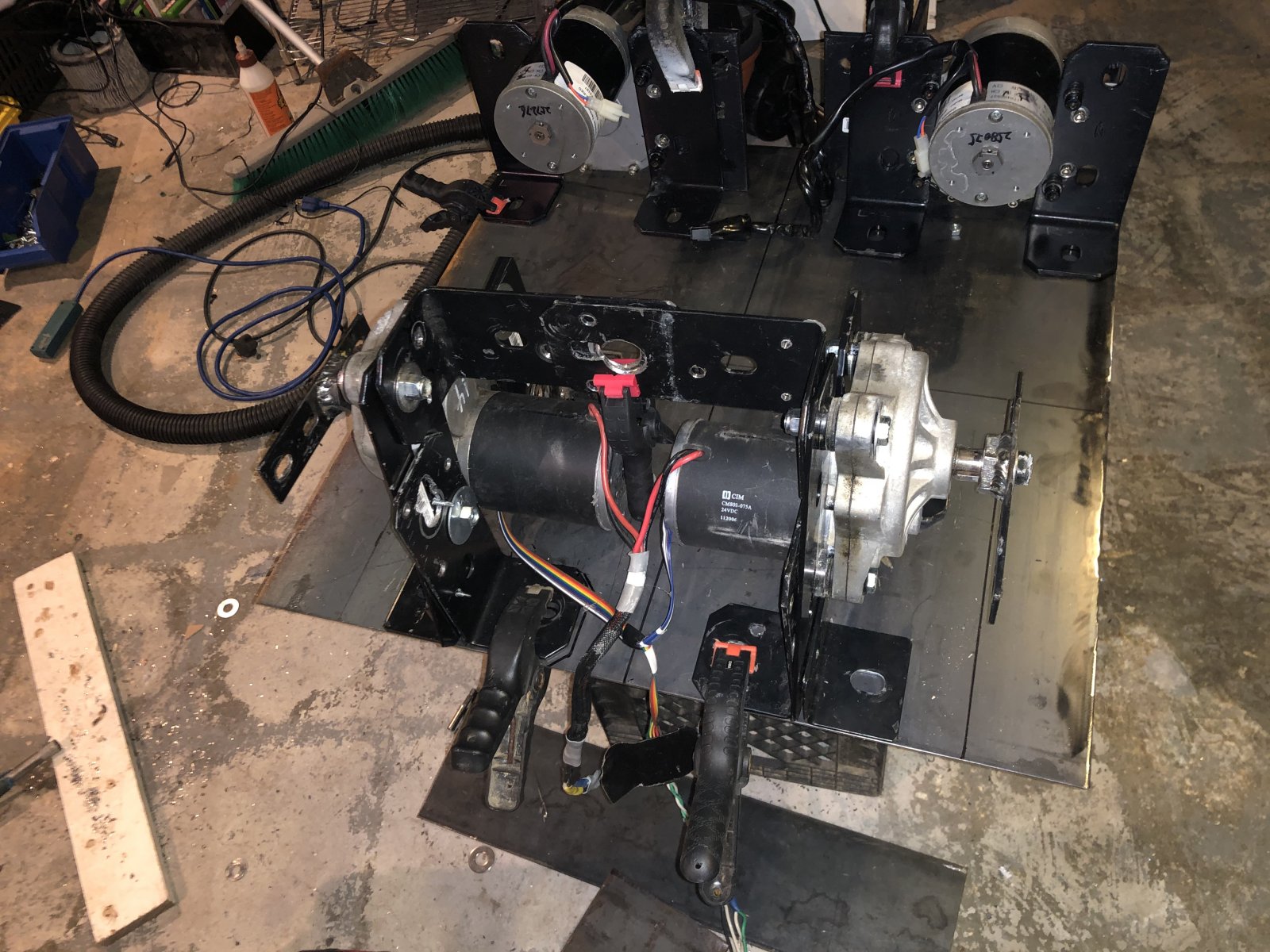

    @noorbeast UPDATE
    ok, its all Mocked up for welding, what do you think? I'm sooo excited the 2dof was fun but i need way more.. I hope this does the trick.
    20,534
    145,028Coins
    +10,776 / 52 / -2
    How stiff is it, there should be no flex even under extreme load. I even run a cross brace between the 2 font motors of my compact rig, to add rigidity:
