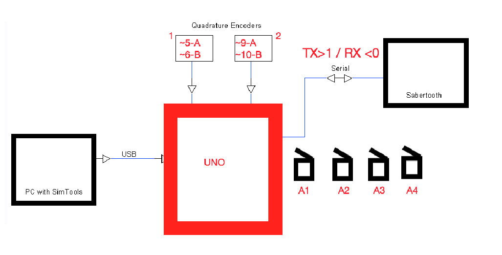

    I was asked to post the Arduino and Processing3 files from my post:
    https://www.xsimulator.net/community/threads/2dof-with-wheelchair-motors.7905/page-2#post-125188
    Meant just for the sake of interest.
    At this moment these codes are NOT meant for members without Arduino- and Processing- programing skills.
    They are written to meet my hardware requirements. (2 motors with quadrature encoders, bluetooth interface, Sabertooth 2x32)
    About SMC3 and Quadrature encoders:
    In my opinion it's not possible without big changes. The SMC3-code reads the analog inputs(feedback pots) and calculates PIDs about 4000 times per second. So it's too busy to do deal also with encoders. But this high rate is not necessary. The values from SimTools come only 100 times per second(every 10msec).
    So i've decided to do PID calculations(now with floating point numbers for a better resolution) 125 times per second(every 8 msec). So there is enough time for the encoders and serial transmissions.
    Quadrature encoding needs a lot of Ard. performance. (max frequency is about 100kHz)
    For example:
    A motor with 3600 rpm and encoders(with 500 pulses per turn) mounted on the motor shaft = 30kHz count frequency.
    Because i needed other adjustment possibilities, but having no access to the SCM3Utilities-code, i've decided to write my own GUI with Processing3.

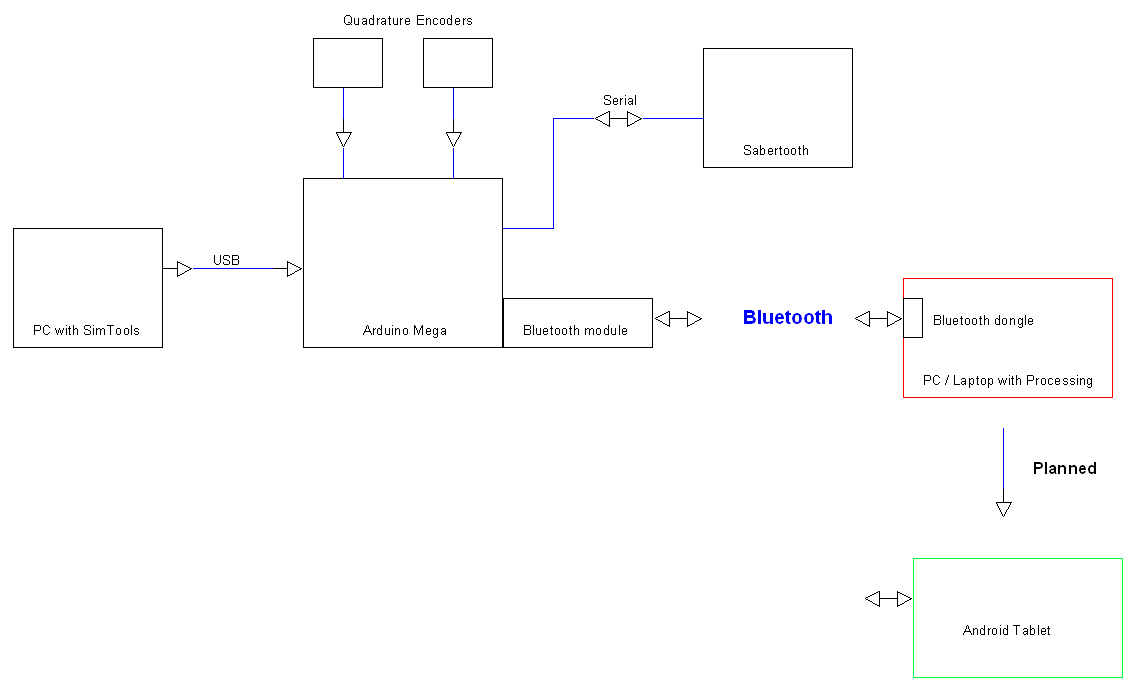

    Here is an overview:
    Processing is used to set the PID parameters and watch the movements of the sim.
    But it is unhandy to work with an extra PC to do this.
    The good news:
    Because Processing is based on Java, it has an Android mode to write Apps.
    My goal is to transfer the Processing sketch to an App running on a tablet.
    For those members who do not know Processing:
    It is a sister project to Arduino and meant for all kinds of visualsations.
    It's also open source, has a simular gui, almost the same syntax and as many libraries available as Arduino.
    But it's based on Java, in contrast to the arduino code, based on C++.
    Arduino and Processing are a perfect combination.

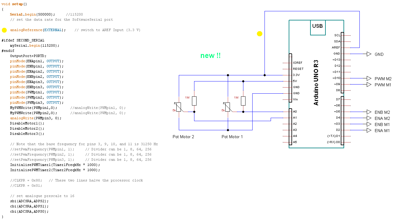

    Hi @Bernd Manger,
    I'd love to get SMC3 running on my rig but I'm using encoders.
    I thought your SMC - S was the solution but just to be difficult I'm using-
    "MODE2 for a 43A "Chinese" IBT-2 H-Bridge".
    I'm using two motors/drivers now but will have three in the future.
    Can you give some guidance on the pin assignments for the IBT-2 as opposed to the
    Sabertooth 2x32?

    I have a little test bench set up with UNO(on COM 4), IBT, small 12v motor with a reduction gearbox and pot.
    Have edited SMCutils.cfg > "COMM_PORT=4"
    SMCutils is loaded to board but can't establish comms with arduino smc.
    The motor does respond to pot input.
    Is there a baud rate or something else I'm missing?
  17. Eli Wizard
    Eli Wizard New Member
    Jan 22, 2017
    12
    Ottawa
    32Coins
    Ha!,,, I had serial monitor on in IDE.
    now I'm cooking with gas.
    thanks for the pinout info
