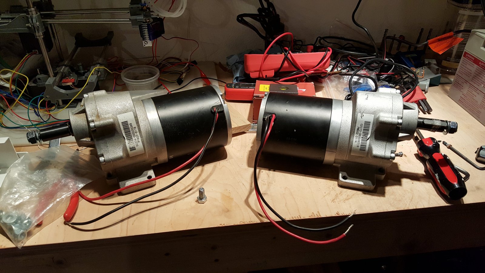

    Slowly but surely gathering parts.
    Motors purchased off ebay. $50

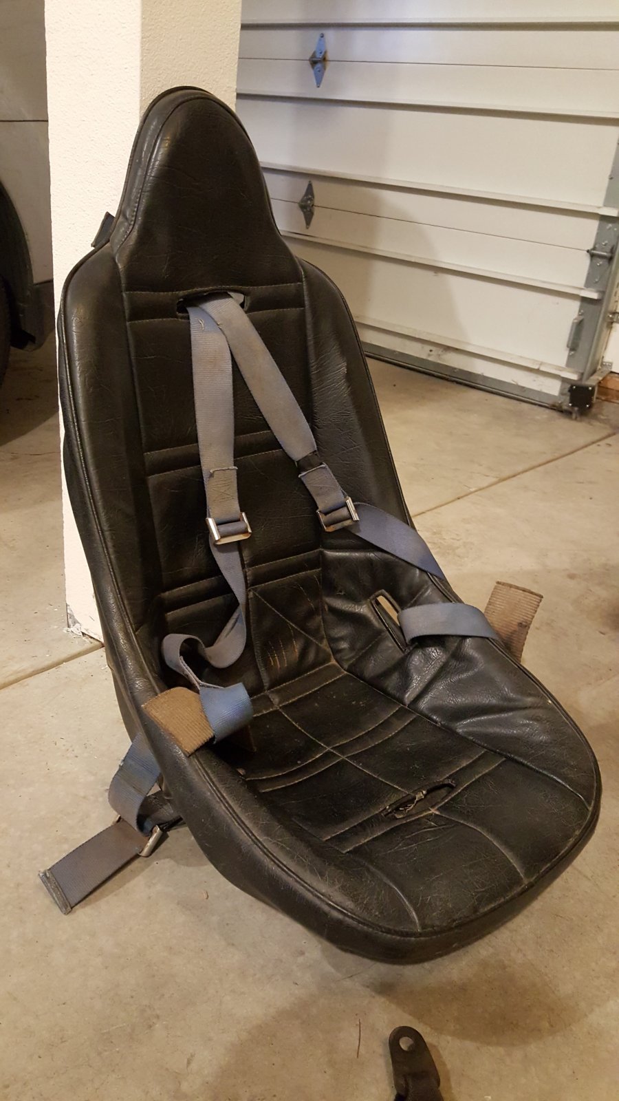

    Found a cool vintage seat on the local Craigslist. $20

    They are 24v wheelchair motors. I believe they are from a Pride Jazzy 614 HD wheelchair, according to my google search. The motors are marked CM808-110B. Output after the gear box is ~120rpm at 24v. They seem really nice to me, although the inline gearbox can be backdriven easier than a 90 degree gearbox. I can turn the gearbox shaft very slowly by hand if I really really crank on it... not sure if that will pose problems down the line but I doubt it. I can pass along the ebay seller's name if you are interested. It looks like they have a ready supply of them available.

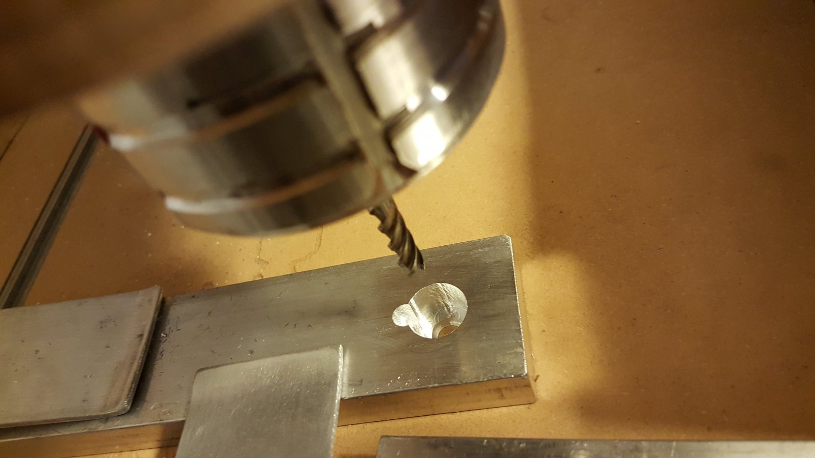

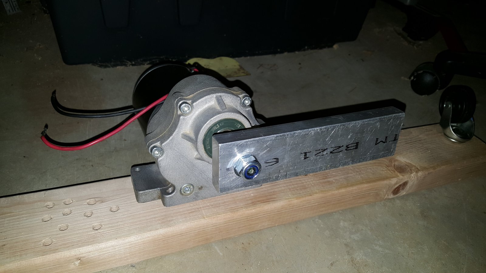

    Update on my progress thus far. Realized my sanity was more important than dealing with the shoddy monster moto boards so I splurged for a 2x32 Sabertooth. Definitely money well spent.
    Took my first foray into milling aluminum on my DIY CNC router to cut some 17mm holes and keyways for the lever arm. Turned out great in my opinion!
    Now on to finding a universal joint and ordering some of those fancy rotary hall effect sensors!

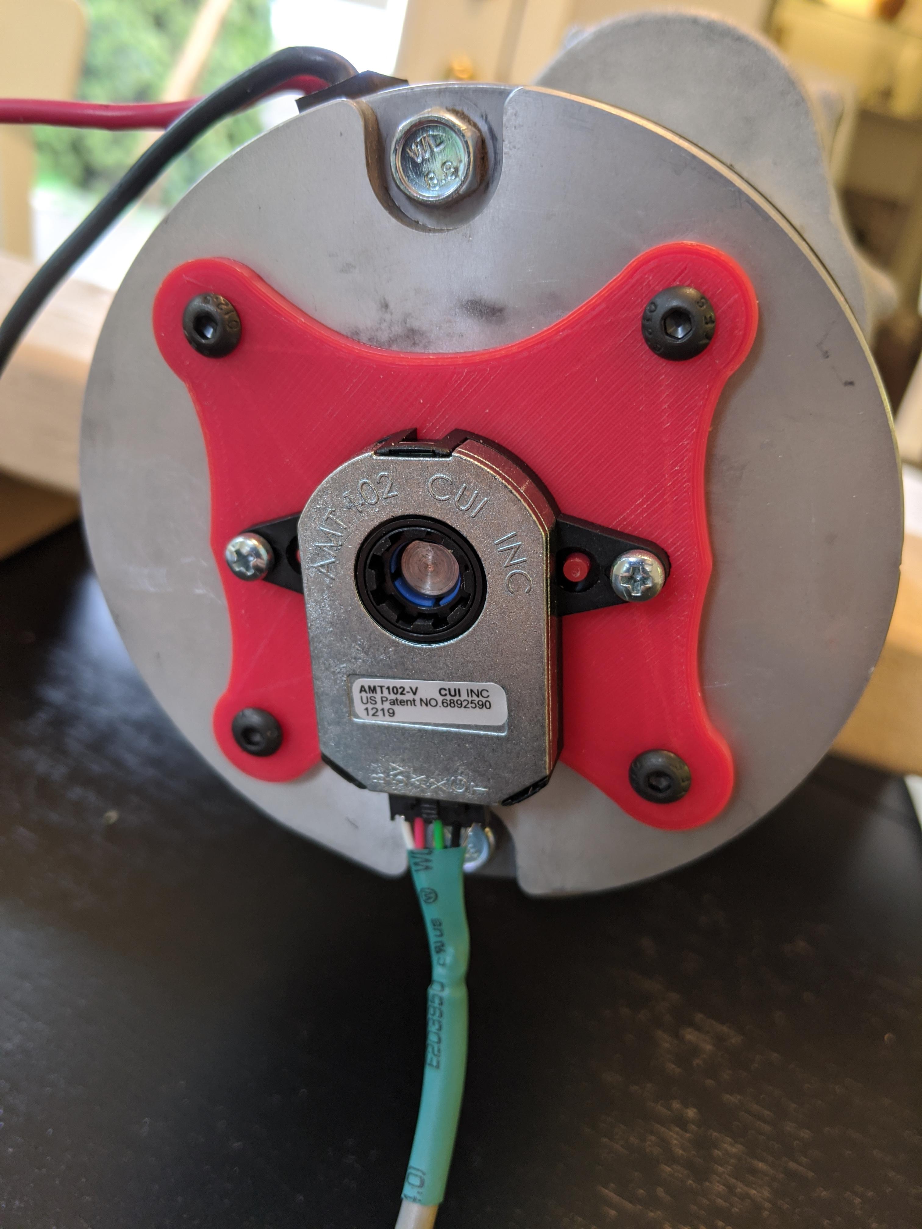

    Nearly two years later and I've decided to pick up this seat mover project again. The lack of free time, wifely concerns about finding space for the rig, and inelegant solutions for positional feedback led me to put the project down and step away. Free time and spousal approval are still lacking, but I finally settled on a positional feedback strategy that I like.
    I purchased a Kangaroo X2 motion controller from Dimension Engineering to pair with my Sabertooth 2x32. Since I don't have an easy way to mount a potentiometer to the output shaft of my gearmotors, I opted to put a quadrature encoder on the motor shaft itself. The motors have the short 8mm shaft exposed on the opposite side of the gear box so it was relatively easy to 3d print an adapter plate and mount encoders. I'm using ATM102 encoders and will incorporate limit switches for homing.
    Last night I got my test setup working with SimTools. Took some focused reading of the Kangaroo X2 manual and relevant postings on this board to get serial communications working correctly, but in the end everything was moving as it should. Loving the resolution of these encoders! Provides wonderfully smooth operation with ~5000 discreet positions within the 90 degrees of travel on the gear shaft.

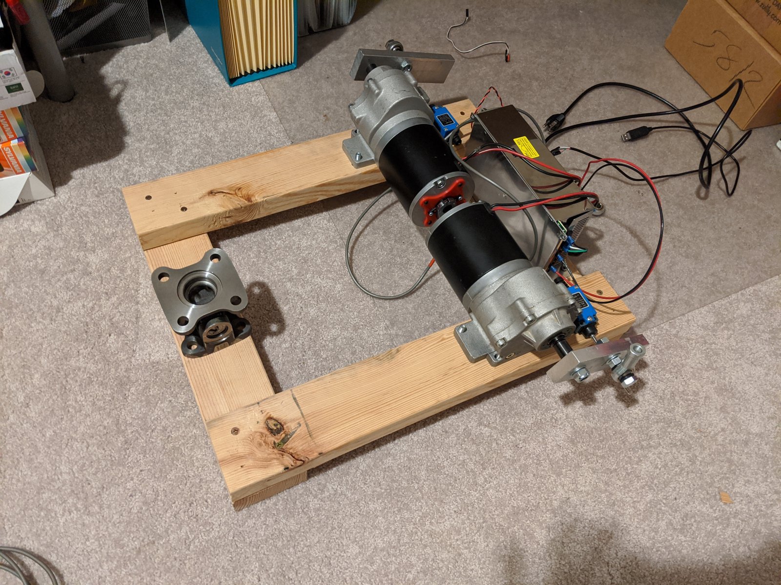

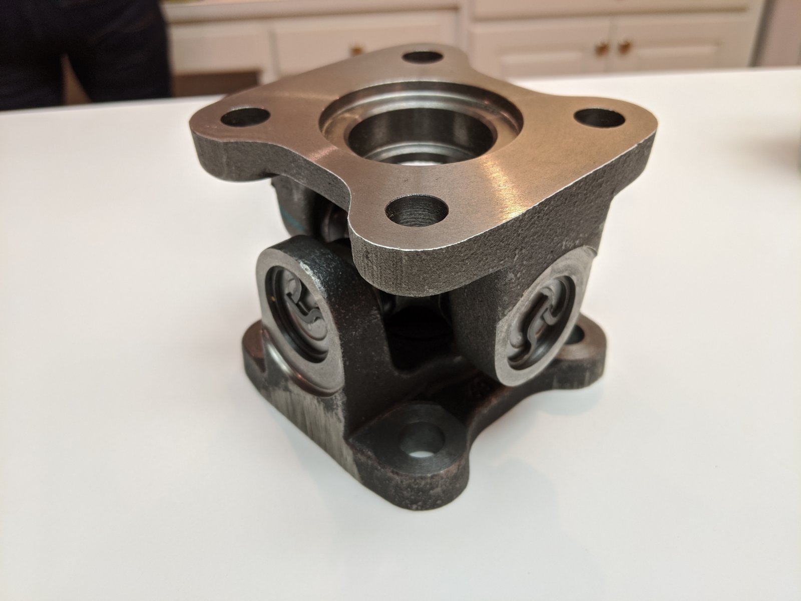

    Slowly but surely moving along. Universal joint is complete. I ended up ordering two Spicer yoke flanges (part 2-2-939) and a Moog 369 universal joint (bearing?) to make what I needed. Took a bit of work to press the caps on with a c-clamp and a hammer, but finally got it together.

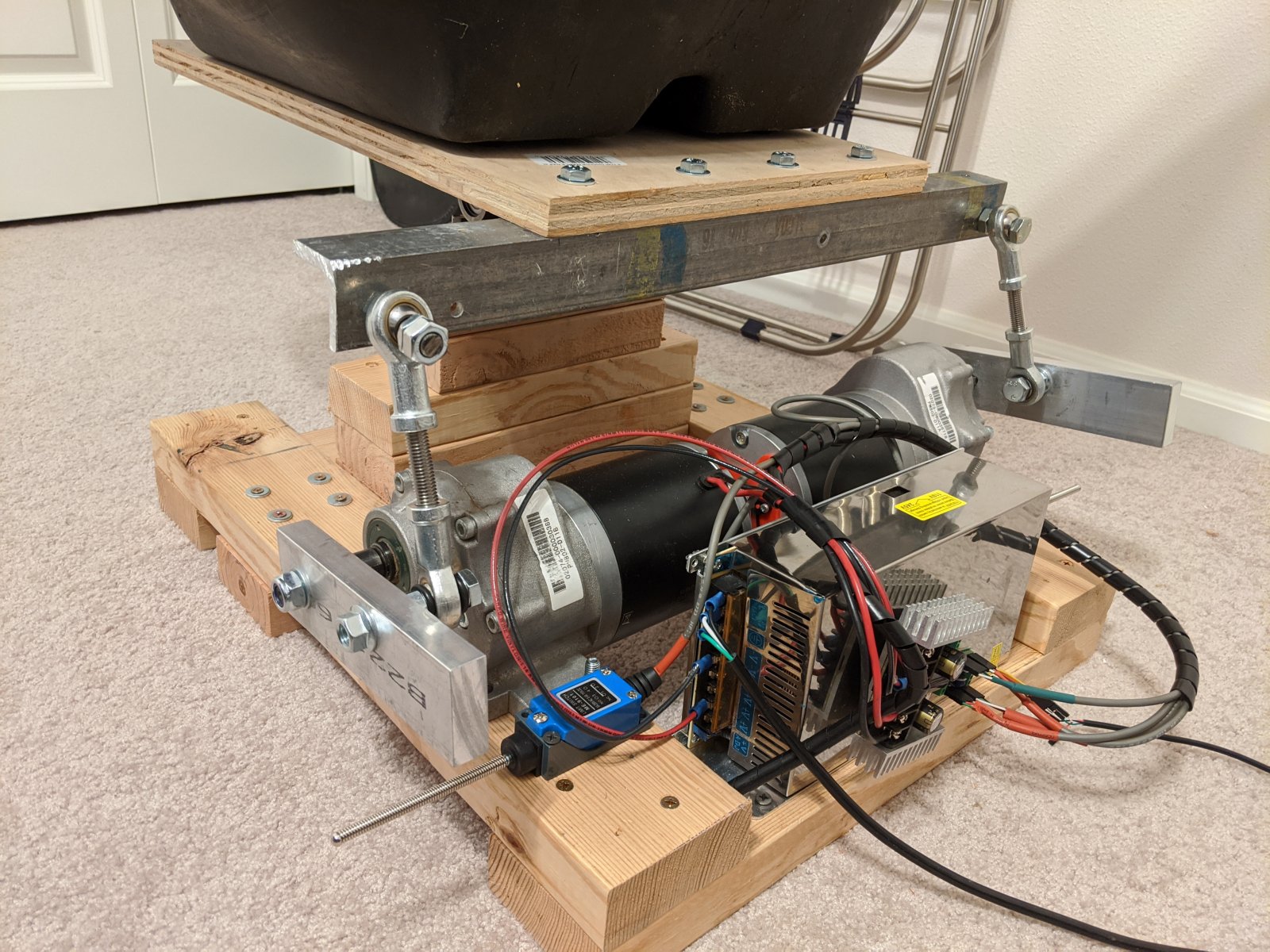

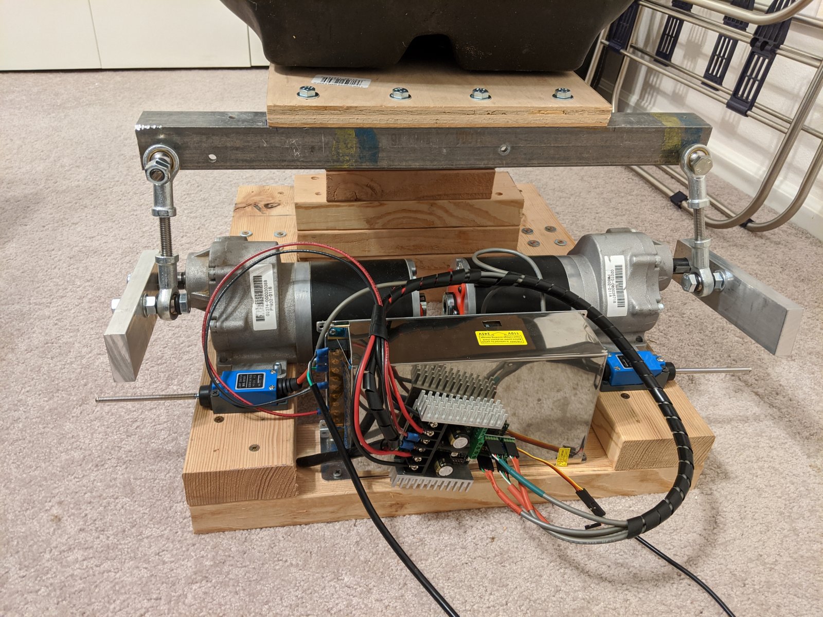

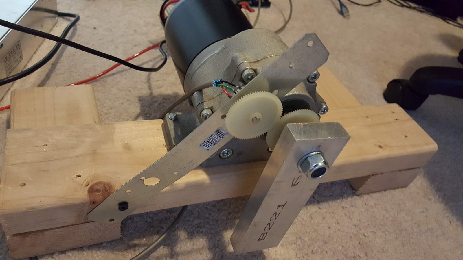

    I started mocking everything up on a wood stand to get the geometry right before I figure out how I want to fabricate a more sturdy base. My goal is to have this a compact build and I think it's looking good so far.

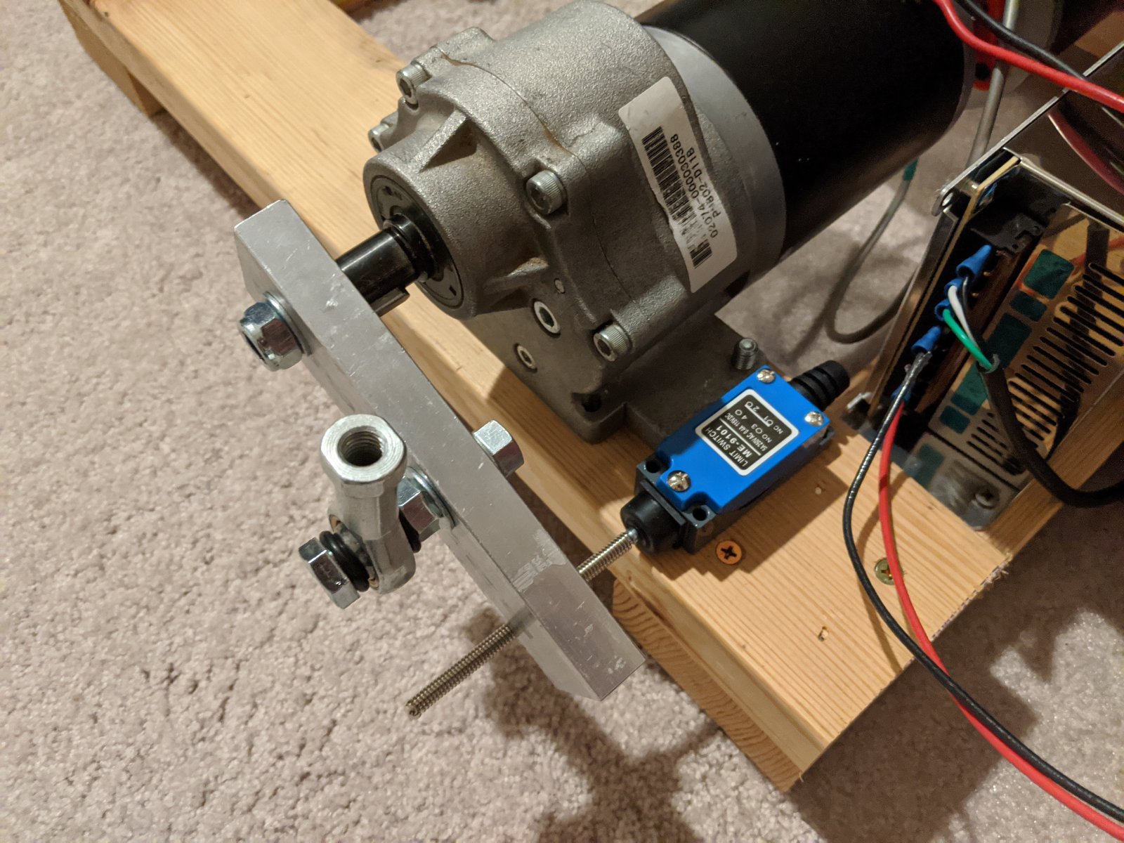

    Also added a single limit switch to each motor so I can home the motor orientation on SimTools boot up (still need to get these wired). Only $10 for both these switches off eBay...

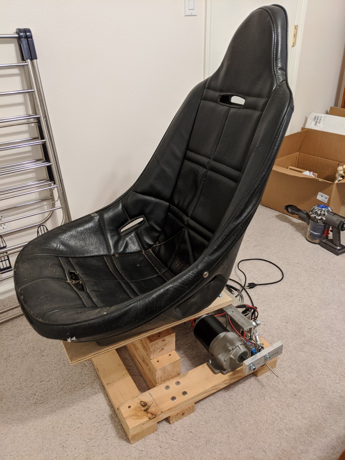

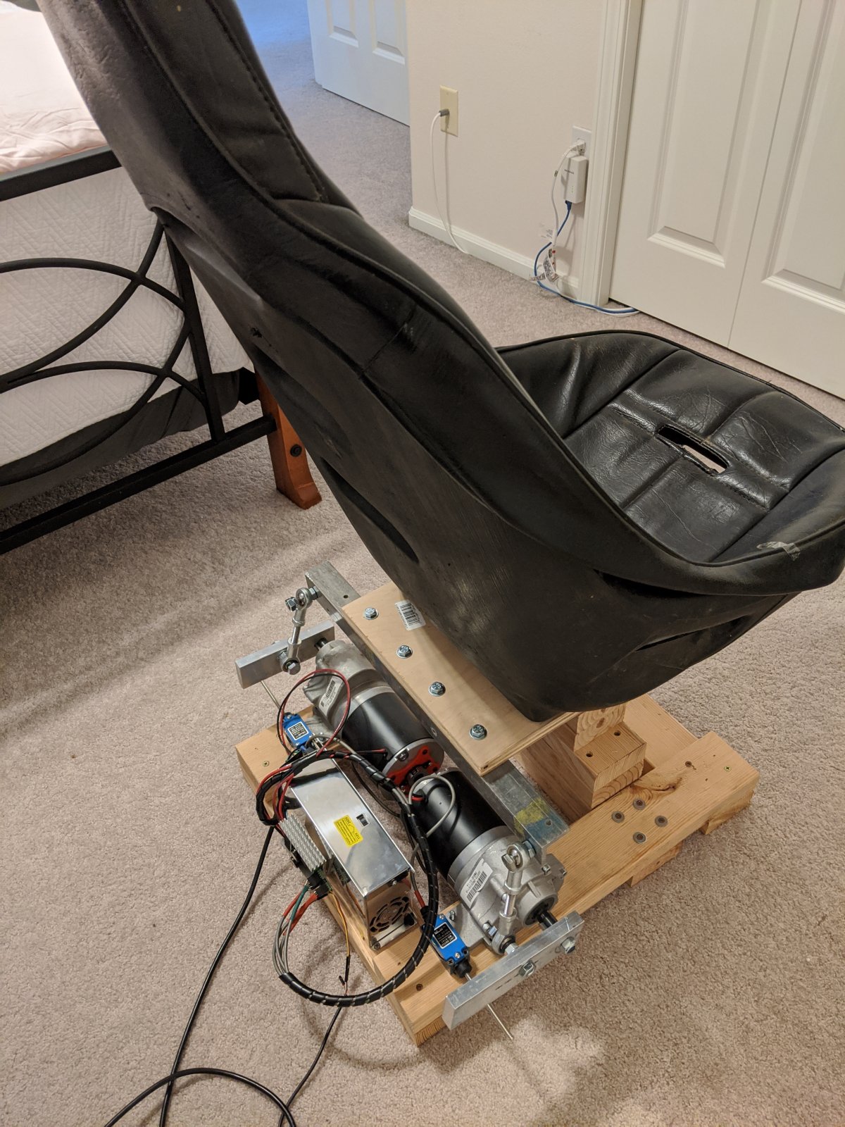

    Well, two years after I started the project I'm finally nearing the finish line. All it took was a global pandemic and stay-home order to find the time to finish putting it all together. I did a little testing in LFS to make sure my geometry was right then tightened everything up. Had to scrounge around the garage to find all the nuts and bolts I needed, but made it work in the end.
    Unfortunately, my simulator doubles as my desk and is currently disassembled so I can work from home. I plan to pull out my wheel this weekend and give it a proper few laps!
    I really appreciate all the help documentation and forum posts on here... It really made building this possible.
