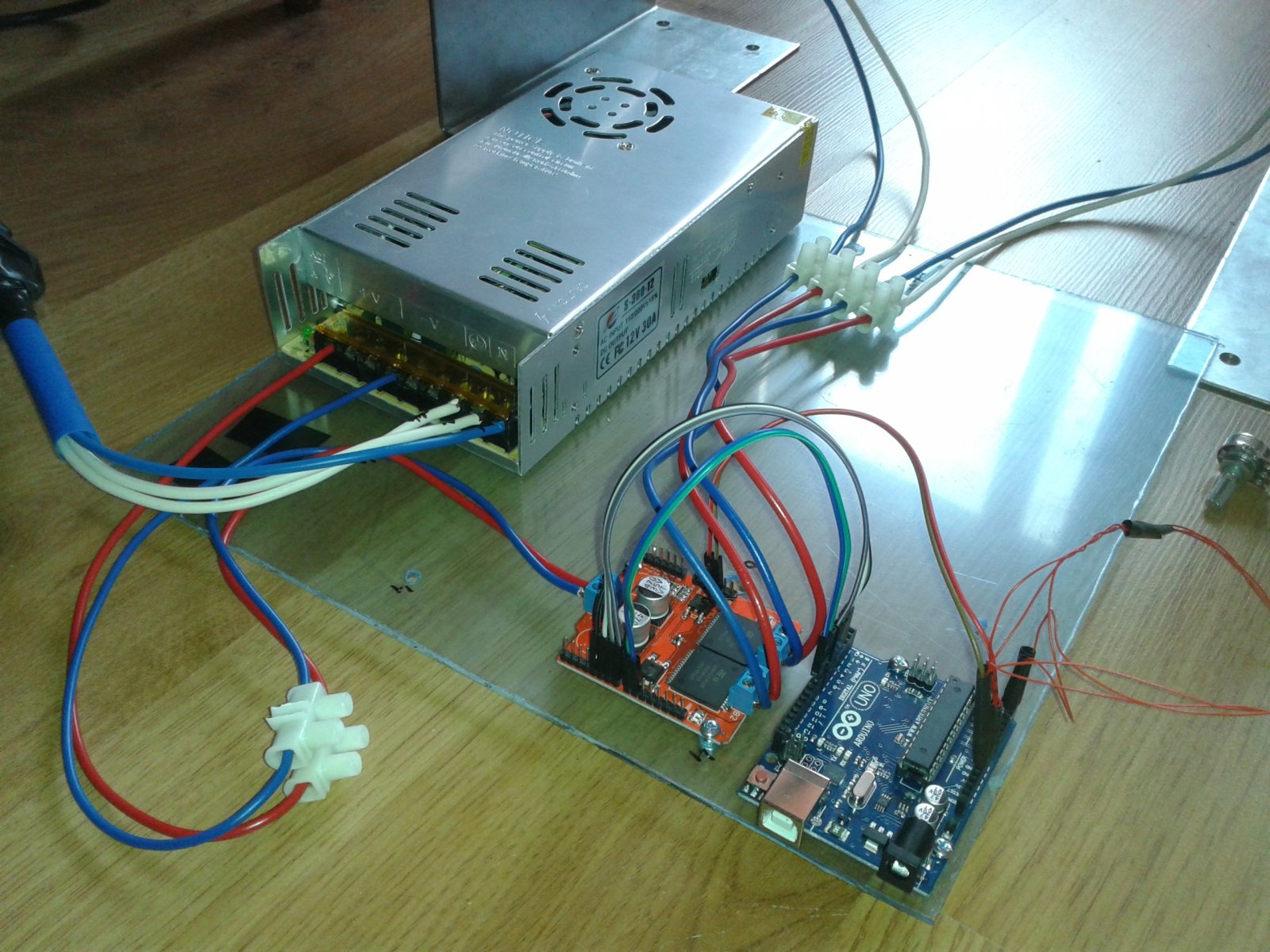

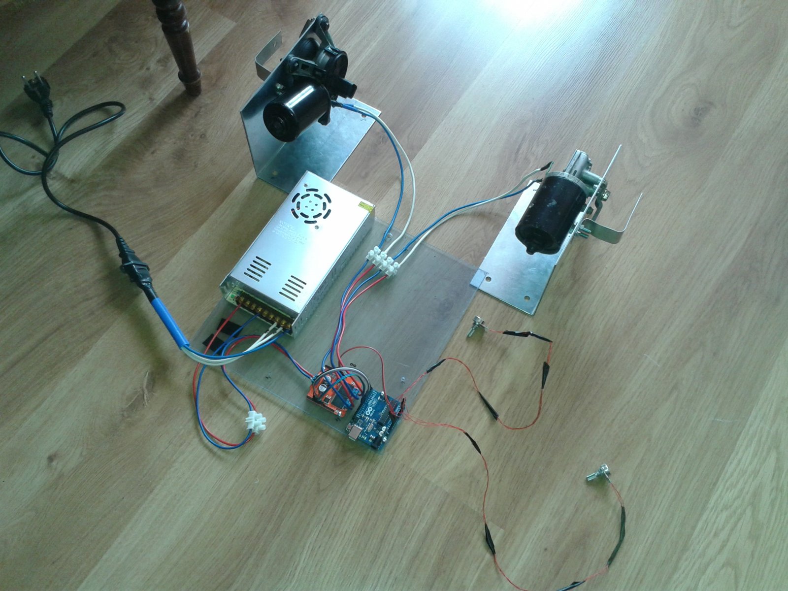

    Hello all. Im a new noob with bad english who started to build 2 dof simulator. Now what i have:Arduino Uno R3, 2 pcs wiper motors ( got it olmost free ), 2 pcs pots 10K, Monster moto motor driver, 12V 30 A power supply.

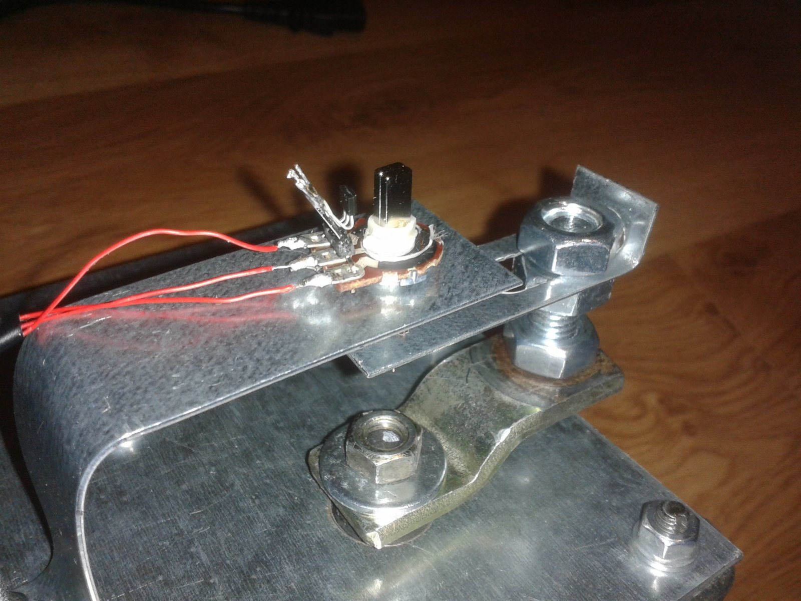

    Wiper motor ground isolation is ok. Followed the advice of bsft.

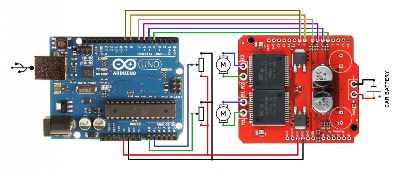

    Used MonsterMoto Shield Example Sketchdate: 5/24/11code by: Jim Lindblomhardware by: Nate Bernstein SparkFun Electronics, to test my connections. Both wiper turns from one side to another. Tested without pots.
  4. Arunas
    Arunas Member
    Feb 27, 2017
    50
    Lithuania
    2Coins
    +26 / 0 / -0
    Used this example to connect everything.

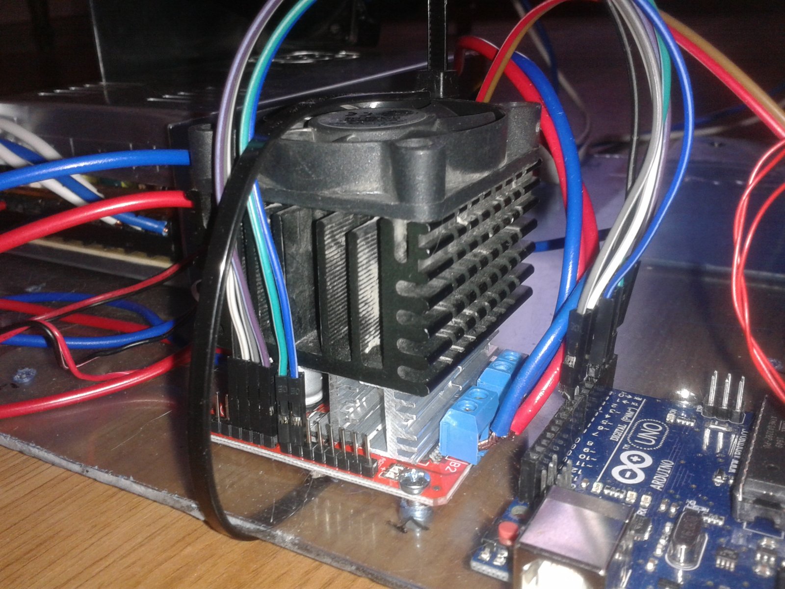

    Thank you noorbeast for your replay. I will try SMC 3 firs. But first I need cooling fan on my motor driver modul because it is very hot and read more FAQ.

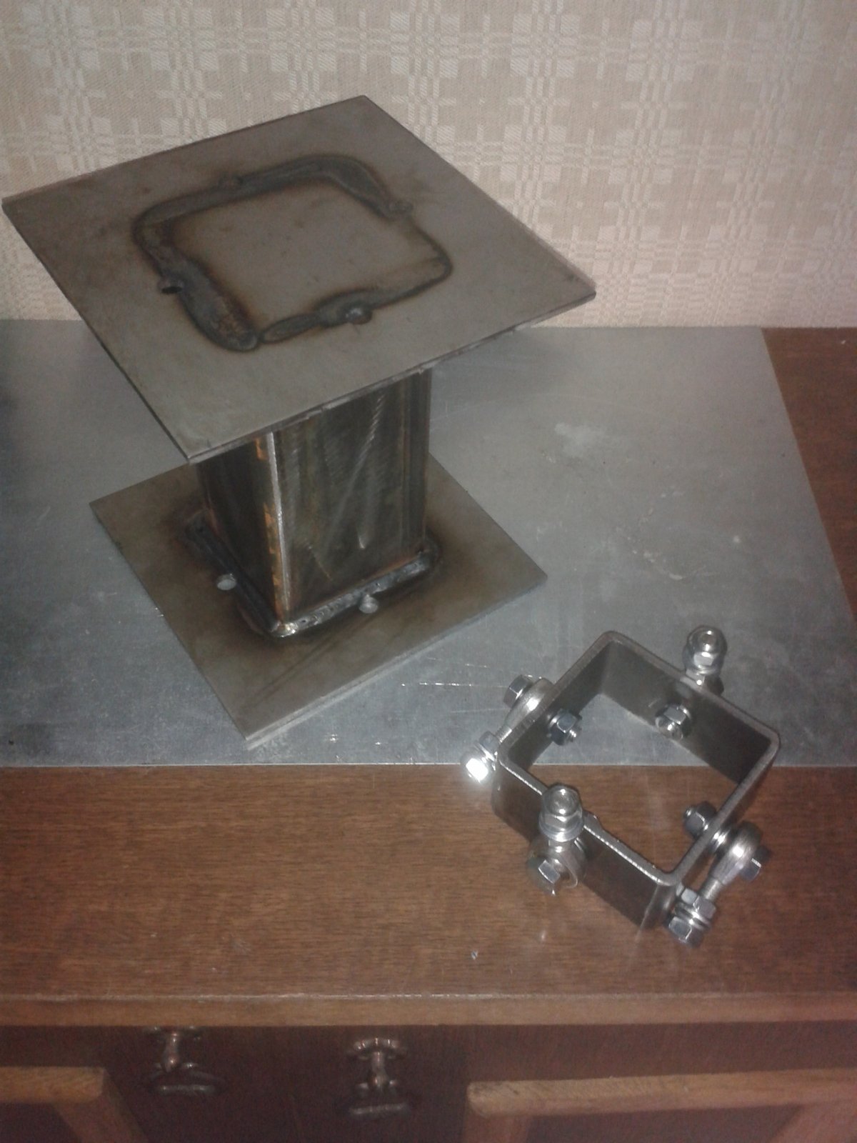

    Some parts of my future moving seat.

    I placed cooling fan on my motor driver modul. Now the temperature is ok. Worked about an hour without heating.
