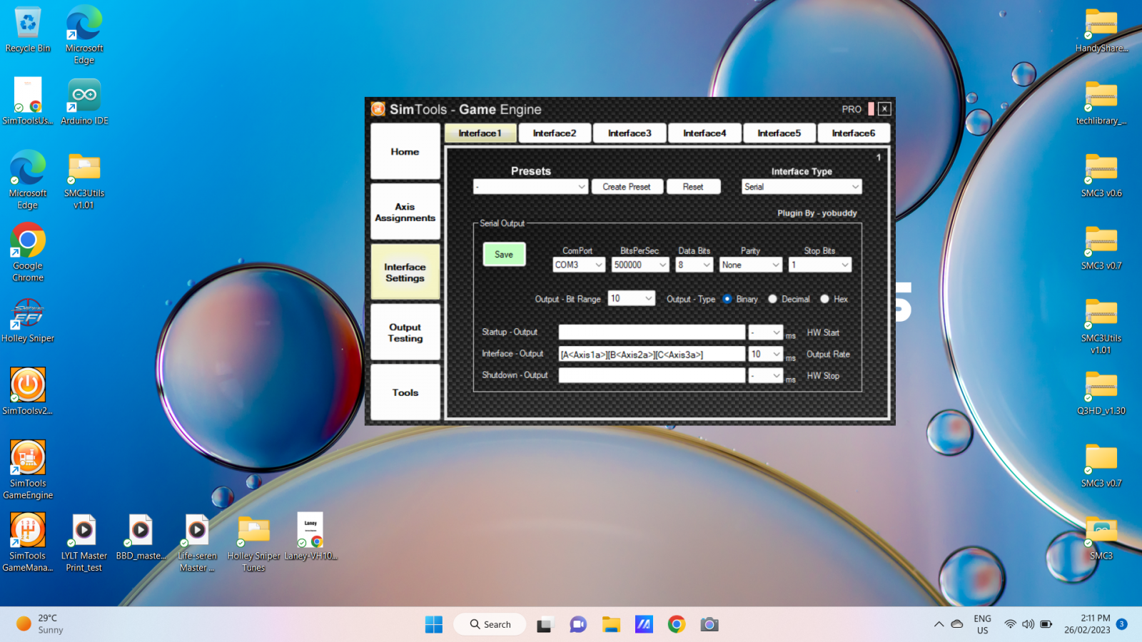

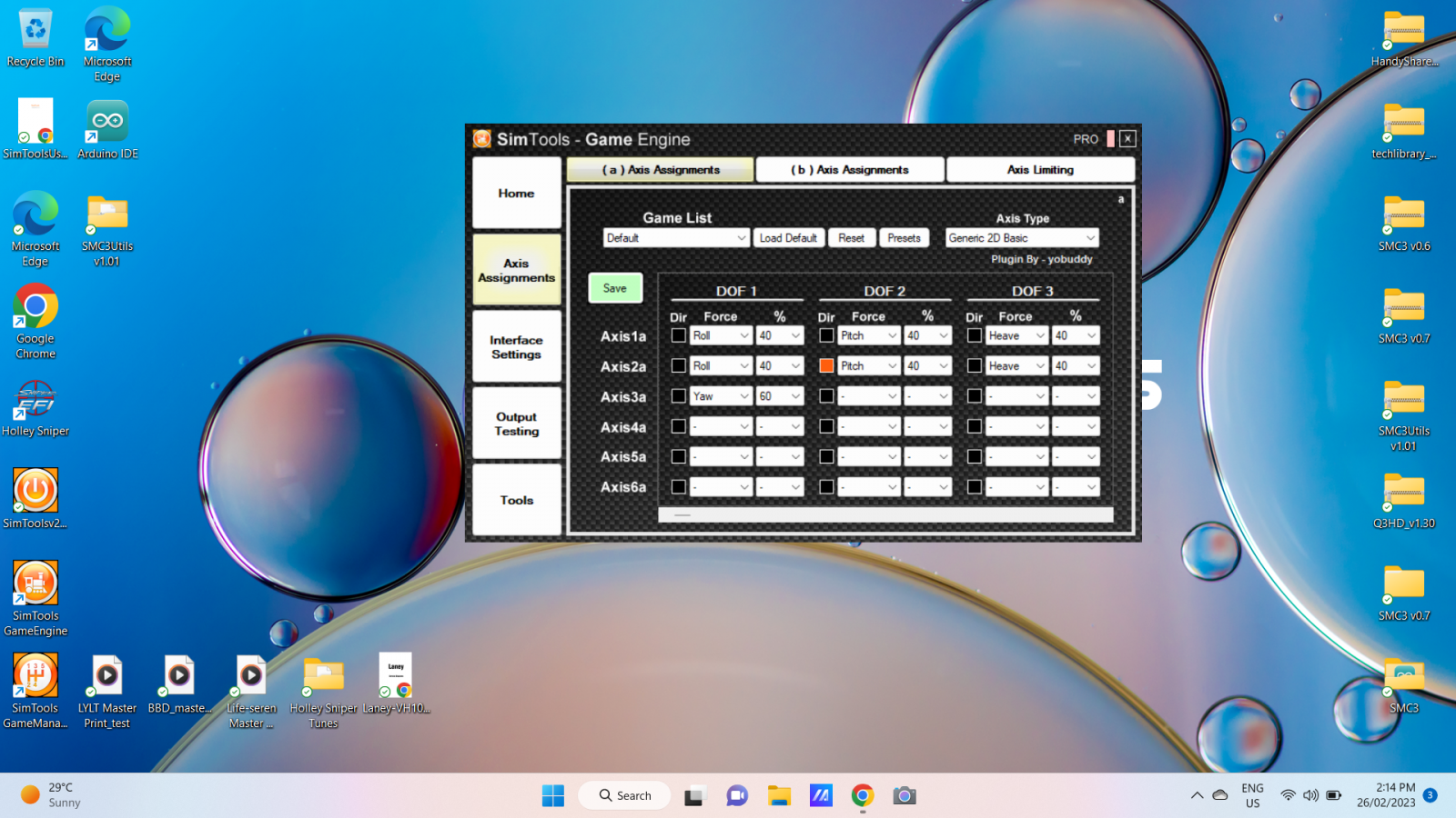

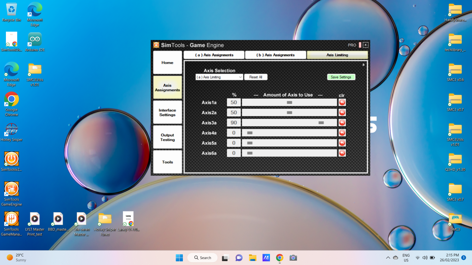

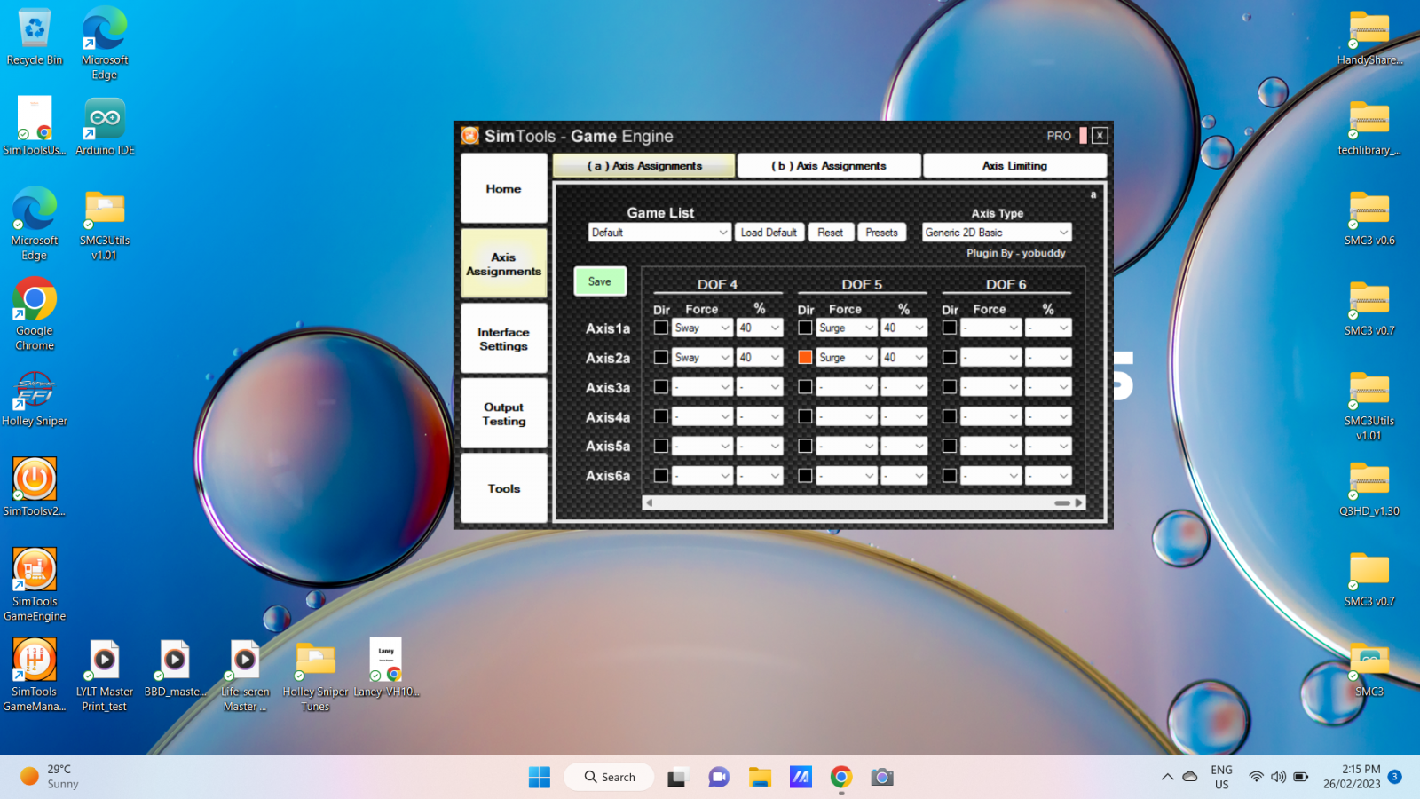

    Hi all. Hoping someone might have dealt with the same problem I'm having with Sim Tools game engine the latest version 2.6, only downloaded yesterday. I had sim tools working very well yesterday. Took me hours of playing around (in the test output mode, (haven't loaded a game yet) but got it to the stage where I had my wife on the rig and all the axis (using in DOF mode with traction loss as a yaw output) were working no problems. Tested it for a couple of hours fine tuning axis limits etc. It was working great! Today I start everything up, laptop, Arduino, sim tools game engine with everything as it was yesterday and all I have is the yaw (my traction loss output option) working for about 5 mins. Then it stopped working as well. All settings from yesterday where saved and I've double checked all interface options and everything is as it should be, the same as yesterday. I even went through and cleared all the axis settings and then put them all back in, saved etc, but when testing, no motion at all in any axis in sim tools. Closed the sim tools game engine and opened SMC3 utilities and everything works as it should. Did this several times today between the two, as I kept thinking it was a hardware issue, but every time I loaded SMC3 utilities it works like a dream. I'm not running the two at the same time. I've tried restarting the computer, disconnecting and reconnecting the Arduino several times, but nothing works. The rig is dead in sim tools, but works no problems in SMC3 utilities. Anyone ever had this issue? Thanks.
    21,497
    150,602Coins
    +11,017 / 55 / -2
    Can you please post pictures of all of your settings, plus let us know if there are any error messages or beeps.

    Using Arduino and x3 IBT-2 43 amp double H bridges, one for each motor.
    upload_2023-2-26_14-14-9.png upload_2023-2-26_14-14-43.png upload_2023-2-26_14-15-16.png upload_2023-2-26_14-15-36.png

    Is there a reason you are using Axis Limiting?
    Hi @noorbeast . I could be wrong here, but the axis limiting is to dial down the actual range of motion your motor shafts move in yes? My setup/geometry means that in roll for example and this is the one that really needed taming, I have so much travel available in my geometry you could literally be tipped out of the seat testing the roll. I dialed the axis limits down so I limited the top frame travel so it had a nicer roll and pitch profile. Then I could relax without worrying about throwing my wife onto the floor. The axis limiting did exactly that, so I'm guessing that's what it's for.
    https://www.xsimulator.net/community/faq/axis-assignment-percentage-totals.120/
    Was running yesterday for a couple of hrs in test output at 40. But I also ran it at 30% across all axes and it also worked at the lower settings. This morning before I entered output testing, I actually dialed everything down to 25% after reading on the forum about keeping everything under 100% if possible, but when nothing would respond in the output test mode, I dialed it back up in case my lower % settings were the issue.
    With the SMC3 utility closed start SimTools and let us know if Output Testing works as expected: https://www.xsimulator.net/community/faq/which-way-to-set-simtool-axis-movements.230/
    Tried this several times today, but no dice. It just won't move in Sim Tools using the output test mode anymore. I definitely have SMC3 closed when trying to use Sim Tools. But I would close Sim Tools and then open SMC3 and then check my motion axes as I was always second guessing something was wrong in the motors, or the iBT-2's, or the Arduino Uno, but once in the SMC3 utilities, all worked like it always does. Then close that, then open Sim Tools game manager and nothing would move once in output test mode.

    SimTools has been reported working with Win 11, so hopefully that is not an issue, but who knows following MS updates.
    If it works in SMC3 then something is likely interfering with SimTools communication. First temporarily disable the firewall and antivirus and restart then test SimTools. If that is not working then reinstall SimTools while the firewall and antivirus are disabled, to ensure they are not messing with SimTools files, then retest.
    You axis range should be controlled in SMC3 rather than SimTools.
    When you do get the rig moving see the tuning tips here, in particular doing one axis at a time and capturing the Max/Min values in the Tuning Center: https://www.xsimulator.net/community/faq/steps-to-create-a-motion-profile.228/

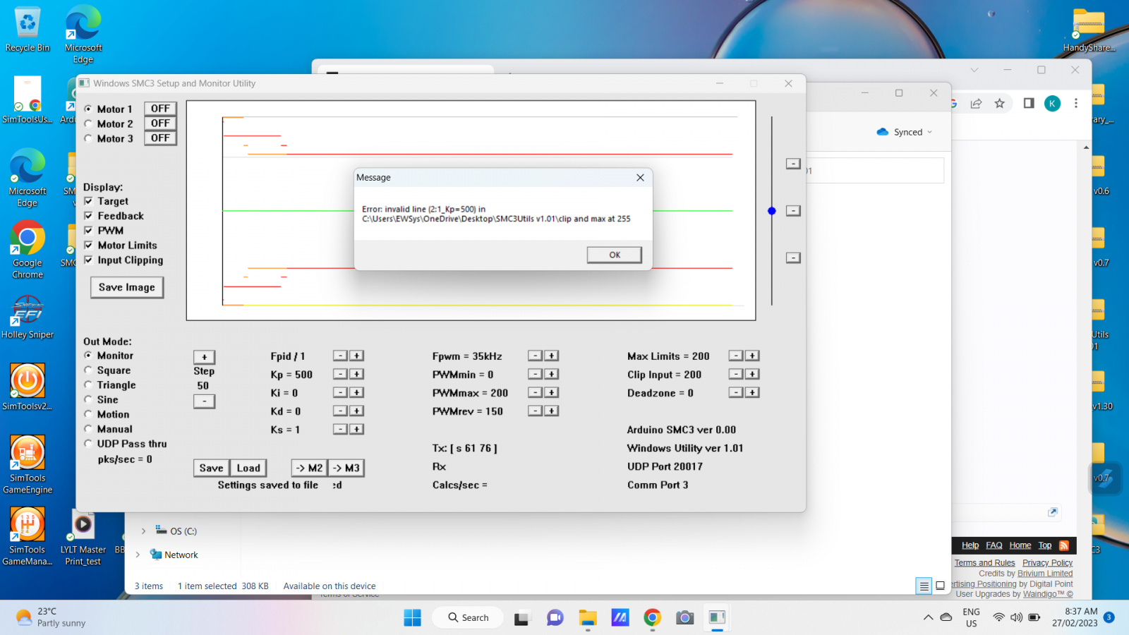

    @noorbeast I have been spending some time in the SMC3 utilities and what I can't work out, is how do I save the changes you make SMC3. For example, I know through testing what my motors are all happy with as far as settings like the KP, PWMmax, PWMrev, and the max limits and clip limits. But I can't work out how to save and reload adjustments you've made. I've tried the save image button for each motor and it's settings, I've tried a save into the SMC3 folder via the save/load buttons, but no matter which one I try, when you open SMC3 it loads up with random settings. If I select load and go to the file I saved it comes up with an error. Do I have to save the file as an ini?
    I'm saving to the SMC3 folder any changes I make. Would be good to be able to load up changes without having to go through each motor and dial them in each time. I assume this is also important for running Sim Tools.

    I don't use SMC3, so there are likely other members better positioned to assist, but can I please clarify are you saying SMC3 does not reflect the values set and if so, are you using a genuine Arduino Uno?

    @noorbeast yes this is the issue. When SMC3 is loaded again even after saving before shutting it down, it reloads with different parameters than what was saved.
    I’m using an Arduino Uno clone.
    I have found other threads with uses having similar issues with SMC3 not saving, but these where related to uses of sabre tooth drivers with Arduino Uno controllers. I use IBT-2 drivers.
    I can pick up a genuine Arduino from my local Jaycar. I’ll do this anyway as a part of the trouble shoot.
