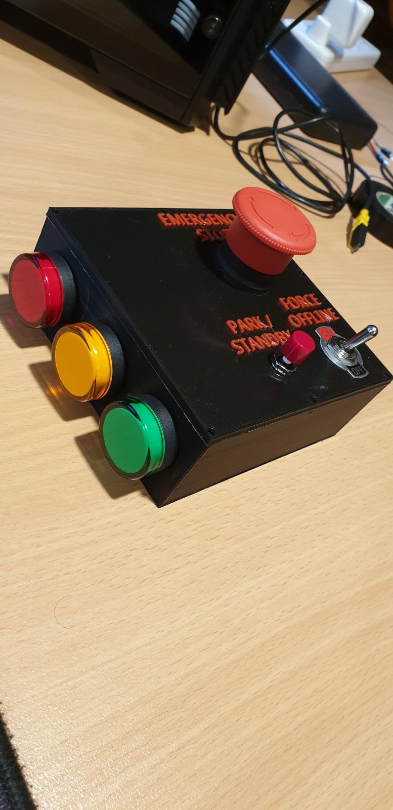

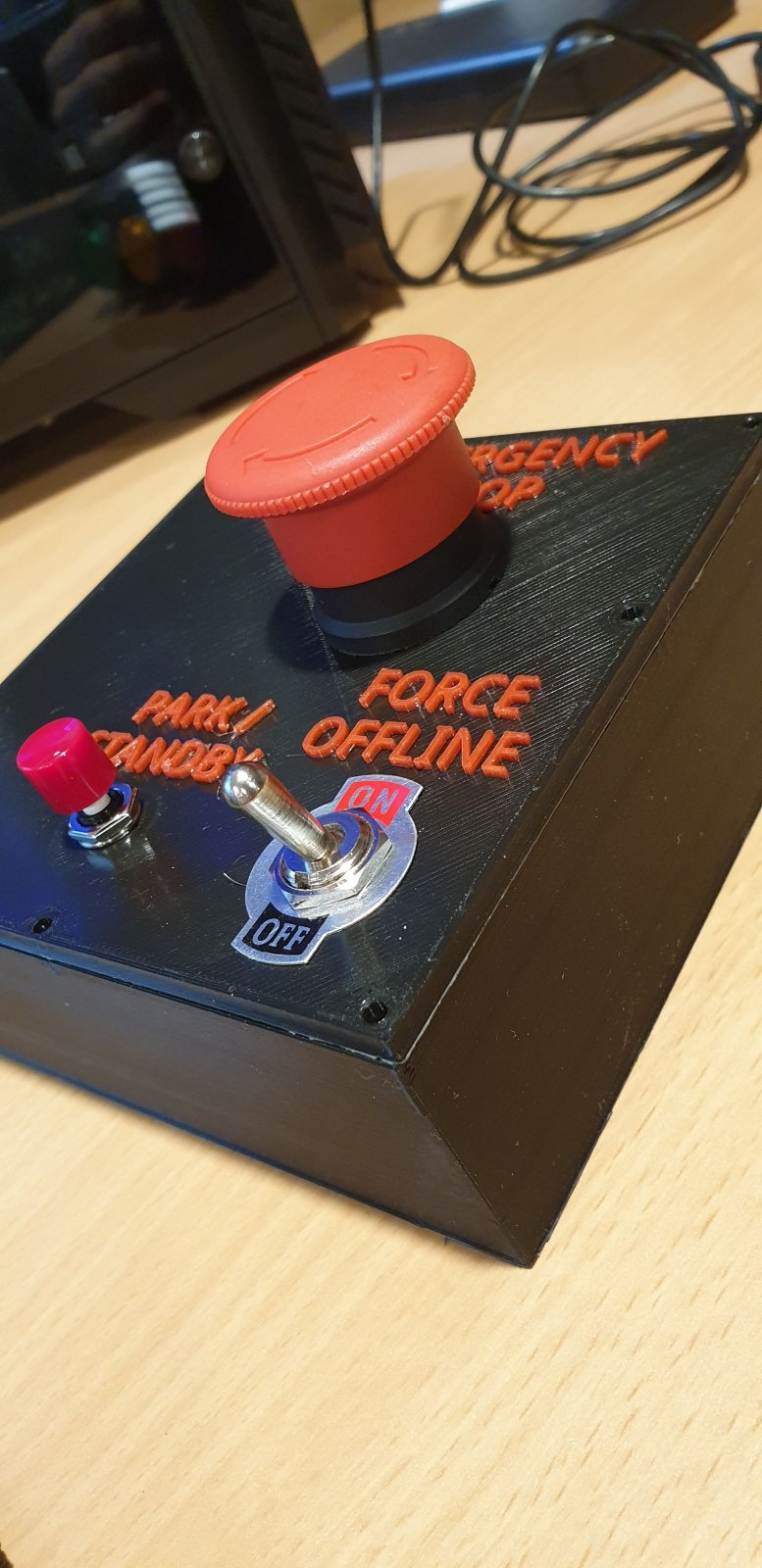

    I've posted images and progress on here.
    https://imgur.com/gallery/g3CPt1S
    printed a controller box add on with led indicators.... text came out a bit wobbly, but it still looks good :)
    more to come.

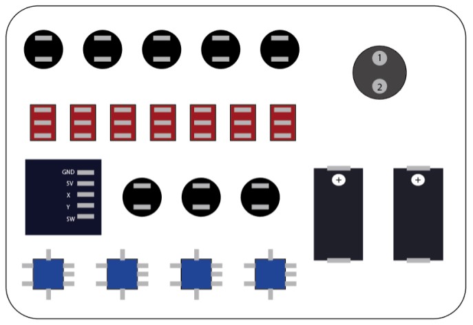

    Need a bit of a hand tackling my button box.
    I've attached a picture.
    I've got a arduino nano and an arduino micro that I could use for it.
    How would I integrate an xy joystick together with a 5x5 matrix grid (following amstudio on youtube)
    Would it work with the arduino or is it better to buy another usb encoder board that'll work better?
  14. Thanos
    Jul 6, 2017
    1,371
    Electronics Engineer
    United States
    2,854Coins
    +1,071 / 9 / -0
    I got one of these and works marvelous:
    http://www.leobodnar.com/products/BU0836/

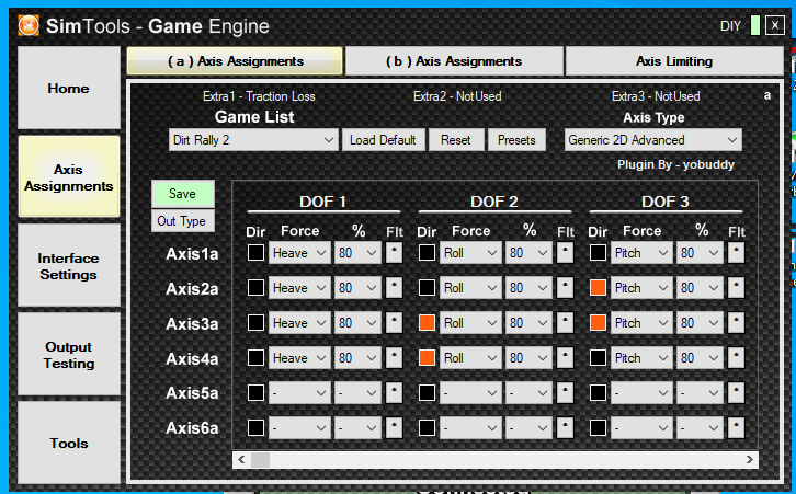

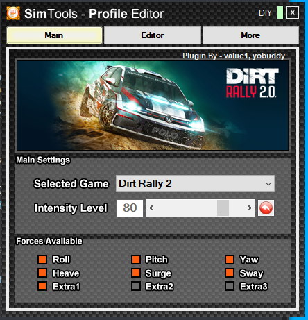

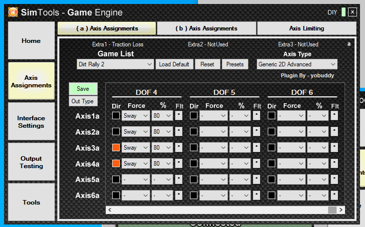

    Getting my head around SimTools and Plugins etc.
    I've downloaded a number of plugins and have had success installing and patching and using in-game.
    Feels great!
    Initially I thought that the Axis Assignments change with each plugin to suit? But that has to be configured for each game right according to my rig?
    I've got these settings which are there for every patched game. I don't really change anything.... and even though it feels good? Maybe am missing something to do.
    I need to learn off the more experiences peeps here :)
    What should I read up on regarding these parameters and what else should I look out for when assigning new games?
    Is there a 'default' setting to go by for the 4 dof sfx platforms?
    Or is it 'if you get one game right, would work for the rest'
  18. noorbeast
    21,594
    151,227Coins
    Your axis allocation total is 320% and that will likely lead to clipping: https://www.xsimulator.net/community/faq/axis-assignment-percentage-totals.120/
    See the tips here to refine your motion profile: https://www.xsimulator.net/community/faq/steps-to-create-a-motion-profile.228/
    The Intensity Level at 80% will result in a lot of global smoothing, and slower responses.
