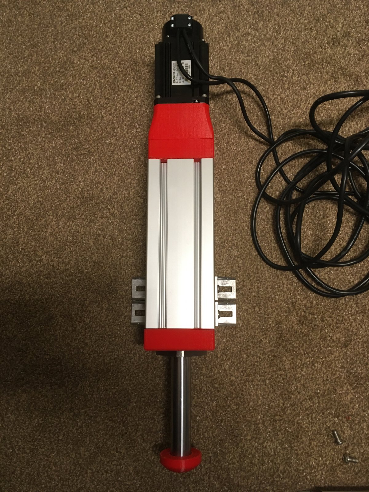

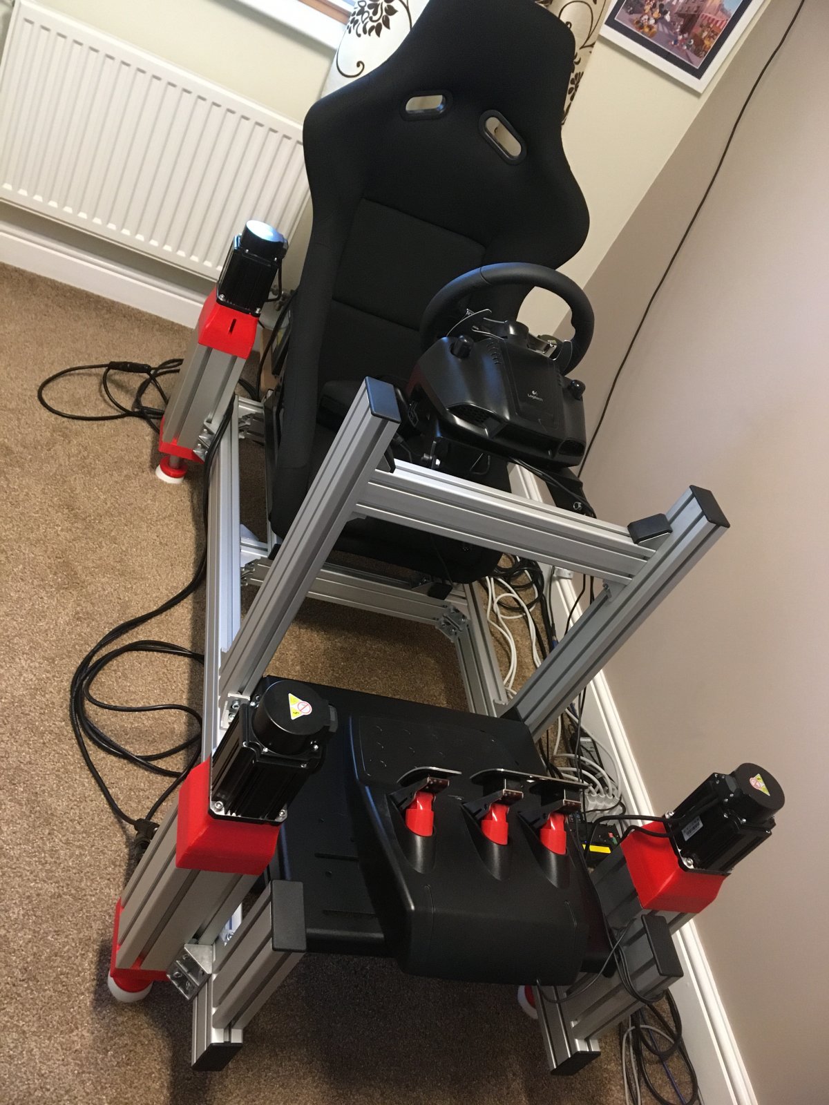

    Well I have had a simukit 2dof for years and finally decided to spend some money!

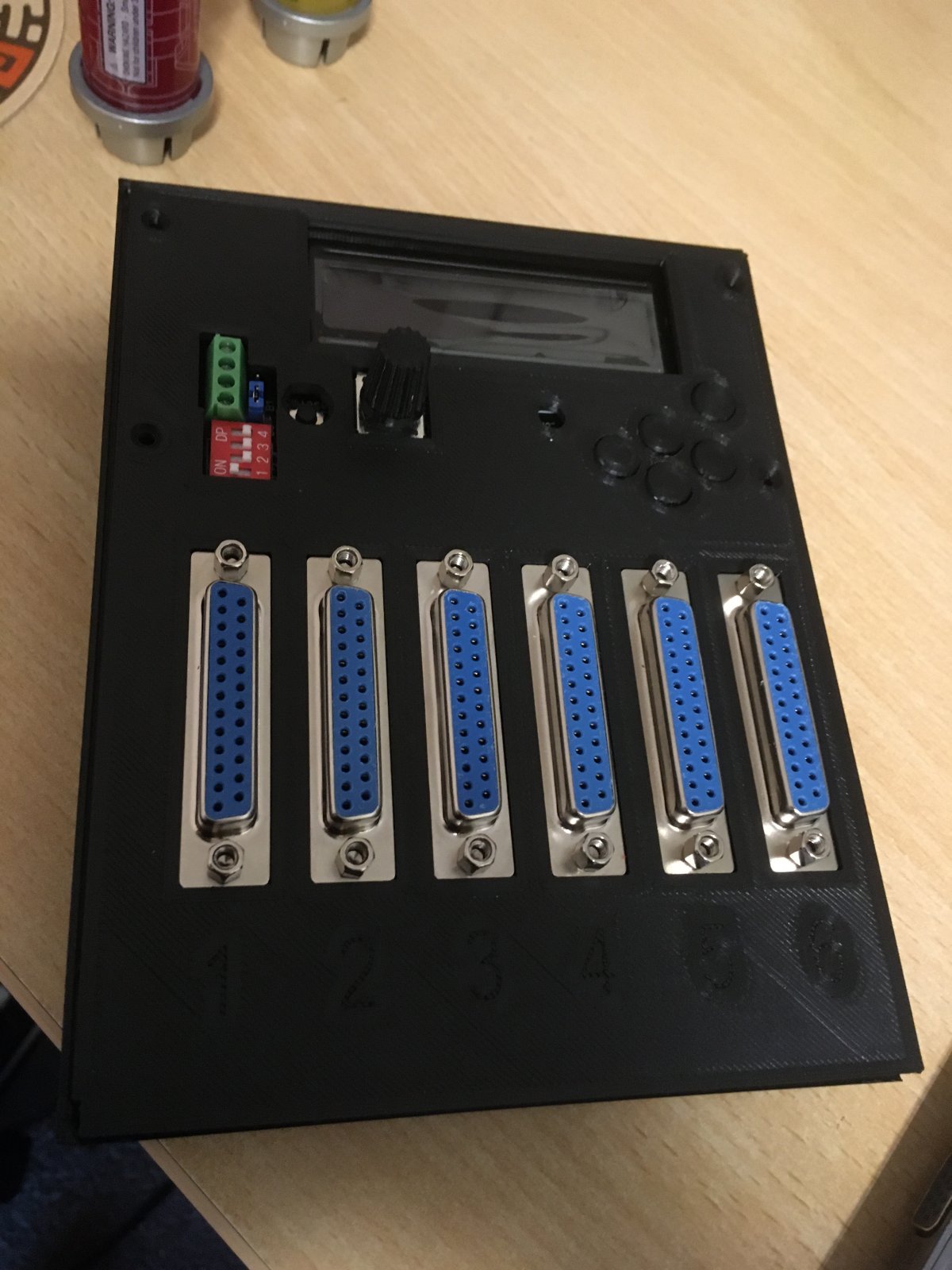

    Just getting to the software stage of my new GT1 rig powered by 4 SFX-100 actuators driven by the new Thanos board.

    5E37836A-473D-41DD-94D4-9E364E5CD647.jpeg 367930EB-6F5D-401F-ADB6-437912515BE2.jpeg FDA67C2F-88D9-49BA-85E8-D3B09BE8437D.jpeg F1D35784-7F11-44AA-A520-BE94B366AC77.jpeg

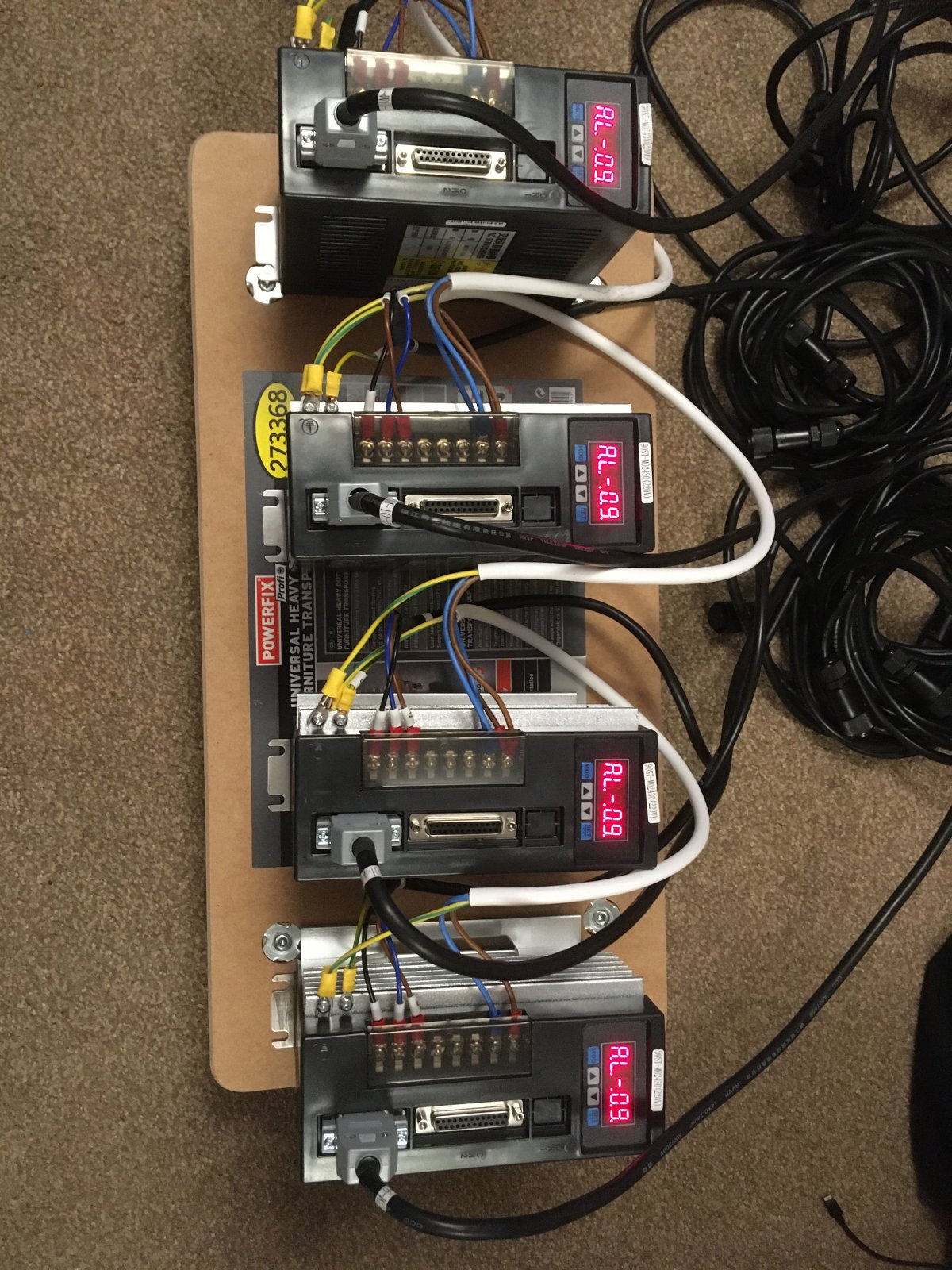

    @noorbeast @Thanos Hi guys, all sorted now. It was merely the antivirus/windows defender software getting in the way. Turned it all off and started working straight away :)
    Last thing now is to wait for a replacement motor driver as my sim rig works as a tripod at the moment :eek: Anyone with a spare AASD-15A I could borrow for a few weeks :grin

    It's been a fun build and nearing the end, cost a bit more than I expected but works better than I hoped so a good trade off. Main issue is it takes sooooo long for the parts to come from China.

    Finally got my replacement driver and the whole thing now works 100%. Really very good! Spent a few hours tweaking simtools so far and the motion is improving, bit more testing and I should be all set :)

    We seem to have developed a squeak. Seems one of the 3D printed sliders is just too tight even when greased and I will need to strip that actuator and file it down a little. I did this to all 4 to get them to fit originally but this one was not quite enough :eek: Must say that without the squeak it's really quiet and quite easy to have a standard conversation with someone when the rig is running :thumbs

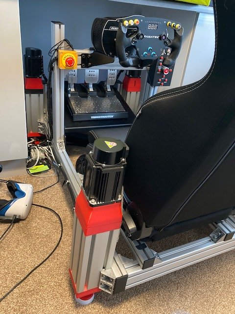

    Been I while since I was on the forum and noticed I never put finished pic up! I have an SFX-100 system managed via a Thanos controller. Has been working well for over 3 years now and treated myself to a new Fanatec wheel plus Thrustmaster LCM pedals.

    Well done Paul! I have the 6DoF version, the SFX100 and Thanos combination are absolutely fantastic.
