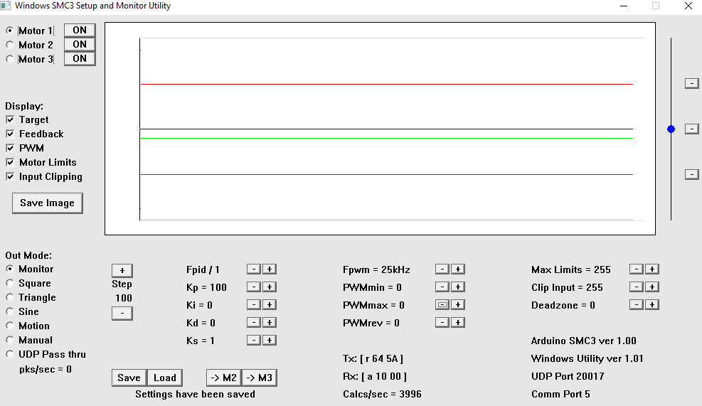

    I ran the SMC3Utility and was able to get the motors moving as said in the tutorial. Now the are in a up position and can't get them back to zero. SMC3 Utility.png

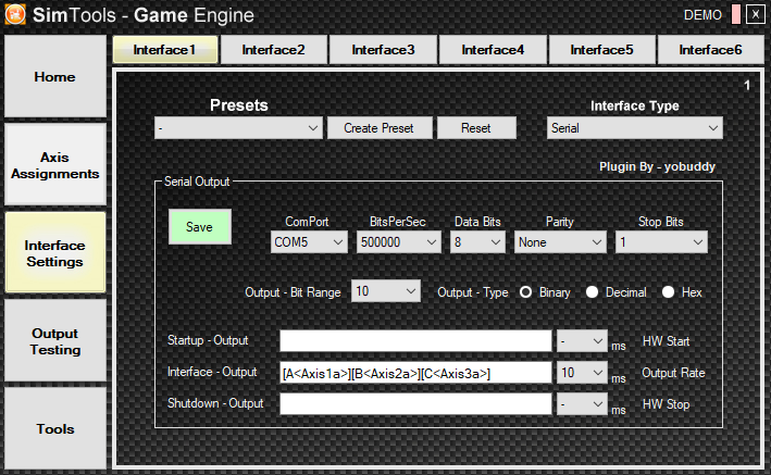

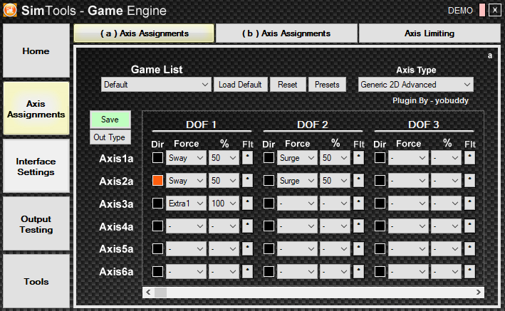

    After I went in SimTools to set the axis and interface.
    When trying to move in the Output Testing, nothing happens. When I press Turn On, the RX light of the Arduino ligth up, but TX stay off, if that means anything.

    I am not sure what you mean by "I ran the SMC3Utility and was able to get the motors moving as said in the tutorial. Now the are in a up position and can't get them back to zero."
    SMC3 should work as expected including the motors returning to a central position, before you mess with SimTools. Your SMC3 settings look like they need refining and we need confirmation SMC3 works as expected.
    The second post in the SMC3 page covers all the functions of the various settings: https://www.xsimulator.net/communit...driver-and-windows-utilities.4957/#post-48121
    Here is a simply analogy intro to PID, which has links to more detailed information if you want to dive down the rabbit hole, while it was done with JRKs in mind the principles are the same for SMC3: https://www.xsimulator.net/community/faq/a-laymans-analogy-guide-to-pids-pid-tuning.219/

    The proper positioning of the pots relative to the motor shaft in SMC3 is used to ensure both are centered on the graph when the rig is level.
    Refining settings can make a difference to smoothness, but can't fully compensate for hardware or design issues.
