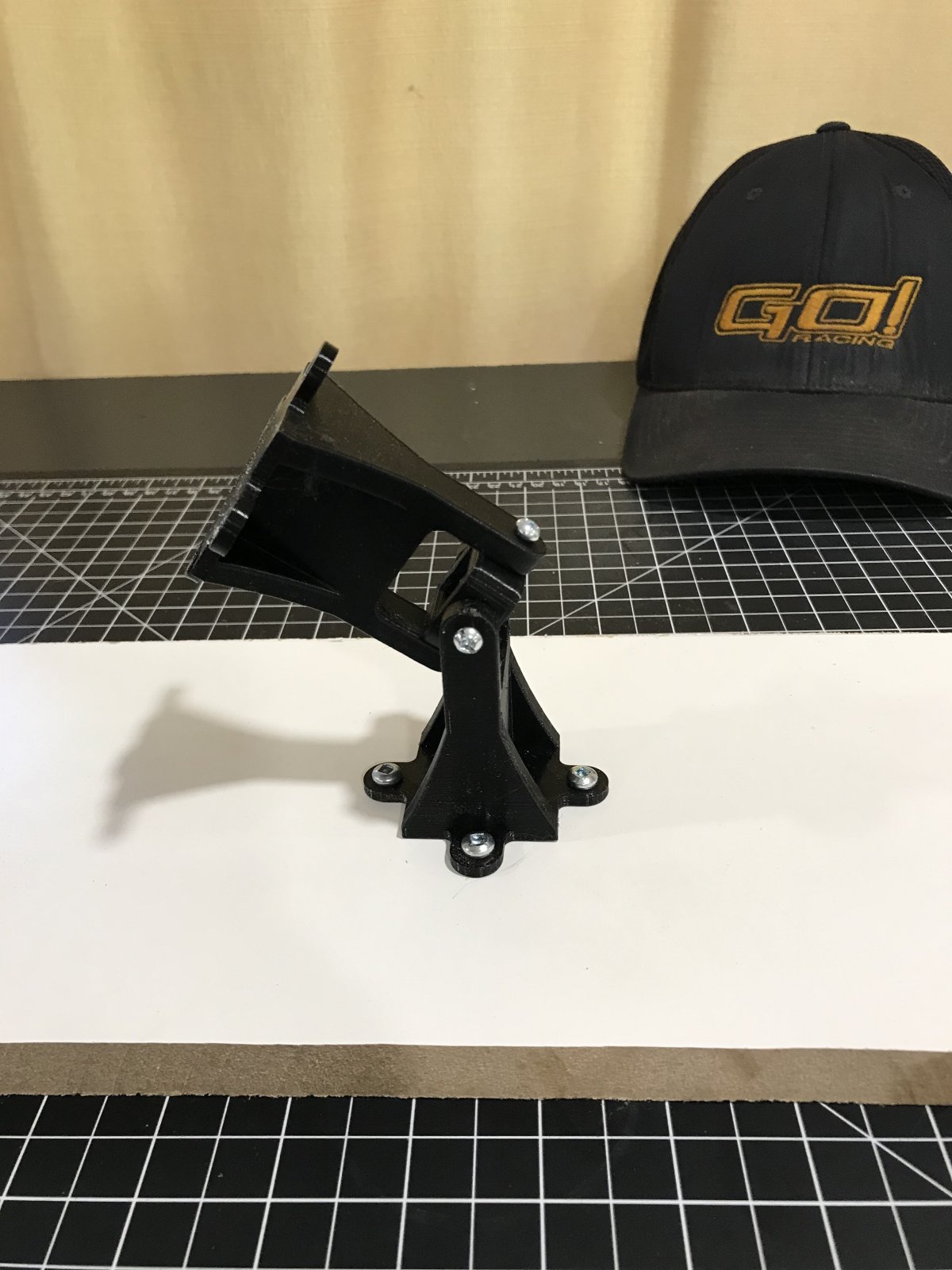

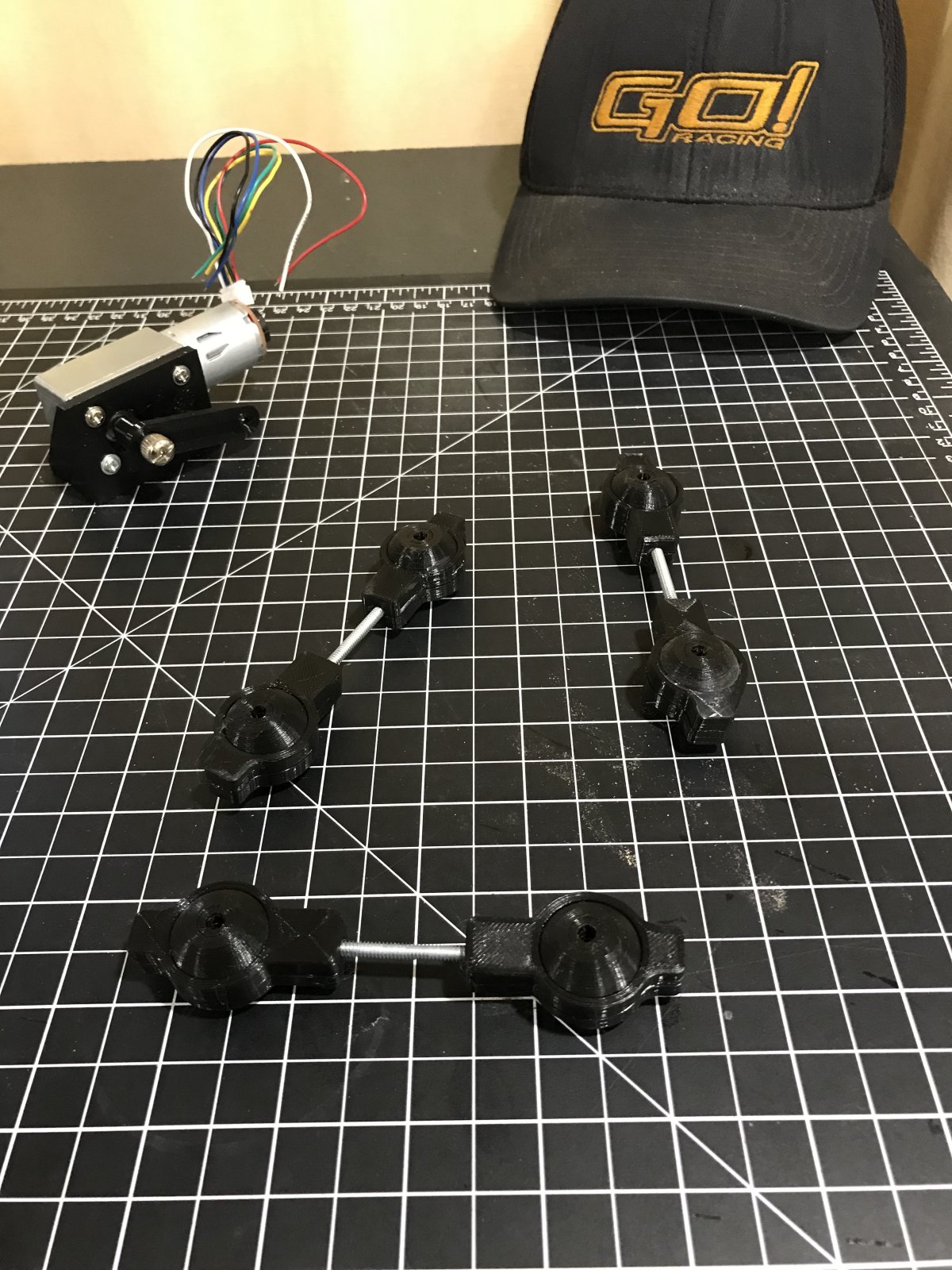

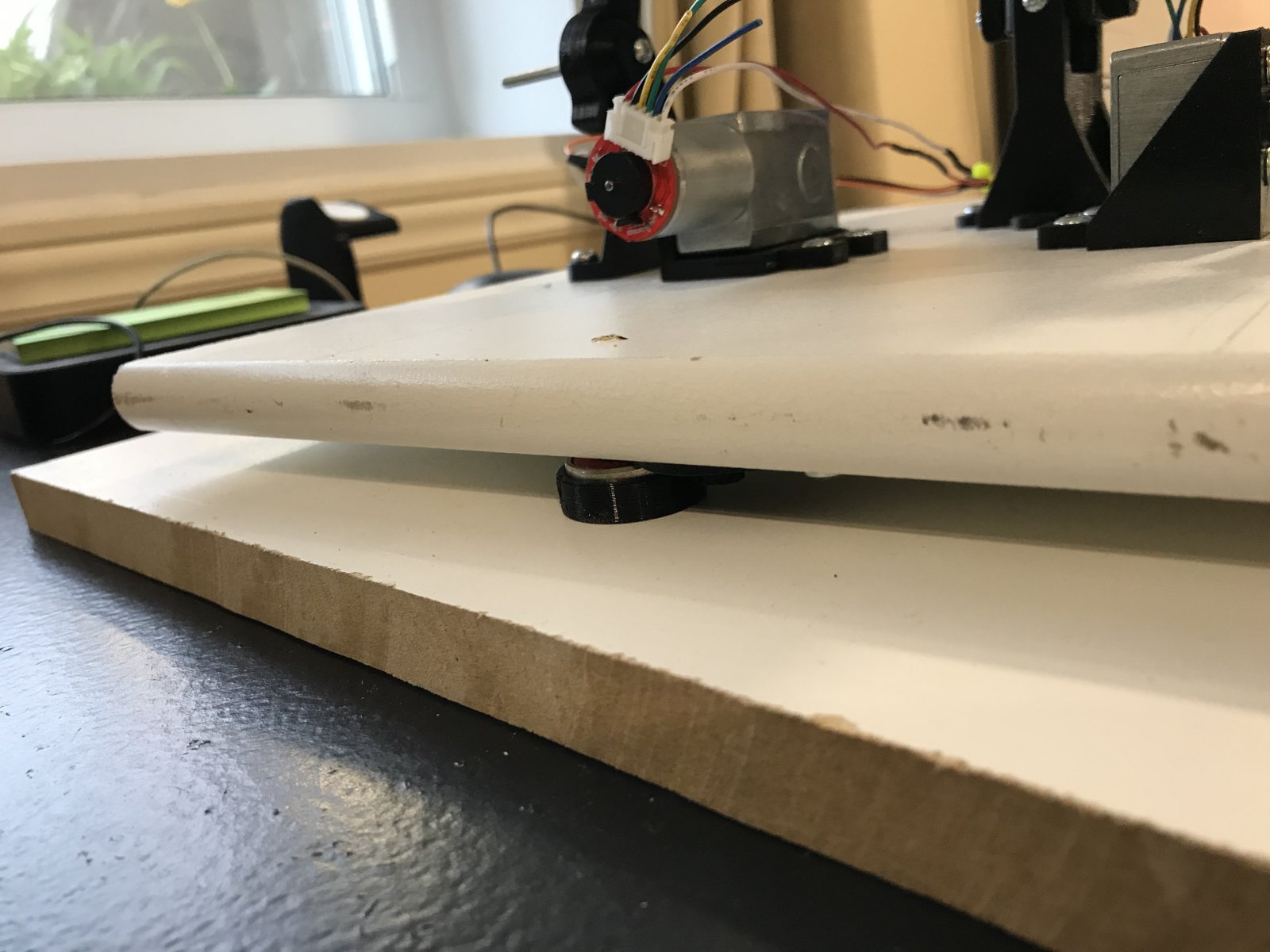

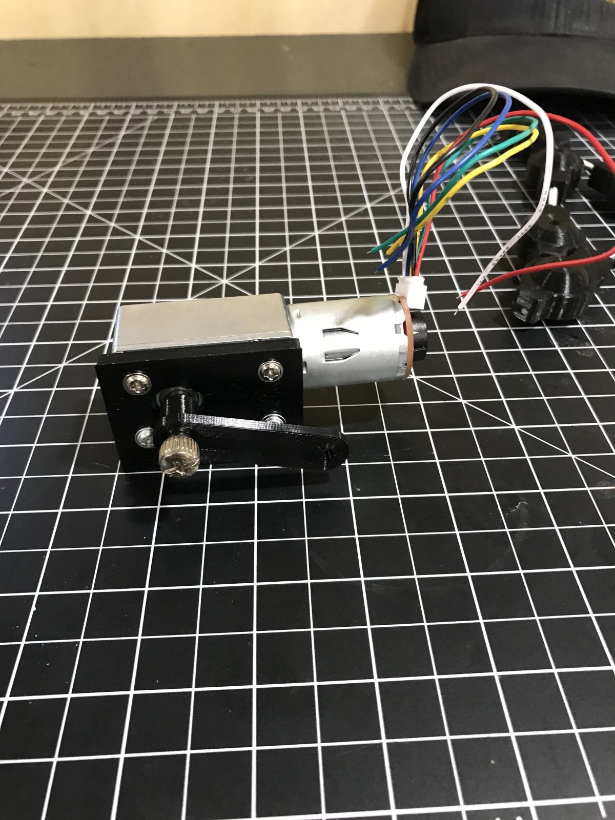

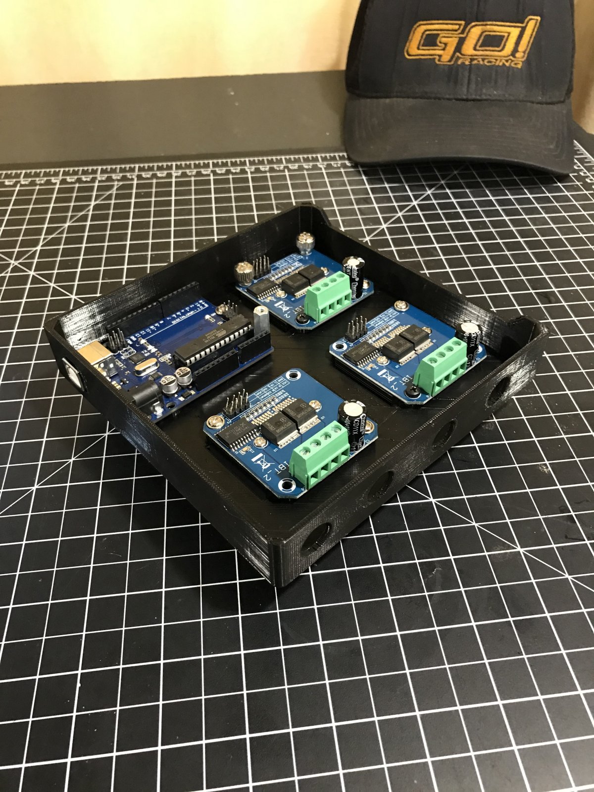

    Ok, so I started a small scale rig. I have cheap motors with encoder from amazon. I 3D printed some rod ends and a universal joint. Used fidget spiner bearing as rollers.
    I also ordered a arduino Uno and IBT-2 that I will use for the final rig.
    I am at a point that I need help for the wiring. Here is the wiring for the motors.
    Red: Motor power + (exchange can control rotating and reversing)
    Black: Coding power- negative (3.3-5V) polarity cannot be wrong
    Yellow: Signal feedback
    Green: Signal feedback
    Blue: Coding power + positive(3.3-5V)polarity cannot be wrong
    White: Motor power - (exchange can control rotating and reversing)
    Red and white are easy to figure out.
    Black and Blue to 5v and GND of the arduino
    Yellow and Green, I figure one must go to the A0, but what about the other one?
    Here are picture of what I have so far.
    U-Joint
    Box
    Motors

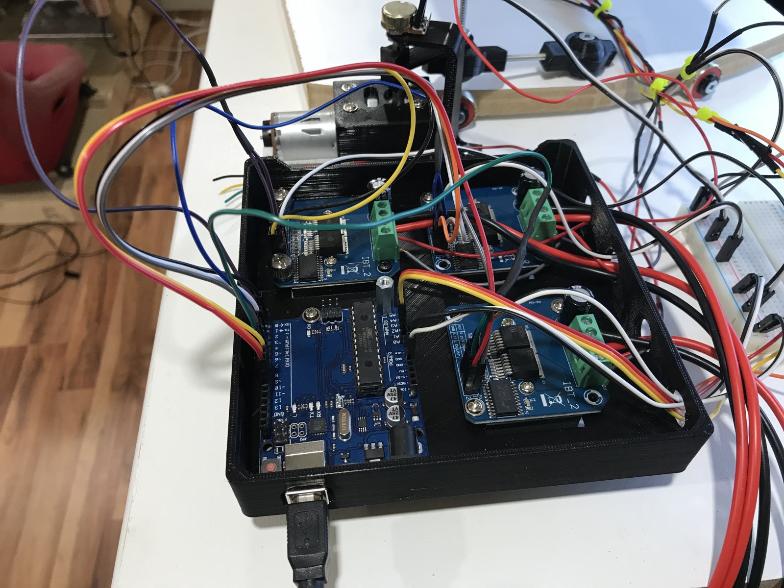

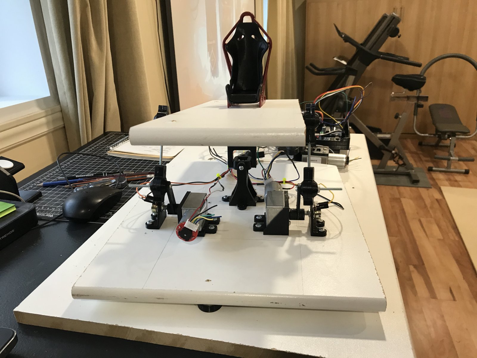

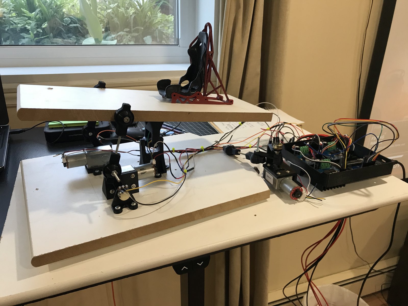

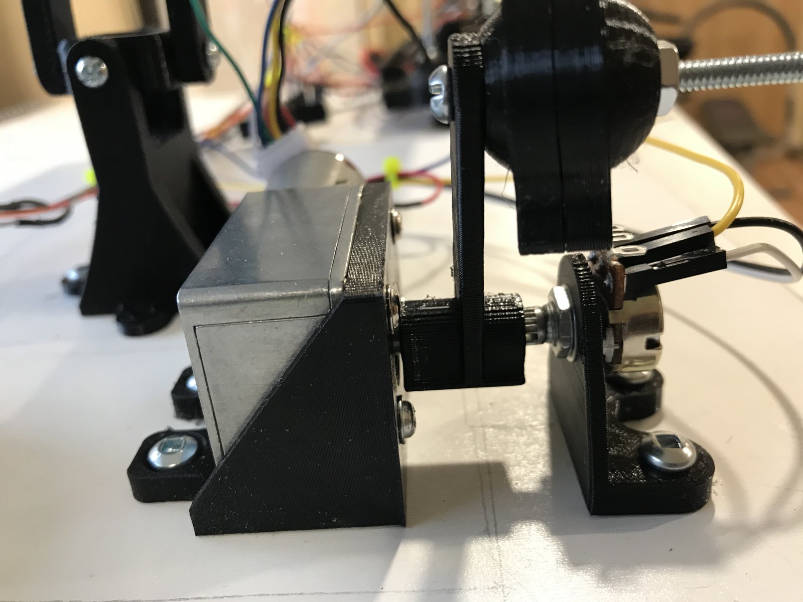

    Little closer to the final test. After finding out that the encoders of the motors did not work with SMC3, I installed 10k POT with 3D printed brackets.

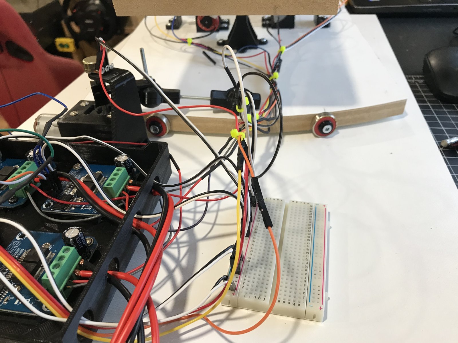

    Completed the wiring, sorry for the rat nest, got to work on my cable management.
    I did the the SMC3 test by RufusDufus and all motors work.
    Hopping to test soon. Here are more pictures.
    Complet Test Rig
    Front View
    Front pivot for traction loss
    Bad wiring job (but working)
    Arduino and IBT enclosure
    Motor and POT link

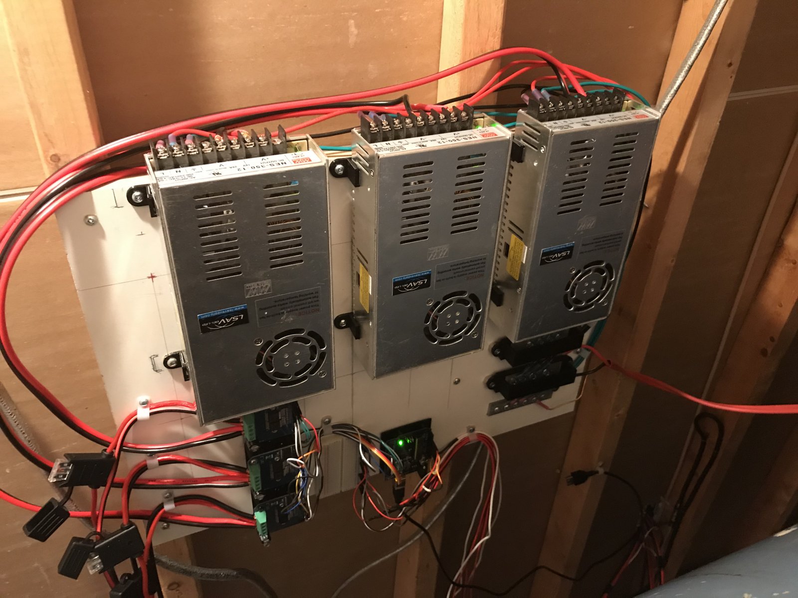

    Hello all,
    Finally got my PSU and motors.

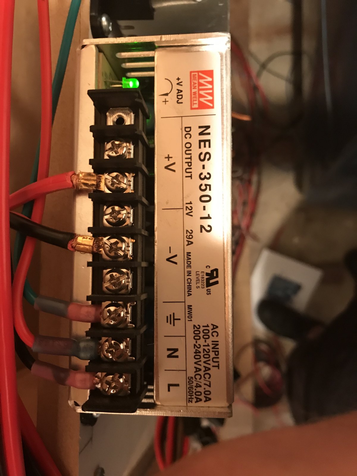

    Now I have a problem, when testing with the SMC3 utility, my PSU go in over voltage protection when testing with the motion. I have Meanwell NES-350-12 PSU. Would adding capacitor in parallel help? If yes, how do I need to wire this?
  5. Vincent Bernier
    Vincent Bernier New Member
    Apr 8, 2021
    20
    Method Agent
    Quebec, Canada
    160Coins
    +8 / 0 / -0
    I forgot to mention my setup
    3 NES-350-12 PSU
    3 Crab pot motors 180W
    3 IBT-2 controllers
    All the wiring is made with 10GA
    21,592
    151,215Coins
    Have you reconfigured SMC3 settings to suit your new hardware?

    Not all the way, when I set PWMmax to 100, this is when they overvolt. At 50 it's fine, but the green line can't keep up with the blue line. I will try to configure other parameters before tweaking the power.
  8. Vincent Bernier
    Apr 8, 2021
    20
    Method Agent
    Quebec, Canada
    160Coins
    +8 / 0 / -0
    So I did some fine tuning and was able to get the PSU not to stall except in Square mode, they stall instantly unless I get the power way down and that makes the motors unable to follow in motion mode

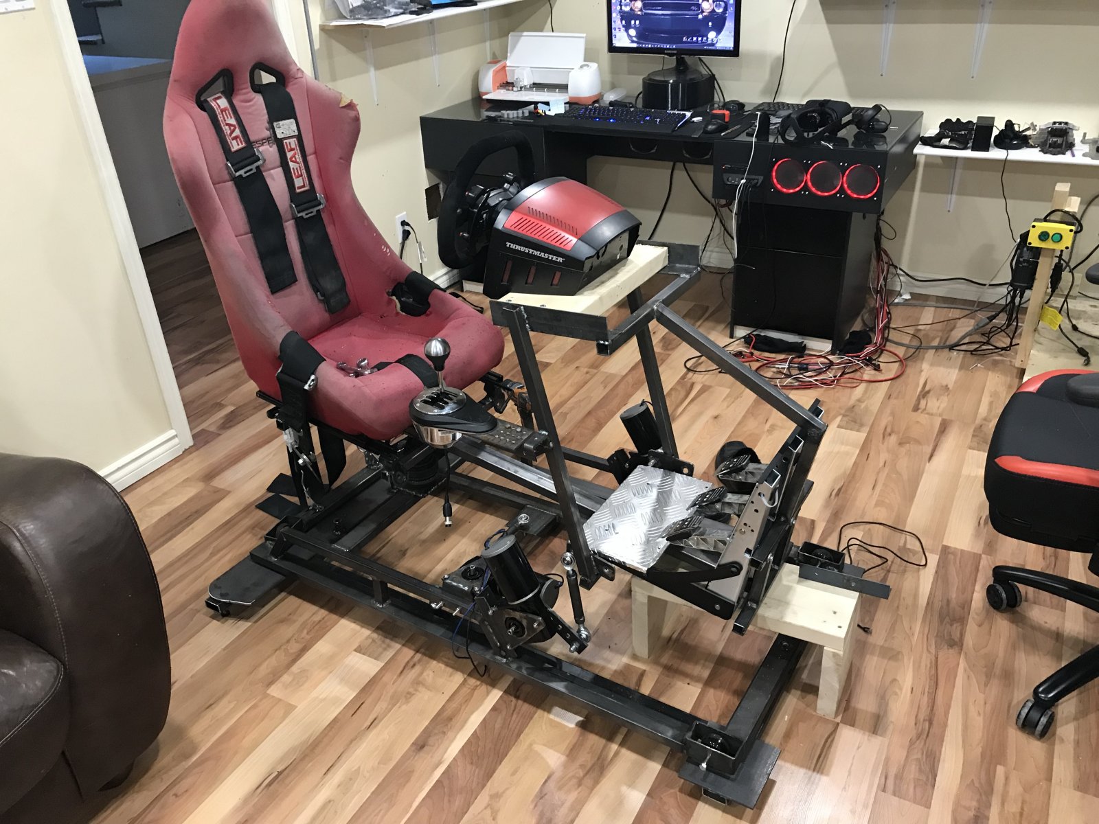

    Finally, I came around to building my simulator. Still have some fine tuning to complete.
    21,592
    151,215Coins
    What CTC distance are the leavers using, too large and there ll not be enough torque for the load.

    CTC is ajustable from 3" to 6", but the PSU would stall with the motors only, no rig attached.
  12. noorbeast
    21,592
    151,215Coins
    Sounds like SMC3 settings are not refined and/or there is a hardware issue.
