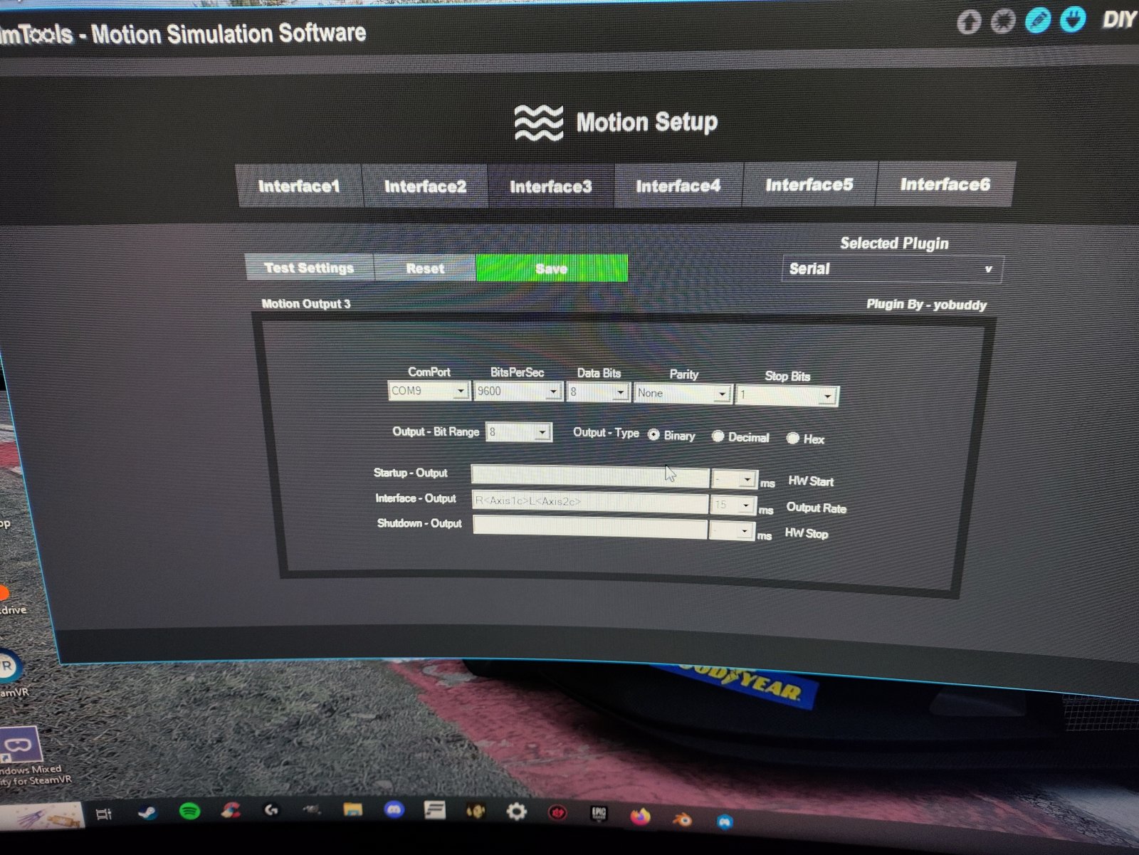

    The Interface settings look correct.
    With Axis Assignment I would expect 1 DIR to be checked orange for roll, but that won't have anything to do with it not worker.
    As we have already ruled our antivirus and language settings that leaves me wondering about your actual hardware and its wiring. What specific servos are you using?

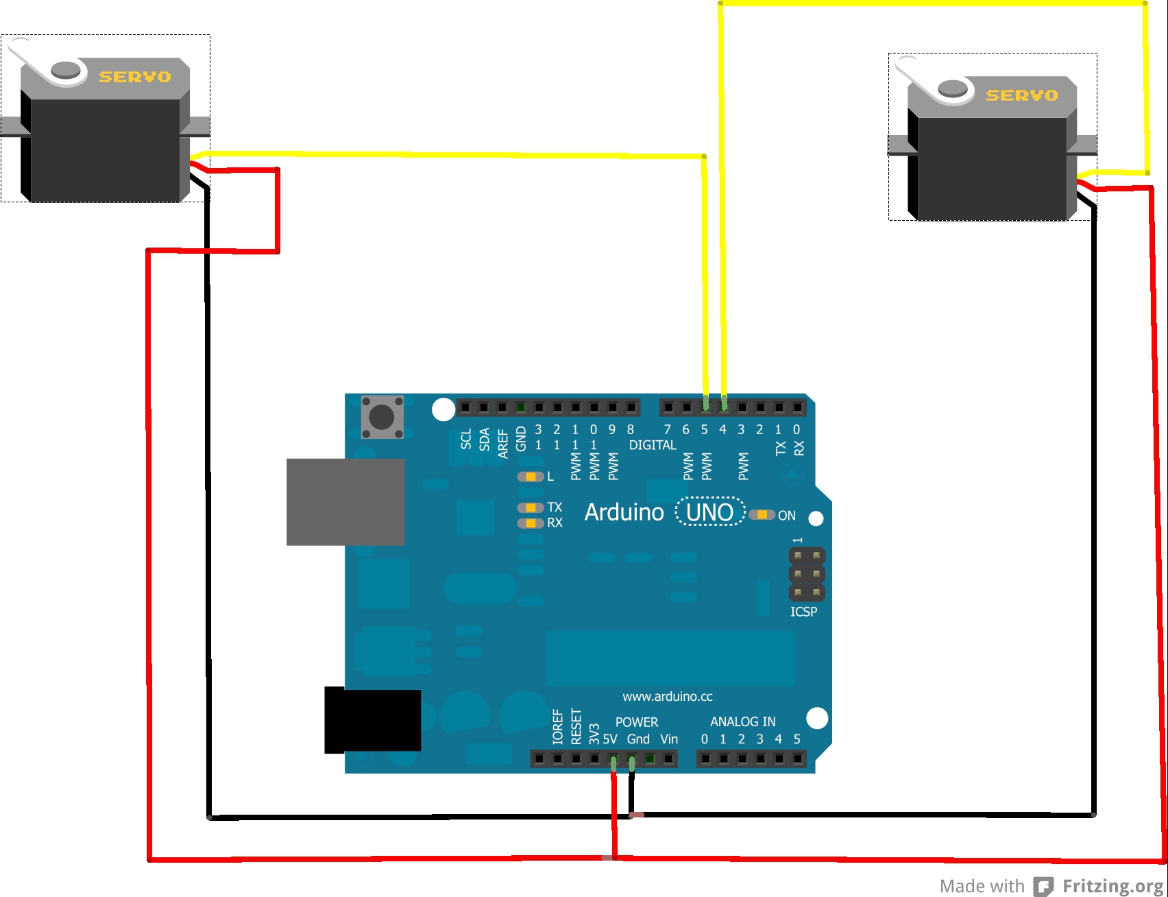

    The wiring should be this, so I just want to confirm it is:

    I'm attaching a video
  3. Vlad1225@45
    Vlad1225@45 New Member
    Oct 27, 2023
    18
    110Coins
    I checked everything correctly 10 times again but nothing works

    Make sure you have clicked the green 'Save' after changing the Interface settings, it should bring up a window saying 'Settings Saved' if it updates correctly.
    I've verified the code and your settings with an arduino Uno and servo here and they work for me. You could also try closing down simtools and starting it again and check that the interface settings are showing up correctly. Also try unplugging and replugging the usb to your microcontroller.
    Also when the microcontroller is plugged in, your servo should move to centre and resist you manually moving the servo arm even without Simtools running if the code has been uploaded correctly.

    in the section axis assignmens % set to 100 and dir DOF1 Axis2a set and when testing at 50-60 Roll and Pitch the first servo rotates by 1mm and that’s it
  9. Vlad1225@45
    Oct 27, 2023
    18
    110Coins
    and for some reason I have an Arduino connected to the com port where it is written in sim tools, but next to the cross and DEMO the red indicator is on, but when you turn on the test the blue one turns on, the red one means that there is no connection

    Then rewire:

    To avoid conflicts, you can try using different PWM-capable pins that do not conflict with the Servo library, or ensure that you're not using the same timer for both servos and PWM signals.
    Adjusted Code Example:
    You could try moving the PWM output to pins 3, 5, and 6 instead, as pin 3 is controlled by Timer2, which isn't used by the Servo library:
