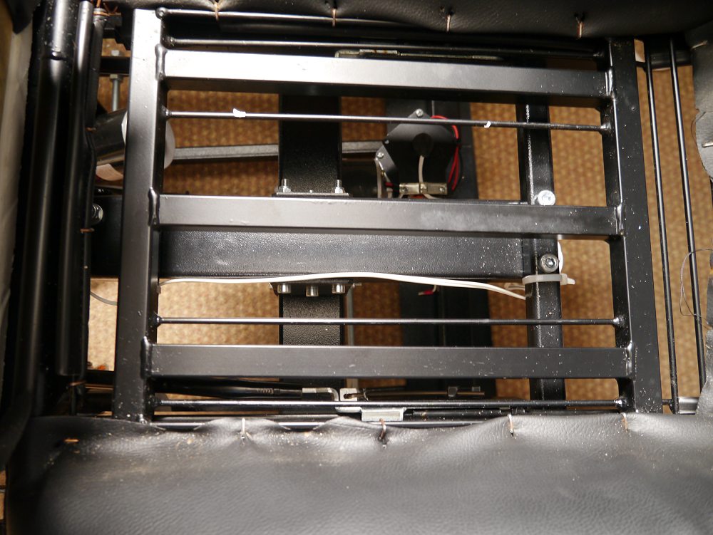

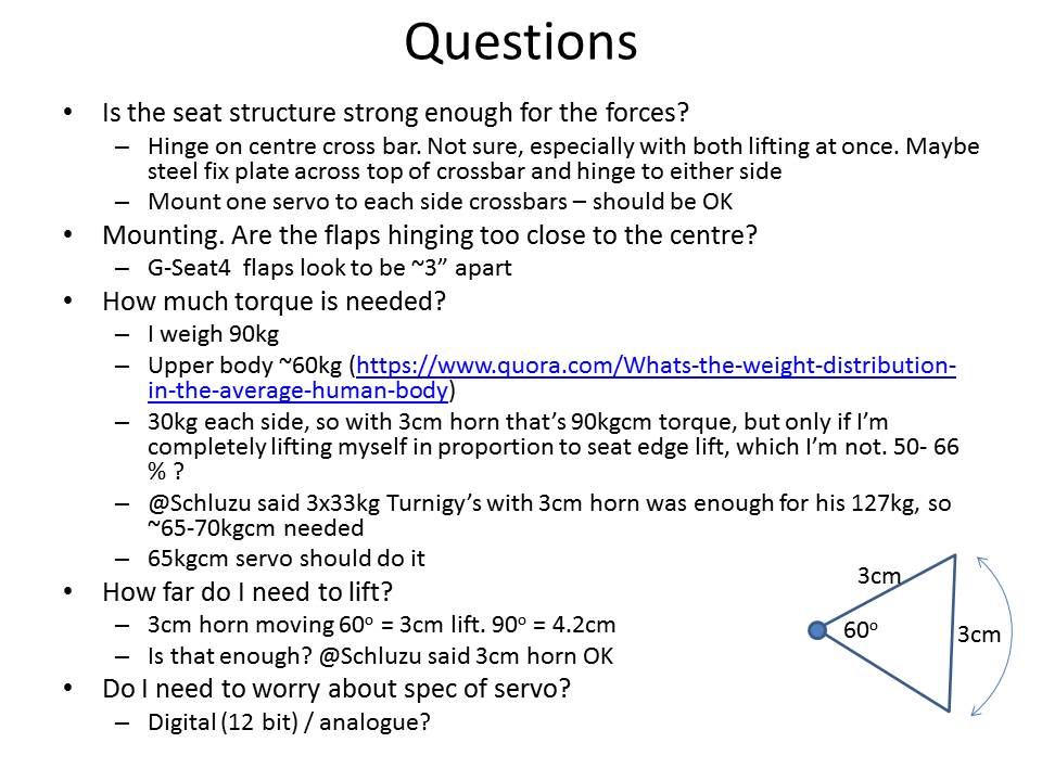

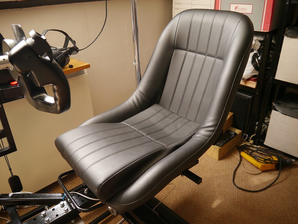

    Update: Title changed again. It's no longer "part 1" as Surge is now well underway in addition to the original heave.
    Edit: For those reading this for the first time, here are a few points about this project that might help in terms of relevance to any project you are considering.
    1. I'm building on an existing seat and ideally I want the g-seat functionality to be very compact, ideally almost invisible/hidden - something Q might build for Bond! Just a design aspiration I have.
    2. The seat frame I'm using constrains some options for flap positioning, which will make it less useful for a sense of roll, but should be fine for heave, which is OK for me as I'm putting this on a 3DOF
    3. It's mainly for flying. I'm not sure my servos would be up to driving.
    Its time for me to move to the next level. I've been using a commercial DOF Reality V3 for the last few months and I'm after more immersion for my VR flying. My seat is a Cobra Clubman Classic bucket and I want to convert it to a G-Seat. I'd like to do it without adding lots of extra structure to support motors, which means I need a very compact solution. So its going to have to be servo powered rather than wiper motors and probably just one servo per flap given the space available. I also want to maintain the comfort and appearance of the seat. I think this can be done building off the crossbars of the seat base, but I have quite a few questions. I've put all my ideas and questions in this short slideshow. Any suggestions welcome.
    Oh, and I've decided to take this a step at a time. I can access the seat base most easily without ripping off all the upholstery, so I'm starting with heave which should give me a nice sense of g-force on a tight turn. Surge can come later.

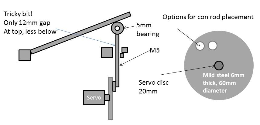

    Hi @Spit40, nice to see another g-seat project. Seems you have already put quite some thoughts into it.
    I am also going to replace my current g-seat with a servo-based solution and was already looking for suitable hardware.
    For now I have only one comment about your chosen servo: Regarding the torque it may be sufficient, but I could imagine that the rod that goes from the servo horn to the paddle may become the week point, or maybe the involved joints. How thick/strong will they be so that you can still mount it onto the horn?
    From this perspective it could be better to use at least 2 servos in order to distribute the weight onto 2 rods and joints.
    This is just what came to my mind when thinking about my own build.

    Thanks Markus. Good point. I was going to use some M5 rod/bearing ends and try to get a very strong aluminium servo arm that could take it. I've emailed the servo supplier to see what they can suggest.
    Phil

    @MarkusB - I've decided not to use a horn but a servo disc which I'll bolt to a larger 6mm thick steel disc. That should remove the servo arm as a weakness. I also then also have lots of flexibility as to placement of the connecting rod. With regards to con rod weakness my issue is the upper bearing which won't easily allow the seat plate to drop to level. I think I may have to cut through the plate and place the bearing above the seat plate and cut some foam out of the seat base to make space for it. If I do that I have the later option to upgrade the M5 to something stronger if needed.

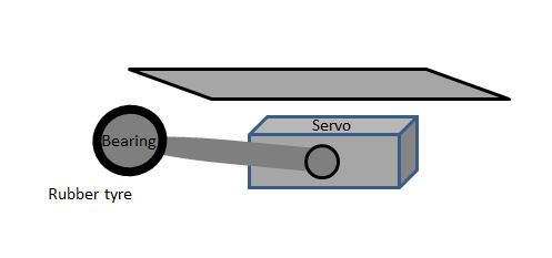

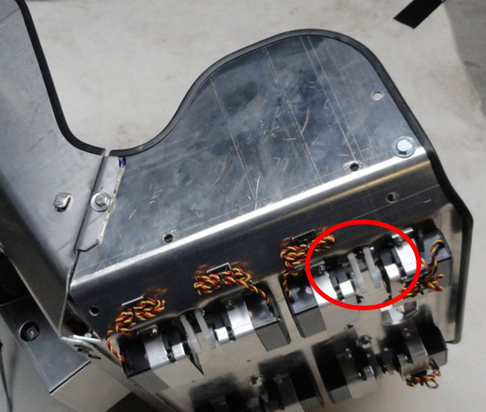

    Looks interesting. I don't know if this would provide any advantage compared to your approach, but I am thinking of mounting the servo motors turned by 90 degrees, similar to the GS4 g-seat. By doing this, the rod only moves in a single plane, while being connected to the servo as well as to the paddle.

    Actually that was my first idea, but I don't have that option given the placement of the seat cross-bars. The other idea I'm thinking of is this. The tyre would roll along the underside of the paddle. I may need to angle the tyre/wheel a bit as otherwise it would skid/pull on the paddle.

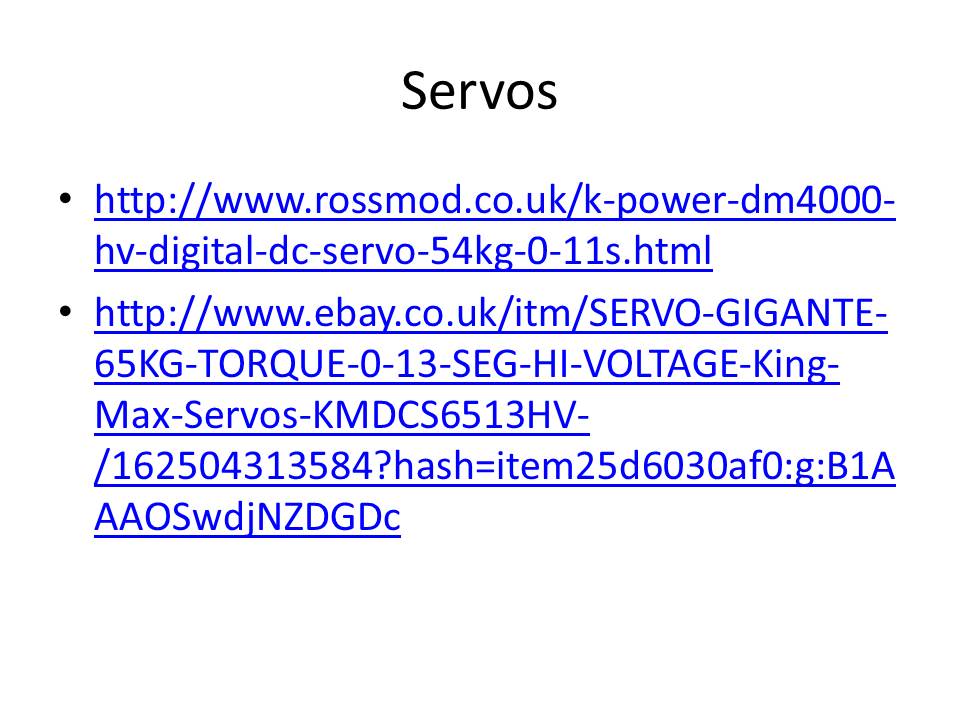

    I've started testing my KingMax 65kg.cm servos. They run on 6.0 - 7.4v and speed is 0.13s/60
    I'm testing for:
    1. Can they really handle 65kg.cm?
    2. Do they really move that quick?
    Torque Testing
    The first problem I'm hitting with (1) is what current draw do I need? I created a 7cm lever and managed to lift a 2kg weight pretty comfortably with it, but it stalled on 4kg. I was only using a 2amp PSU though. Any advice please on what kind of current I'm going to need and how to source it cheapest. Ideally it would be variable voltage as there's some confusion over maximum operating voltage - the side of the servo actually says it will handle 8.4v
    UPDATE: This should do it. 20A should be plenty (hopefully for both servos) and 7.5V with +10% adj. so 8.25v available.

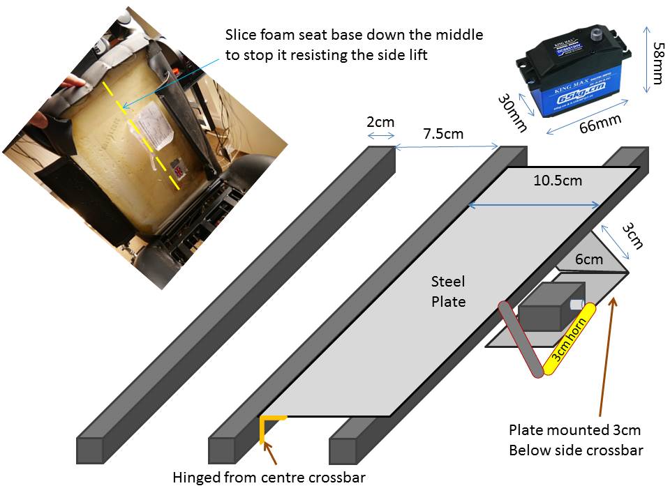

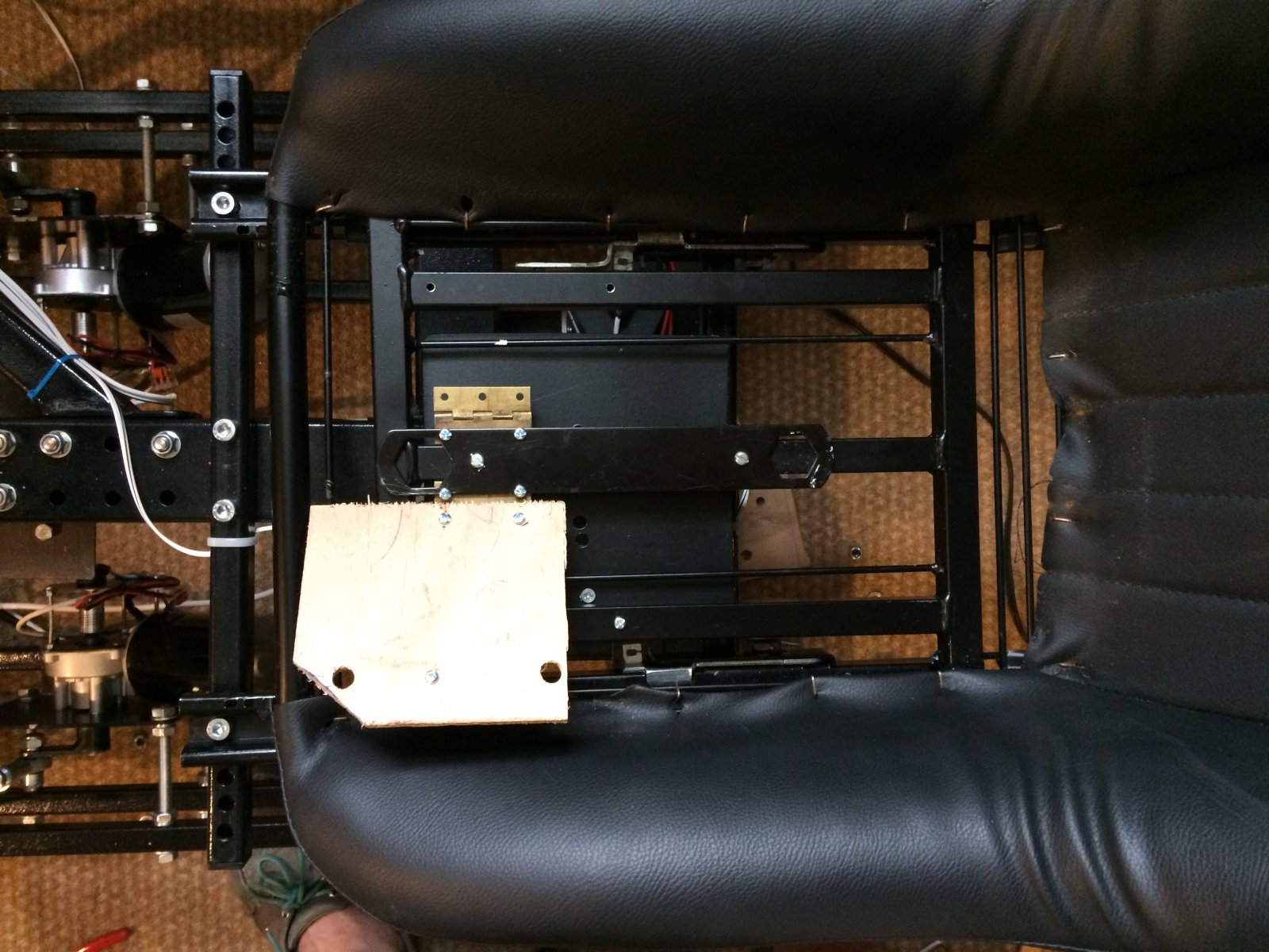

    Good progress this weekend. I have one seat base plate working. I'll post my modified arduino sketch later as others may find it useful. Because I can't do -ve heave/surge, it clips all -ve values (output <128) and then maps the 128-255 range to the desired servo max/min positions.
    It's rough and ready with ply for now while I tweak things. I'm not quite sure whether I have enough power at the moment, but that seems strange as my 65kgcm KingMax is quite a bit bigger than the dual Turnigy's others have used. When I first tried it with the dense foam seat cushion over the plate I got very little movement, and the servo certainly couldn't go full distance. I later tried with a thin foam cushion though and the results were much better. I plan to cut the foam seat base into sections to allow hinging without resistance.
    I'm currently searching the forums for previous g-seat builds as I'm unsure about 2 things:
    1. How much lift at the outside of the plate is desirable for a good feeling? Less lift means less resistance, more force and faster response. I'm currently lifting about 70mm
    2. How deep should the plate be (i.e. front to back of seat)? At present I think I've made it too small. Less than 1/2 the seat depth and the pressure on my leg is a bit too subtle.
    Any links that can be shared to pictures of previous builds would be appreciated.

    Thanks Marcus. I found a page with some of these on, but not this one... especially with that great question of yours about flap positioning. If anyone has any new experience/learnings on flap positioning I'd be pleased to know.
    Currently this is what I have with my first test. Hinging from the edge of the flap.

    I think I'm constrained by the seat I'm using, so I'm going to have to hinge from the inner edge and I won't be able to lower the opposite flap, to give the sense of pressure easing, when one side increases. I guess that isn't needed so much anyway for me as I'm adding this to a 3DOF so I have roll covered already. I want this primarily for heave, though it should aid the sense of roll.
    The next question is flap size, and I think I'll go for about 1/2 seat depth next.
