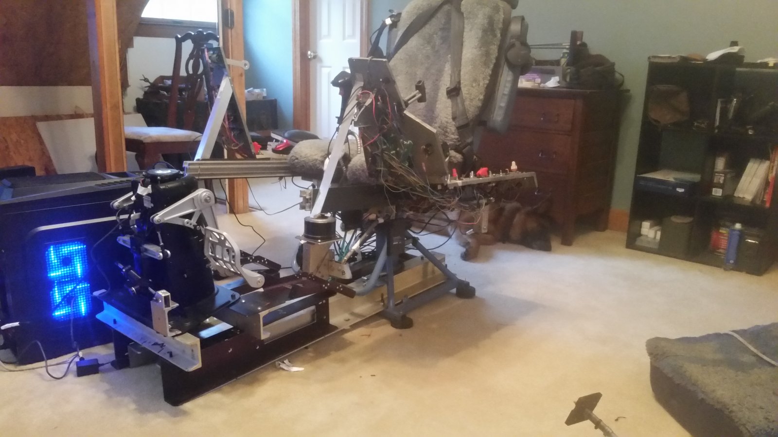

    After looking at some motion g-seat rigs like Bergison's, I'm am wondering if they would be a better option than a Stewart platform for adding motion to my flight simpit. Initially, I just thought the platform so everything moved. Now though, I am starting to think that the moving seat would be more immersive in VR because it would alter your interaction with the controls. Pulling you away or pushing you closer as the seat moves in relation to aircraft attitude, pulling positive and negative The, etc. It would also seem to simplify adding it to the pit. Does anyone have experience or advice they can offer on plus's and minus's of either?

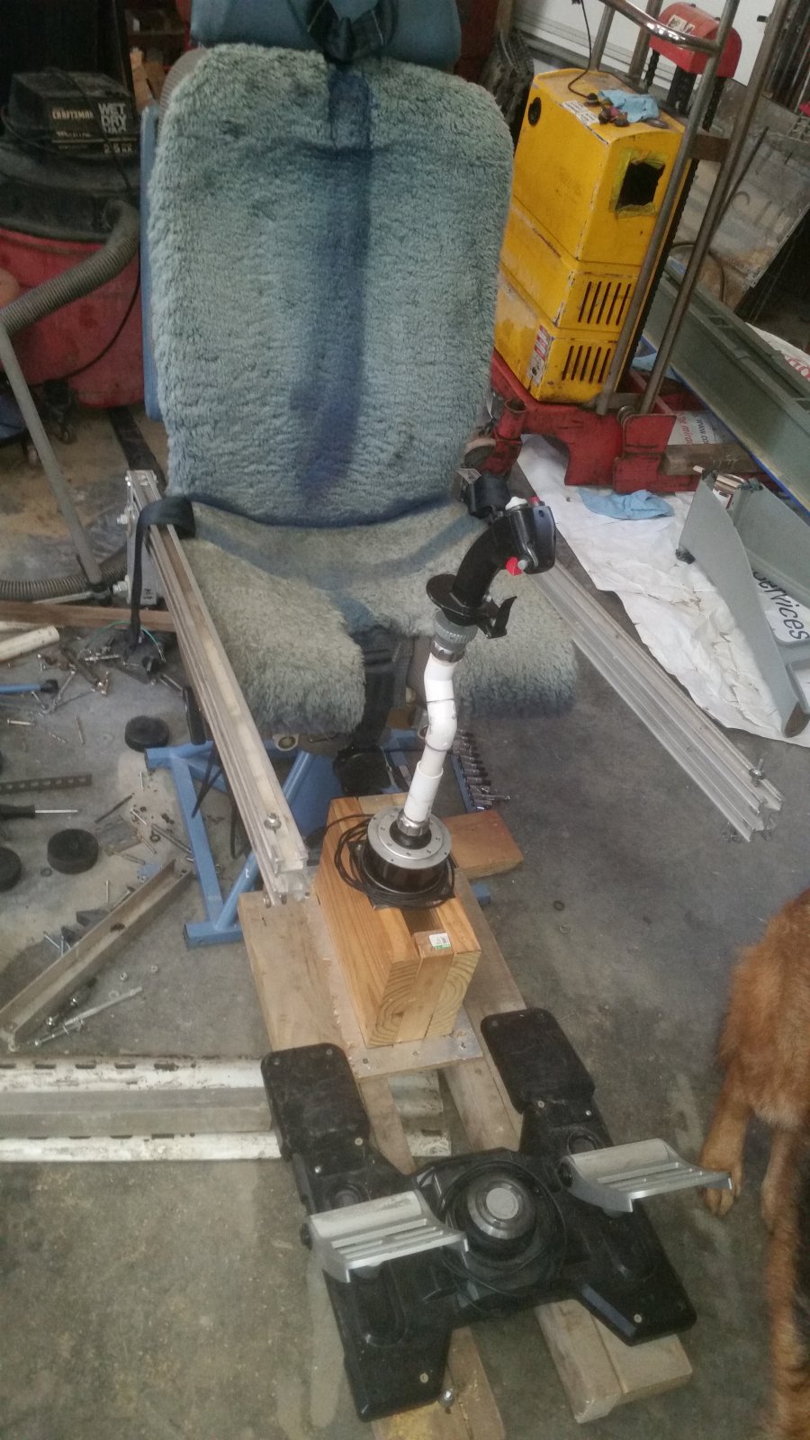

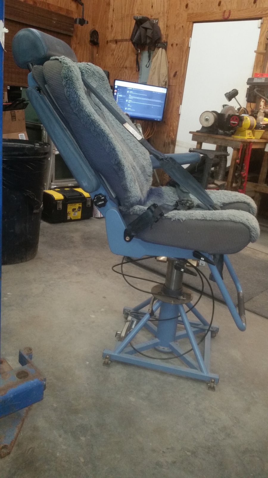

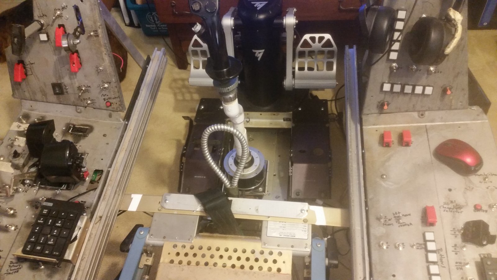

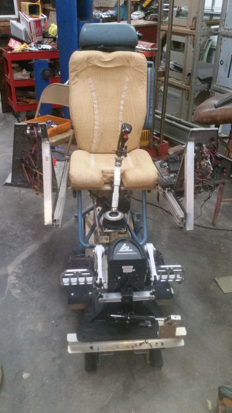

    I have been looking to buy another house after selling mine last year and so my simpit is in storage. So, in the meantime, I am starting to plan the building of the motion side of my pit. I will be putting a g-seat style system in which I also am starting to plan out. The pit is a scale F-14 pilot front office minus the front displays. All switches, levers, buttons, etc work and control the functions in conjunction with PointCTRL. I have vibrating transducers under the back and bottom seat covers. I use it primarily in DCS but also P3D, FlightGear, and FS2020 with the Reverb G1 HMD. The simpit is constructed out of a C-17 pilot seat with aluminum rails that hold the stick and pedals. The side panels are removable. I got the seat as a set of 6 along with the training station from a pallet used to train AWACs operators. I have sold the seats I don't need. 2020-02-14 17_21_08.jpg image005-1.jpg 20190627_144913.jpg image001.jpg 20190627_150645.jpg JPEG_20190314_153309.jpg image003-1.jpg image002.jpg
    I know that the panels, wiring, and everything will need bracing and tidying up to withstand the motion of a full motion platform if I choose to move the whole unit in 6 DOF.
    I hope the question makes sense. Sometimes what you don't know that you don't know can really bite you so whatever advice I get will be helpful. Am I asking the right questions?
