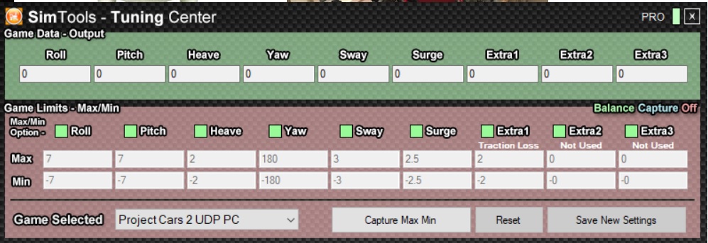

    Hi guys, is there anyone that plays project cars 2 with a 6 dof rig?
    I would like to know about your experience and if you were able to find a personal setting on your rig that makes you feel acceleration and deceleration of your car and switching gear and the movement of the tip of your rig when turning.
    Thanks!

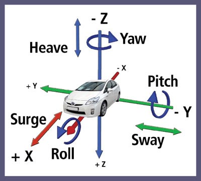

    But a lot of videos I have watched around of 3 dof give the impression that the rig itself have movements that make you feel the acceleration, deceleration and the turns .
    Are on a 6 dof these forces more spread/distributed across the 6 axes and hence felt less on 3 axes compared as a 3 dof or is it just that a 6 dof needs a more complex distribution of the forces during our manual set ups in symtools?
    21,581
    151,100Coins
    Even a 2DOF can simulate not just sway, roll, pitch and surge, but also heave. But a 6DOF can actually have a heave force. Things like surge can be simulated better with a 6DOF, but the extent of axis movement limits how long the sensation of a force can be sustained. That is why the likes of G-Seats, motion harnesses, wind simulation and the like are also popular additions to traditional motion rigs.

    Can anyone please suggest a setting for a 6 dof that would intensify the feelings of acceleration, deceleration, switch gear and movement of the tip of the rig toward the turns of the track ?
    21,581
    151,100Coins
    You have to tune a motion profile to a specific rig, rather than just drop in random settings, see here for the steps involved: https://www.xsimulator.net/community/faq/steps-to-create-a-motion-profile.228/

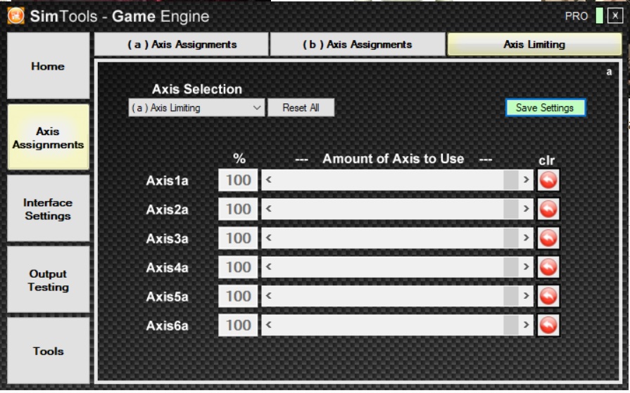

    The settings in axis assignment and in tuning center were shared with me and should be specific for the 6 dof I have. But reading I see the problem of clipping. Since it is a 6 dof rig, most probably it is easier to have clipping than a 3 dof,
    I was reading this comment you made
    https://www.xsimulator.net/communit...-loss-moving-while-stopped.10397/#post-143323
    How does it work for a 6 dof ? How should I distribute the allocation for the specific rig I have ?
    100% : 6 = 16.6 % ?
    How do I know which axes serve multiple DOF/forces?
    21,581
    151,100Coins
    What rig do you have? Can you please post some pictures and specifications.
    An Axis Allocation is not necessarily and even split between forces, some are likely to be higher than others, such as a sway allocation normally being higher that heave. But the total Axis Allocation should be around 100%.

    I have to say that by reading this post
    and playing with the values of the "tuning center" of simtools , I was able to set the 6 dof dofreality rig so that I can feel acceleration , deceleration , gear switch movements and swing feelings when getting inside turns.
    It worked for project cars 2 and it made even better dirt 3
