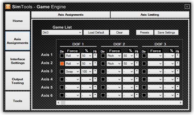

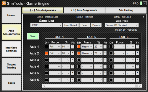

    I just setup Project cars in simtools and I am having a problem with the motion. The traction loss axis 3a is moving from side to side non stop, even when I am in the pits before starting the race. I got the plugin I found in the downloads section and below you can find my information and settings. Do you know what be happening and could you guys give me a hand.
    Commercial or DIY: Commercial
    DOF (Number of axles ): 3DOF
    Actuators (DIY, SCN5 etc.): SCN6
    Interface (Arduino, SCN, Mega, DIY etc. ): Came with the actuators
    SimTools
    Version: 2.1
    Game Plugin: Iracing, Assetto Corsa, Dirt Rally and others
    Settings (Relevant ones): Most settings are as per the quick-start guide
    SimTools Licence type: Pro

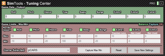

    You can also try adding a bit of DeadZone to the axis.
    But it does sound like the max/min values need adjusted as noorbeast suggests.

    Yes, As @noorbeast and @yobuddy suggest, try andjusting to a higher value for traction loss in tuningcenter.
    I think you have the same Commercial simulator i have, Try a value 7-9 for TL.
    Rembember to capture Min/Max values for Project Cars in tuning center!

    I understand that there will be a problem with high DOF % If only captured min/max values are used, and not adjusting the values to higher settings in tuning center manually.
    Example: Project cars have a min/max value for Pitch +- 10
    If the DOF% is set to 100% for Pitch, when/if the game outputs + or - 10 then the full range of the axis is used.
    Then if the tuningcenter value is increased to 20. (Still 100% DOF for Pitch) then only 50% of axis travel/range is used.
    If a lower value i used in tuning center (Still 100% DOF for Pitch) then also 100% of axis travel/range is used, but reaching this quicker due to lower tuning center value.
    If i understood things correctly DOF% is % of force (Data from game to use), NOT travel/range for axis.
    Depending on the Min/Max values in tuning center, the game engine calculates total axis travel/range for axis.
    So in theory 100% DOF for all forces can be used .. yes, it's only an example..
    But a high setting is necessary in tuning Center for all that forces to avoid clipping, reach max travel/range for axis.
    Please correct me if i got all this wrong.

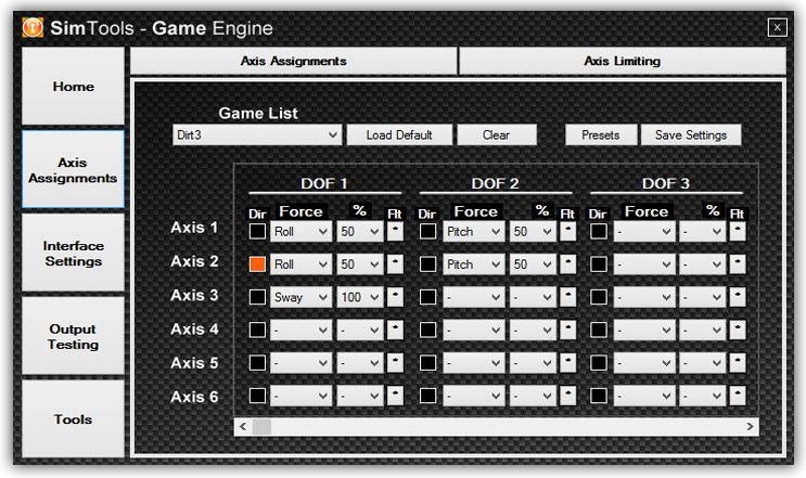

    I was able to fix the problem with Pcars TL. Once I got to capture Min/Max I could see that the TL was coming up at +/- 0.032 and that was the problem. I adjusted Extra 1 to +/- 10 and no more problem. Thanks for the tip.
    I have been trying to get better setups for my games but this is no easy task for sure. You can take a whole day of tweaking. I took Noorbeast's advice and lowered the total DOF for axis 1 and 2 and raised a bit for TL and I believe it did help. The setup I have for Pcars now seems to be almost the way I want, which is maximum reality, but I think I still need some more tweaking, what you guys think?

    if I understand well, the percentage that checks each axis must take into the total? (100%).
    For example, if I have only pitch and roll on Axis 1, I have to allocate 50% + 50% (see attachment), but if I have pitch, roll and heave, for example, I should keep around 33% + 33% + 33% ?!?
    I have always believed that every percentage was about strength on the single axis ...
    Thanks for the clarification, @yobuddy !!! :thumbs:thumbs:thumbs
  16. noorbeast
    21,597
    151,245Coins
    If an allocation serves more than one axis/force then yes it should total around 100%.
    However, that does not necessarily mean you always distribute the allocations evenly, rather what % you allocate depends on the design of the rig.
    If it is just roll and pitch then 50/50 is not a bad split, but if you have say a traditional 2DOF doing surge, sway, heave, pitch and roll then likely you would have higher allocations for something like sway and much lower allocations for the likes of heave, but the total should really be around 100%, you can go a little over, but you have to be careful not to overdo it.

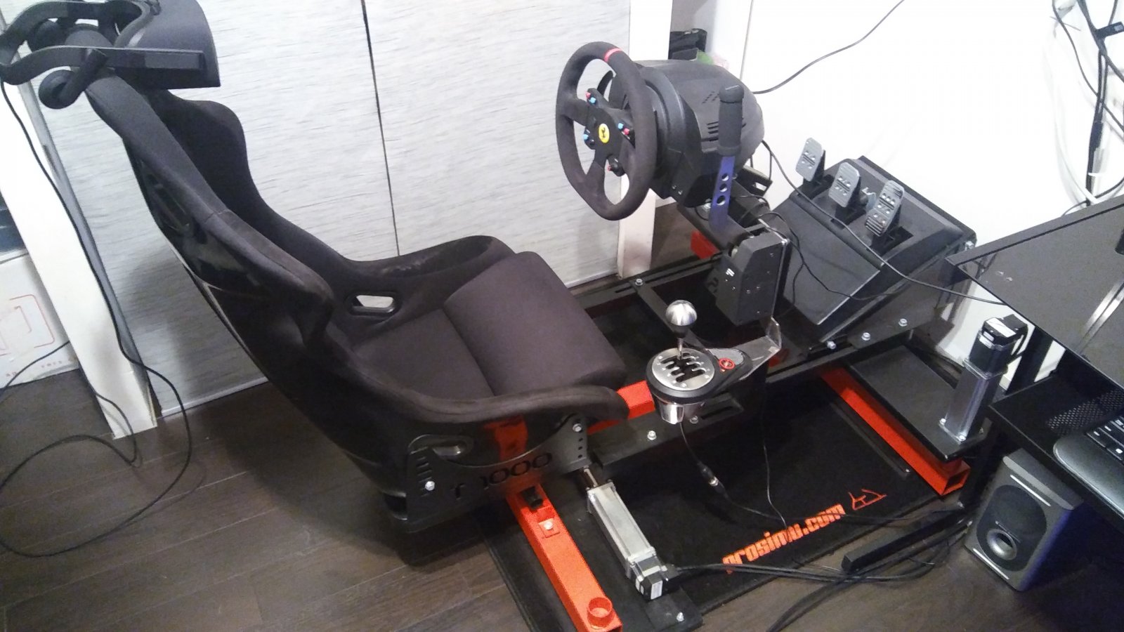

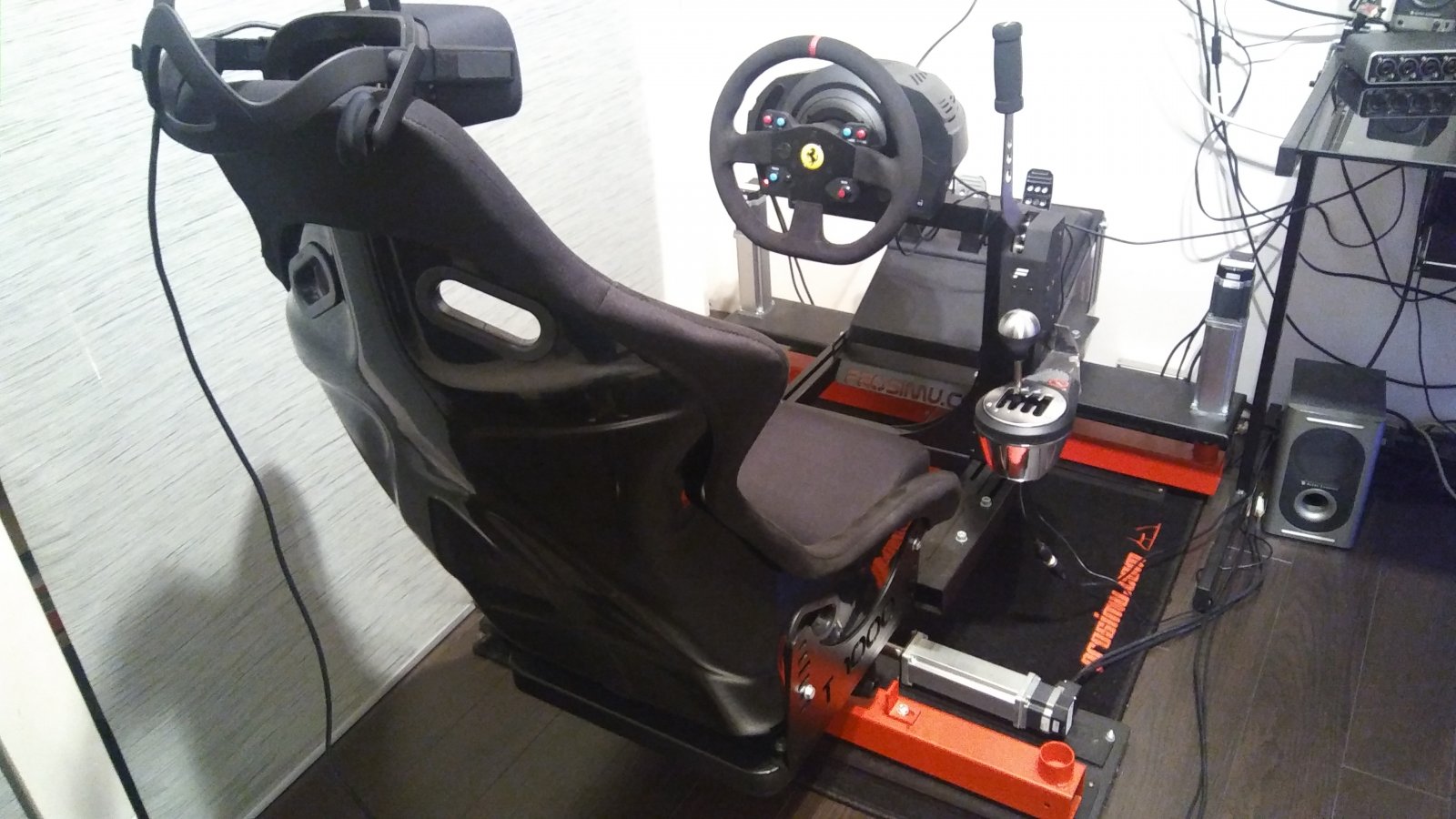

    Maybe we could have a dedicated area with Tuning Centre Values and Axis Settings for specific rigs and games for newcomers. I see that other members have already mentioned this idea, so maybe I am just not finding and there is already a dedicated area.
    Here are a couple of pics of my rig. I still need to do a lot of tweaking.
