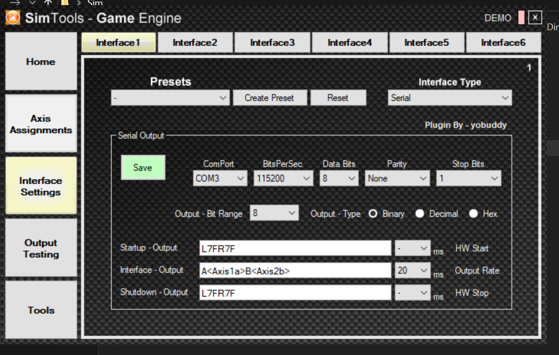

    Hi everyone!
    I'm starting to build my first 2dof diy.
    At first before build a frame I want to test the motor comunication.
    I've an Arduino Uno and ibt-2 shild for 24v wiper motor.
    I followed a guide for smc3 https://www.xsimulator.net/communit...3dof-motor-driver-and-windows-utilities.4957/ and I'm able to run correctly the code on smc3, but when I set the simtools 2.4 and try output test they doesn't work.
    I follow the guide to wire diagrams and change mode 2 on the Arduino code.
    Can someone get some help?
    22,150
    154,526Coins
    +11,185 / 57 / -2

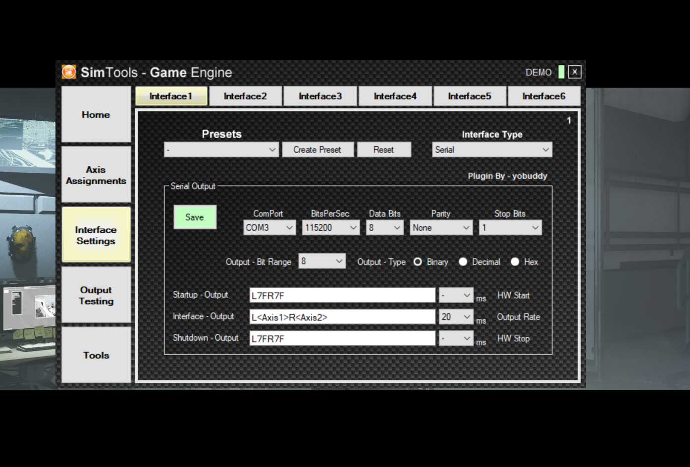

    The difference from the old SimTools 1.3 to the new SimTools 2 (which you are using) in setup is that in the Interface Settings instead of axis defined like this <Axis1> it now has designate grouping for a or b in SimTools 2 for each axis assignment, like this <Axis1a>
  3. kino
    kino New Member
    Nov 15, 2019
    8
    cnc programmer
    italy
    89Coins
    Ok I change this value but it still no work

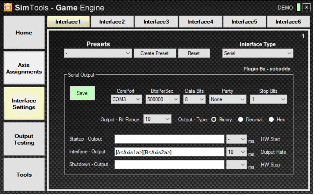

    I am going to presume everything works as expected with SMC3, if not then SMC3 has to be correctly configured before messing with SimTools.
    Once SMC3 is working in SimTools Interface Settings try:
    [A<Axis1a>][B<Axis2a>]
    Set for 10bit binary output
    BitsPerSec 500000 , N , 8 , 1 (10ms delay)
  5. kino
    kino New Member
    Nov 15, 2019
    8
    cnc programmer
    italy
    89Coins
    yes smc3 work but with your setting simtools still not work too

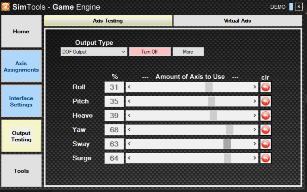

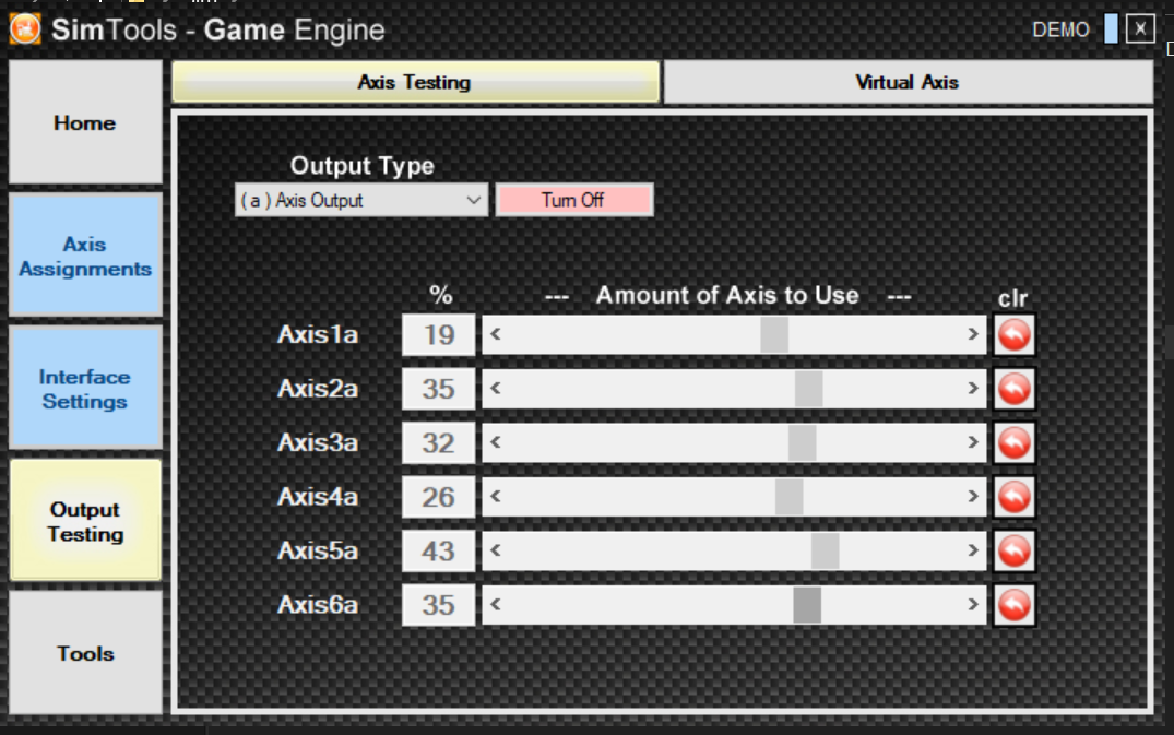

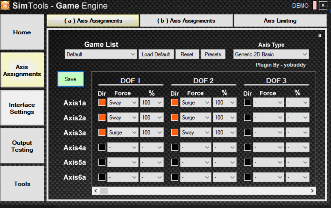

    Do you have a Default Axis Assignment configured, as that is what Output Testing uses?
  7. kino
    kino New Member
    Nov 15, 2019
    8
    cnc programmer
    italy
    89Coins
    yes but nothing

  11. SeatTime
    2,572
    You have also selected the wrong com port (COM3) in simtools - it should be COM4 as shown in your SMC-3 video:).
