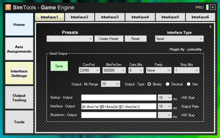

    Here are the answers to your questions:

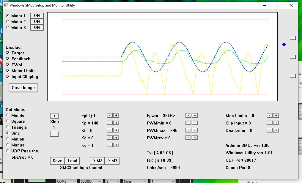

    #1: Sometimes it happens straight away when I activate the output testing, sometimes a while into the testing, I could not find a way to reproduce the behaviour, it appears to happen randomly and only one motor is affected.
    #2: In regards of your idea of the SMC3 configuration issue, what could it be? I took the latest SMC3 version and changed it to "Mode 2" for the use of IBT2, but nothing else.
    #3: The settings are the standard settings in SimTools for the connection to the Arduino and for everything else I will post the screenshots shortly.

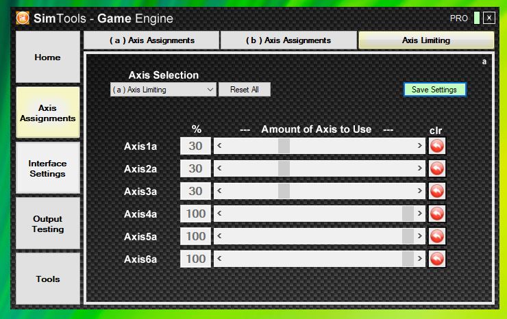

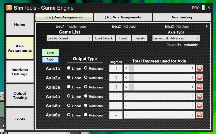

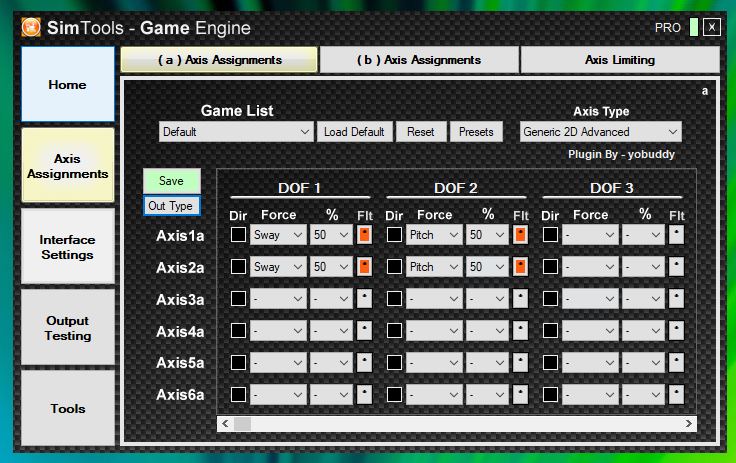

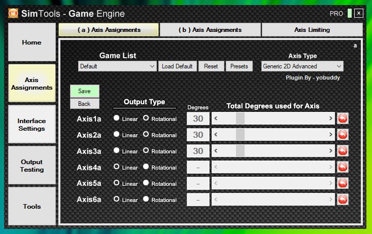

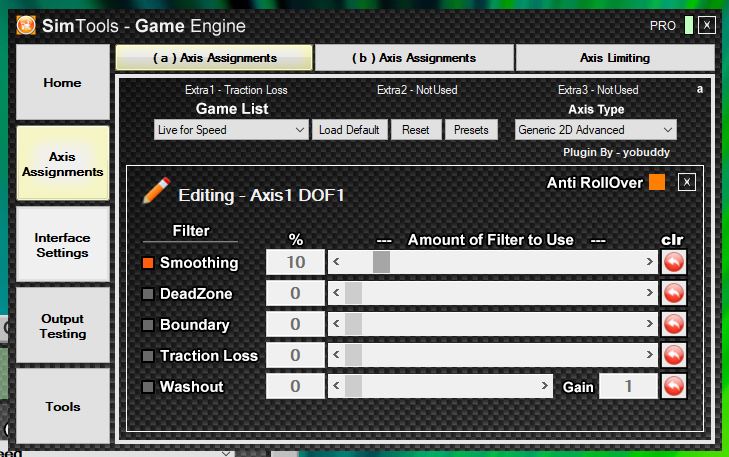

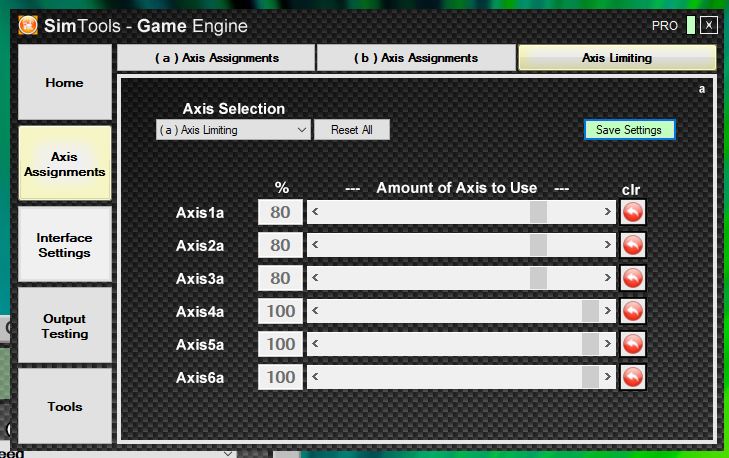

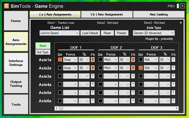

    here are the screenshots for the settings of my setup. I hope this might help you to identify the issue I currently
    have with my rig.
    picture1.JPG picture2.JPG picture3.JPG picture4.JPG picture5.JPG picture6.JPG picture7.JPG picture8.JPG picture9.JPG picture10.JPG
    22,045
    153,866Coins
    +11,152 / 57 / -2
    I would suggest a back to basics approach.
    First refine the SMC3 settings, you want the green line to track the blue as close as possible and in particular set the Max Limits and Clip Input to control the range, see the functional explanations here: https://www.xsimulator.net/communit...driver-and-windows-utilities.4957/#post-48121
    Once SMC3 if fully sorted then you can start with SimTools, grab a copy of the SimTools manual and keep it handy for reference: https://www.xsimulator.net/community/faq/rtfm-start-with-the-official-simtools-documentation.117/
    Initially do not use filters or limit axis, instead initially dial in each axis individually, before enabling them all and tweaking from there, see the tips here: https://www.xsimulator.net/community/faq/steps-to-create-a-motion-profile.228/
    Be mindful of the Axis Assignment % totals: https://www.xsimulator.net/community/faq/axis-assignment-percentage-totals.120/

    I followed the SMC3 manual and the result was/is the collapsing behaviour for motor #1, I changed the IBT2, checked and adjusted the rotation sensors.
    So I will reset most settings and start from scratch,
    22,045
    153,866Coins
    +11,152 / 57 / -2
    As mentioned you need to set the SMC3 Max Limits and Clip Input to control the range., along with refining SMC3 PID settings.

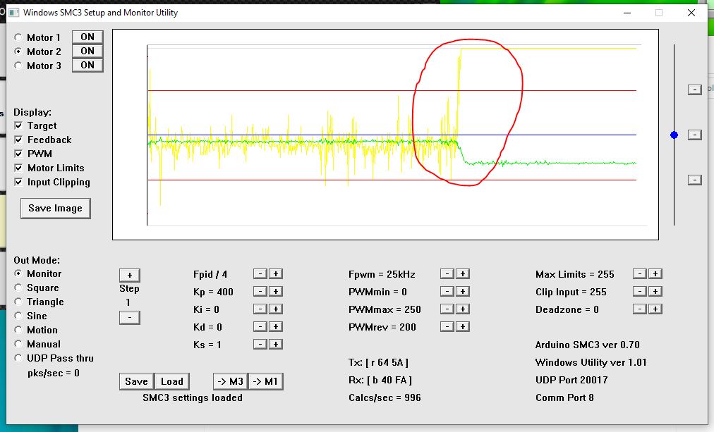

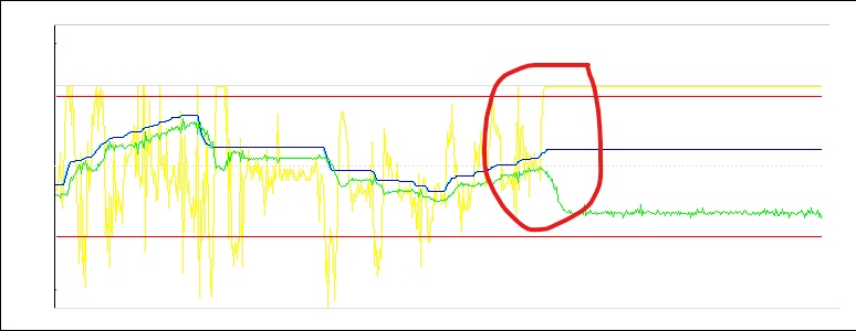

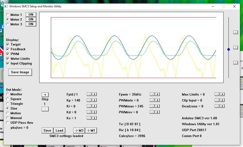

    Me again,
    I did all what was recommended above, but it did not help with my issue.

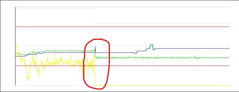

    However, I found that when the motor collapses the PWM signal becomes very high and flatlines as see in the screenshots below. Before this happens all works as expected. I also played with different settings form the one suggested in the manual to many others, the behaviour is always the same.
    I even rewired some cables, because I thought the issue might be bad cabling.
    I am a bit lost the moment and help would be much appreciated.
    Thank you.
    Screenshot with settings
    Motor #1 at the moment of the collapse
    SMC3-Capture-74411.9732276_LI.jpg Motor #2 at the moment of the collapse
    22,045
    153,866Coins
    +11,152 / 57 / -2
    On the mechanical side how long is the lever CTC?
    Try a CTC of 50-60mm.
    In addition a lever becomes inefficient in terms of torque over about 38 degrees up and down.

    Any idea why the PWM signal goes flat?
  12. noorbeast
    22,045
    153,866Coins
    +11,152 / 57 / -2
    I would expect it is triggered by a disconnect.

    Try set PWMAX to 140-170,
    because my motor turn off when there is heavy movement with more than 170 PWMAX , so try lower it maybe it help,
    using 2x IBT-2 as for one motor helped me alot , look at this thread https://www.xsimulator.net/communit...-a-single-motor-driver-more-power.5482/page-7

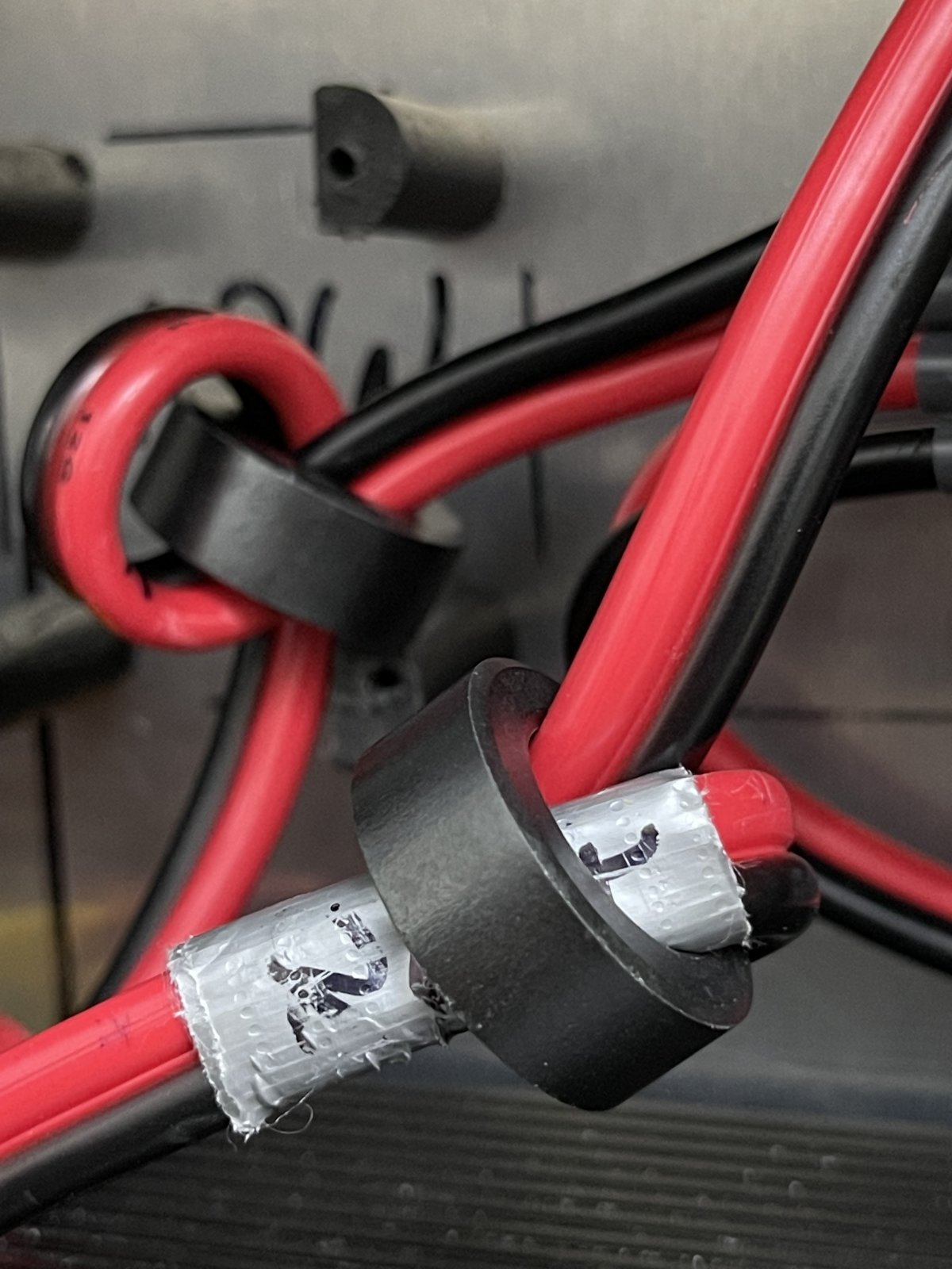

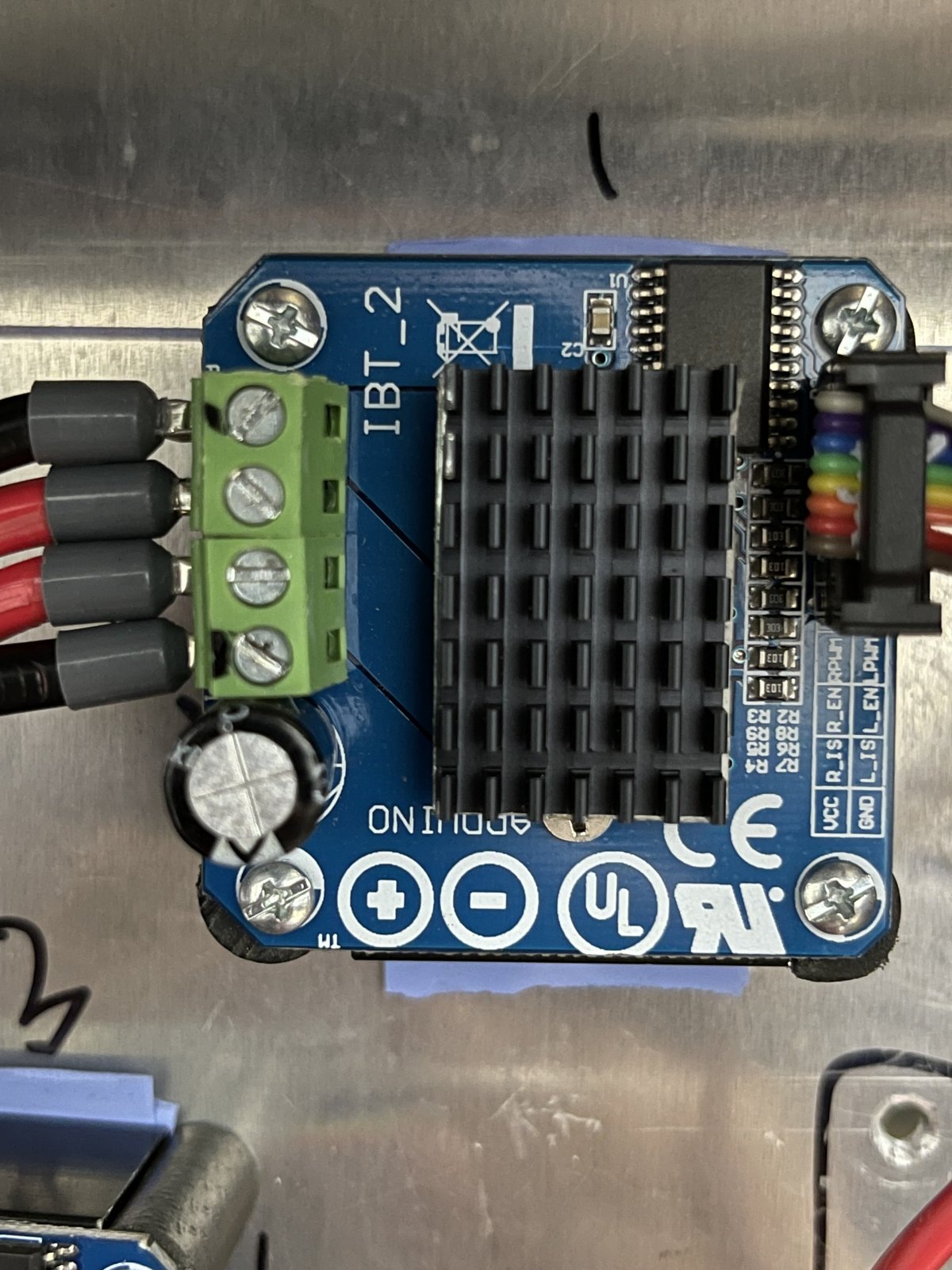

    Here is an update from my rig, I was able to drive 10min today without issues and without major changes to the rig itself. So what did I change?
    First I installed some small heatsinks on both the BTS7960 chips of the IBT-2 controllers.
    They look a bit funny, because I had to divide a bigger to fit the size of the chips.
    The second thing I did, was to wrap the power cables and the wires between the IBT2 and the Arduino through some ferrite rings.
    These action improved the data signal quality significantly, I will post a screenshot here in the next few days.
    I will also post my new settings for SMC3Utils, thanks to @absyfadhel1 and his ideas.
    Working on the rig are now, the left and right motor, the bass transducer (buttkicker) and the fans for wind simulation.

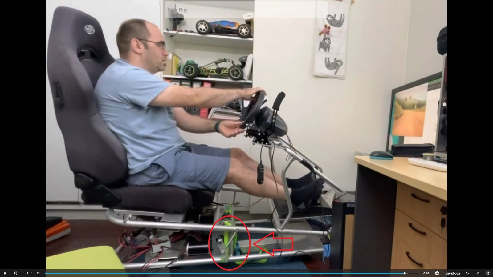

    To do: Traction loss, it is technically working, however the rollers I currently are not good enough and the friction is to high. I will replace them with heavy duty ball bearings. Also not finished yet, is the seat belt tensioner, because the motor I planned to use, is electrical not isolated, so back to the drawing board for this one.
    Once everything is working, I will transport it back to the workshop to change a bit on the sim rig, like improvement to the balance and centre of gravity, shorten the front overhang. reposition the handbrake and other smaller stuff.
