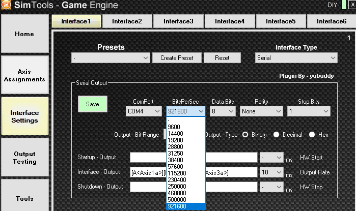

    i saw this and i thought its maybe like my problem, i think that my arduino get overloded so its crash.
    does this faq help in any h-bridge driver, or only for sabertooh
    https://www.xsimulator.net/community/faq/baud-rate-arduino-and-sabertooth.339/
    when i change 115200 baud instead of 500000 in simtools there is no motion , so do i need to ground pin 8 and reset as said in faq?... aif so so all i need to put wire from pin 8 to the motion body or somthig els?

    i tried make it 91600 and 115200 but no motion, only if it on 500000 its work but stiop the motion when fast move

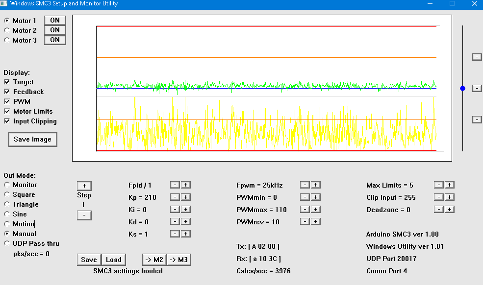

    This is my setting
  7. absyfadhel1
    absyfadhel1 Member
    Oct 19, 2017
    329
    bahrain
    442Coins
    +33 / 0 / -0

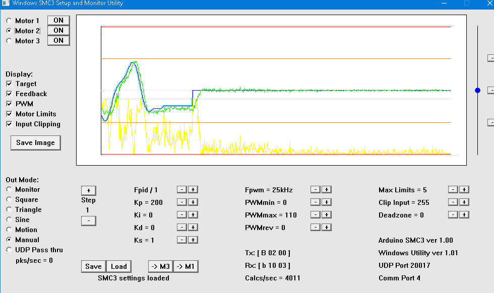

    when motor on green line look like what is show now, but when motor of is straight , nothing touching body i check all wire and connection everything good
    21,669
    151,668Coins
    +11,045 / 56 / -2
    Max limits is very low.

    oh yes bro its for more safety , but my motor didnt across the max limit the motor turn off when i move the motor fast
  13. noorbeast
    21,669
    151,668Coins
    +11,045 / 56 / -2
    Moving a motor fast tends to be associated with overshoots.

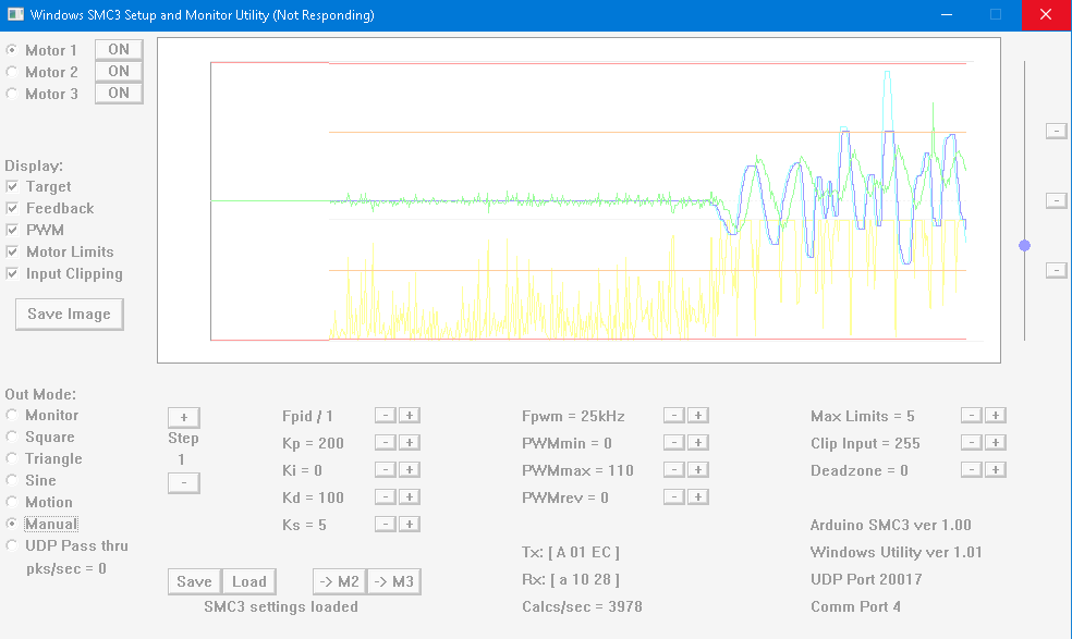

    so what i need to do in this situation ?
  16. absyfadhel1
    absyfadhel1 Member
    Oct 19, 2017
    329
    bahrain
    442Coins
    +33 / 0 / -0
    do i need just to increase kd?
