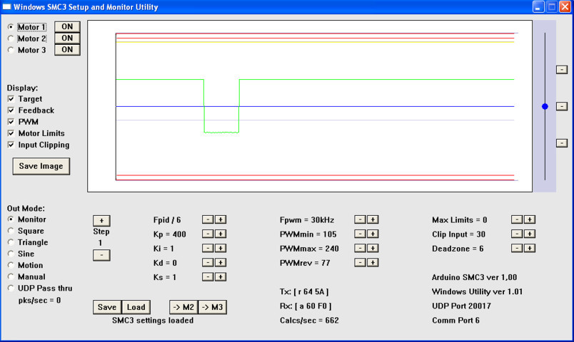

    Then I did some tests for a fine adjustment, in my picture my settings:
    Motore 2=Motore 1

    Thank you for the assistance. I will try a change to the settings. I am using the igt-2 so i wonder if i may have tripped something in the hbridge.
    I will try and get some time on the project tomorrow.
    I see you p setting is quite big 400 mine is only 4 !

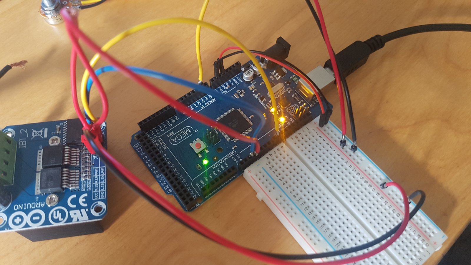

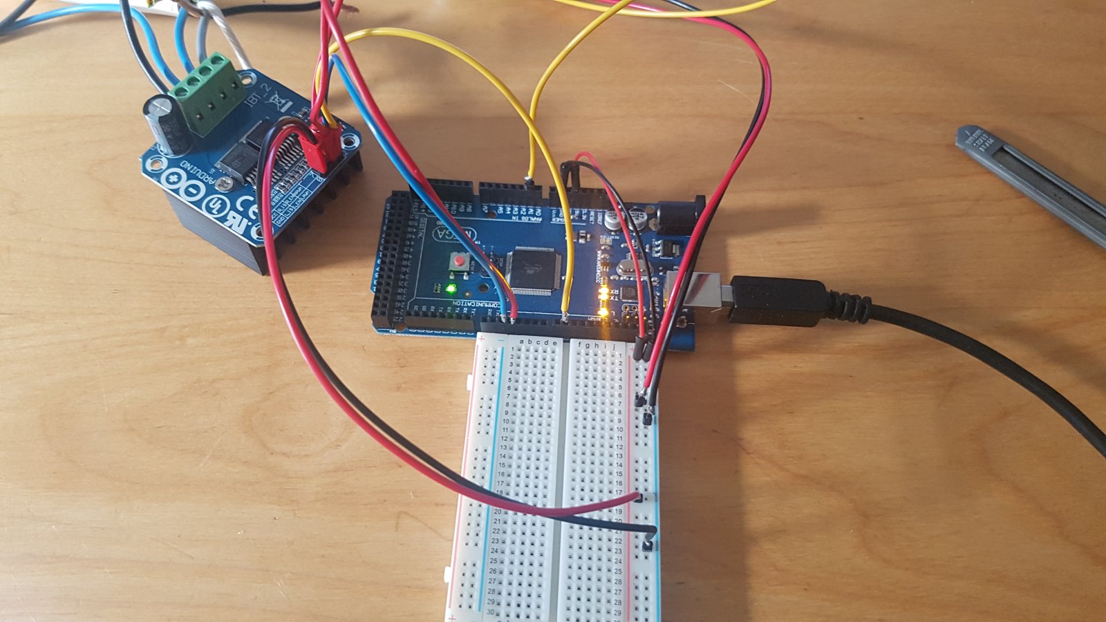

    Hi together,
    before I can starting with my problem -> I am using an Arduino Mega board! Is that a problem?
    I have a problem with the BT-2 Setup, because my motor doesn't move. I have wiring up my BT-2 and Arduino like on the first page.
    I have set the Mode to Mode2 and uploaded it to my arduino.
    When I start the SMC3 Utility, I can see the PWM output, but nothing happens.
    For testing, I have only one H-Bridge, Motor and Pot connected to my Arduino - hope that this is ok.
    I did tested the H-Bridge, Arduino and Motor with another script, where I can control the motor with the pot and that's works - So, I have no idea what's the problem.
    Can anyone help me? Would be great, because we finished the chair - only the electronic is missing.
    Thanks and Cheers
    Jochen

    Make sure MODE2 is written in capitals...
    #define MODE2

    The SMC3 code ONLY shuts down the motors if the POT feedback signal goes beyond the Max Limits setting. If the POT feedback is not going outside these limits it's not the software - probably the H-Bridge drivers going into thermal shutdown or overcurrent shutdown.
    Note if the SMC3 is shutting down the motors (you see the button in the top left of the SMC3Utils program say OFF) but you don't think the feedback is going out of range then you probably have noise in the system somewhere. A very short spike is enough for SMC3 to shut the motors down if the spike goes beyond the Max Limits but it might not display on the graph because its so short.
    If the motors shutdown but SMC3Utils still says ON in the top left of screen then it is the H-Bridges shutting down or PSU or other hardware issue.
  17. CaptBluescreen
    CaptBluescreen New Member
    Aug 31, 2017
    131Coins
    Yes, MODE2 is written in capitals. I think, that it is a MegaBoard problem. I found something about PORTD = portstatus; and that it will not work on a MegaBoard - so I have to wait for my Uno to arrive.

  19. CaptBluescreen
    Aug 31, 2017
    131Coins
    Hi at all,
    so i tested a little bit around and searched for the problem with the PORTD mapping on an Arduino MEGA2560 and I found out, that I had to remap the PORTD.
    So, I added this into the setup() function:
    DDRD = 0B11111111;
    PORTD = 0B11111111;
    OutputPort =PORTD;
    I set the digital pins 0-7 as output and as high. (Not sure if it is correct)
    Then I have tested it again with the wiring diagramm from the first page.
    The motor doesn't moved. So, I connected R_EN and L_EN to 5v. The motor moved, but only in clockwise. When I switched the RPWM and LPWM, the direction changed.
    I would be interested in how you wired the h-bridge. I have a BTS7960 H-Bridge. I get only On or Off signal on the PWM Pin 9 - I can disconnect the Digital Pin 2, it makes no difference...
