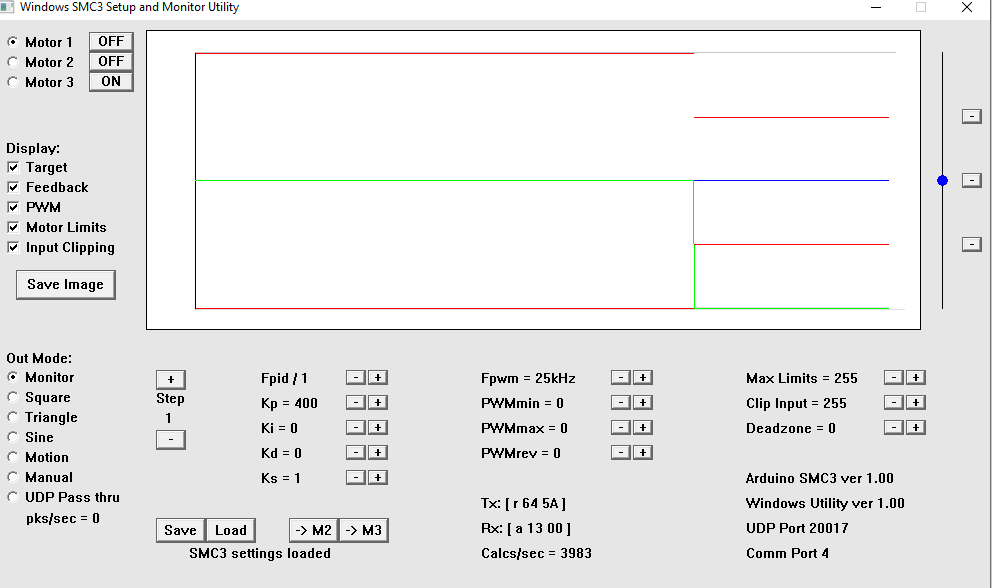

    and this happen when i launch smc3

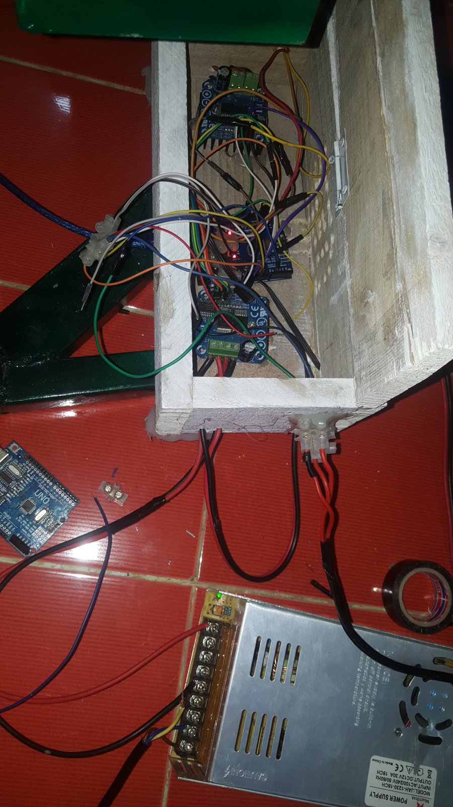

    Can you please post some hardware pecs and pictures, we are flying blind without knowing specifically what you are using.

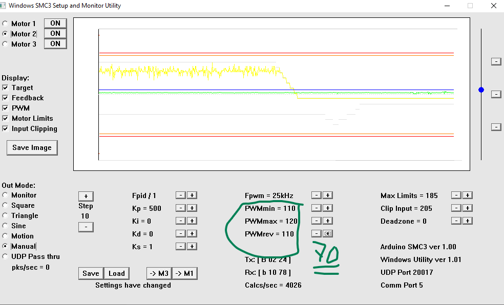

    the problem is when the setting in the circle below 70 motor work but when above nothing move
    22,032
    153,788Coins
    +11,150 / 57 / -2
    They look to be IBT2s, so before we get into other possibilities can I please confirm are you using Mode 2 in the SMC3 code?
  8. MarkusB
    Jun 30, 2015
    552
    4,215Coins
    +597 / 2 / -0
    The PWMmin and PWMrev values are quite high. Have you tried to set them all to zero and then only increase PWMmax, as it is described in the SMC3 tutorial?

    this is the problem
  11. hannibal
    hannibal Active Member
    Sep 29, 2018
    677
    4,492Coins
    +298 / 4 / -0
    your pot looks super noisy... have you tested the movement of the motor with the pot separate?

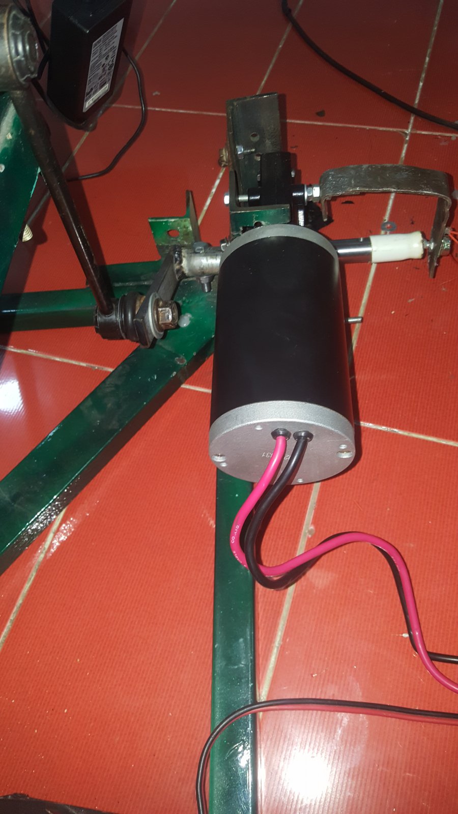

    when i test the motor and check force via putting the cable direct to psu not to the ibt board the motor push perfect but via the ibt2 board no force, this what i tried:
    change wires,
    change psu,
    change pot,
    change arduino and ibt,
    check in another pc.
    help please

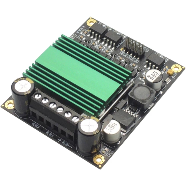

    is there any powerful board to replace it with ibt-2?

    Update: i tried to double ibt-2 for motor and the motor worked above 200 PWMrmax , put when i try to force the lever by my hand the ibt-2 cut the power from the motor so the issue not solved! help

    Interesting I have the same problem. It is not a deal breaker because I have leveled the seat so not so much force is needed but if I force the force to the seat i can also trigger shuts down of the motor. After I reset the arduino (i have made a reset button) it powers it up again.
    Does this happens to both motors? Could it be that it is only one of the IBT-2 weaker?

    hi, as in title , where to buy 100a h bridge 12v motor driver?
    like this one?

    when i tried to tunning center for no limit 2 after save setting the motor go forward and backsword fast and make crash, but in lfs and assetto corsa its fine help!
  20. noorbeast
    22,032
    153,788Coins
    +11,150 / 57 / -2
    Sounds like the TC values are way too low, did you capture the Max and Min values first?
