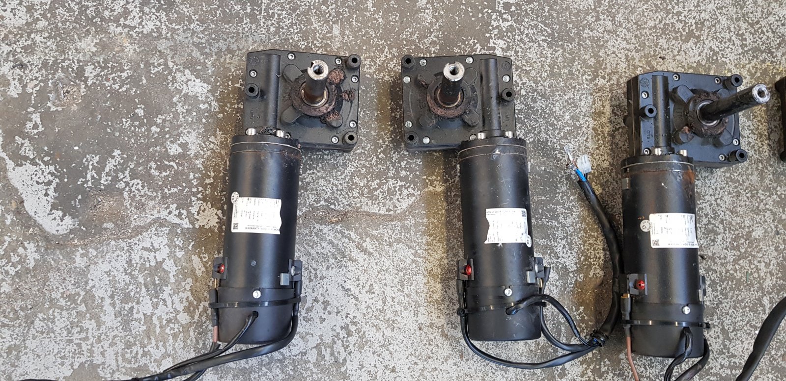

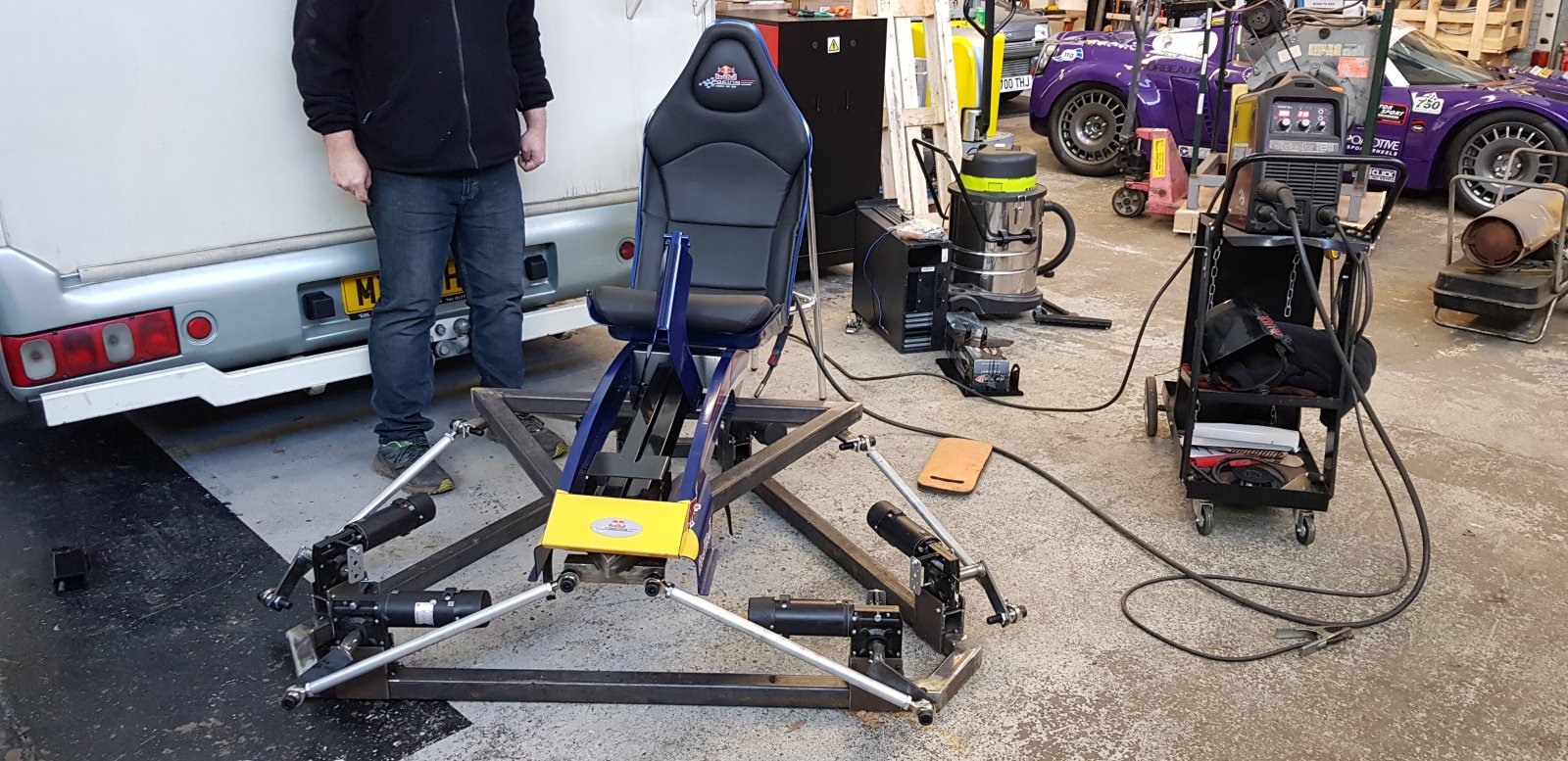

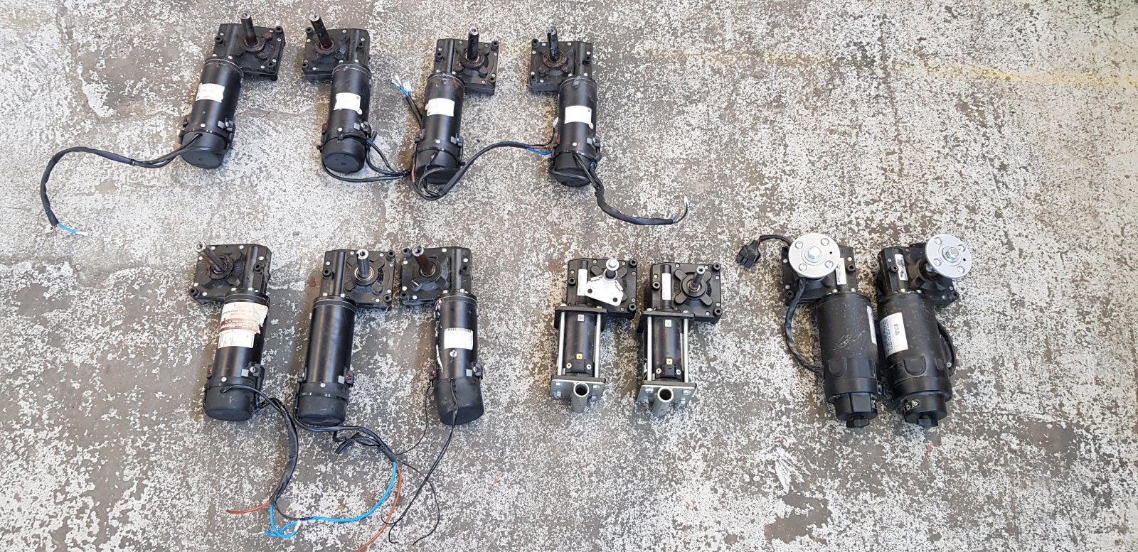

    some motors and a hydraulic pump and actuator
    i have quite a few motors now all the same spec and more on thier way
    all the same gearbox 25:1
    24v
    17 amps
    watts = volts x amps = 24 * 17 = 408
    135 rpm
    more on thier way so i will have 12 soon enough
    6 is enough to start building

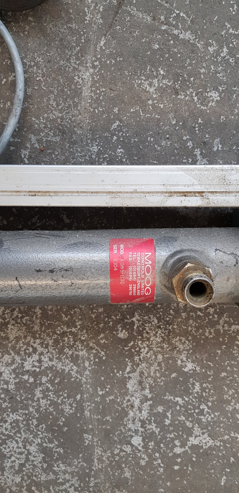

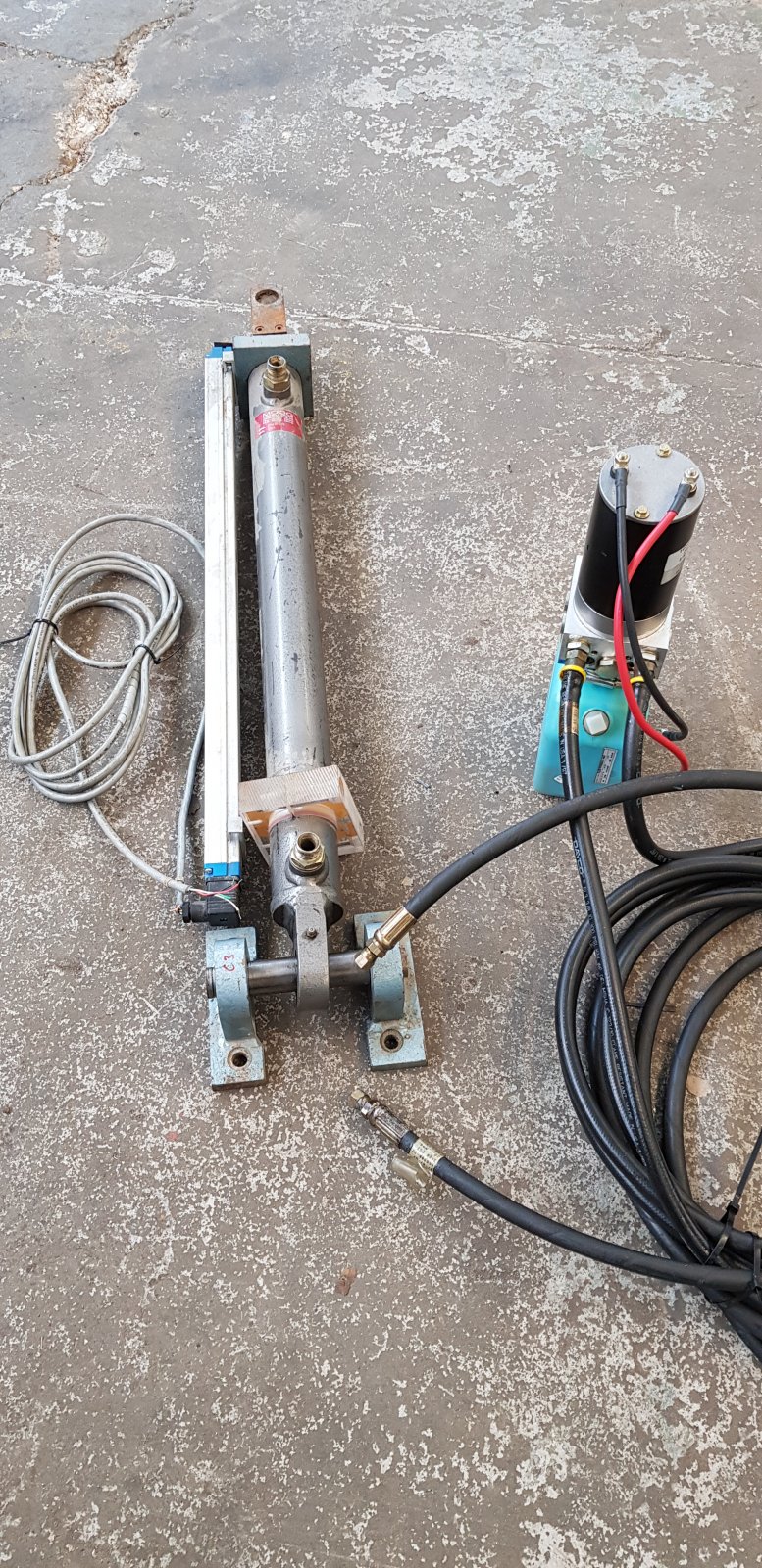

    (I also have 6 hydraulic rams, I am going to plumb it into the actustor and see how fast i can drive it with 24v - might be a whole new type of rig - might be a big flop too !)
    so i have to decide how to mount the motors to the base - do I mount them so the motors all face towards the centre or do I mount them so they sit in pairs on the sides of a triangle
    hopefully will find time to run the hydraulic test tomorrow

    The hydraulic actuator test was not a great success
    The thing leaked everywhere and made a mess and the speed was very poor.
    The motor i have is for a much smaller bore.
    I will look at a more powerful pump but i guess it will work best with a high pressure 3 phase pump and solenoids to drive each actuator

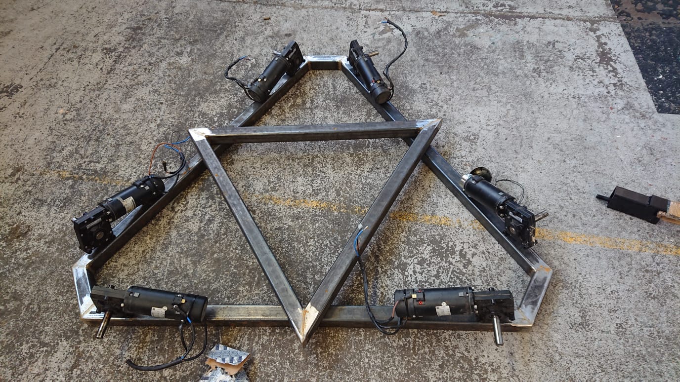

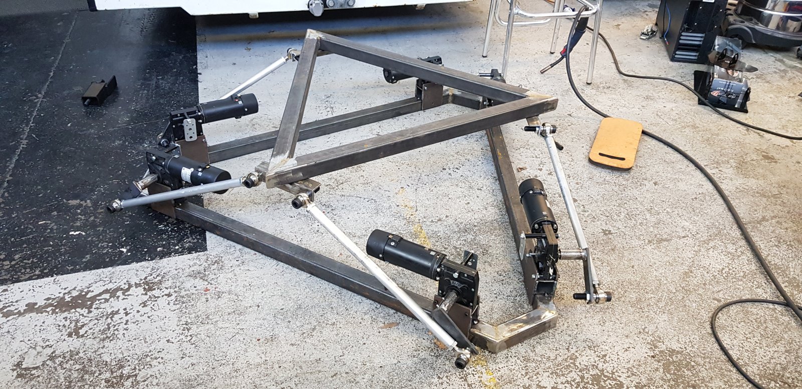

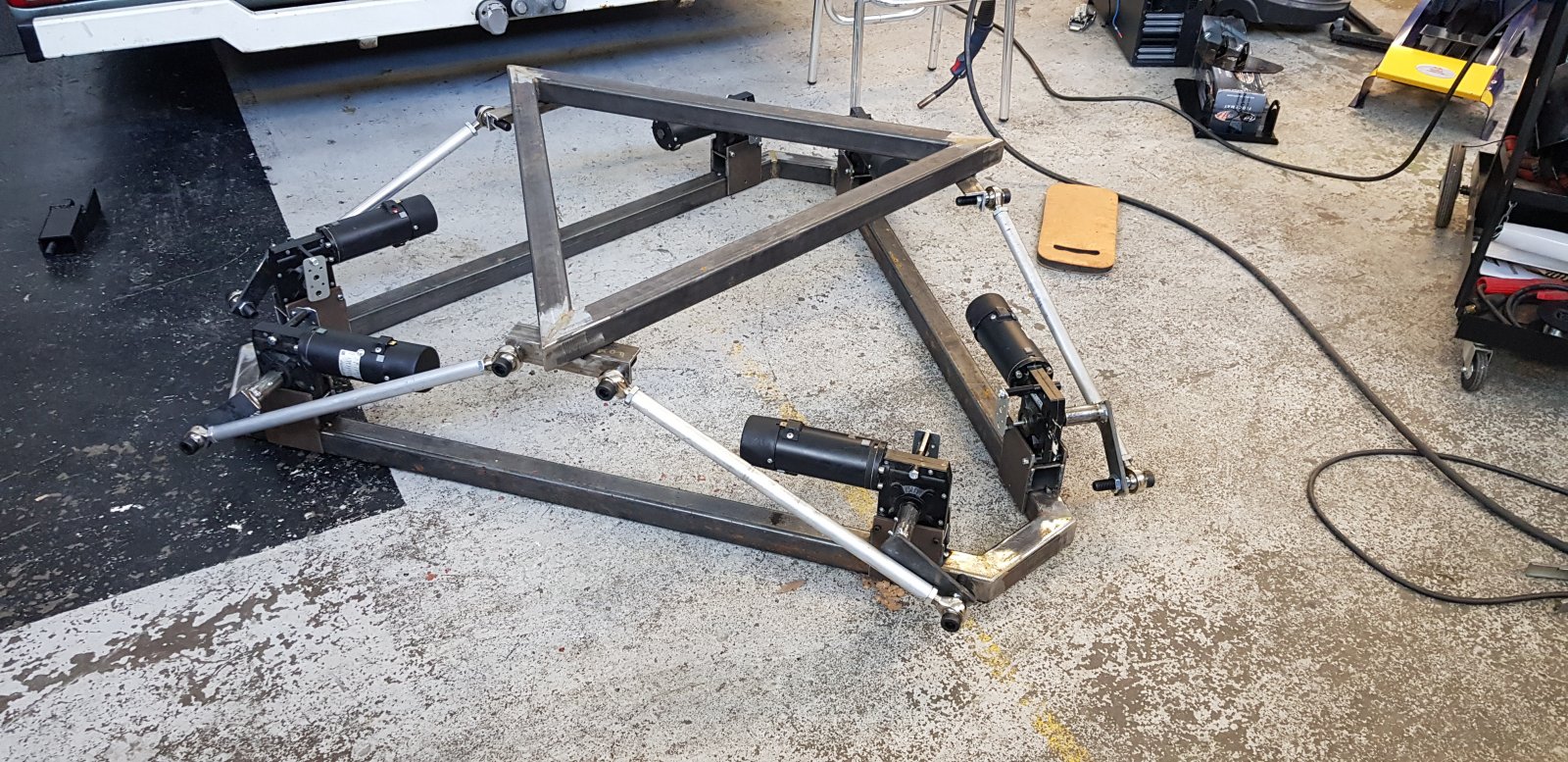

    i have gone for a triangular base that is 1.3 M on each side spaced out with flat joiners on the edges
    the platform is a triangle that is 1 M on each edge
    constructed from 50mm box
    pics soon

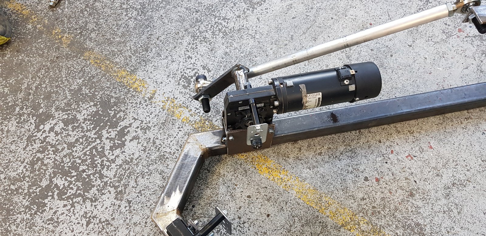

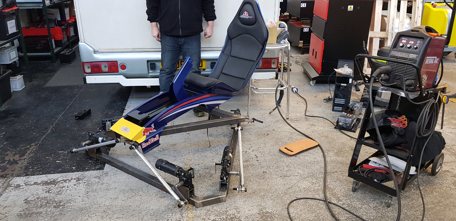

    image of the frame attached - welding the motor brackets next
  13. Gadget999
    1,959
    11,983Coins
    +484 / 10 / -0

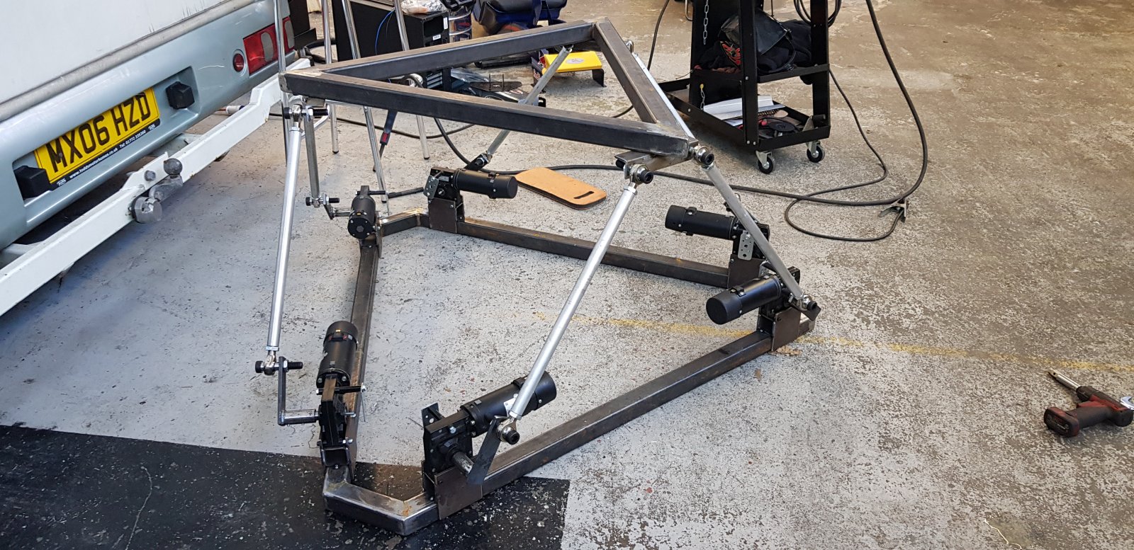

    Some pics of the build
    I have one motor wired up with a 180 degree pot and an arduino nano
    It appears i only have 90 degrees of movement - is this because i have 180 pots not 360 pots ?
  14. pmvcda
    pmvcda aka FlyPT
    Nov 3, 2010
    2,180
    Portugal
    15,393Coins
    +2,601 / 17 / -0
    Yes, you need 360º for more degrees unless you use a gearbox to reduce, but you loose precision.

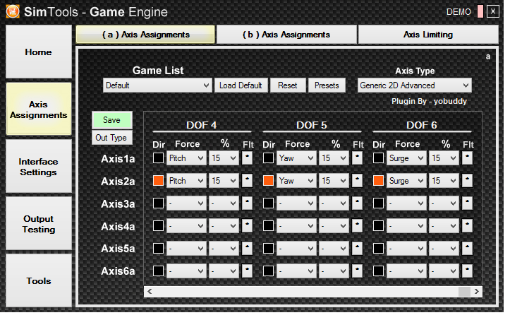

    so the next step is configuring simtools
    i plan to have 3 arduinos - 2 motors on each so 3 interfaces, each on a different com port
    i have the first pair working and i can move them in the software
    how do i set up the axes for a 6dof ?
    is it 2 axes per arduino and they can all do each of the 6dof ?
    i have attached images of how i think i should set up the first arduino / motors
    do i set up arduino 2 and 3 the same ?
    any suggestions greatly appreciated :)
    (does sim tools see each arduino as a 2DOF ?)
