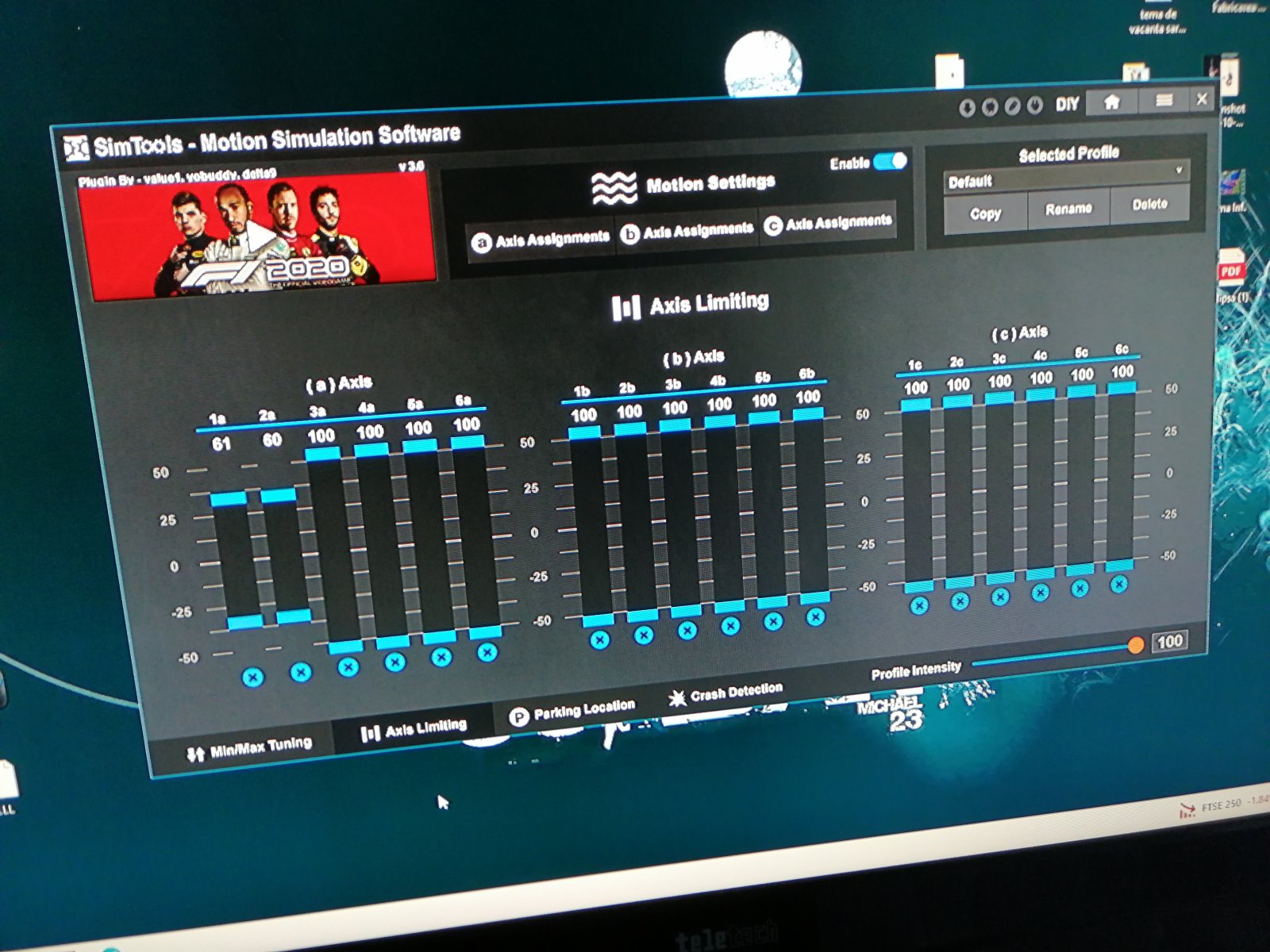

    I have a problem, when I start simtools my sim rig sits straight, when I open axis testing it leans to one side, then when I play f1 its shaking, no game telemetry

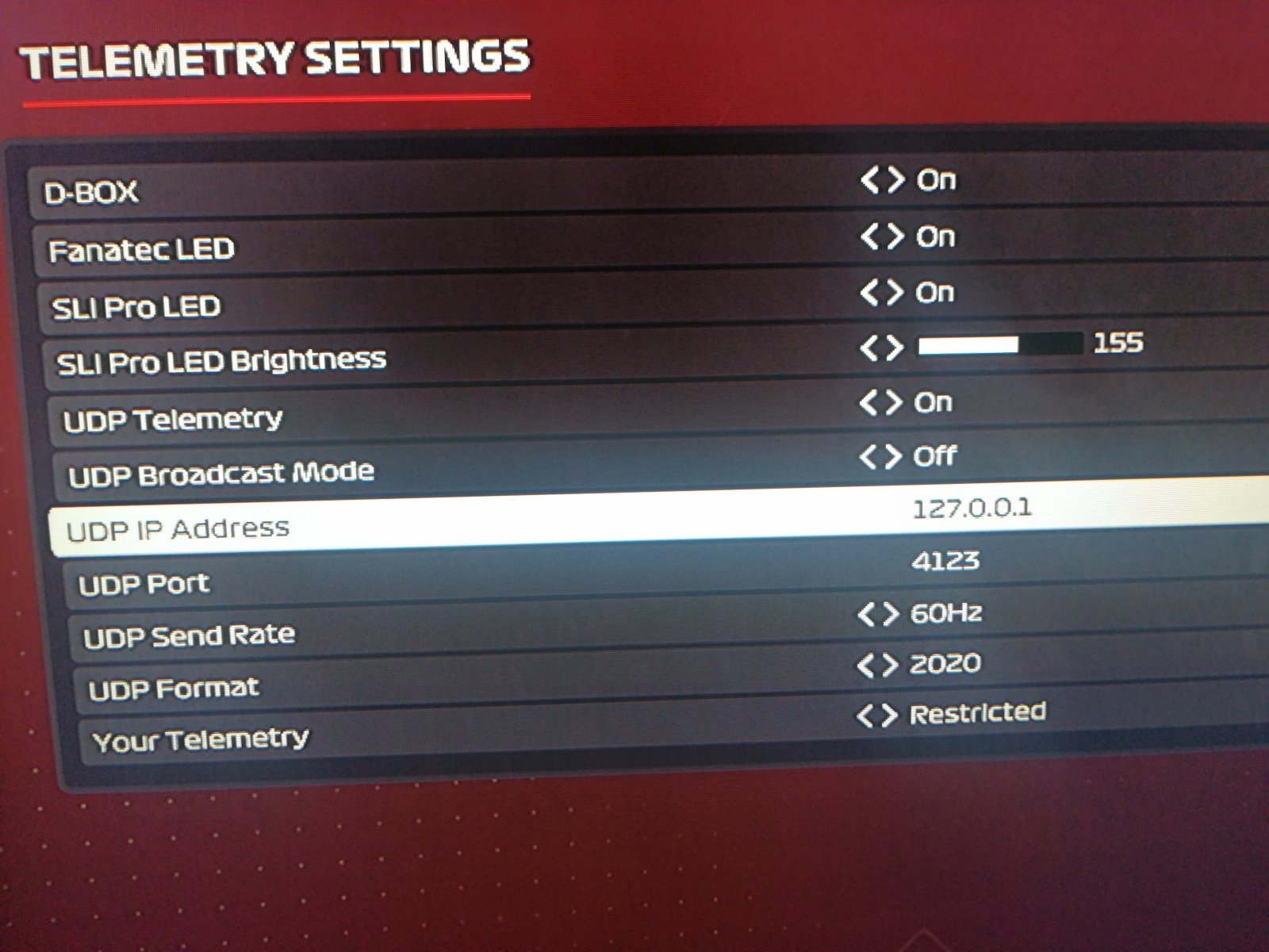

    Hello. This is the telemetry I have, it's ok or i have to change something?

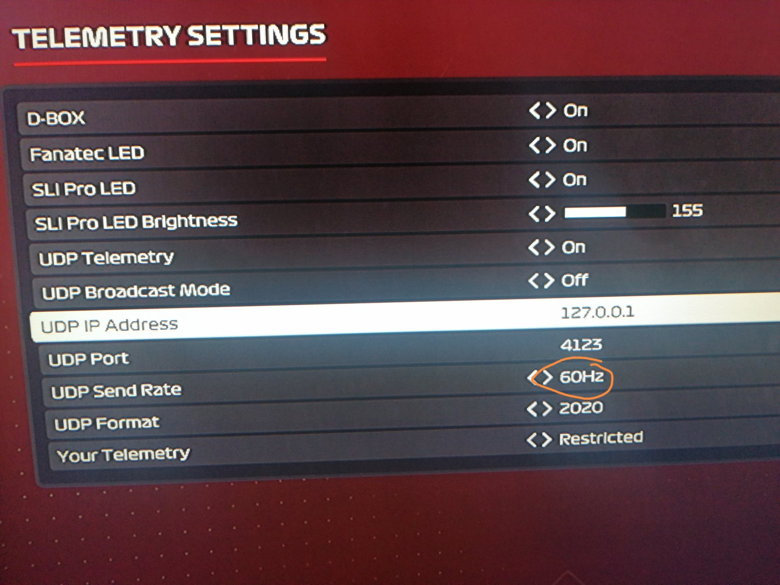

    Hello, is it necessary to reinstall simtools with firewall and antivirus disabled?
  16. noorbeast
    22,225
    154,819Coins
    +11,226 / 57 / -2
    Sometimes, SimTools by necessity accesses game data and some AV get overly aggressive.

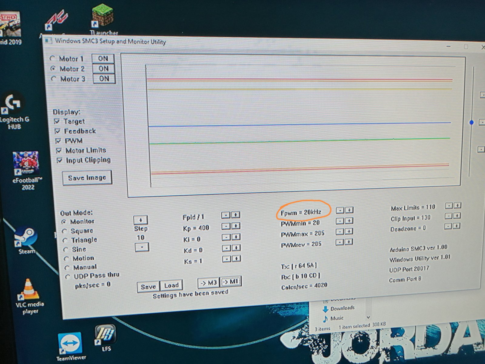

    Hello. Is there any relation between khz in telemetry and khz in smc3 utility?

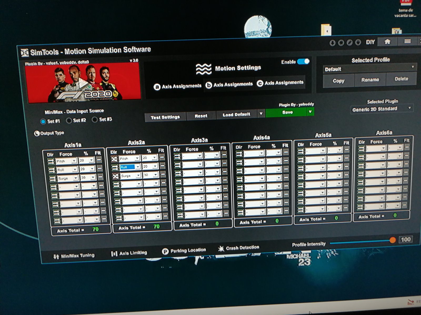

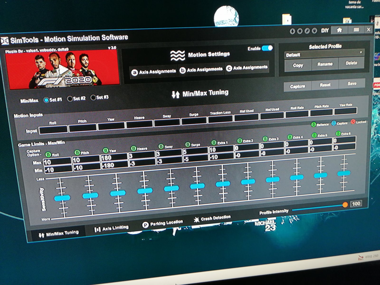

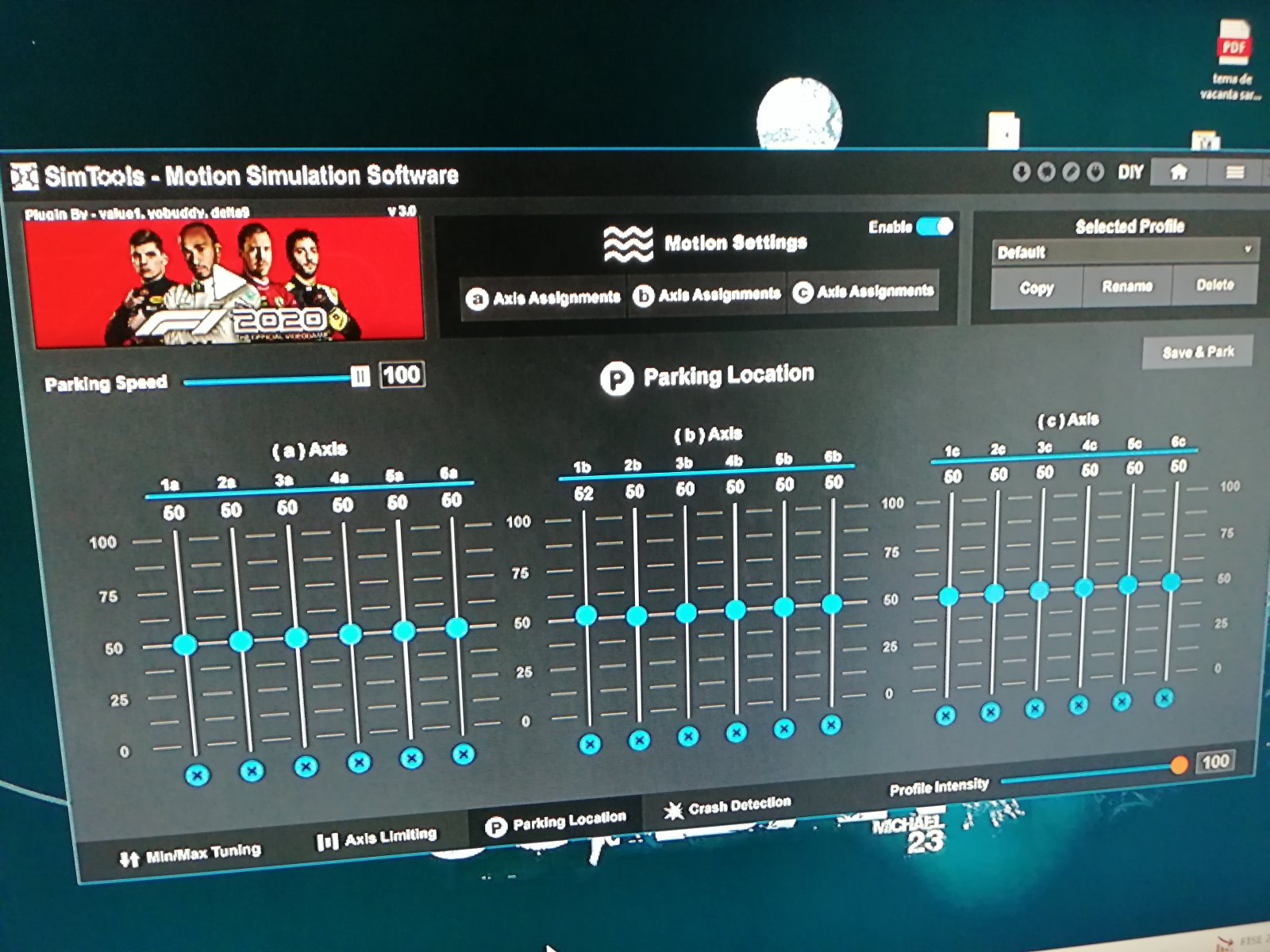

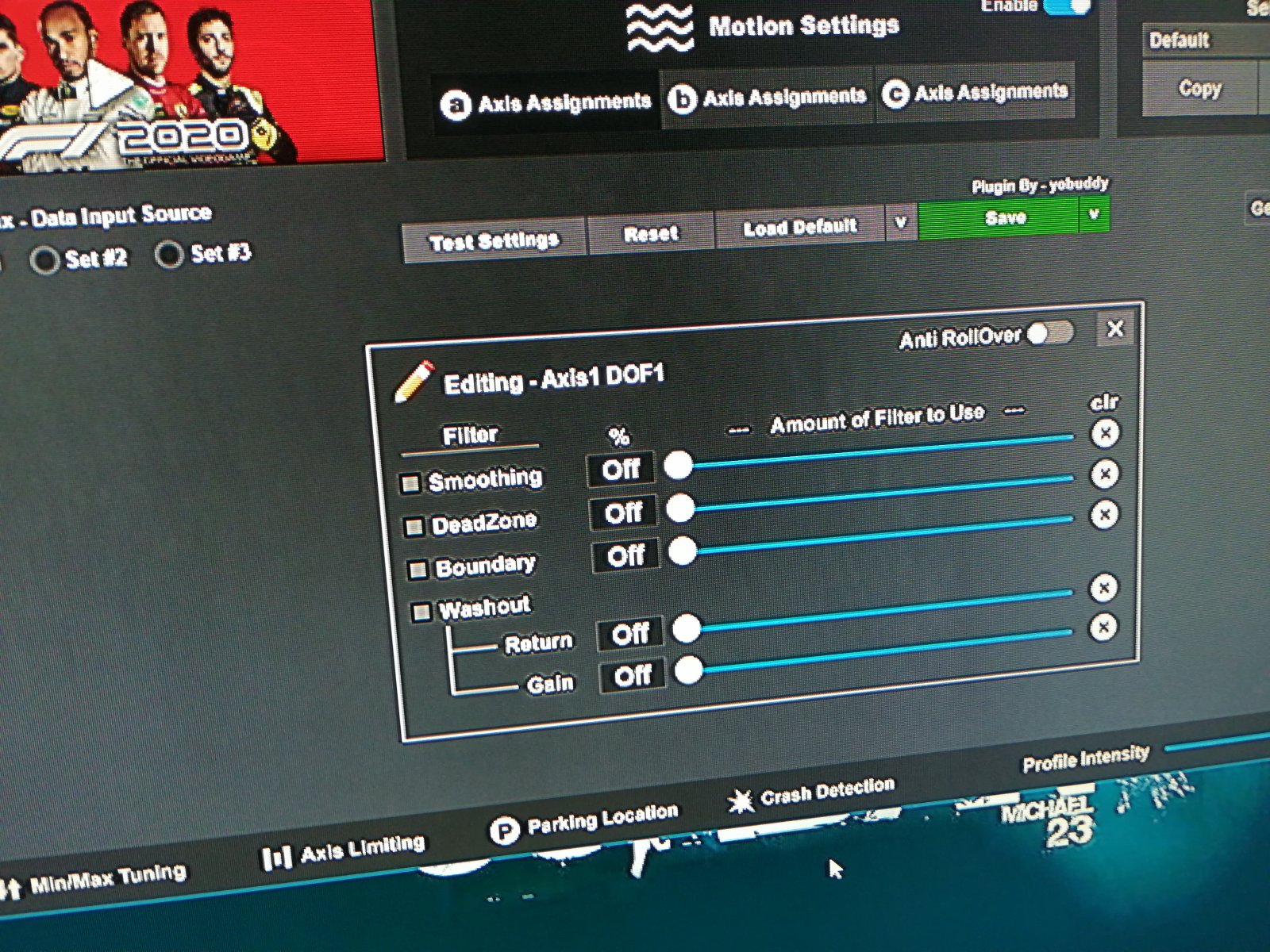

    Hello. What are these settings for?
  19. noorbeast
    22,225
    154,819Coins
    +11,226 / 57 / -2
  20. noorbeast
    22,225
    154,819Coins
    +11,226 / 57 / -2
    A SimTools v3 manual has yet to be written, as it is in Beta testing and subject to change, but fundamentally the Tuning Center values serve the same purpose as in V2, p.77 onwards: https://www.xsimulator.net/community/faq/rtfm-start-with-the-official-simtools-documentation.117/
    Also see the motion profile tuning tips in the FAQs: https://www.xsimulator.net/community/faq/steps-to-create-a-motion-profile.228/
    Basically you capture base settings for the Tuning Center: http://www.xsimulator.net/community/faq/set-base-tuning-motion-values-in-the-tuning-center.122/
    From there manually tweak the settings. Raising the Tuning Center values will soften the motion over a greater axis movement, lowering the value will do the reverse. See here for an expanded explanation: https://www.xsimulator.net/community/threads/graphic-simtools-parameter-adjustment.9054/#post-113925
