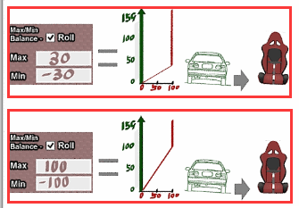

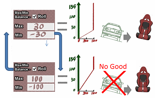

    Because of the language barrier, I hope to more intuitive way to my SIMTOOLS parameters of understanding.
    [​IMG][​IMG]
    The car in the picture indicates the movement of the car in the game.
    [​IMG][​IMG]
    The seat in the picture represents the movement of the car simulator.
    The effect of different Tuning Center values on the motion of the car simulator.

    Great example.............I need one clarification please..
    Input boxes where you manually put in +- 30 and +-100 - "why" is the +-100 showing less seat movement than +-30??? in my feeble mind, it should be more movement with +-100???
    Thanks kind sir.
    Tom
  4. yobuddy
    5,408
    50,693Coins
    +5,166 / 19 / -0
    I think the max/min part may need a little extra explanation.
    Although using smaller numbers does make the sim faster, it also makes your simulator have less range from the game.
    (Anything above the max value is ignored)
    In the above Max/Min Example #1 the sim is maxed out at 30deg (so 31deg to 180deg does nothing).
    While using bigger numbers makes the sim slower to respond, it also gives the sim more usable range.
    in Max/Min Example #2 above the sim reacts up to 100 and -100 degrees.
    The question is, what is the realistic usable range the game is giving us?
    To find the answer, we auto capture Max/Min settings from he game under "normal driving conditions".
    "normal driving conditions" - means driving at about 80% as you normally would being carful not to hit anything.
    (although I would run over a curb or two, or even a little jump)
    Save the new settings and your set for a test drive.
    This way when you use 100% on the axis assignments page you get the full range of motion from the game on your simulator.
    If you want your simulator to be more sensitive to a given DOF, just use more % on the axis assignment page.
    (btw, above 100% is possible with SimTools 2.0)

    It looks to me like the red chair (right below the tuning center pic) tipping at the top of the page is tipping back and forth between 0 and 100.
    If this is true then the red chairs would look different.
    The top chair would max out movement with 1/3rd of the input.
    Where the bottom red chair would move it's full distance over the 0 to 100 input.
    (in other words, it would do what the top red chair is doing above)
    The max value you set is the value that maxes out your sim in that direction for the DOF.
    hope that helps some.

    I agree with you, the upper red rocking chair in the range 0 to 100 according to Example 100 Max / Min -100 and not in the range +30 Max / Min -30et the second in below in the beach 0 to 30 in example 30 Max / Min -30 and not in the range 100 Max / Min -100
    Explaining post with moving images is a very good idea for the understanding of all nationalities
    It should nevertheless choose realistic examples to facilitate understanding
    In the example the post 1 there is a Roll DOF, all units are in degrees
    - A value of 159 ° to capture is not realistic in normal driving conditions.
    Ongoing barrel: Yes
    - Choosing a Max range + 100 ° / Mini-100 °
    Are there a pedagogical interest in using such values for understanding?

    Sorry, Ok if the car is the game, you just reverse the post1 "+30 / -30" and "+100 / -100"
    In the post 1, reverse upload_2016-10-12_18-20-18.png and upload_2016-10-12_18-21-1.png
