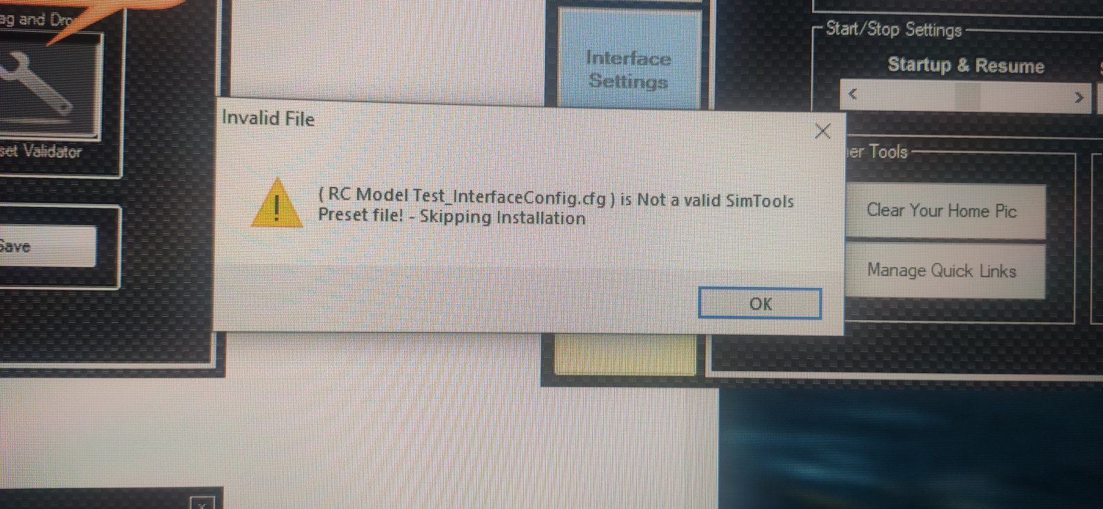

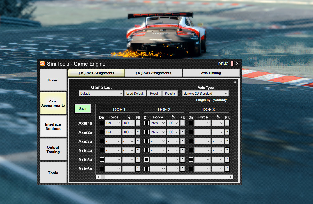

    Ok I have problem with configuration
    I download RC model files but can't install preset i have white config manually but noting happened can someone help me?

    My settings?

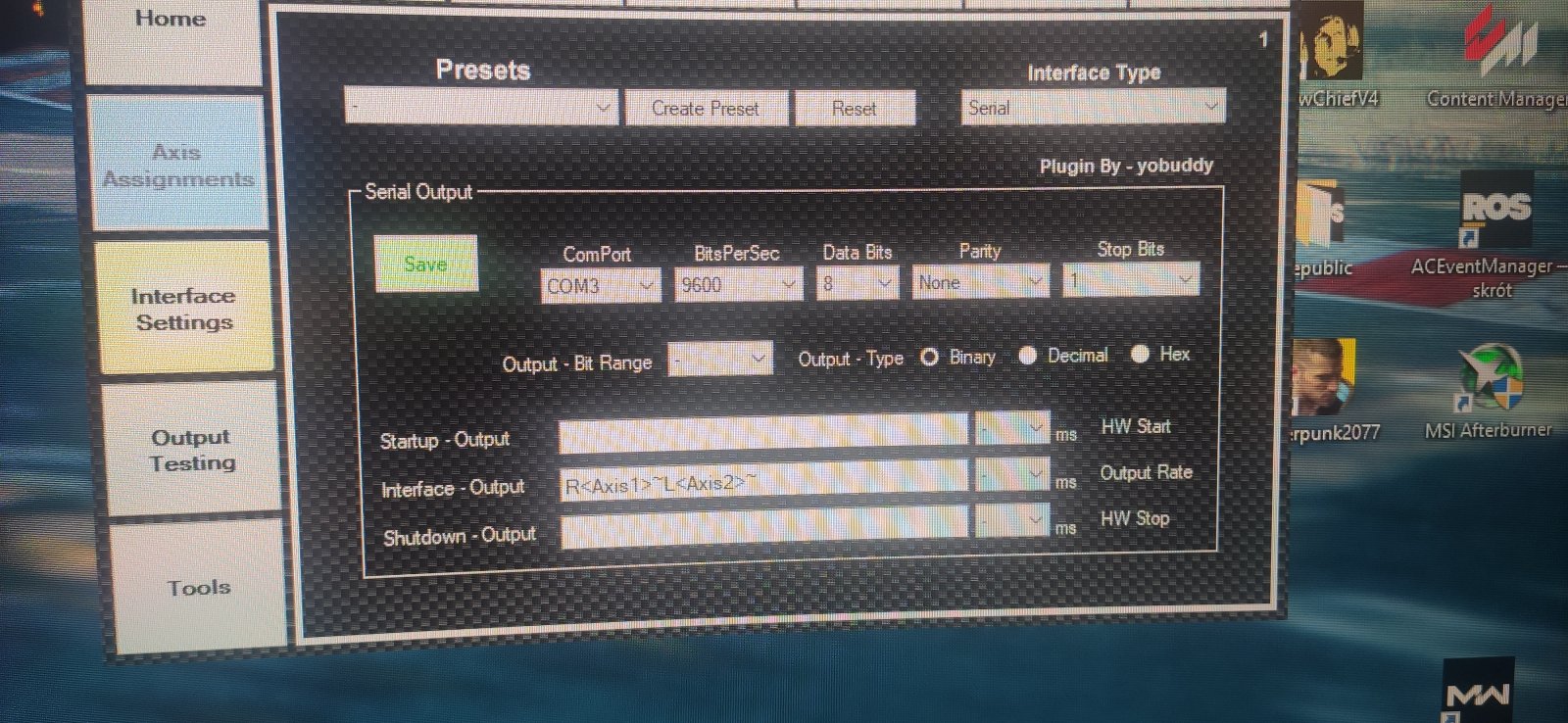

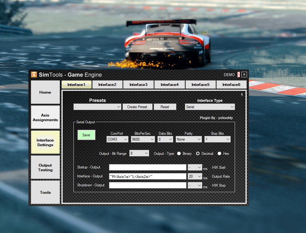

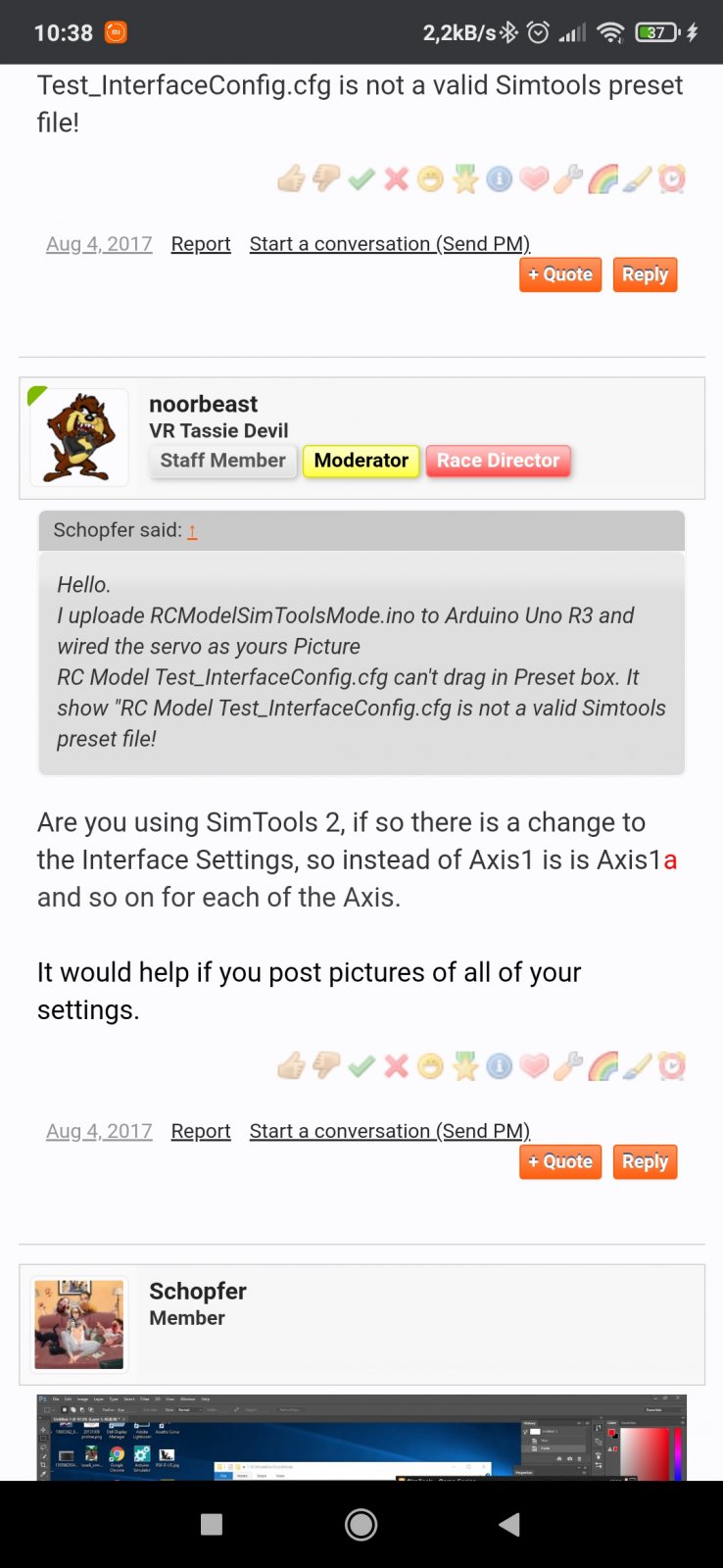

    This was my problem i have to add a letter for axis name

    Ok not much time but thing r getting better
    my config

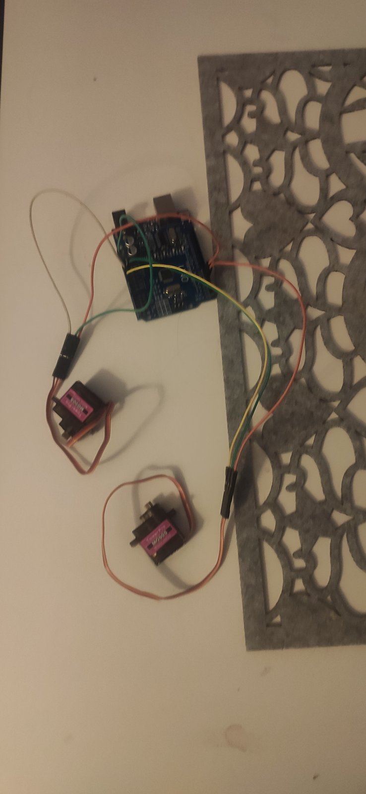

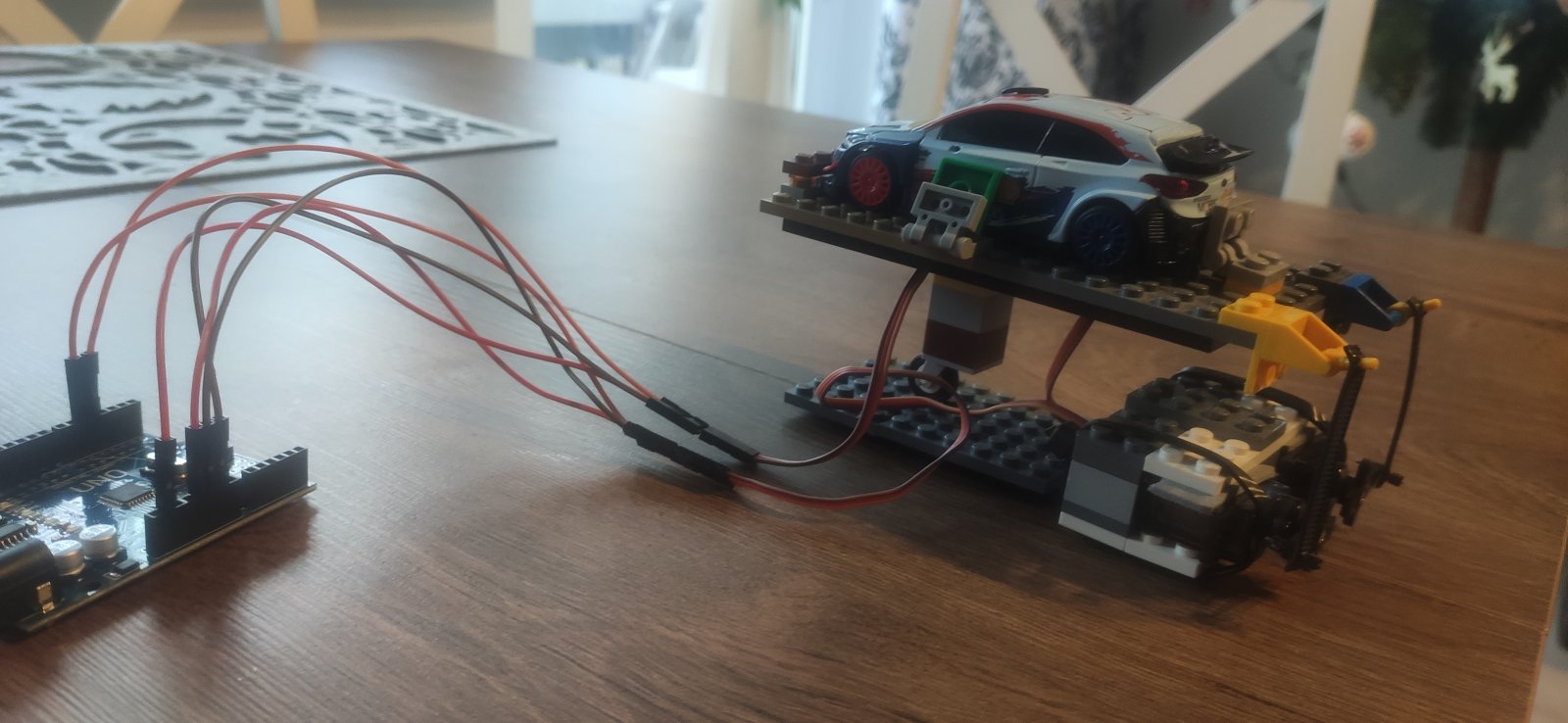

    ...and results everythings going now smooth . Next i try install game and try how this works

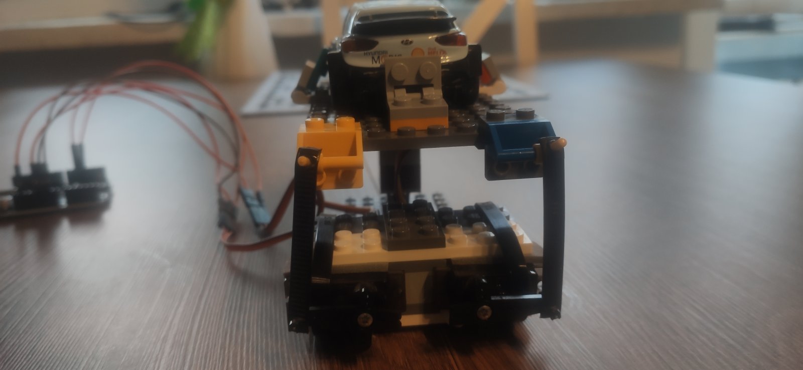

    My testing platform. Tomarrow I will rec some testing films. Important to start lfs without patching first because game must create some important files first

    My test

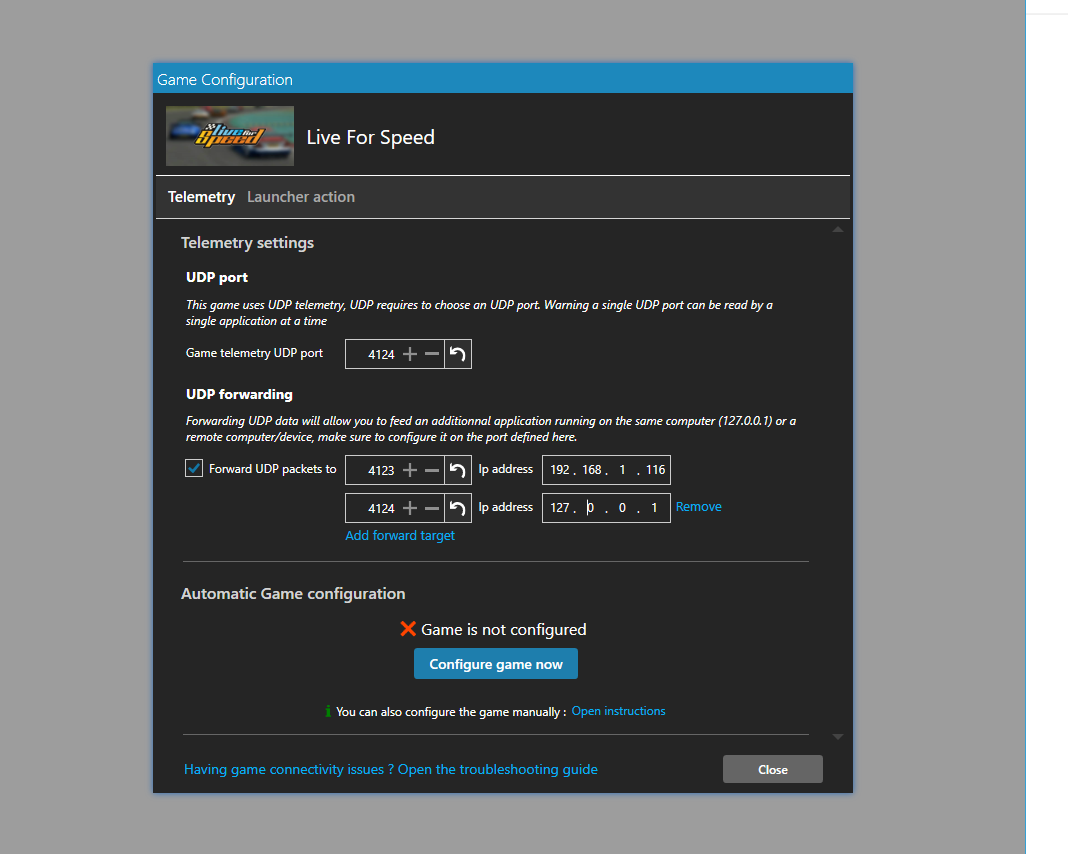

    Ok all works. Now I must find how put UDP really to simhub to my bassshaker and shakeit work parallel and then choose what to do next : platform or belt tensioner

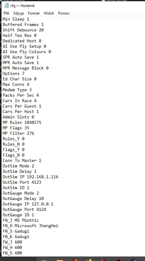

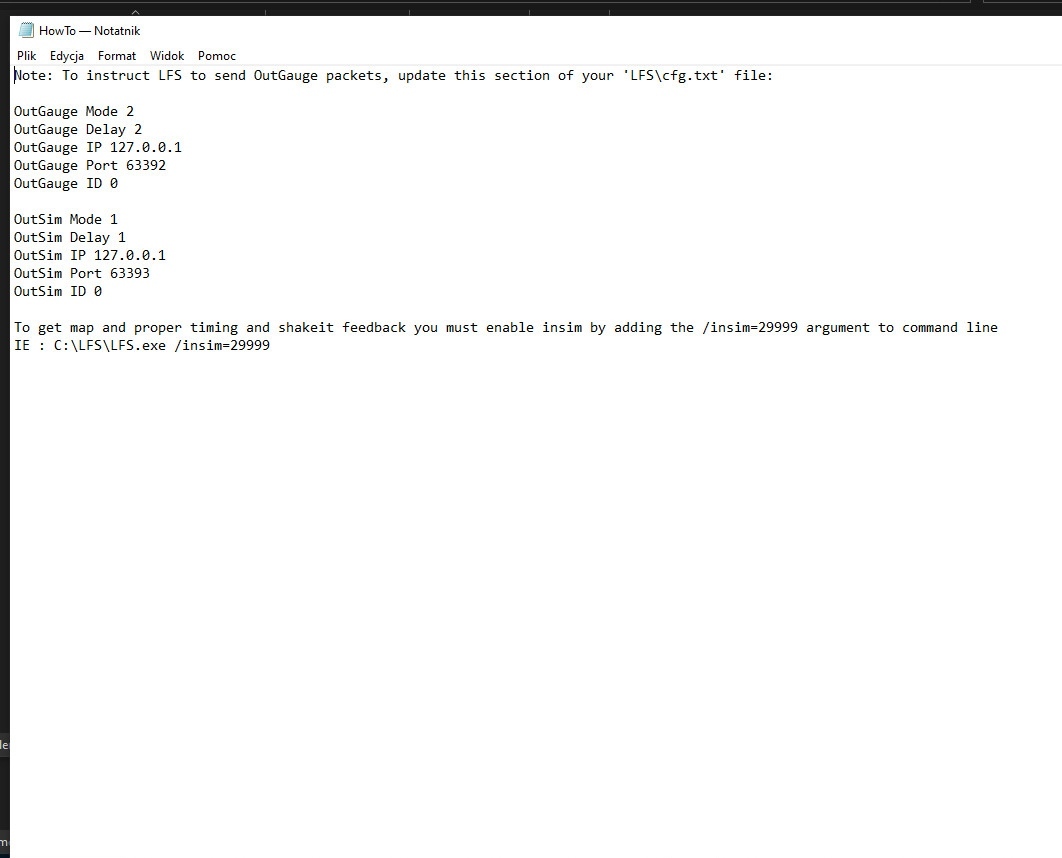

    Maybe someone can help me
    I gave shakeit and bassshaker in simhub and this doesn't work with lfs patched by simtools
    I have lfs config file and recommend settings by simhub

    Hi I don't understand it. Maybe the technikal language barier i have something like that and bassshaker and shakeit working on simtools port but sim tool doesn't work
    Any idea?
