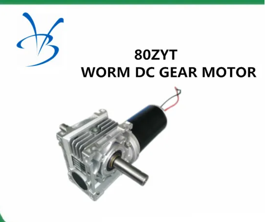

    They are 440Watt motors
    I was originally gonna go with mean well power supply's but they only output 350Watts
    What should I get?
    I will be using 4 motors would two bigger power supply's be better?
    Thanks for the help

    The motors are:
    24V dc
    440W
    25 amps
    There are lots of kinds of power supply's and im very confused so any kind of help would be greatly appreciated

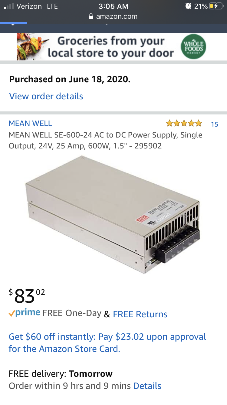

    C6ECAE12-C55C-4AA1-8627-D93FD2F4B2D1.png Just ordered 4 of these power supply’s. I think I should be able to daisy chain two of them then wire them to the saber tooth. Is this the right way to do it?

    Be careful when putting 2 power supplies in parallel as its not as easy as you might think ( daisy chaining as you put it.) There are many mixed views on the subject if you google it but from my understanding you will have to get both supplies outputting the same voltage within a few millivolts. Even if you manage to do this then there will be differences in the 2 power supplies. You may purchase 4 supplies from the same company with matching batch numbers but due to small variances in the components that the supplies are made of they really wont perform as 4 identical supplies. When paired one supply will always work harder than the other and the load wont be evenly shared.
    Also when using the sabertooth driver you will need to deal with the regenerative voltages that the driver produces when the motors brake or change direction. You could use some large resistors and leak it to ground but it will heat the resistors a lot so would need cooling. The best way and the way the manufacturer of the sabertooth suggests is to put a battery in parallel with the supply as an accumulator. This will deal with the voltage spikes and provide added power to your supply. A car battery would be a good start if you want real power as they provide lots of amps fast but to get 24v you will need to wire 2 in series then wire them in parallel with the supply. Now i understand that this may not be possible as for 4 motors you would need 4 power supplies and 8 car battery's and be dealing with massive amounts of available current which could be dangerous if you are not experienced in electrics.
    You may be able to use much smaller battery's like motorbike or alarm backup battery's which will work the same and be more compact but wont be able to supply as much current.
    You stated that your using a 32A sabertooth, 24v/25A motors and 600w power supplies which are all maximum figures that the parts can supply. A well balanced 2dof sim on a universal joint with good angles on the rods wouldn't need anywhere near that much power per motor but a 4dof that lifts all your weight on the motors surely will. The only real way to tell how much you will need is to test(r&d). Try to keep it as simple as you can to start with to get a working sim then increase the power if you need to but also keep in mind that the more current available she sharper the sim will react.

    Ok back to the sim. What hardware have you already got. You said you have 4 of the motors and that you have purchased 4 power supplies so based on that info and the design that you have in mind id have to say that the sabertooth 2x32 probably isnt the best driver for your design due to it being a duel motor driver. I would probably go for a cytron single motor driver so you can use a single 600w power supply per motor.
    Something like this or a more powerful version but remember your supplies will only deliver 25A max
    https://www.robotshop.com/uk/cytron-30a-5-30v-single-brushed-dc-motor-driver.html
    You could buy 4 of them for less than 2 sabertooths 2x32 and will deliver the same punch due to your supplies being 25A. It would eradicate the problem of trying to pair 2 supplies together for more power.

    I wasted a lot if time with server power supplies, they do not like fluctuations in power.
    I use 2x 12v batteries and a truck battery charger
    Works perfectly and does not shut down

    the batteries act like large capacitors and absorb the regenerative braking
    the only need a trickle charge whilst the sim is operating
