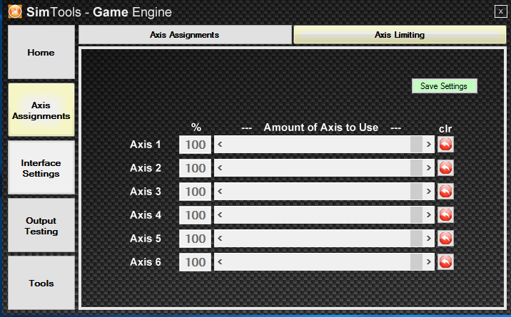

    Do you mean that nothing happens if you turn on the Output Testing in SimTools and move the sliders, but the motors do respond using the JRK config utility?
    If so then you have a configuration problem and need to post pictures of all your settings.

    So here are my pics

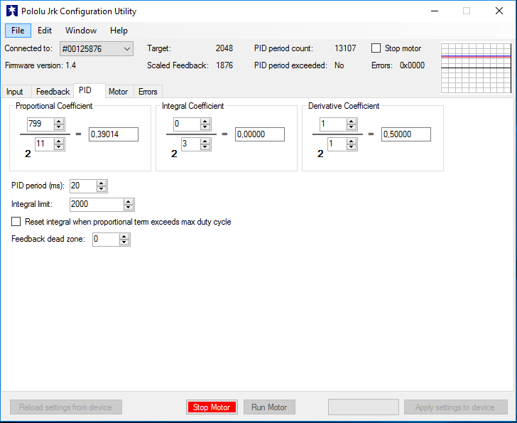

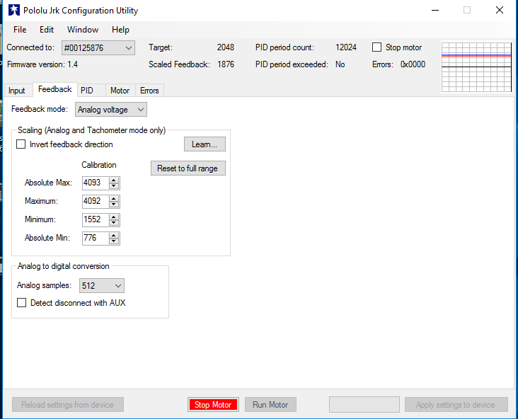

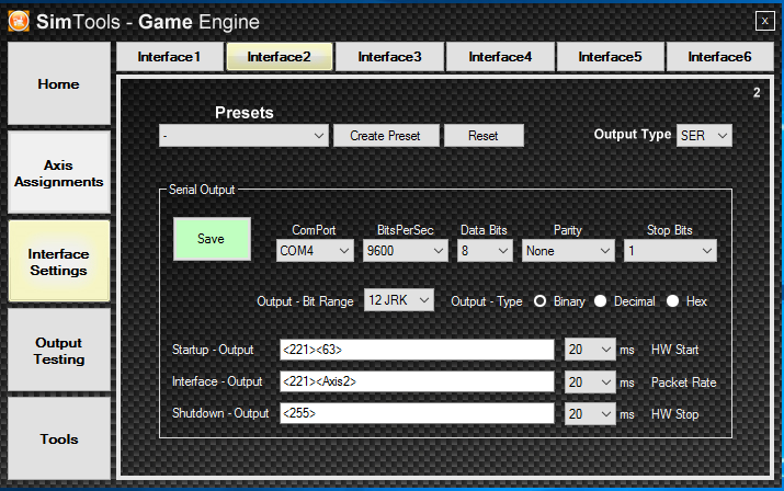

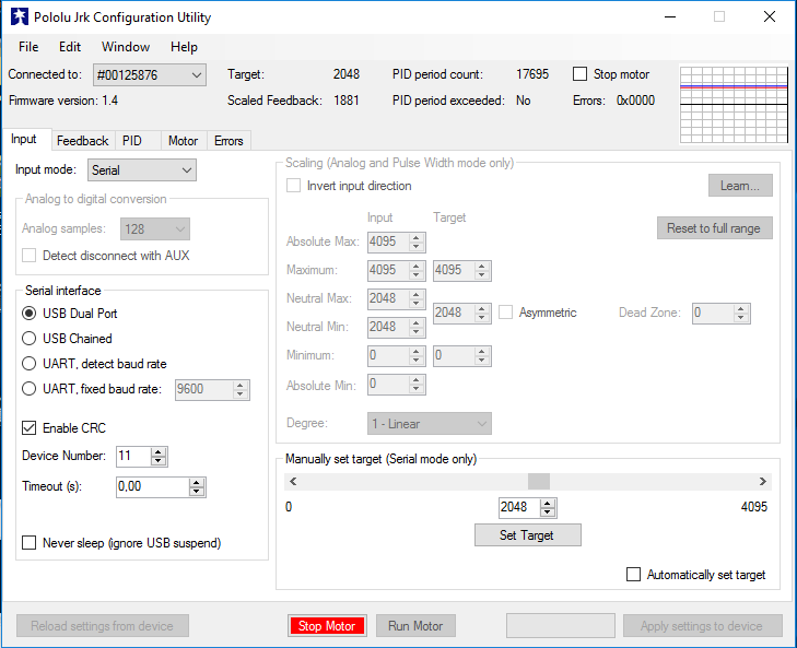

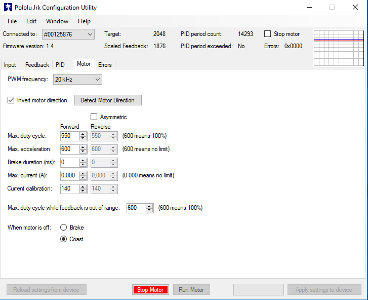

  5. Mo165
    Mo165 Member
    Sep 22, 2015
    48
    Austria
    103Coins
    2DOF, DC motor, JRK, Motion platform
    My Settings what could be wrong?

  7. Nick Moxley
    17,057Coins
    +2,507 / 30 / -2
    Have you confirmed your COM port #'s in the device manager ?
  8. Mo165
    Mo165 Member
    Sep 22, 2015
    48
    Austria
    103Coins
    I think i confirmed it, cause the pololu settings work
  9. Nick Moxley
    17,057Coins
    +2,507 / 30 / -2
    Simtools requires the proper ports to be selected manually, The utility does not.
  10. Mo165
    Mo165 Member
    Sep 22, 2015
    48
    Austria
    103Coins
    ok thanks i´ll take a look
  11. Mo165
    Mo165 Member
    Sep 22, 2015
    48
    Austria
    103Coins

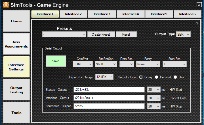

    I changeed the numbers to COM6 and COM4 but how can i confirm them or whats actually ment?
  12. mariano68
    mariano68 Active Member
    Nov 15, 2014
    574
    builder contractor
    Argentina
    3,341Coins
    +394 / 2 / -0
    2DOF, Arduino, 4DOF
    Go to control panel / Device Manager and check the com of your Arduino.

  15. Mo165
    Mo165 Member
    Sep 22, 2015
    48
    Austria
    103Coins
    I have Default Profile axis and even with them nothing work.

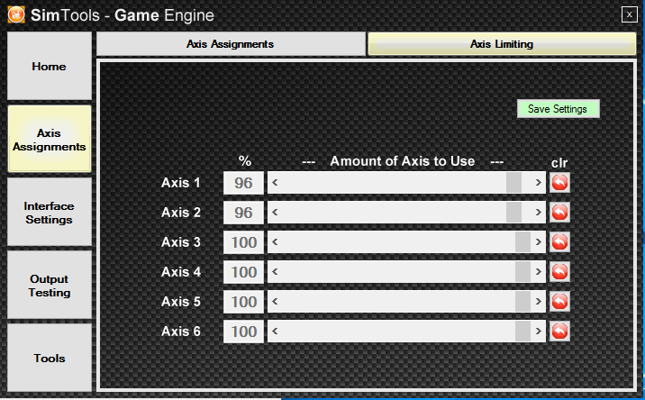

  16. noorbeast
    22,185
    154,750Coins
    +11,195 / 57 / -2
    Here are the basic JRK setup instructions by @eaorobbie: https://www.xsimulator.net/community/threads/playseat-to-2-dofseat.5401/page-2#post-56352
    On the Input tab of the JRK utility you need to uncheck Enable CRC, check Never sleep and apply those settings to device. Check Reset integral on the PID tab and apply. You can refine the settings further, particularly the PIDs: https://www.xsimulator.net/community/faq/practical-examples-video-tutorial-to-jrk-pid-tuning.225/
    You are allocating over 100% total to the Axis Assignments in SimTools, with way too much given for just 2 assignments: https://www.xsimulator.net/community/faq/axis-assignment-percentage-totals.120/
    It takes time but once you have SimTools talking to the JRKs and everything works as expected in Output Testing you then need toi develop a motion profile, here is how you go about it: https://www.xsimulator.net/community/faq/steps-to-create-a-motion-profile.228/

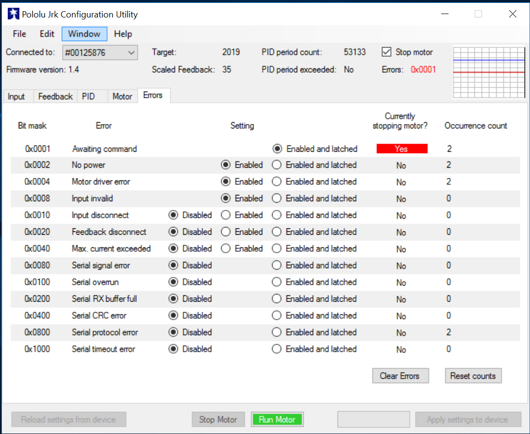

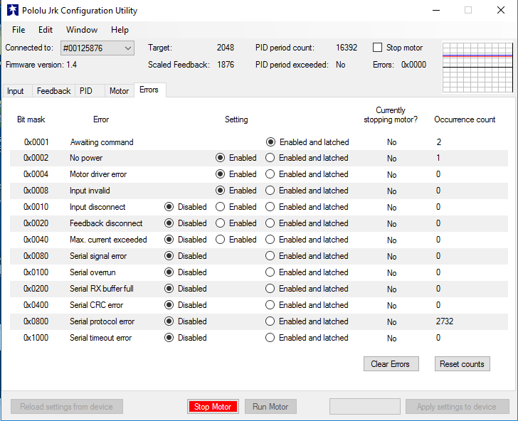

  20. Mo165
    Mo165 Member
    Sep 22, 2015
    48
    Austria
    103Coins
    The Motor stops and wants to start again but without pulling the rig up it doesn´t work anymore.
