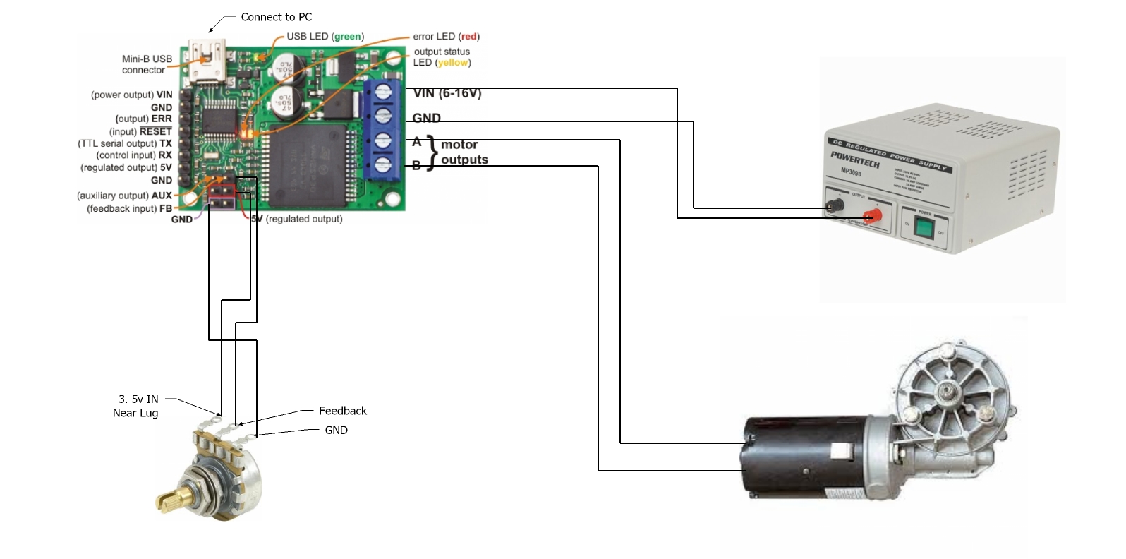

    Once all loaded open the device manager and take note which are the command ports for each jrk.
    Then we need to make sure everything is wired correctly.
    Be careful not to wire the power supply backwards please check before switching on.
    Pots will need to be connect in as per you already had them, to give feedback on the lever position.
    Plugin in our usb ports but do not turn on the power to the Jrks.

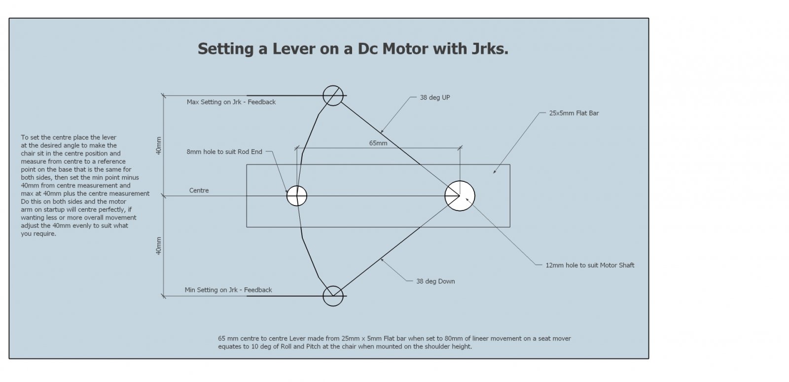

    Now we can set our max and min setting but actually moving the levers to their locations we wont them to be , I personally measure from a base to the centre of the connection for the connection rod, For example on my unit, when the lever is in its middle position and my sim is level, its 80mm from the base to the centre. Now I want 80mm of movement so that's 40mm up and 40mm down. Therefore when I set max I move the lever to 120mm from base and when I set min I move the lever to 40mm above the base. As per drawing below.
    Setting Min and Max
    1.Click Learn
    2.Follow the prompt and set the lever to its max position.
    3.Press Ok
    4.Follow the prompt and set the lever to its min position.
    5.Pres OK
    6.Note the values now have been set in the Calibration area.
    7.Apply settings to the device.

    Reading the Jrk documents most of this can be worked out easily, what I did in 2009 when I pioneered there use on sims back then no one thought the little buggers had enough grunt to run a sim or even if the software could talk to them.
    But do agree I need to do a tutorial on setting them up in Jrks software then using them in SimTools, just time.
    There might be a few more steps but as you will find, once set they just plug and play working correctly everytime.
