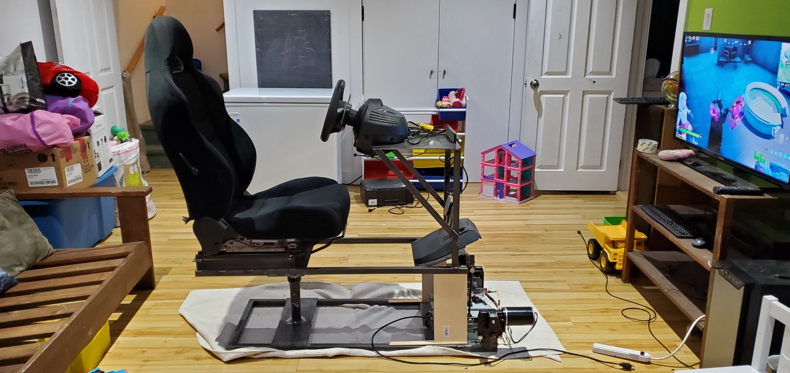

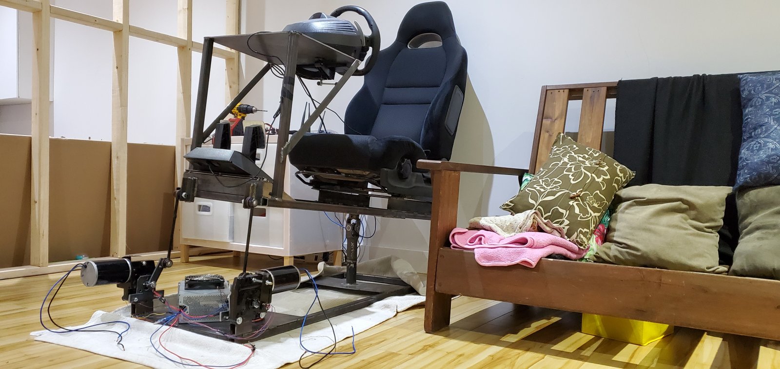

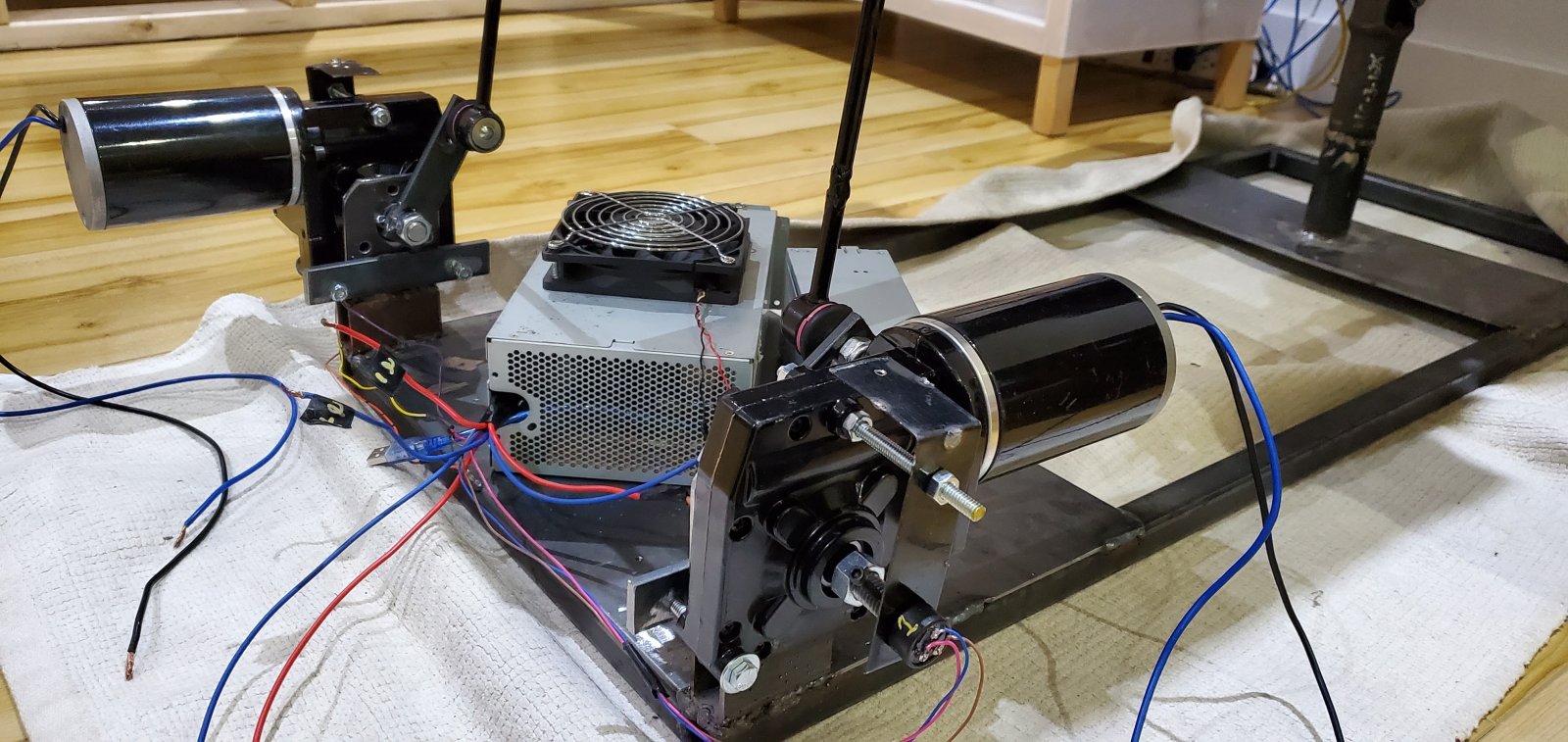

    Hi guys, heres my 2DOF rig that ive built slowy with the help of this forum.
    Its not finished yet, i am in the testing phase.
    Ive started with some wiper motors that blown shortly after my first tests, now ive got some 50:1 pgsaw motors.
    The rig is all steel (heavy) with a thrustmaster tx steering/pedals, an acura RSX seat, arduino and VNH5019 dual driver.
    I started knowing nothing about simulators, learn about everything on this forum and some google search.
    Looking foward to fix all my little issues shortly and start enjoying my rig.
    Thanks a lot!

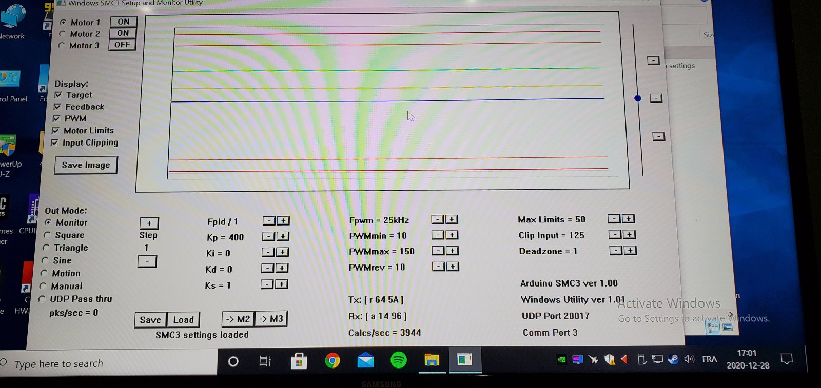

    Before testing with LFS grab a multi-meter and test each step of your hardware, as there is no point messing with SimTools until SMC3 works as expected.
    What is the weight of your rig when measured at the frame near the feet, where your motors are positioned?
    50:1s when brand new can be back driven, but it is pretty hard to do and I would normally expect them to be able to hold the mass of a rig when un-powered, particularly as a foot mount rig has plenty of inherent design leverage.
    Am I correct in assuming the rig holds position when both motors are un-powered, but will not do so with one powered on motor lifting the rig against the un-powered motor?

  5. Skuldi
    Skuldi Member Gold Contributor
    Aug 16, 2020
    53
    Germany NRW
    265Coins
    +37 / 0 / -0
    You can only move one motor at time in smc but both should have power. You can try to raise powermin to give the inactive motor more power to hold the position.
  6. drzmat
    drzmat Member
    Apr 30, 2020
    57
    184Coins
    +10 / 0 / -0
    Heres my current settings :
  7. drzmat
    drzmat Member
    Apr 30, 2020
    57
    184Coins
    +10 / 0 / -0
    I have raised the PWmin to 50 and now it can hold the rig weight in smcutils.
    With me climbing into the seat, sometime a lever goes down right away if i am not careful, is there any downside to raise the pwmin a bit again?
    I have about 21 lbs weight at the levers when i am not sitting in the rig.
  8. drzmat
    drzmat Member
    Apr 30, 2020
    57
    184Coins
    +10 / 0 / -0
    PWmin at 80 works great holding me and the rig in lfs, a little noisy but it works!
    I had some fun until my pc crashed and rebooted, then my levers went down.
    I think my biggest issue is weight at the motor levers, i went to heavy with this rig..... :(

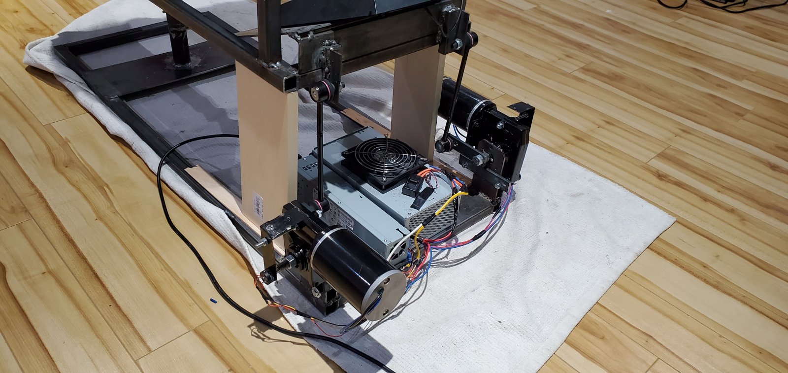

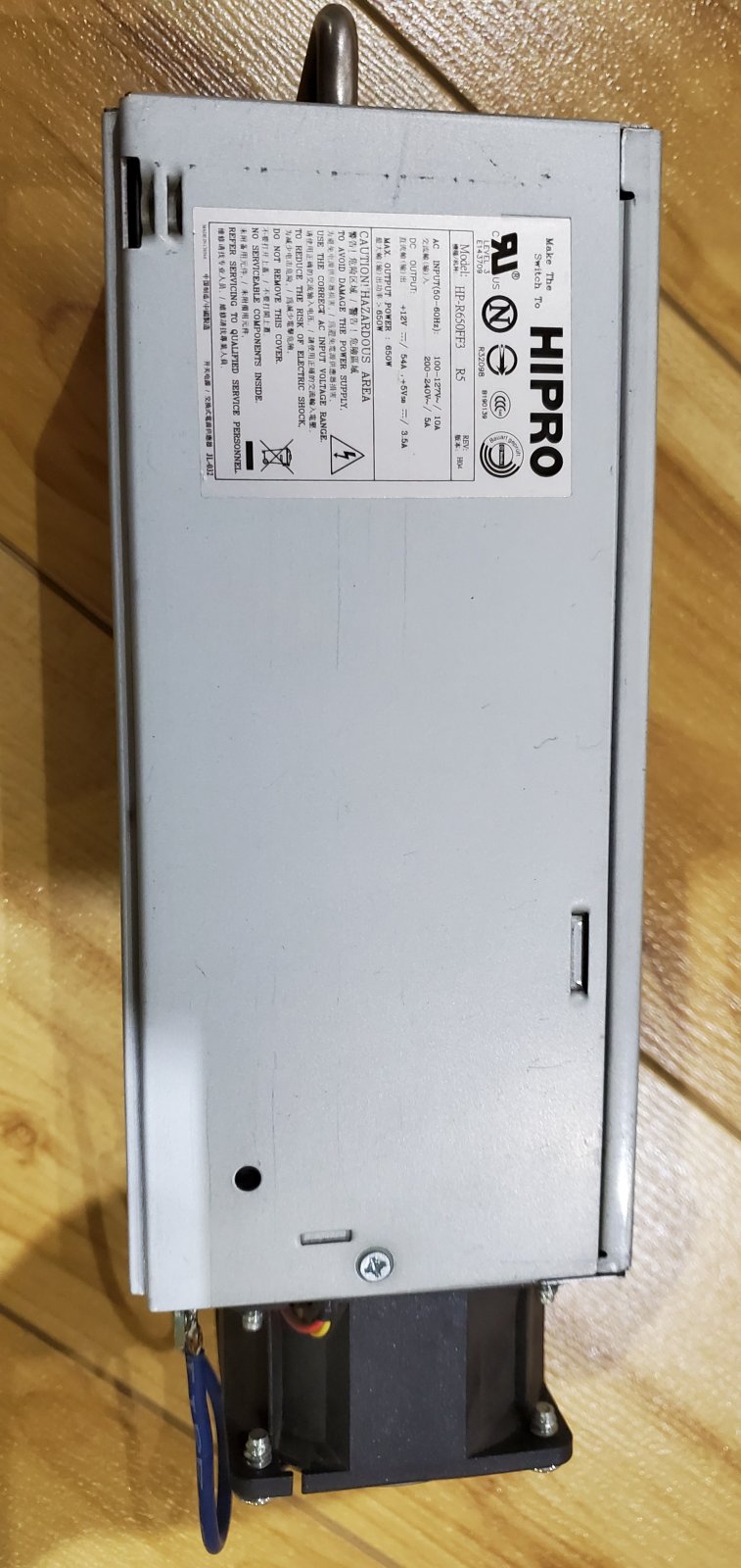

    I wanted to report a problem i had with a Hipro power supply, it was shutting power down after a couple of seconds of driving in LFS.
    I replaced it with a HP server power supply that a lot of people seems to be using and its perfect now.

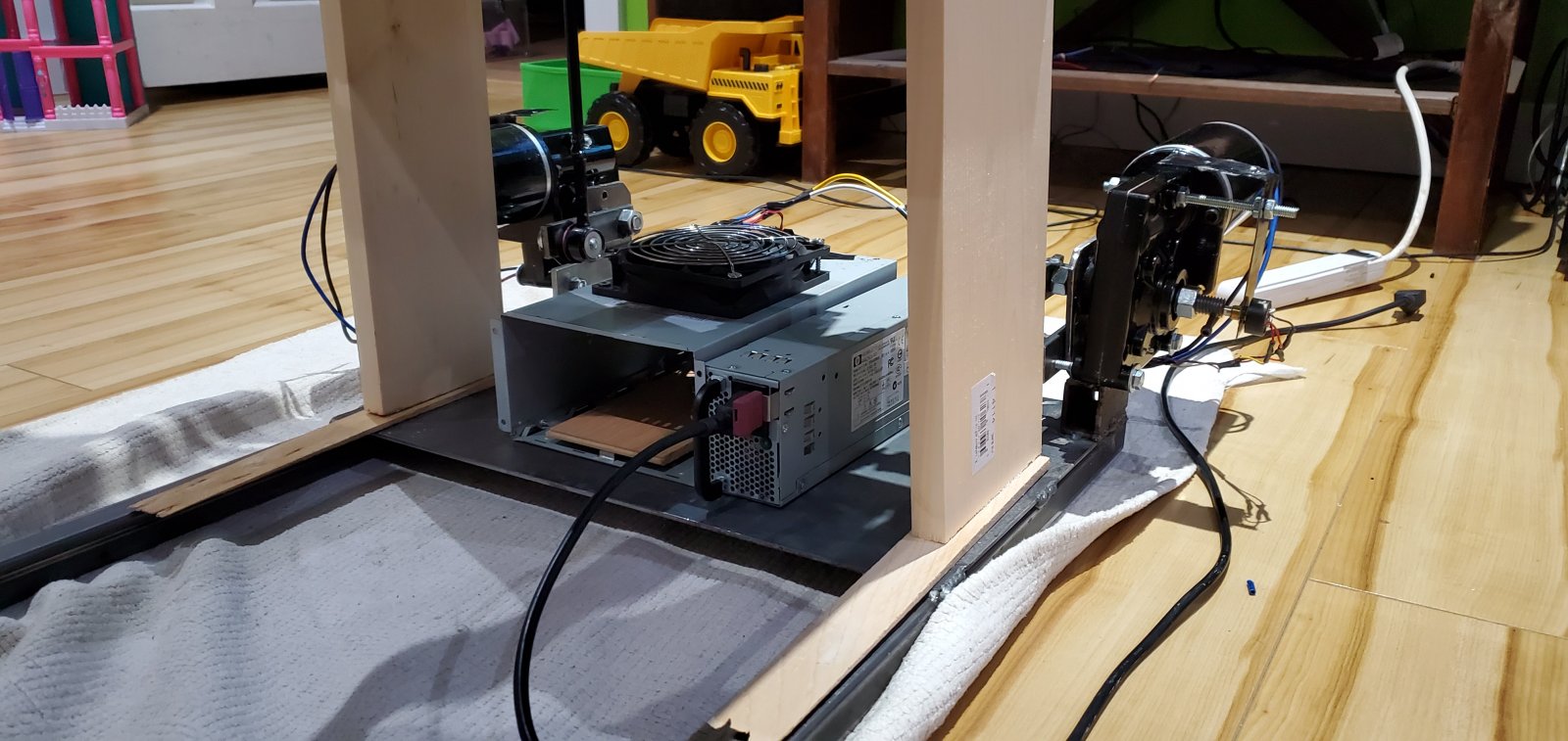

    So my rig is up and running!
    I did a bit of wiring cleanup and put some wood pieces under it when unpowered so the levers dont move.
    Did some fine tuning in simtools as well since i was almost thrown out of my seat the first time i tried it in LFS :)
    Sorry for my kids mess in the basement!

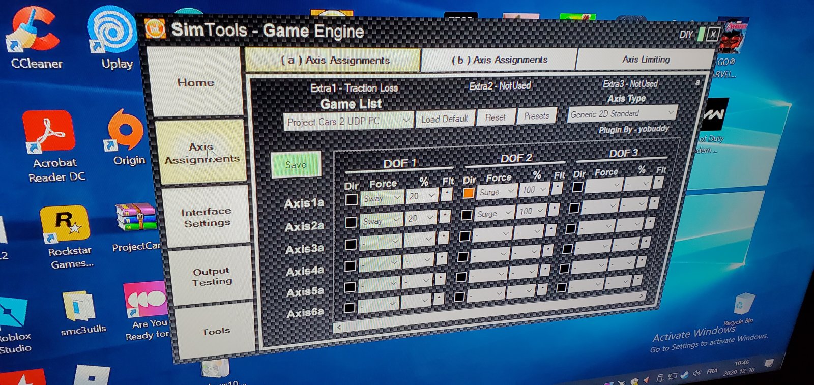

  15. drzmat
    drzmat Member
    Apr 30, 2020
    57
    184Coins
    +10 / 0 / -0

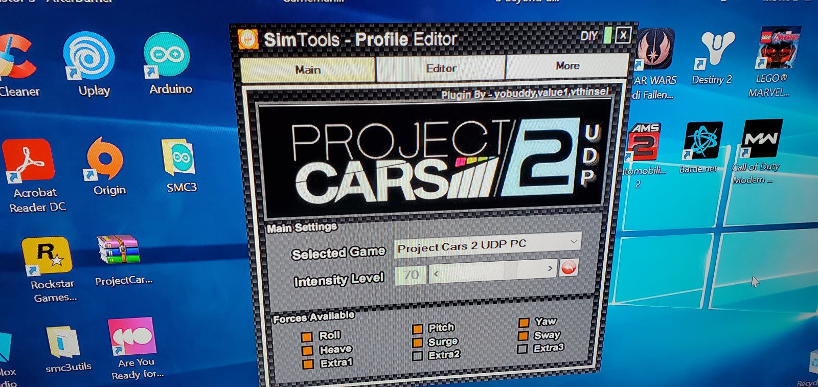

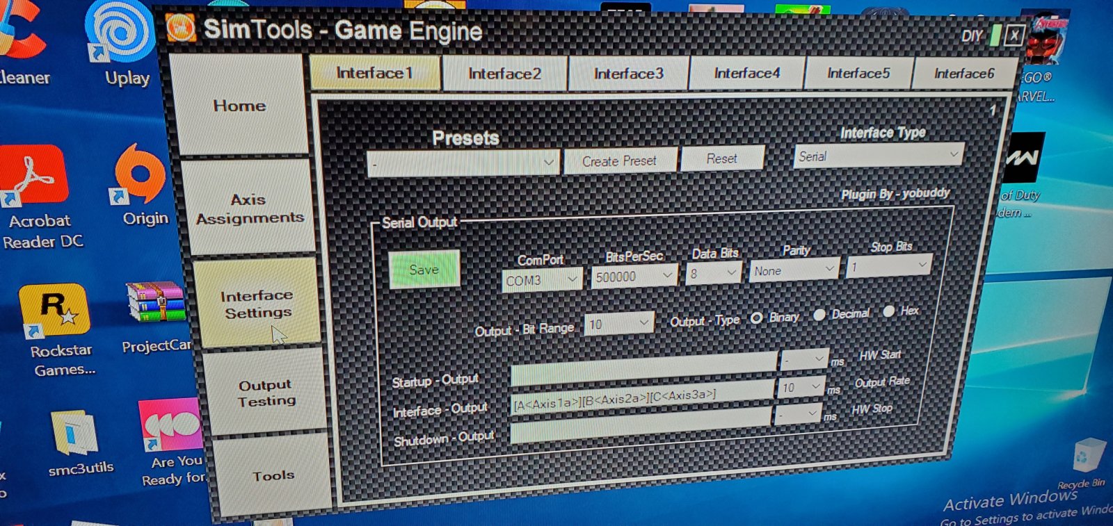

    Here you go, ive played with the axis assigments % and intensity level a bit today but thats my settings from this morning.
    Talking of intensity level, i was wondering what most users run? At 100 my rig is very rough.
    I could put it at 100 probably but i would have to lower the axis assigment % a lot...
  16. noorbeast
    21,717
    152,009Coins
    +11,061 / 56 / -2
    Sway will normally have one DIR box checked and the other not, and it should lean away from a corner, Roll will be set the opposite of sway.
    Surge will have no DIR box or both checked, depending on which way it needs to go, on a 2DOF surge will pitch up for acceleration and down for braking.
    Axis allocation for sway is not enough, experiment between 30-40, and way too much for surge, try around 15-20%.
    For a 2DOF this is all that is needed for the Interface Settings: [A<Axis1a>][B<Axis2a>]
    Leave the intensity at 100% for initial tuning, using a mid range car and decent track, I use Monza in Assetto Corsa, it looks flat but actually has some significant bumpy sections. Follow the tips here, including capturing then tweaking the Tuning Center values: https://www.xsimulator.net/community/faq/steps-to-create-a-motion-profile.228/
    Once you have a decent base motion profile for a mid range car and decent track then you can make variations of it in the Game Manager Profile Editor for specific cars and tracks, so you may lower the Intensity for say a F1 car on a bumpy track like Nords, I use about 92% for that, any more and it will rattle your teeth.

  18. drzmat
    drzmat Member
    Apr 30, 2020
    57
    184Coins
    +10 / 0 / -0
    Ive play with your settings noorbeast :), all in project cars 2 btw, watkins glen track.
    First, i just cant play at 100% intensity, its way too harsh on both the material and myself and its just unrealistic, ive put it at 90% and its way better.
    Second, your settings for surge are ok but no way i can put between 30-40 for sway, its way too much and unrealistic again, same thing for roll. I am at 10 sway and 7 roll for now and and may be able to give some more tomorow but not much.
    I just added the pitch and roll forces tonight and wow, that is great!
    I added heave force also and i dont have a clue of what its doing.
    So, mu current settings are :
    Sway : 10
    Roll : 7
    Surge: 15
    Pitch : 25
    Heave : 10
