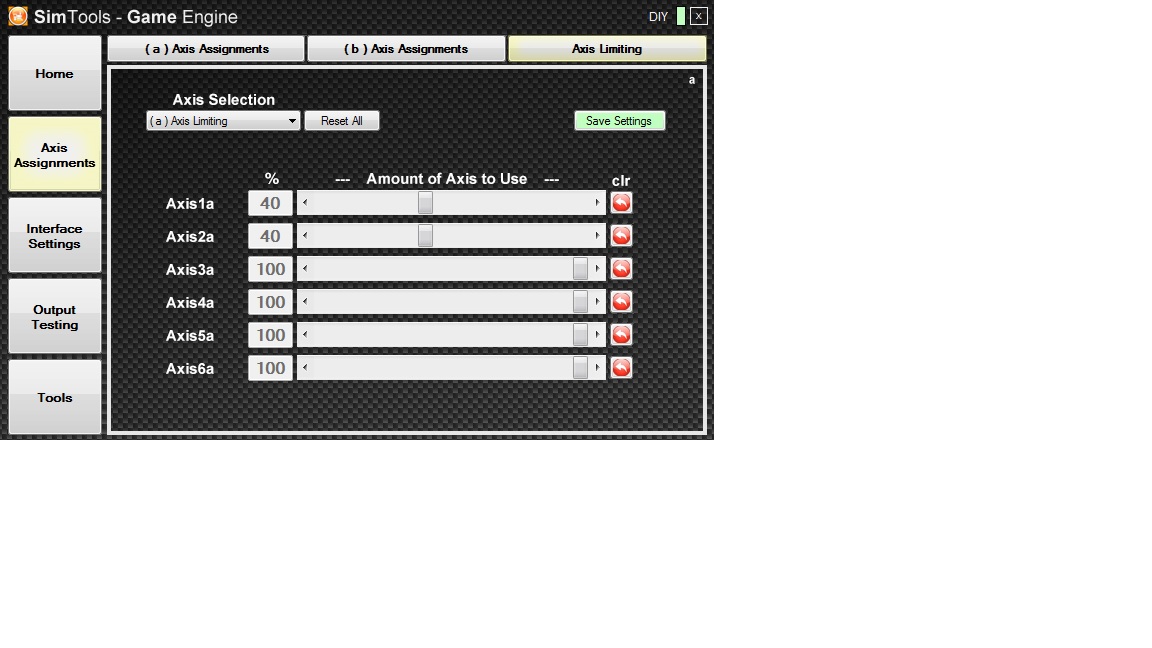

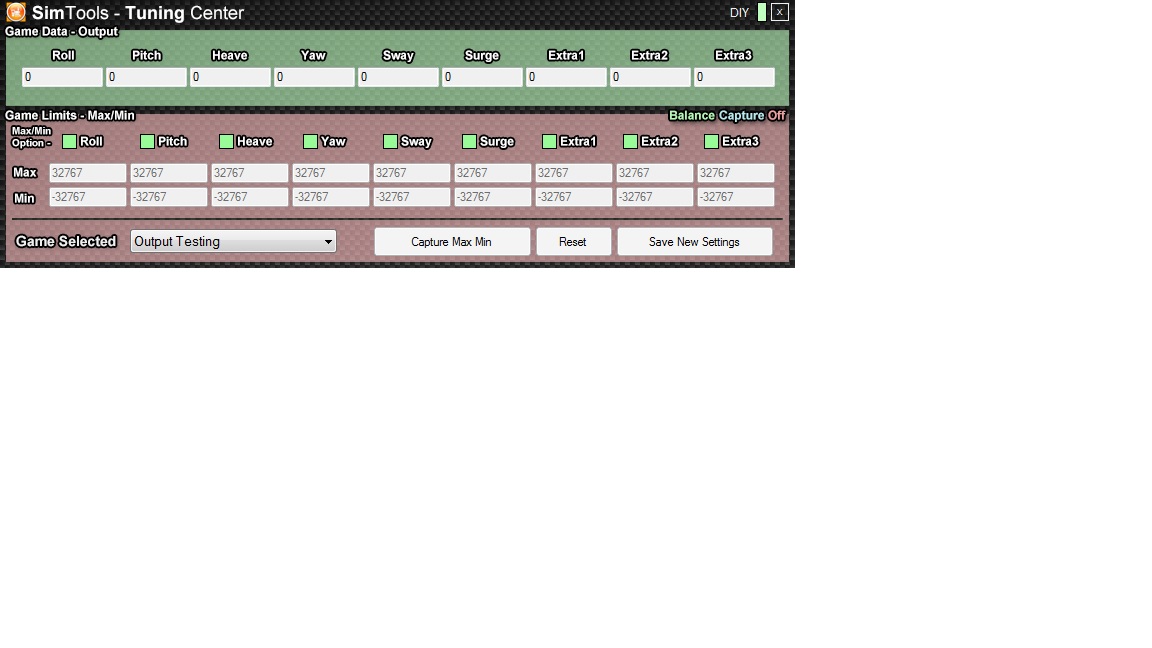

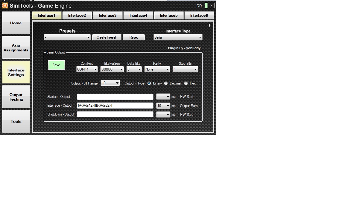

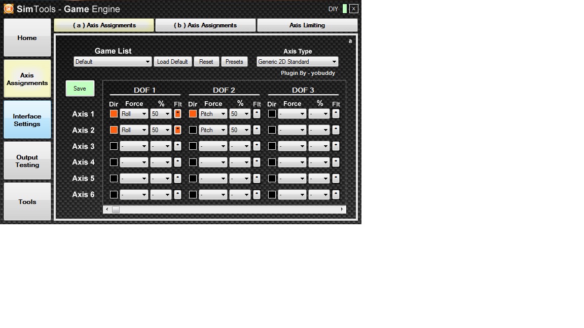

    OK, here are the pics of my setup. It is exactly the same as in ver.2.0.
    It was strange, but after I have installed 2.1 (to other directory than 2.0) all of my 2.0
    setup transferred to 2.1 as well, so I didn't need to copy the values.
    With 2.0 it is still working as well.
    My platform is a custom made, I'm using SMC3 Arduino 3DOF Motor Driver.
    Thank You

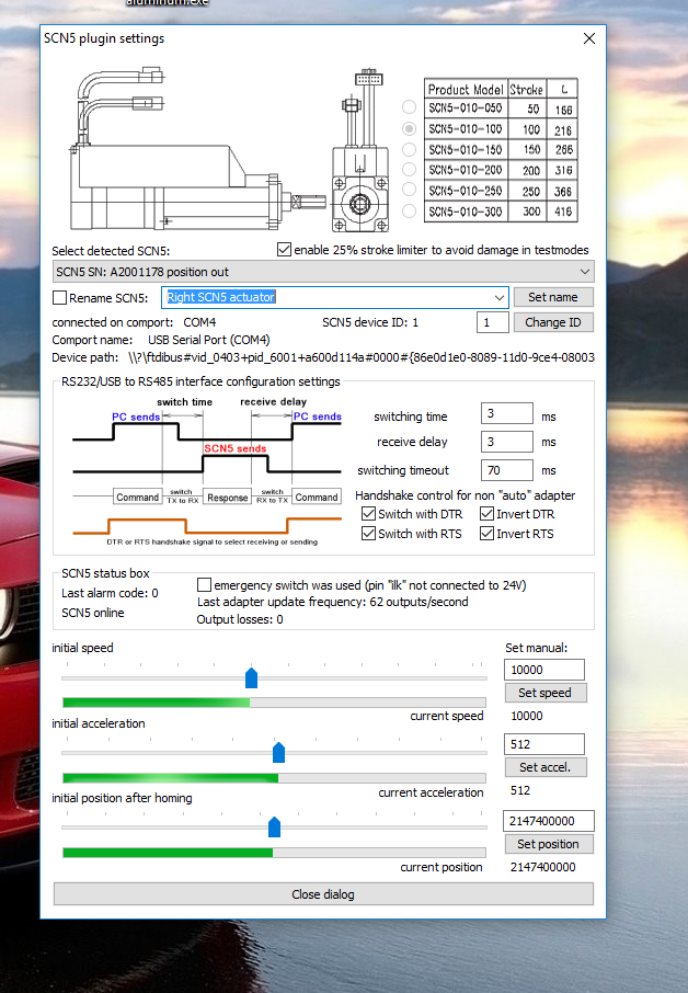

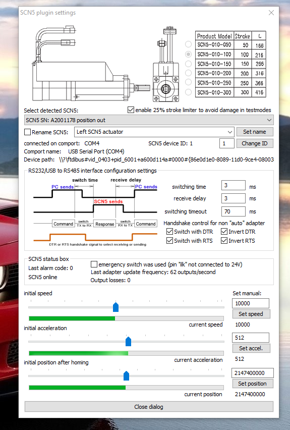

    Hallo again
    I am having problems with my right SCN5 actuator back again - it seems the ST 2.1 lost the ID, and only right moves. AS I remember I need to change the ID in x-sim converter to make it work?
    In ST 2.1 I have COM 3 and COM4 to choose from. In x-sim converter both SCN5s seem to be connected to COM4
    Any help will be appreciated
    Here I present x-sim converter
    PS - I switched the USBs and in x-sim converter all seemed to get back. I had two SCNs working. I started ST 2.1 and iR and nothing happened. I just felt a tiny movement at the end of session of iR.
    I restarted the computer and all is back to what it used to be which is wrong . x-sim conv finds only one scns. Both IDs are set to ZERO.
    What is funny - when I start x-sim conv only right SCN works. With ST 2.1 the other one starts.
    Any ideas what went wrong?
    PS 1 to make it works I have to replug USBs - then both ST 2.1 and x-sim conv see SCNs
    PS 2 ST does not work with iR. GM GE are connected and patched - a small movement sort of vibe is felt
    PS3 During the session with iR info popped up - that ST stopped working
    PS3 I replugged the USBs and x-sim conv saw both SCNs - the moment I started ST 2.1 it went down to one left. After that when I run x-sim converter only one SCN is visible.

    @TPS
    Are both your SCN actuators connected to the same serial adapter?
    Or do you have each SCN connected to its own adapter?
  19. TPS
    TPS Member
    Mar 9, 2013
    72
    Business coach
    Lodz/Poland
    439Coins
    2DOF, SCN5
    Every actuator has its own connector. It used to be good before, as I switched from Lince to ST2.0/2.1. After a long period of time I started ST and it moved only one scn. After I replug usbs it is found by x-sim converter, (see attached files above). but it changes nothing as I start ST 2.1 and only one scn moves
  20. yobuddy
    51,741Coins
    +5,205 / 19 / -0
    I can't speak for xsim stuff.
    But if it used to work, and now it does not, I would look for hardware problems.
    Loose wires or a faulty USB cable maybe?
    Maybe look at your interfaces settings and make sure both SCN actuators are listed in Game Engine?
    If one looks wrong, remove it. then restart SimTools and re-set it up.
    But it sounds like it could be hardware to me.
