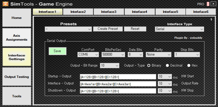

    Hi, I'm working with DOF Reality's H3, and I'm leaving a question because there's a problem.
    I download the files (interface settings) of the links you provided in the first post and add them to the program, and my simulator's movement is strange.
    This phenomenon occurs even though the setting value has not been changed much.
    1 . When I run a test or turn on a linked game, the simulator is already in the middle, but it's moving to one side.
    2. When a test or game is terminated, it is a phenomenon in which it slowly returns to the center after moving all the way to the maximum on the left.
    3 . In addition, the simulator moves as if it were snapped, even if the value being sent (in a test or game) went up very slowly.
    ( This is a statement about the results of the previous comparison using SRS.
    + If there is a problem with mentioning another program, I will correct it right away. )

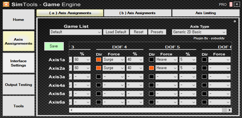

    ▲ I add my settings status.
    + If I want to use the Yaw value from the interface you provided, how should I add it?

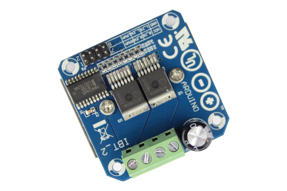

    sounds like a one of your motor driver is broken
    you might need this BTS7960B
    try testing each axis using that smc utility

    My PC still has SRS (Sim Racing Studio) installed, so I tested it with it and it works fine.
    (+ Smooth movement)
    So I think there is a problem with the interface or setting.
    Do you have any more predictions about the cause of other problems, not motor drivers?
    + I'm not only using the simulator, but also DOF reality's Motion box, is it possible that it's not compatible with the sim tools method?

    If you're running SimTools 2.5 try 2.4. I had the same problem you're describing when I updated to 2.5.
    Tried installing over 2.4; clean install; wiping out the APPDATA folder, clean install and reinstalling the plugin...nothing worked for me with 2.5.
  13. LemonIcetea
    LemonIcetea New Member
    Jul 23, 2021
    17
    123Coins
    3DOF, 6DOF
    Thank you so much for your help!!
    For now, I only did the Output Test, but when I used 2.4 Version as you said, I couldn't see the phenomenon I was talking about.
    I'll have to further confirm that the movement is still unnatural, but I'm so happy.
    Once again, thank you for your help.

    It looks like your assignments are misconfigured, for example Roll and Sway should be set the opposite of each other, with Sway leaning away from a corner. It is hard to say if other axis are messed up, but this is what SimTools expects: https://www.xsimulator.net/community/faq/which-way-to-set-simtool-axis-movements.230/

  16. noorbeast
    21,889
    152,965Coins
    +11,115 / 56 / -2
    To properly configure a motion profile for best results first download the SimTools manual and keep it handy for reference: https://www.xsimulator.net/community/faq/rtfm-start-with-the-official-simtools-documentation.117/
    Next ensure the control hardware side is configured and working as expected, and axis assignments are configured as Simtools expects, with everything working as expected in Output Testing.
    Then see the tips here for refining a motion profile, initially doing one axis at a time, then turning them all on and tweaking from there: https://www.xsimulator.net/community/faq/steps-to-create-a-motion-profile.228/

    Looking at the video there seems to be considerable lag in the response of the rig, is that what you mean by "there is a problem of alternating movements like stairs. In addition, there is a problem of sudden movement when the slider is controlled to a near maximum (90%?) level."
    Just to rule out a known bug can you please make sure your computer is set to use English Local: https://www.xsimulator.net/community/faq/simtools-language-setting-bug-change-to-english-local.233/
    Your Axis Assignment allocation totals are very high: https://www.xsimulator.net/community/faq/axis-assignment-percentage-totals.120/
    And the Axis Allocation for sway and roll need to be correct, sway leans away from a corner and roll DIR check boxes are set opposite of sway, this is what SimTools expects: https://www.xsimulator.net/community/faq/which-way-to-set-simtool-axis-movements.230/

    When dealing with Pitch, there seems to be a problem that both sides do not rise at the same time, with the left axis rising by a certain amount, and the right axis rising after all the right axis rises. (in addition to the previous story of moving like a stairwell)
    Secondly, I modified it by applying the existing preset. (Except Extra1, every Axis Assignment allocation were divided in half)
    Third, I'm not good at English, so I'm asking you, is it right that you have to move in different directions when you move the sliders of Roll and Sway during the OutPut Test?
