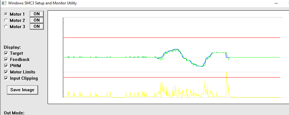

    Hi guys,
    A couple of weeks ago I bought new, stronger, motors for my 2DOF motion simulator (type of motor: 90ZYT-155-12 25:00). I bought them here:https://www.motioncontrolproducts.co.uk/sections/8/dc-brushed-motors/
    Because they are much stronger, then the ones I had before, I changed my two single channel motomonsters to two double channel motomonsters. I did this to prevent them from breaking down.
    So what I wanted to ask is if need to change my settings in SMC3, because I use 2 doucle channel motomonster. If yes, what do I need to change?
    21,555
    150,950Coins
    +11,025 / 56 / -2

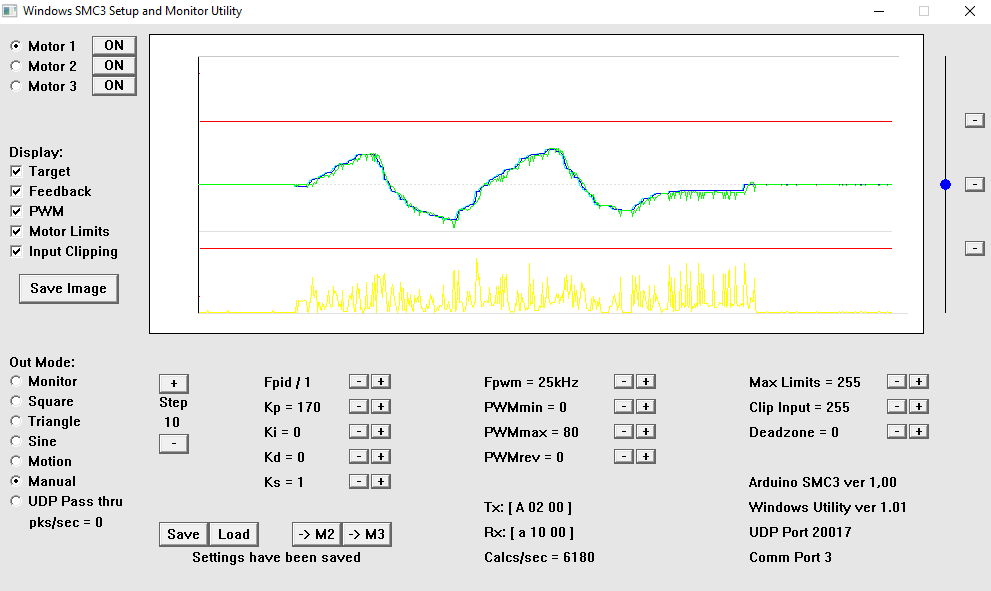

    In the SMC3 graph you can check how well your rig responds to control inputs, if you get under or over shoots then you need to refine your settings.

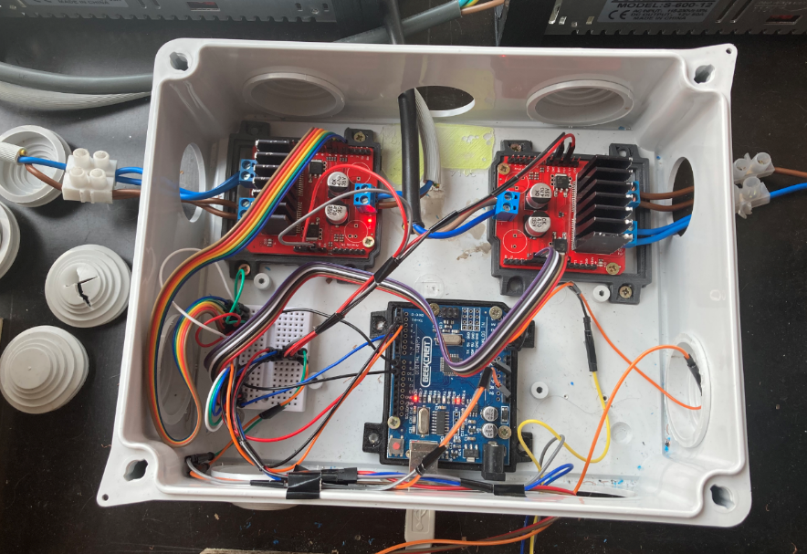

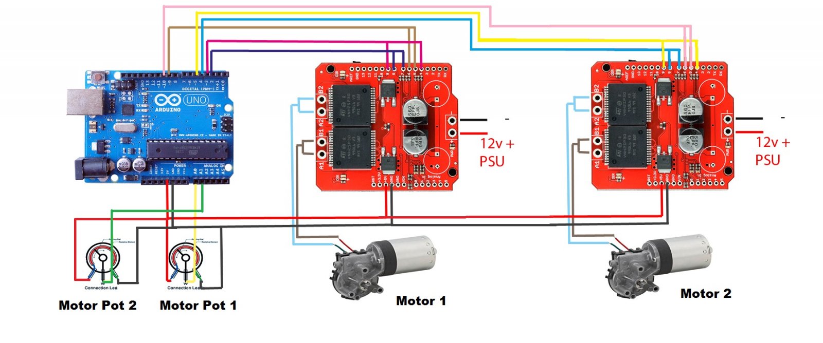

    Hi guys,
    So yesterday I tested both of my motomonster and they were functioning as normal. I tested all drivers seperately. (motor per A/B out). Today I made this (check picture down below) setup and the motomonster have no output. What could be the problem? Because I have nog clue why I'm not getting any output[​IMG]
  8. Witvrt
    Witvrt Member
    Nov 29, 2020
    49
    127Coins
    +13 / 0 / -0
    Hi guys,
    I tested both motomonster seperatly and rewired them. After I did this they both worked, so if anyone encounterd this before. Just try this and it could possibly solve your problem.

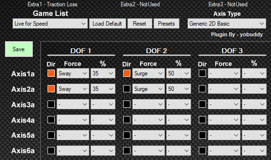

    Hi guys,
    I was doing some tests with Live for speed and my sim was only leaning forwards and backwards, although I've surge in my settings to. What could possibly the problem? upload_2021-5-19_20-43-32.png
    (my settings)
  12. noorbeast
    21,555
    150,950Coins
    +11,025 / 56 / -2
  13. Witvrt
    Witvrt Member
    Nov 29, 2020
    49
    127Coins
    +13 / 0 / -0
    Everything moves like I expect it to move. The only thing that is a little strange is that when I move surge, to the left side, the motors only respond when surge is on -100. Or sometimes there is a delay before the move to the requested position.

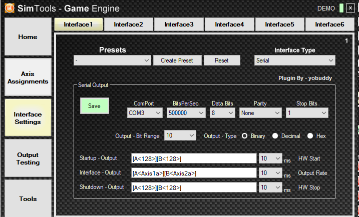

    Almost getting there, I hope !
    After having problems with my wipermotors not being strong enough and replacing them with stronger motors, I as well replaced the single motomonsters by dual to avoid them to be burned by too much current.
    Now, it seems that smc3 is reacting fine (see screenshot and video)
    both motors are for testing running with the same config and are reacting fine.

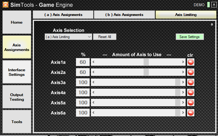

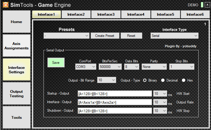

    With Simtools however, the motors do not move below the starting (middle potentiometer) position.
    Axis limiting is set to 65%. With the previous (weak) wipermotors and single motomonsters, I didn't have this issue.
    Below my simtools settings
    simtools manual testing :
    motors during manual testing with simtools ( as you can see, the motors do not move below the starting position :( ..... HEEEEELP)
  16. noorbeast
    21,555
    150,950Coins
    +11,025 / 56 / -2
    You can't run SMC3 and SimTools at the same time, it will cause a port conflict.

    now, I have movement below the starting position but only when moving surge or sway to -100% like there is nothing in between. aaaaarrrrggg, so frustrating. Above starting position, there is nice lineair movement, for both motors)
  19. noorbeast
    21,555
    150,950Coins
    +11,025 / 56 / -2
    Can you please explain what changes you made that resulted in the movement in your latest video, and post pictures of your settings that go with that latest video.

    Hi Noorbeast,
    thanks for your involvement. Really appreciated as I do not know anymore what to do and I need to have my project finished in 3 weeks. :confused:
    As said, testing with smc3 runs fine for both directions of both motors. You see the pot value nice in sync with the engine.
    As for testing with simtools, 1 direction (above starting position) is working ok, (nice lineair movement) the other direction (below starting position) moves only at 100% axis testing and at full range. (see video). This behavior is the same for both motors.
    I notice when changing the polarity of the motors this behavior (of deflecting only at 100%) is the same but for the opposite direction of movement. How can this happen and why does it all look fine in smc3 ? Could this be related to a wiring problem of the MM ? Is it correct to wire A1+B1 to 1 lead and A2+B2 to the other side of the motor or am I missing something in here ? (see picture in previous post)
    below the requested simtools settings. Axis limiting was increased from 50 to 65% since the video you were refering to.
    upload_2021-5-24_10-33-27.png upload_2021-5-24_10-33-57.png upload_2021-5-24_10-34-27.png
