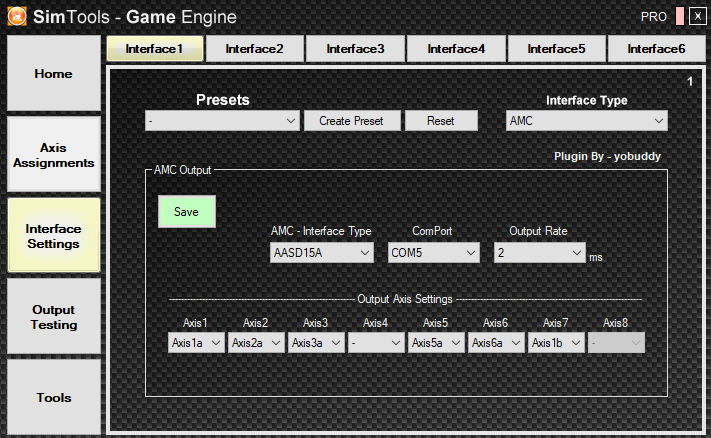

    I have my 3 actuators connected as follows:
    Servo 1 Connector - Front center (only one actuator on the front) - actuator says 'Axis A'
    Servo 2 Connector - Back Left - actuator says 'Axis B'
    Servo 3 Connector - Back Right - actuator says 'Axis C'
    If this is incorrect, I would love to know what Servo connectors should be connected where as if I follow the 5DOF connection guide then I just can't, since I have no front left or right - only middle actuator on the front.
    In 'Game Engine' in changed the interface settings to show only 3-Axis as I only have 3 actuators.

    I get your frustration, but I suggest you just take a deep breath and take it one step at a time.
    I have not seen @Thanos manual, but suspect connecting as you describe, adjusting the Interface Settings and Axis Assignment accordingly should work.
    Can you please post pictures of all of your settings. I expect @Thanos can assist in spotting any errors.
    Everything must work as expected in Output Testing before messing with a specific game profile.

    Sure thing.
    I followed the Barry Rowland SRG install to the T - obviously with less actuators.

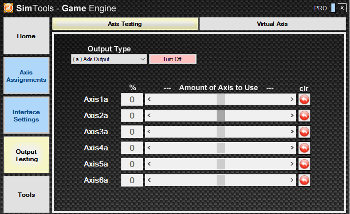

    I can test using the 'DOF Output drop down - previously this was not possible because there were no settings in the DOF section.
    This is how my actuators relate to the output testing:
    Axis 1a = Front mounted centered single actuator (physical label on actuator says Axis: A)
    Axis 2a= Rear Left actuator (physical label on actuator says Axis: B)
    Axis 3a= Rear Right actuator (physical label on actuator says Axis: C
    Some screens of my settings

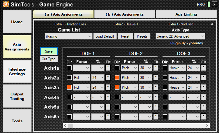

    To my way of thinking if Axis 1a = Front mounted centered single actuator then Roll does not apply in Axis Assignments. Nor should you mess with filters until the base profile is fully sorted.
    Heave and pitch are different. With heave all 3 actuators should move up and down in unison. With pitch up the front actuator should extend up and rear actuators should contract down, and the reverse for pitch down.
    You will likely end up with a smaller Axis Allocation for heave compared to pitch.

    That makes total sense on the roll, removing the front actuator indeed helped.
    I added more pitch and less heave, and that also looks good.

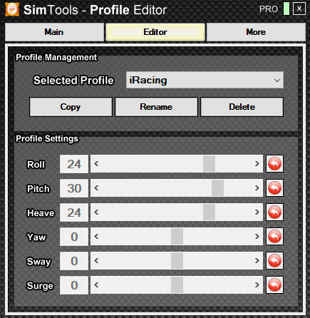

    So, in SimTools I opened the 'Game Manager' and there's an entry for iRacing here too, but all roll, pitch, heave values were at zero.
    I changed these to the same as the 'iRacing' config in the 'Game Engine'.

    Ok, so using the 'Game Manager' it works and seems like it's moving the right ways with the exception of pitch.
    It seems that I do not have to duplicate the parameters for roll, pitch and heave into the iRacing profile in 'Game Manager', so I'm not sure why the profile here even has those sliders?
    The only useful slider seems to be the main 'intensity level'?
