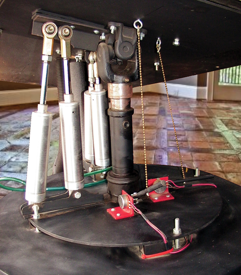

    I am going to build a fully enclosed cockpit that is mounted on a motion base. The frame will be wood, as will the platform base. I am going with a driveshaft/u-joint pedestal design as I think it will offer the smallest footprint and easiest build design. The first picture shows the basic type of pedestal I am planning to build.
    I am not planning to use pneumatic cylinders for this build, but rather 50:1 50RPM crab pot motors connected to arms and pushrods on ball and socket joints for hydraulic pushrods - the type used in the rear hatch of an suv.
    For the actuator controls I am thinking the Polulu JRK12v12 looks to be the simplest choice. However, I know NOTHING about computer programming or how to wire the boards etc. So, I will need help there.
    The power supply unit I think I will be using is a 12V 50 AMP 600W psu. I think one for each motor should do the trick. However, I do not understand for certain if these convert 120v to 12vDC directly or do I need a car battery in line with them...a little help there would be appreciated.
    Ok, so some of my questions about the platform build itself... the guy who built the pedestal in the picture used pneumatic cylinders and set the pedestal slightly behind and to the right of the rider in order to keep a constant load on the cylinders. Do I need to do this using electric motors as well, or should it be centered on the center of balance? Will the ball joints be strong enough to be used for this or is there a stronger option available? Also, I notice some people mentioned that 50:1 ratio might be slow for a flight sim on the DC motors...is this true?

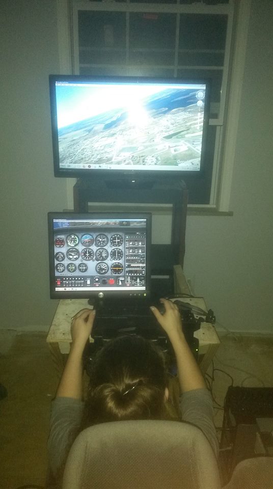

    The last picture is a preliminary setup with monitors and seat. This will be mounted to the platform, pending a little lightening up on weight. The seat base has a homemade bass shaker under the seat.
    Any and all help appreciated! Thanks guys! NV_0414_Noon_Figure06.jpg 28058702_506678916393345_4659229511000294121_n.jpg

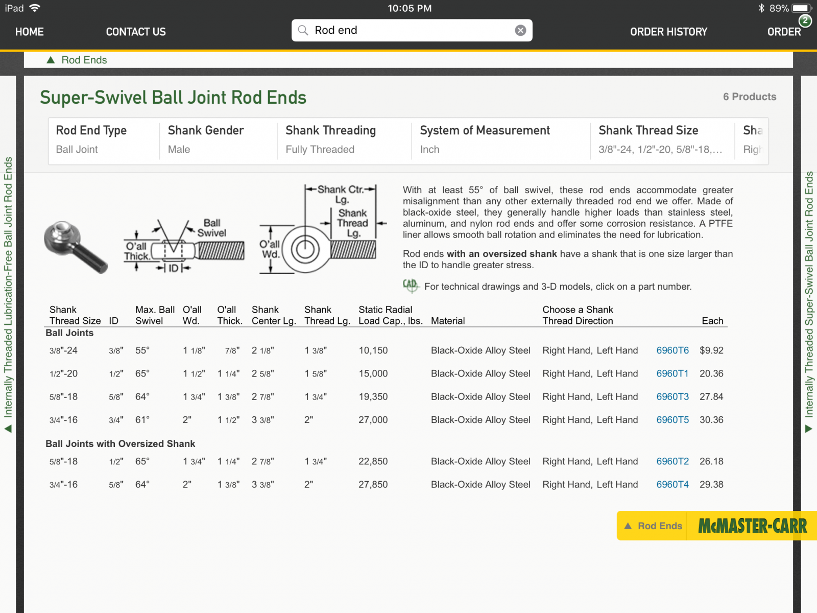

    Ok, so the high misalignment heim connectors look like the best choice as far as something that will last for the linkage rods. However, I have looked through e-bay and cannot find exactly what I am looking for. I am thinking like a 5/8 to 3/4 size would be sufficient for the pins that will pass through the heim connector...but I cannot seem to find a ready made linkage rod with that type of size connectors. What are you guys using to connect the motors to the motion base? Keep in mind that rider and seat and controls plus monitors will all be moving so probably somewhere in the range of 350-400 pounds in the top end of the weight category. I need strength and durability.
  15. noorbeast
    21,592
    151,215Coins
    A suitable sized steel rod with a nut welded either end would do the job.
  16. Donerb
    Donerb Old Racer
    Dec 28, 2017
    19
    California
    486Coins
    +9 / 0 / -0
    Honestly aerospace quality 3/8 high angularity rods are more then capable of handling the load if you don’t use high angularity you can go up a size and make up or buy stepped bushing to step down the pin size And make high angularity. Best ones have Teflon lining w/0 that they will start to rattle at some point. This is from McMaster as an example 4586FAC7-D32E-4EF5-ACAC-038DD8C847D9.png

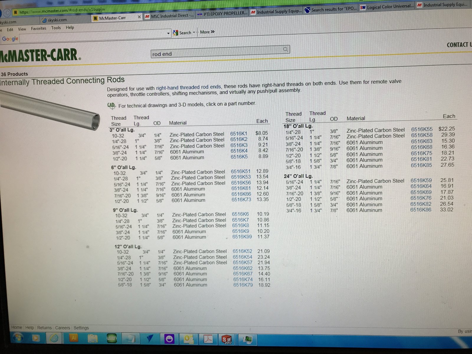

    I have looked at the different tie rod ends with Heim joints and had already decided that stepping down via a high angularity bushing would be the most cost effective method. However, I am having trouble finding rods that are threaded on the inside to accept the male connectors. I guess I just haven't figured out how to search for it. LOL

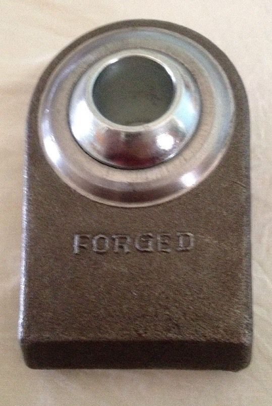

  19. Donerb
    Donerb Old Racer
    Dec 28, 2017
    19
    California
    486Coins
    +9 / 0 / -0
    Ah now those I like! That was what I was think of for my seat end. I’m on the road but let me look up the ends for the tubes so you can weld together. To be honest I don’t recall ever seeing pre built ones. Have you tried speedway motors? Or some of the sprint car suppliers?
  20. Donerb
    Donerb Old Racer
    Dec 28, 2017
    19
    California
    486Coins
    +9 / 0 / -0
