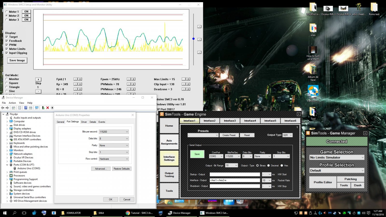

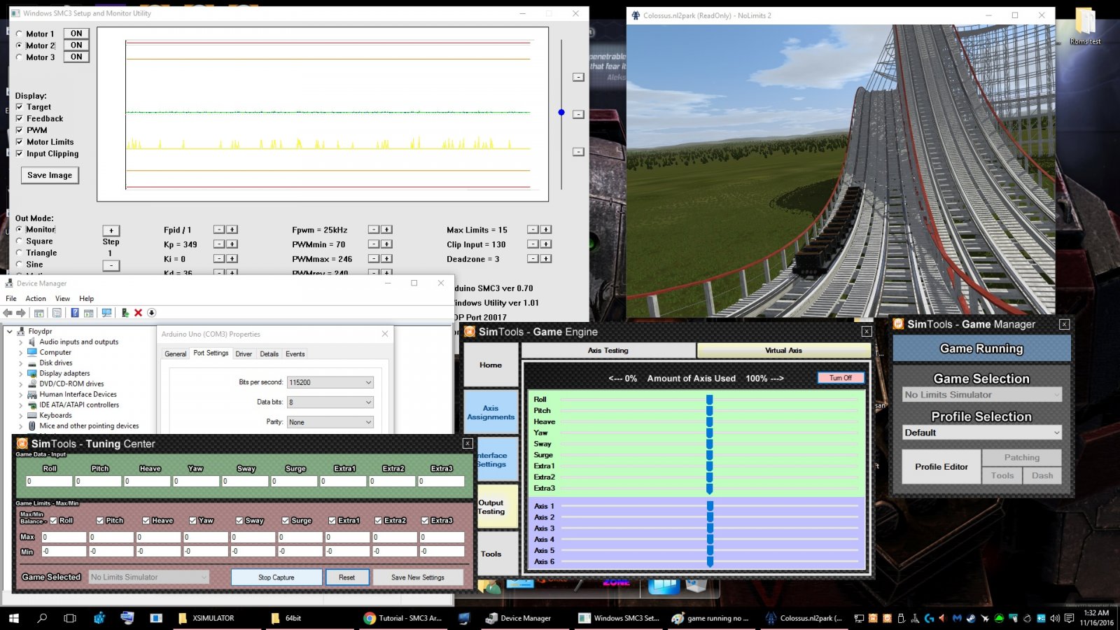

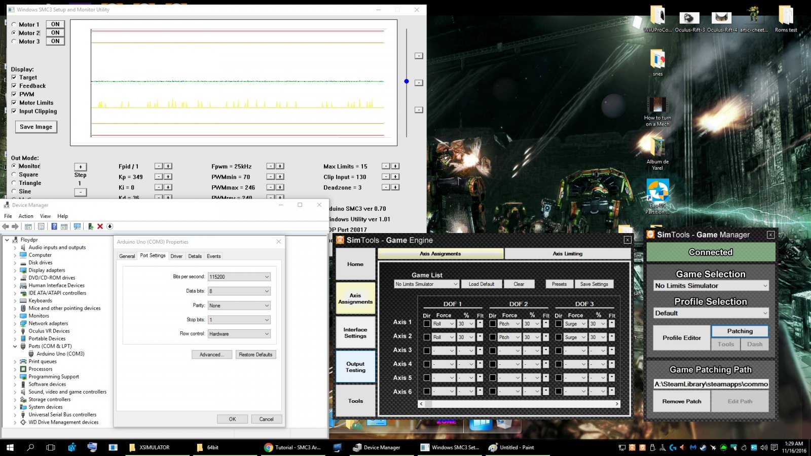

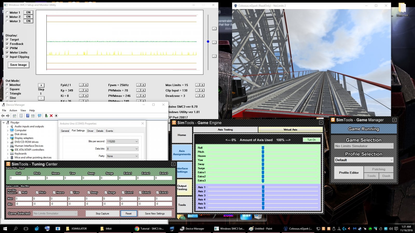

    Hello, in the photos you can see how my settings are, I have been looking for information on this and I have tried everything I have seen, when I run the SMC3 utils system, I run the engines without any problem. My problem is when I try to make the game send the data. I've also dealt with other games like Grid2, project cars and do the same. I have a 2dof, one engine I want to control the pitch and another the roll. I do not know what I'm doing wrong that the game is not sending any data.

    For NL2 you have to enable the --telemetry flag and it only works with the full version, not the trial version: https://www.xsimulator.net/community/faq/no-limits-2-v2-2-and-higher-how-to-activate-telemetry.198/
    Use these as the initial 'Interface Settings' configuration, just change to the appropriate com ports: https://www.xsimulator.net/communit...-and-windows-utilities.4957/page-5#post-50249
    Which way and axis moves is controlled by the DIR box being checked orange or not. This is the standard way the axis should be configured to move: https://www.xsimulator.net/community/faq/which-way-to-set-simtool-axis-movements.230/
    For example one will be checked orange for sway and the opposite checked for roll.
    The official SimTools documentation is here: https://www.xsimulator.net/community/faq/rtfm-start-with-the-official-simtools-documentation.117/
    And you can find further configurations tips and tweaks in the FAQs: https://www.xsimulator.net/community/faq/simtools-settings-tips-and-tricks.18/category

    Ok that works out! . That means that I have to activate the telemetry on each game? . What about grid and projects cars?

    @Floydpr
    looking at your pic you are trying to run both simtools and smc util at same time. Only 1 program can access a com port at a time, close smc and just run ssimtools and game you want motion from.
    21,603
    151,275Coins
    +11,033 / 56 / -2
    No, the --telemetry flag is just for NL2.
