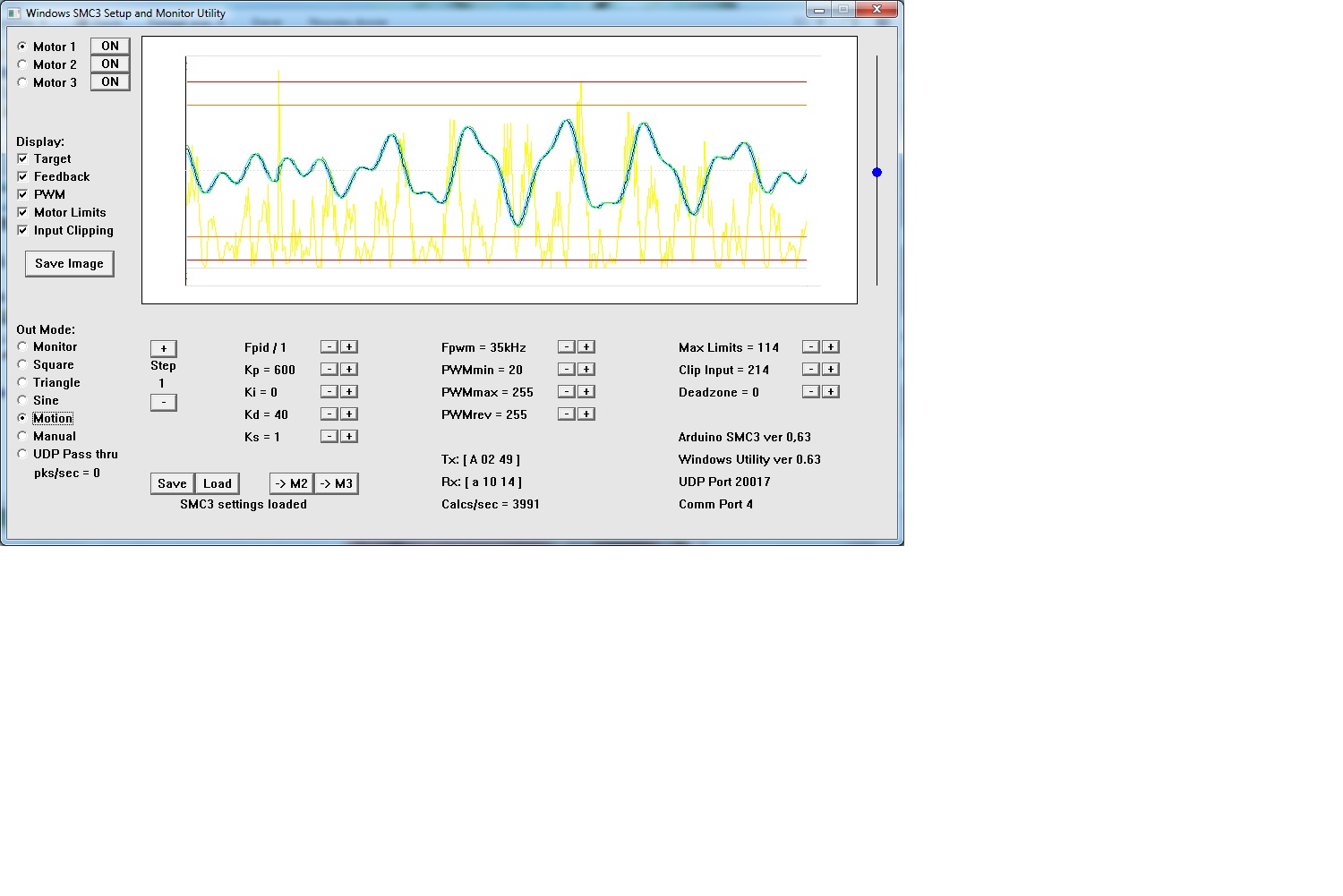

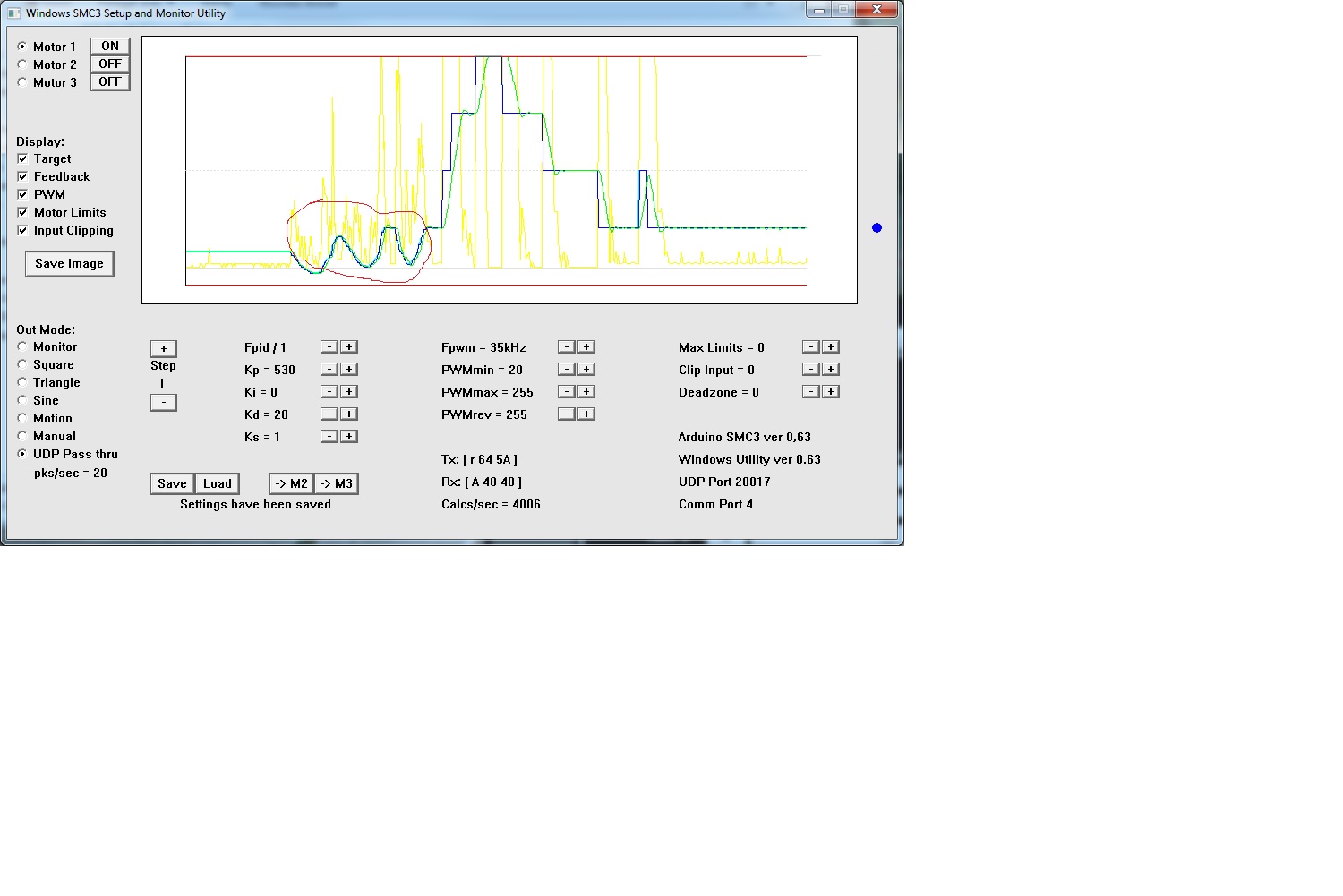

    Hi, :)
    I tried testing Rufus advised but it gives no good result to me. :blush
    here it is:
    This is in manuel mode and i move the slider of simtool (axis) slowly and continuously.
    In mode : motion with SMC3utls only = it is works very well !:thumbs

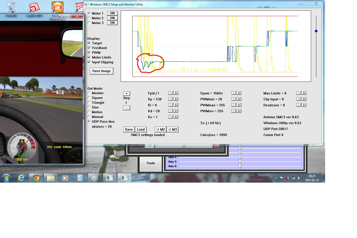

    and the last one with game motion :
    you can see in the red circle a good response but step response elsewhere
    :sos
    Eric :cool:

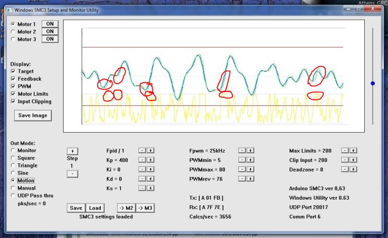

    This is the test with SMC3. Everything work smooth.

    Hi spartan, as a side note I notice in your screenshot you are getting some tracking lag in a few places. If you look at the yellow PWM signal at each of these instances it is being clipped by your PWMmax setting (see markups). This means the motors aren't getting sufficient power to track fast moving changes. I would suggest your PWMmax signal is too low - usually it would be above 150 and perhaps even close to 255 (maximum allowed) if the motors are under load.
    You will probably find with current setting the tracking will be even worse when you sit in the sim... I am guessing this was a bench test?
    Also once finished testing I would reduce the Max Limits setting to about half the Clip Input setting - the Ard shuts off the motors if they get to the Max Limits setting position

    Yes RufusDufus you are right.
    I was planing to reduse Max Limits and increase PWMmax to get better resolts and again yes this was test with no load.
    I wanted first to fix everything in my sim (simtools, axis,game) and than re-tune PID settings.
    Thank you for your help.
    I must say that this is the first time iam to close to make it work. I am making thia sim for about 2 years now and only with your SMC3 i managed to make it alive.
    I hope you can find out what is happening with the simtools and finally start my engine:):)

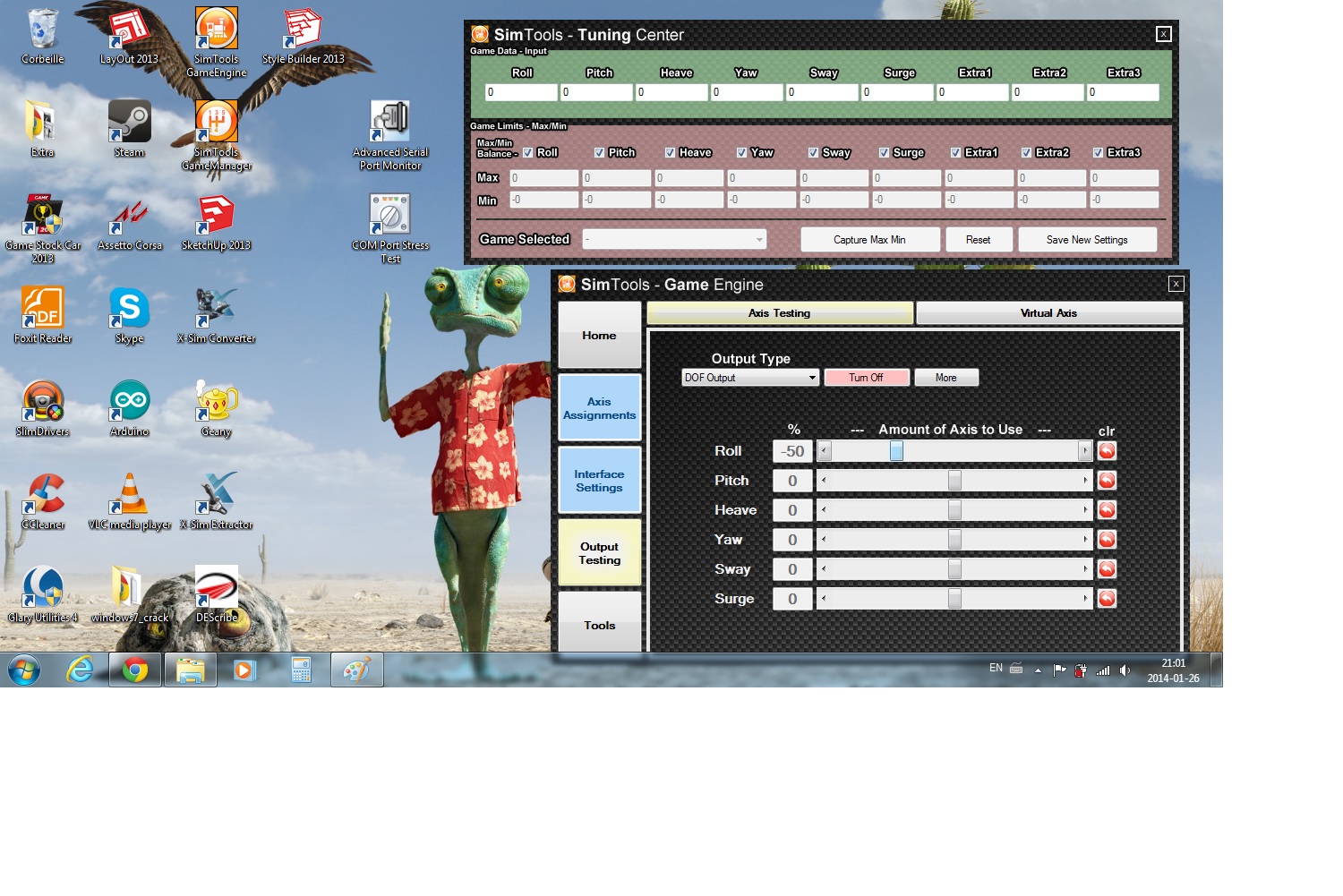

    My setup - Modified atx powersupply 48a
    2x polulu 36v20cs h-bridges
    2x hall effect pots 10k
    2x zyt 155-12v motors
    arduino uno running SMC3 firmware mode 1
    All connections made like discribed.
    Simtools runs on 1 pc.
    Arduno direct from Simtools
    Saved default axis profile
    Using Axis output
    Windows 7 ultimate
    The problem still is when I move the sliders of axis1 and axis2 nothing moves untill the slider reaches about 26% and then the motors move to their limits and when sliding back the move to the center.

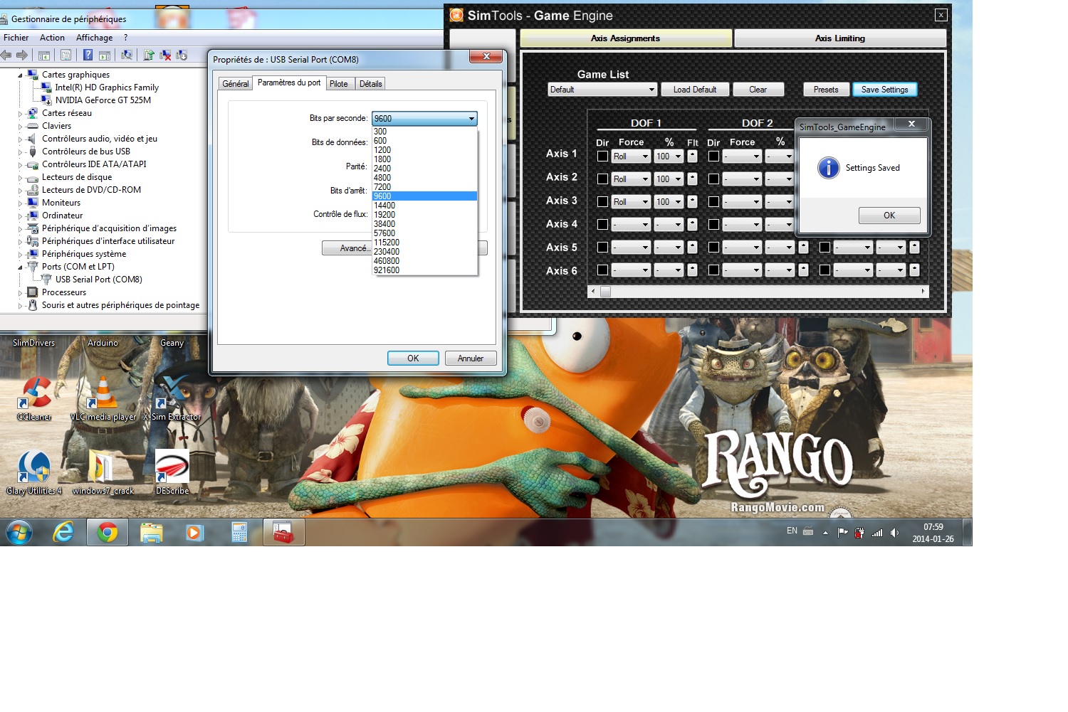

    me too , i want to thanks for the quick response on these problems.:thumbs
    As Rufus has already explained to me, Simtools manages the communication parameters itself with windows but is it normal that 500kbauds is not in the list of the device manager ? :nerd
  17. spartan300
    spartan300 New Member
    May 25, 2011
    19
    Doctor
    Athens
    462Coins
    +19 / 0 / -0
    Hi. still the same for me too.The only difference is that it keep the 500kBauds saved :(

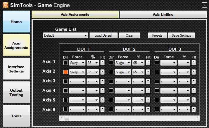

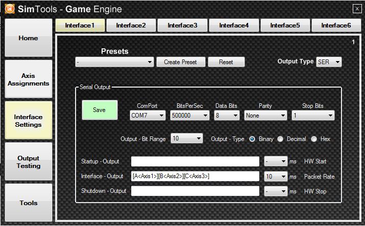

    OK, as a double check I just installed everything on another computer from scratch and all is working as expected... I have to assume at this stage I am forgetting to tell you something.
    Here are my interface and axis assignment settings.. and I will continue to investigate possible causes. :think

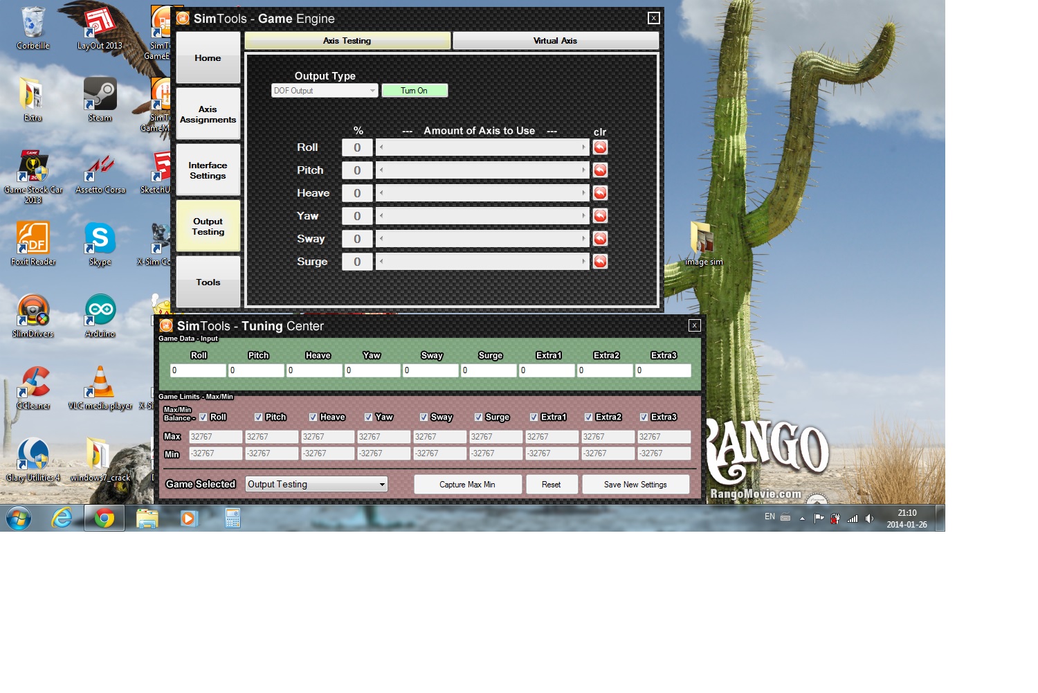

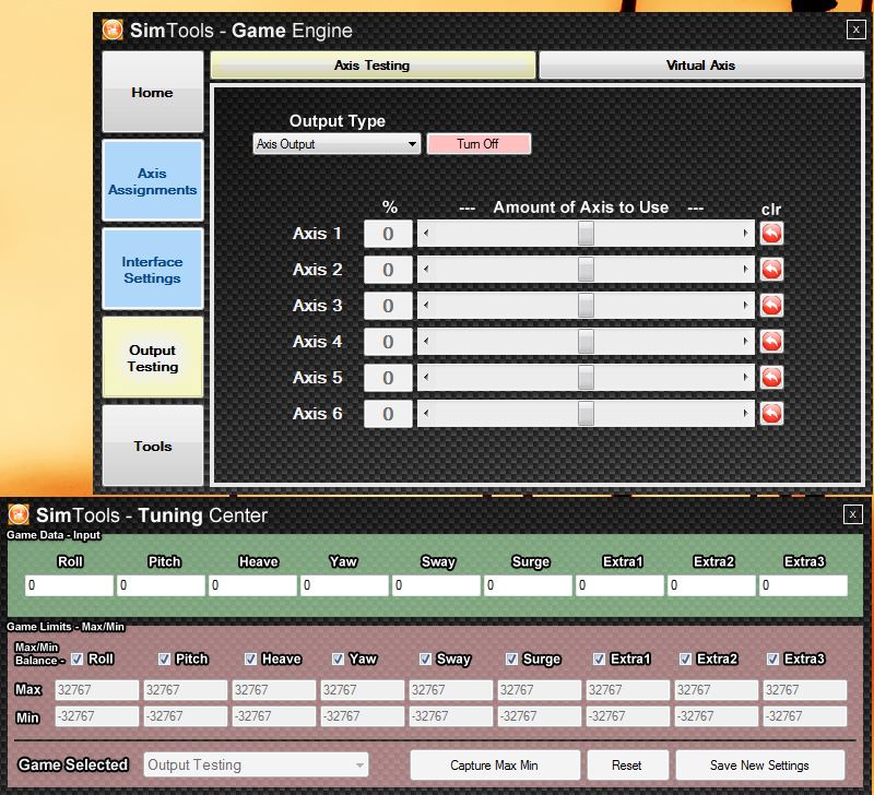

    This is what the tuning center should look like when in output testing mode... please check.
    Note: when in Axis output the values in the green area will stay at 0. When in DOF output the values in the green area will change as you move the associated DOF slider from -32767 to 32767 (the slider end points).
    The game selected should say Output testing and all min/max values are -32767 and 32767

    As you know, I have version 1.1.
    I took care to save before "Axis assignments, defaults, roll = 100%" and "COM8, 500k, 8n1, binary, 10ms, [<Axis1> A] [B <Axis2>] [C <Axis3> ]
    I managed to get numbers (32k-32k-) in the green zone only 1 time in manual mode and I do not know why I'm not able to see them any more. I closed, reopened simtools, rebooted the computer, but nothing more.

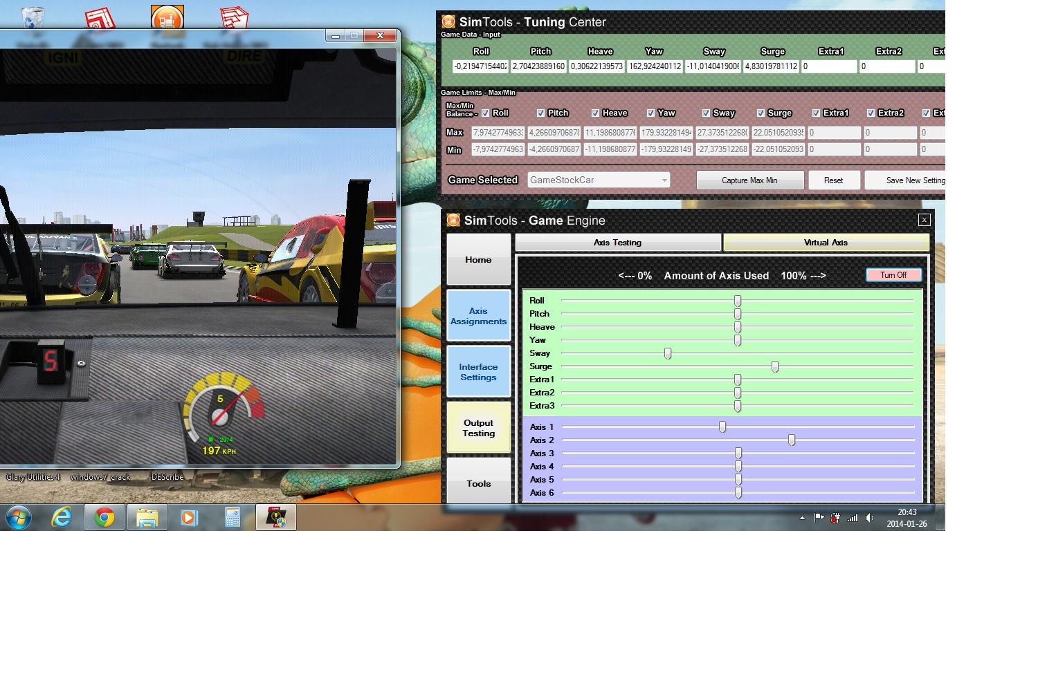

    In Game mode, I have these numbers:
