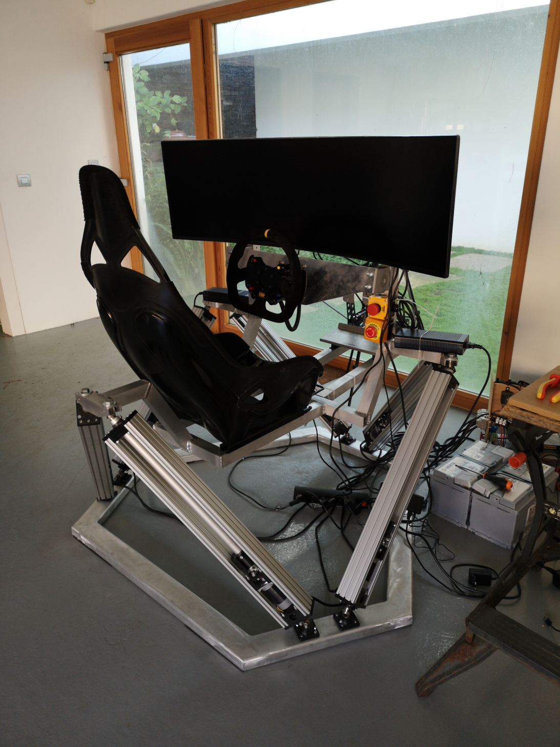

    Before reading everything here, just a short info:
    First time posting, but sneaking for a long long time (sorry for some English errors I might post).
    So some of the guys here are guilty! Yes, I started to build a 6DOF motion simulator with DIY actuators.
    SeatTimes, SilentChill and some others, you are an inspiration.
    I think my wife hates you guys... ;)
    So, for some years I've been looking at motion sims, but since my desire was always cars and air planes, I always thought that less than 6DOF would kill the aircraft experience (probably I'm wrong).
    But now with so many 6DOF builds, specially with actuators, I though it's the time to start my build.
    Well it already started some months ago, but free time is always a problem.
    I will make some posts to put at the start of this thread the current project development.
    I will make the following topics:
    -Videos and photos (latest images and videos of the construction)
    -Parts (list of all parts, and where I got them)
    -Plans (drawings, schematics and 3D printed parts files)
    -Software (software used, setups and code developed for this project)
    So let's start! Hope my project can help others. And let's hope I can make it.

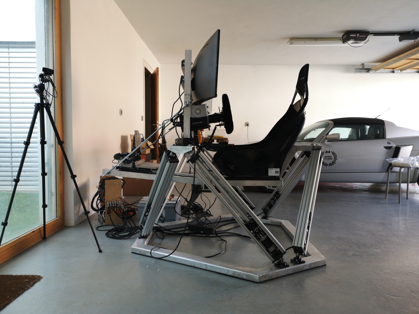

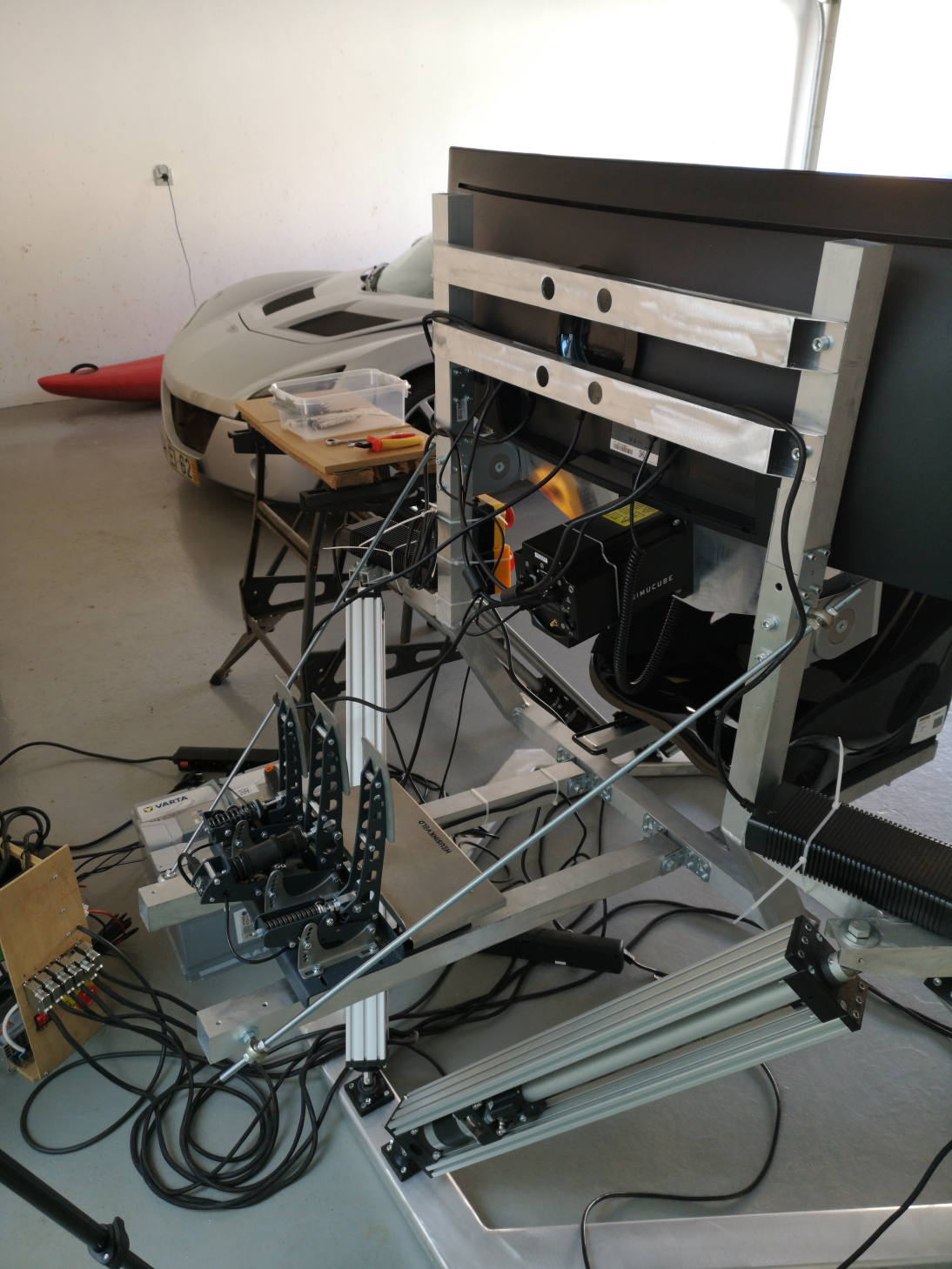

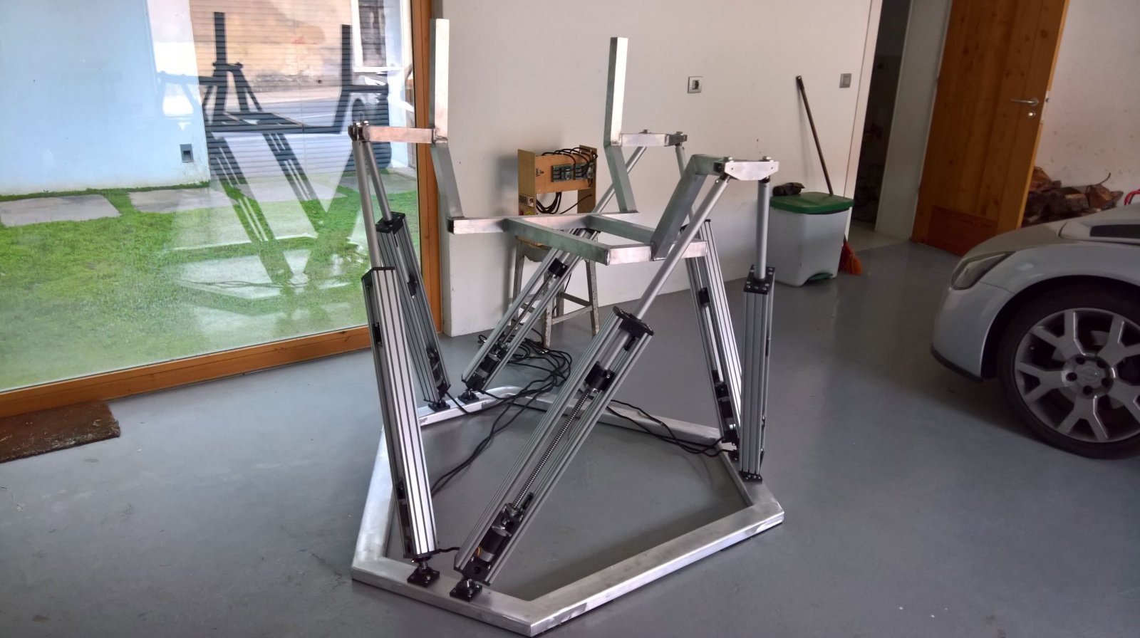

    Videos and photos
    Current state (needs cable management...):
    Older state, just the hexapod:
    Latest video
    Testing FlyPT Mover with DiRT Rally2:
    Testing the old interface between SimTools and ESP32 boards:
    Fifth video
    With load:
    Fourth video
    Hexapod moving.
    Third test video
    Arduino replaced by ESP32 and no more potentiometers.
    Positioning made with internal hall sensors of BLDC motor.
    Older videos in my Youtube Channel...

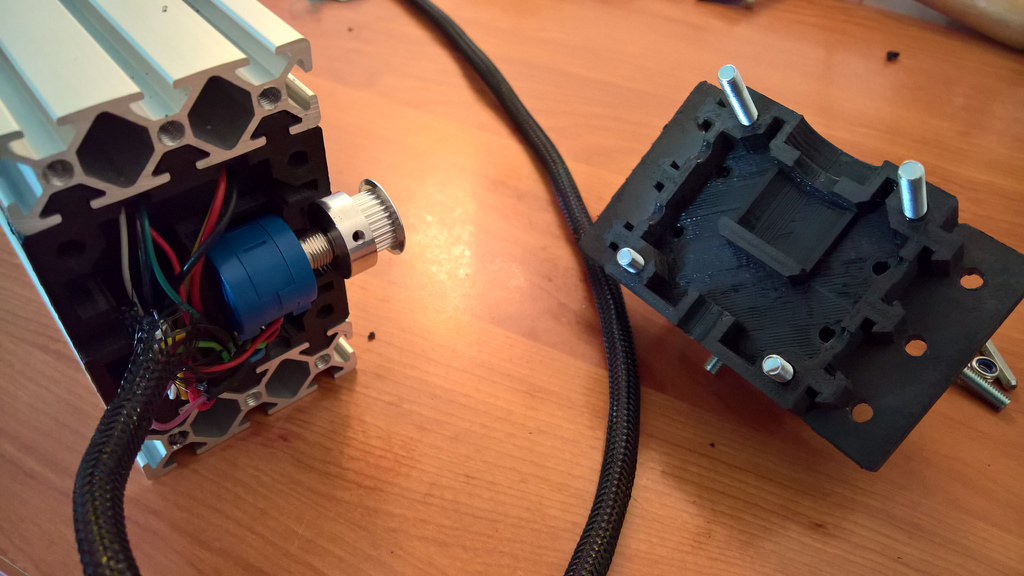

    Parts
    List of all parts, and where I got them
    No prices, because they are always changing, I don't want to know how much I spend in total :p

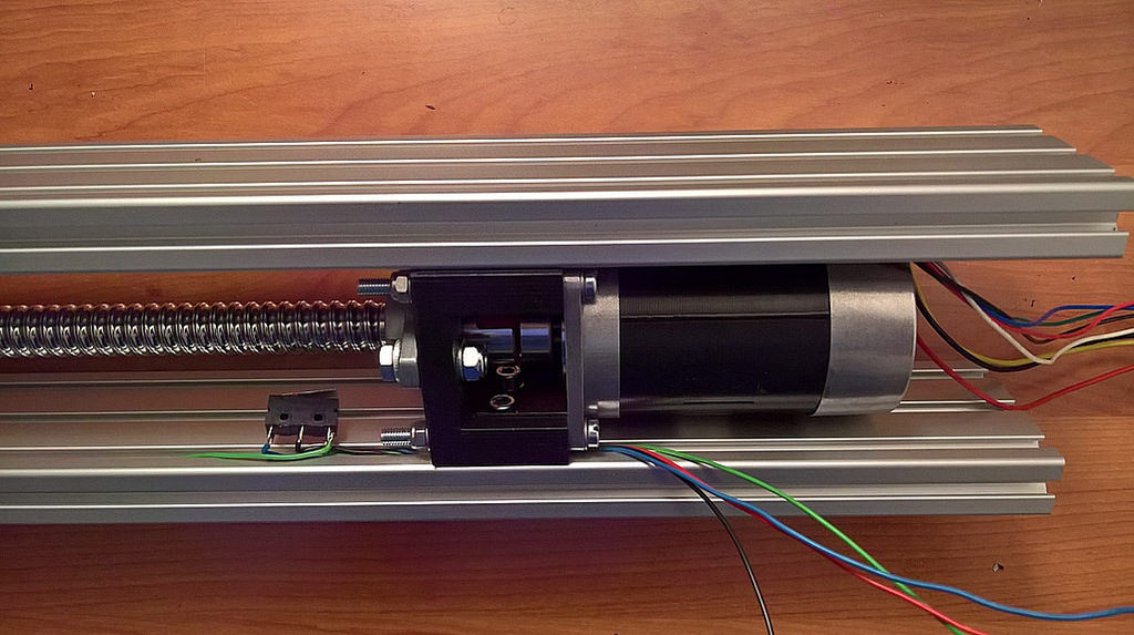

    Motors (6x):
    Nanotec DB59C024035-A (brushless).
    1 Bought from Portuguese reseller
    5 Bought at Farnell (http://pt.farnell.com/nanotec/db59c024035-a/bldc-motor-24vdc-4500rpm/dp/2507576 - less than half the price from above )
    Specs: http://en.nanotec.com/fileadmin/files/Datenblaetter/BLDC/DB59/DB59C024035-A.pdf

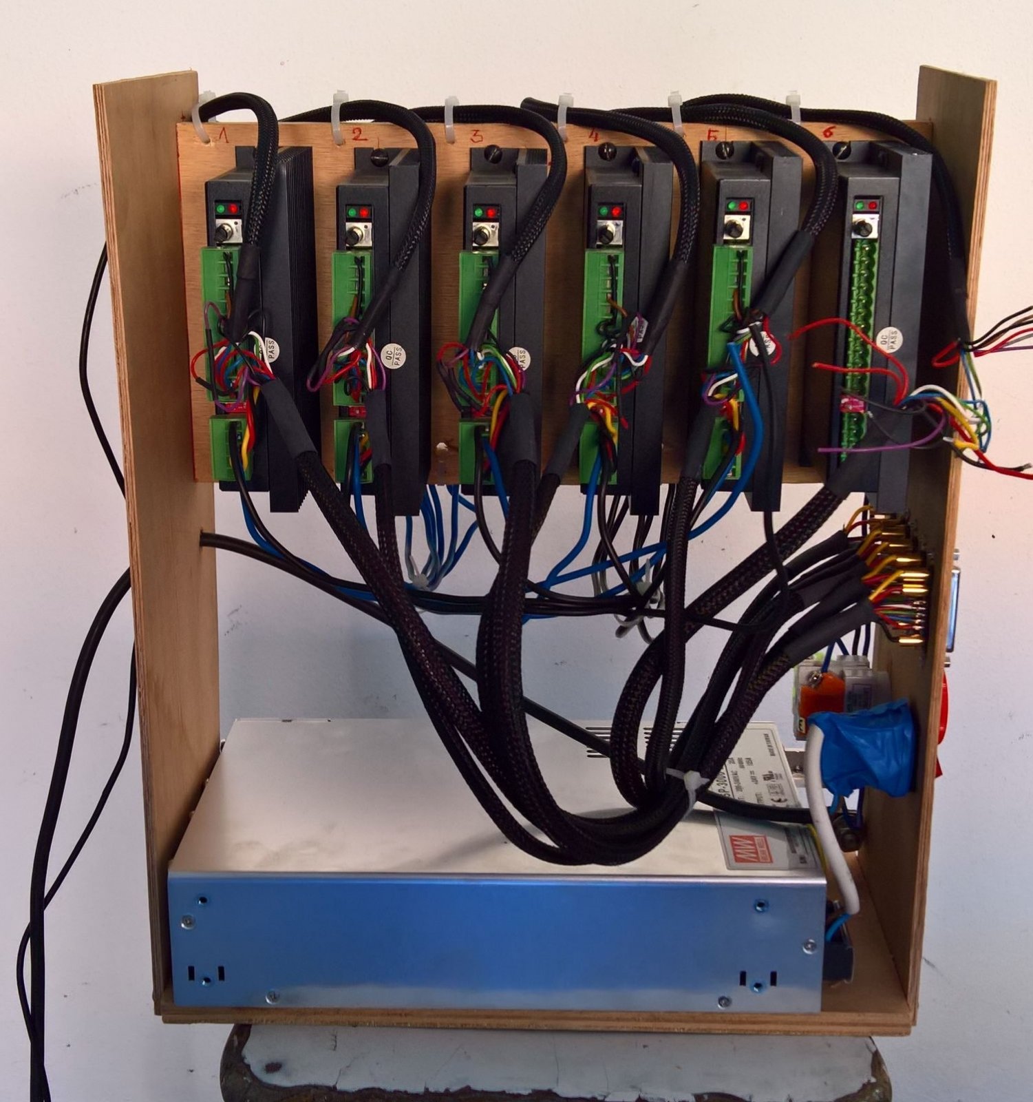

    Motor drivers (6x):
    ACT Motor BLDC-8015A
    Bought on ebay (http://www.ebay.co.uk/itm/252468509819?_trksid=p2060353.m1438.l2649&ssPageName=STRK:MEBIDX:IT).
    Specs: http://www.wantmotor.com/product/8015a.html (From Wantai, but equal to ACT Motor)
    ATTENTION: ACT / Wantai / Longs motors seems the same, but try to buy all from the same source. I got from Wantai and ACT, and controllers have different speeds! <<< It's possible to adjust speed on those controllers, but you have to open them. Post about that: https://www.xsimulator.net/communit...shless-diy-actuators.10799/page-8#post-166235
    Power supply (1x):
    Mean Well RSP-3000-24
    Bought on ebay (http://www.ebay.co.uk/itm/231473165159?_trksid=p2060353.m2749.l2649&var=530732464572&ssPageName=STRK:MEBIDX:IT).
    Specs: http://media.it-tronics.de/Datasheets/Power_Supplies/MeanWell/RSP-3000.pdf

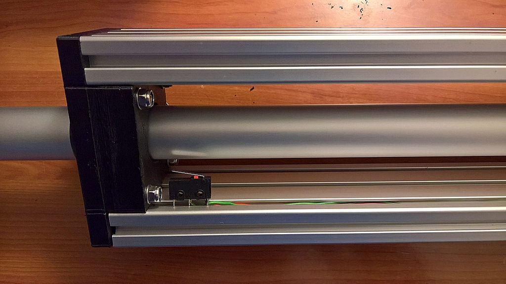

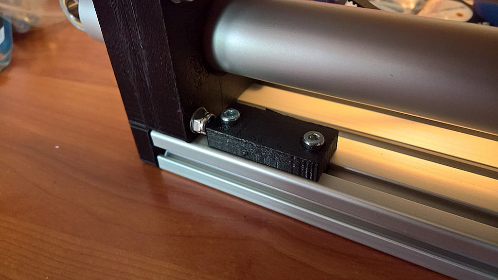

    Microswitches (12x):
    Bought on ebay (http://www.ebay.co.uk/itm/282088135235?_trksid=p2060353.m2749.l2649&var=581040167277&ssPageName=STRK:MEBIDX:IT)
    Specs: 16mm lever

    Aluminium tube (6x):
    Bought from Motedis (http://www.motedis.com/shop/Tube-sy...ular-tube-aluminium-anodized-28x2mm::823.html)
    Specs: 28mm exterior, 2mm wall with 500mm length
    Aluminium profile (12x):

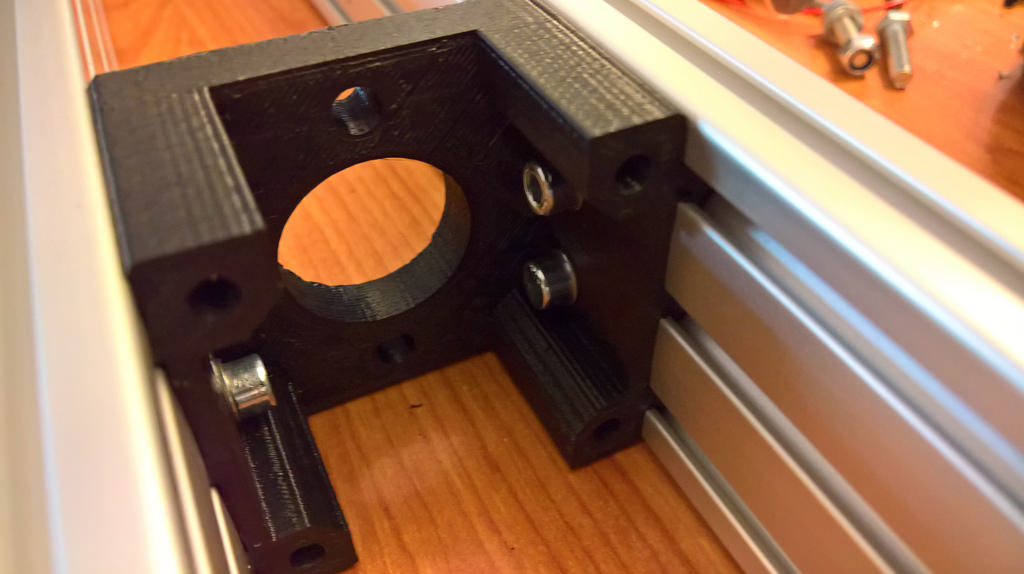

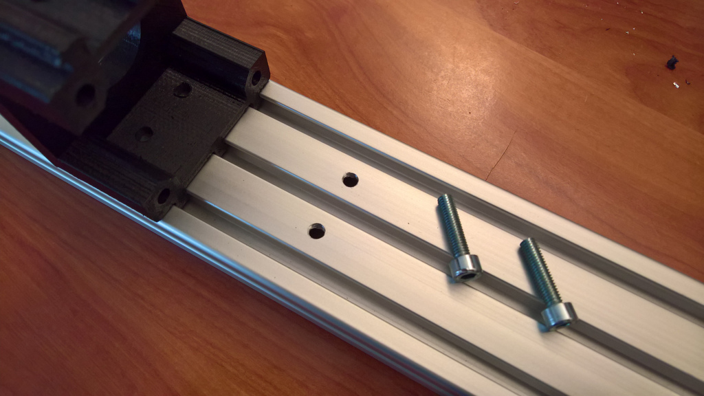

    Bought from Motedis (http://www.motedis.com/shop/Slot-pr...-slot-5/Profile-20x60-I-Type-slot-5::499.html)
    Specs: 20x60 I-Type slot 5 with 730mm lenght
    Aluminium for upper structure with 40x40mm (5m)
    Aluminium for bottom structure with 80x40mm (5m)

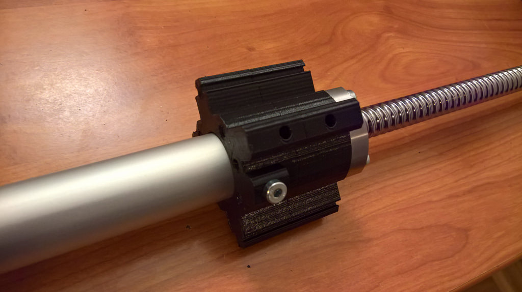

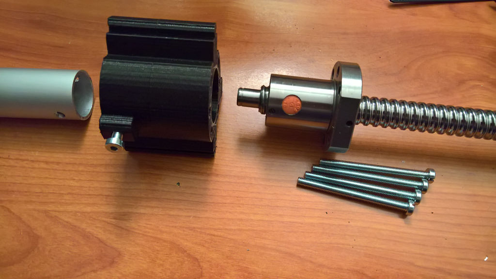

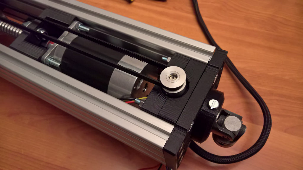

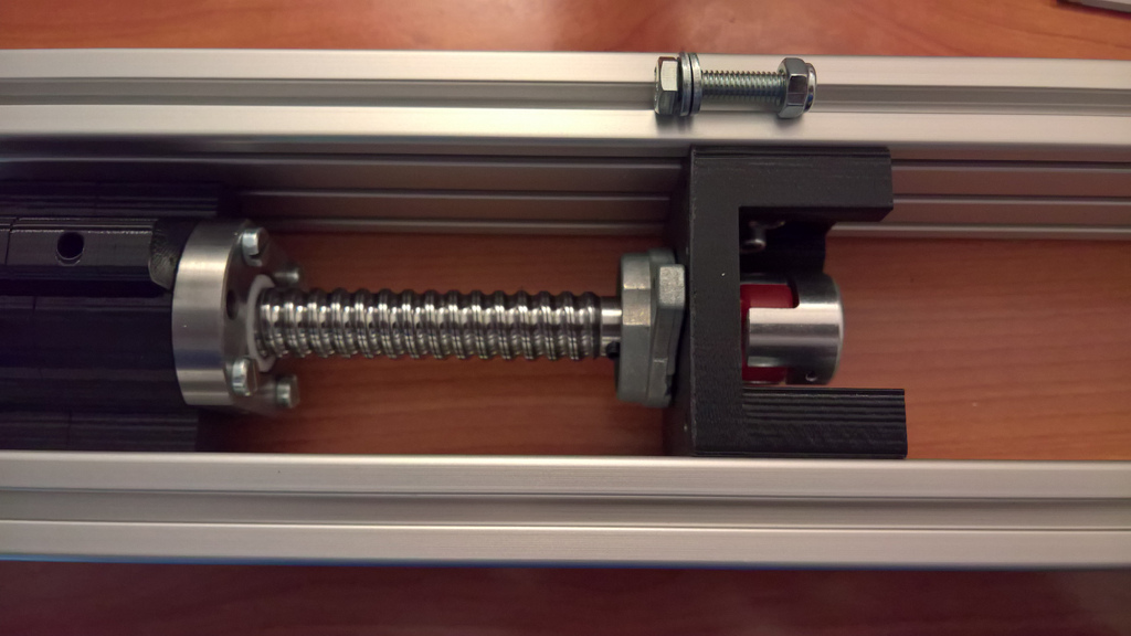

    Ballscrew (6x):
    Bought from Motedis (http://www.motedis.com/shop/Dynamic...es/Ball-screw/Ballscrew-SFU1605-DM::1444.html)
    Specs: SFU1605-DM with 542mm (5mm step for each turn with 16mm diameter)
    Nut for ballscrew (6x):
    Bought from Motedis (http://www.motedis.com/shop/Dynamic...ball-screw/Screw-nut-DIN-439-M10x1::2444.html)
    Specs: DIN 439 M10x1
    3D Filament PET-G 1,75mm black (4kg):
    Bought from Motedis (http://www.motedis.com/shop/table_cats.php?table_id=45)

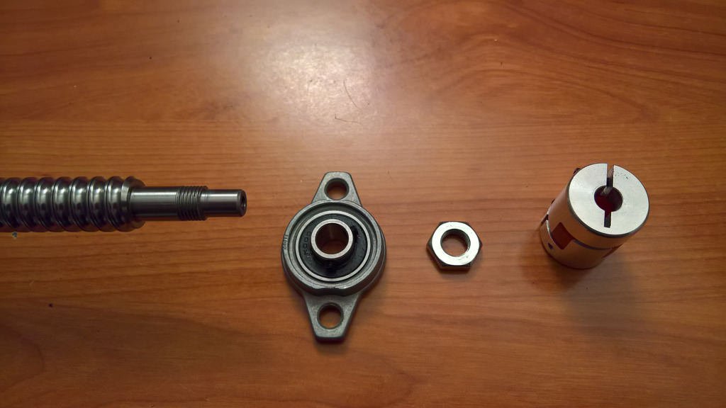

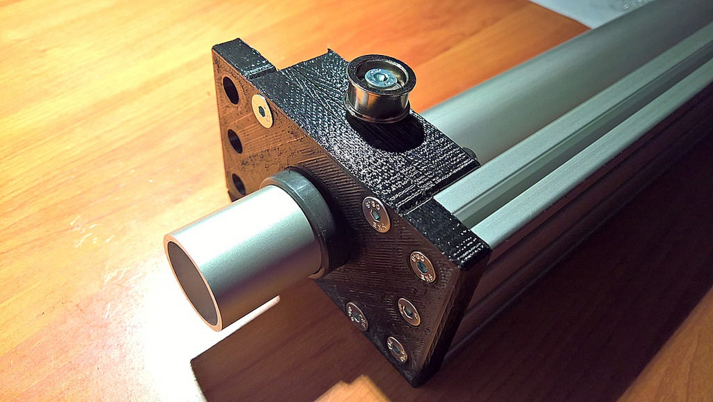

    Flange Bearing (6x)
    Bought from Motedis (http://www.motedis.com/shop/Dynamic...lange-Bearing-10mm-die-cast-KFL000::5212.html)
    Specs: 10mm die-cast aluminium KFL000
    Plain bearing (6x):
    Bought from Motedis (http://www.motedis.com/shop/Dynamic...g/Plain-bearing-Igus-GFM-283239-20::1166.html)
    Specs: Igus GFM-283239-20 Type 283239-20
    Flexible clutch (6x):

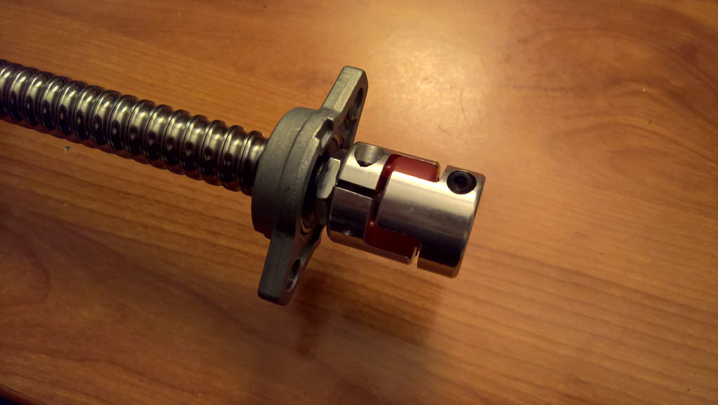

    Bought from ebay(http://www.ebay.co.uk/itm/Wellenkup...287275?hash=item3f76fdd8eb:g:MIAAAOSwOgdYynFj)
    Specs: Diameter 25mm Lenght 30mm Shaft diameter 8,00mm/8,00mm

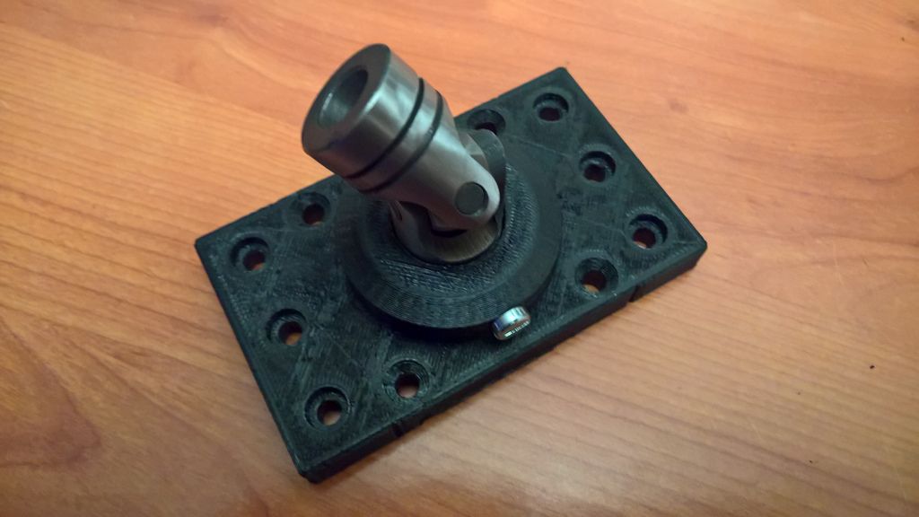

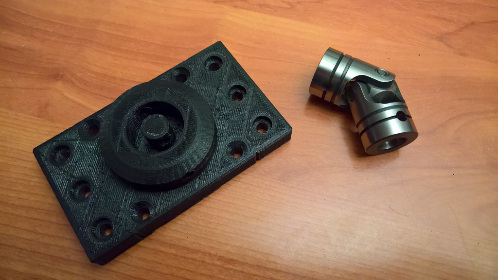

    Universal joint (12x):
    Bought from ebay (http://www.ebay.co.uk/itm/12mm-Dia-...654174&hash=item2cadada585:g:odAAAOSwuhhXWW89)
    Specs: 12mm Dia Shaft Coupling Motor Connector

    Socket cap Allen screw M4 x 12mm - To fix limit switches (6 x 4x = 24x)
    Socket cap Allen screw M5 x 20mm - Most used screw (6 x 18x = 108x)

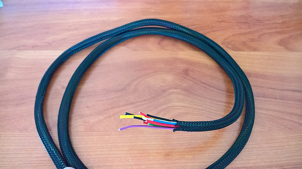

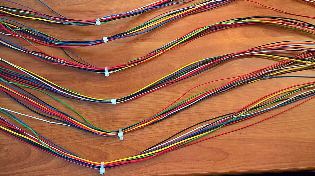

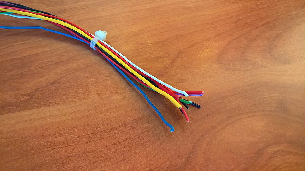

    Wires:
    0.35 mm2 cross section for signal (various colours)
    1.00 mm2 cross section for motors power (yellow, black and red)
    Bought on ebay (https://www.ebay.fr/itm/Automotive-Wire-0-35-1-5-mm-Thin-Wall-Cable-AWG16-22-Singlecore-5m-10m-lead/282093003064?ssPageName=STRK:MEBIDX:IT&_trksid=p2057872.m2749.l2649)

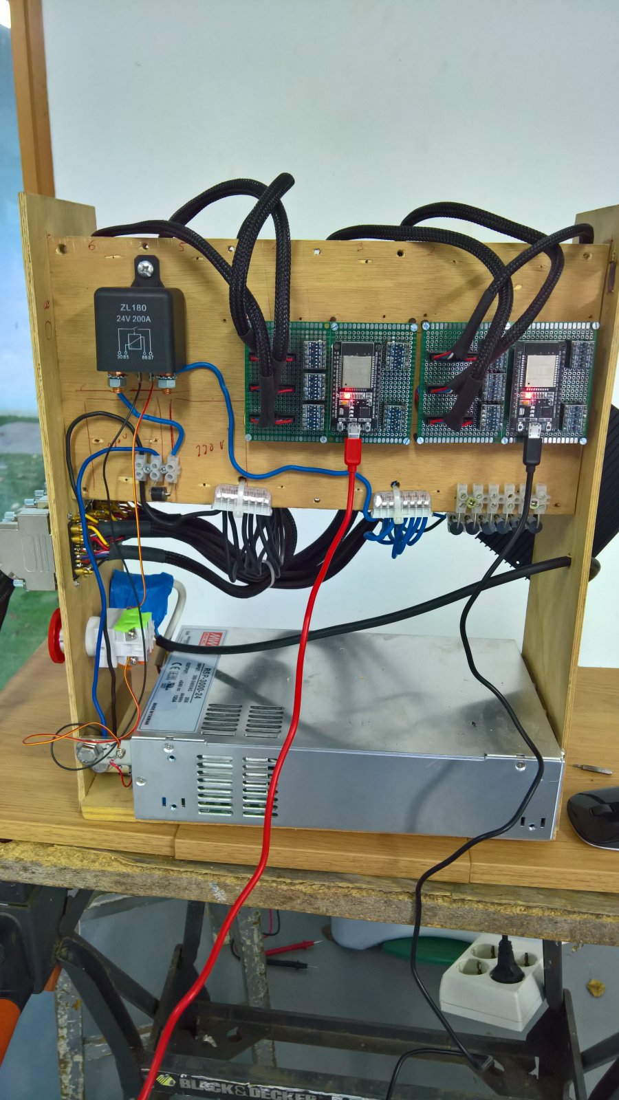

    Relay 24V 200A (1x):
    Bought on ebay (https://www.ebay.fr/itm/Car-Truck-Boat-24V-200A-Heavy-Duty-Split-Charge-Starter-Relay-with-Teminal/163238356171?ssPageName=STRK:MEBIDX:IT&_trksid=p2057872.m2749.l2649)

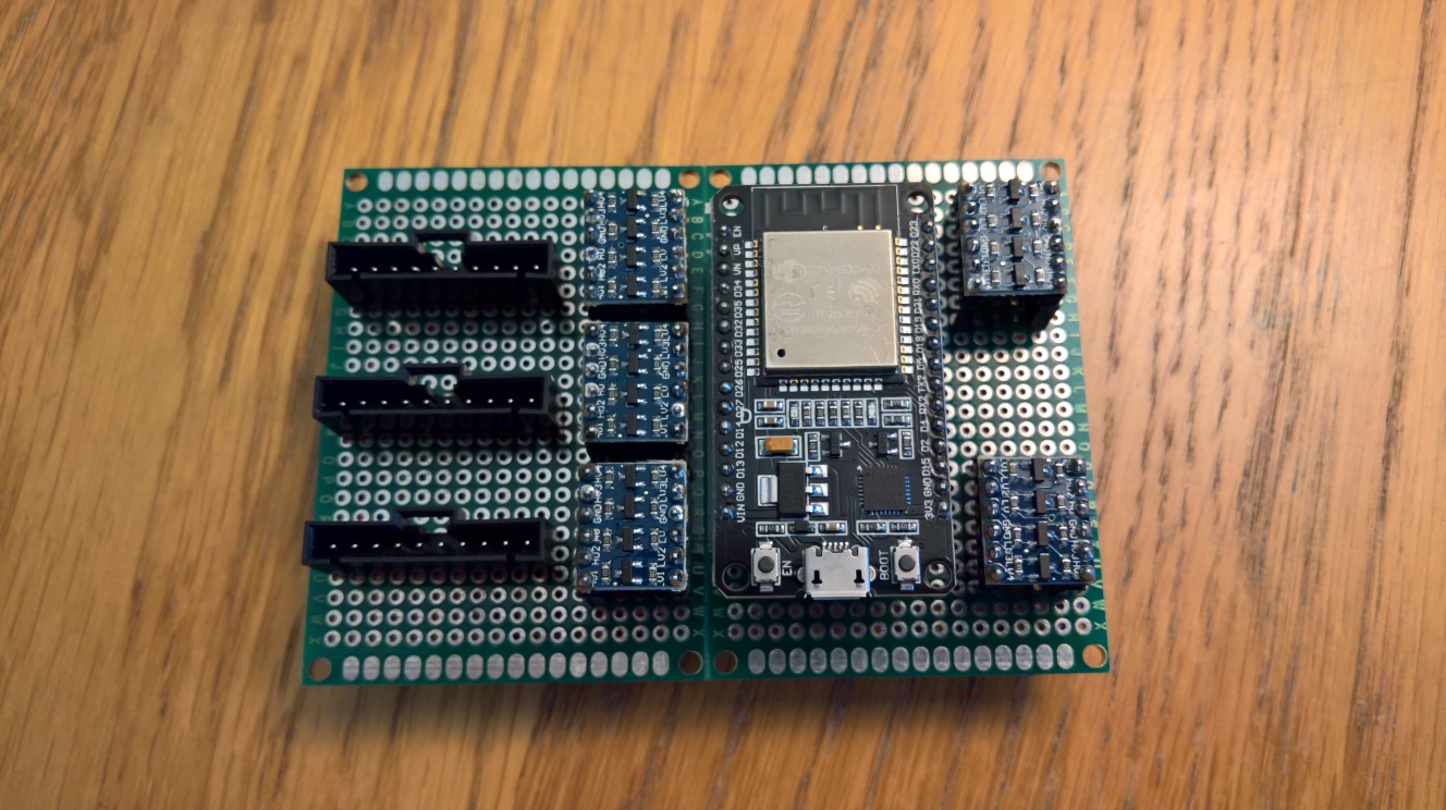

    ESP32 Dev Kit (2x):
    Bought on ebay (https://www.ebay.fr/itm/Espressif-ESP32-WLAN-Dev-Kit-Board-Development-Bluetooth-Wifi-v1-WROOM32-NodeMCU/253059783728?ssPageName=STRK:MEBIDX:IT&_trksid=p2057872.m2749.l2649)
    Level shifters (10x):
    Bought on ebay (https://www.ebay.fr/itm/5-Stuck-4-K...668603?hash=item3aeafec63b:g:xR0AAOSwiYlaD2Gc)
    Male/Female connectors with 10 pins to mount on PCB (6x):
    Bought on ebay (https://www.ebay.fr/itm/KIT-5x-BUCHSE-STECKER-10-polig-CRIMPKONTAKTE-2-54mm-PCB-Gerade-A2011/253322647034?ssPageName=STRK:MEBIDX:IT&_trksid=p2057872.m2749.l2649)
    Male/Female pins to mount ESP32 and level shifters on the PCB (10x M/F with 6 pins and 4x M/F with 15 pins):
    Bought on ebay (https://www.ebay.fr/itm/Pin-or-Female-Header-Edge-Pins-Strip-0-1-2-54mm-for-Breadboard-PCB-for-Dupont/263333424929?ssPageName=STRK:MEBIDX:IT&_trksid=p2057872.m2749.l2649)
    PCB board 5x7 (2x):
    Bought on ebay (https://www.ebay.fr/itm/1055-Double-Side-Copper-prototype-pcb-Universal-Board-for-Arduino-au-choix/292031954800?ssPageName=STRK:MEBIDX:IT&_trksid=p2057872.m2749.l2649)

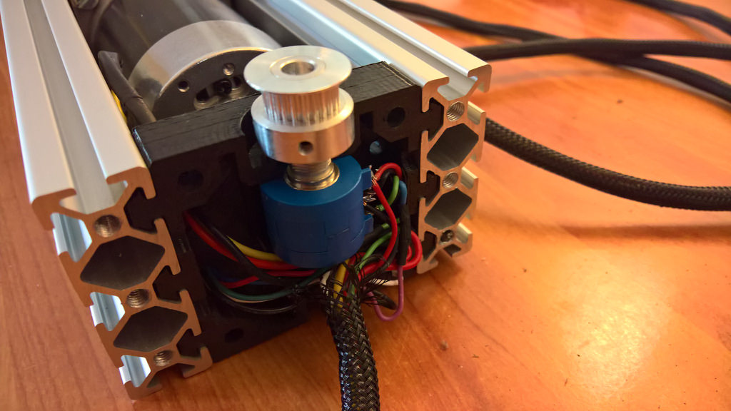

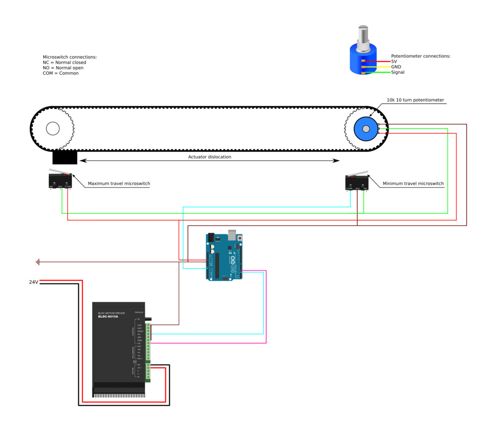

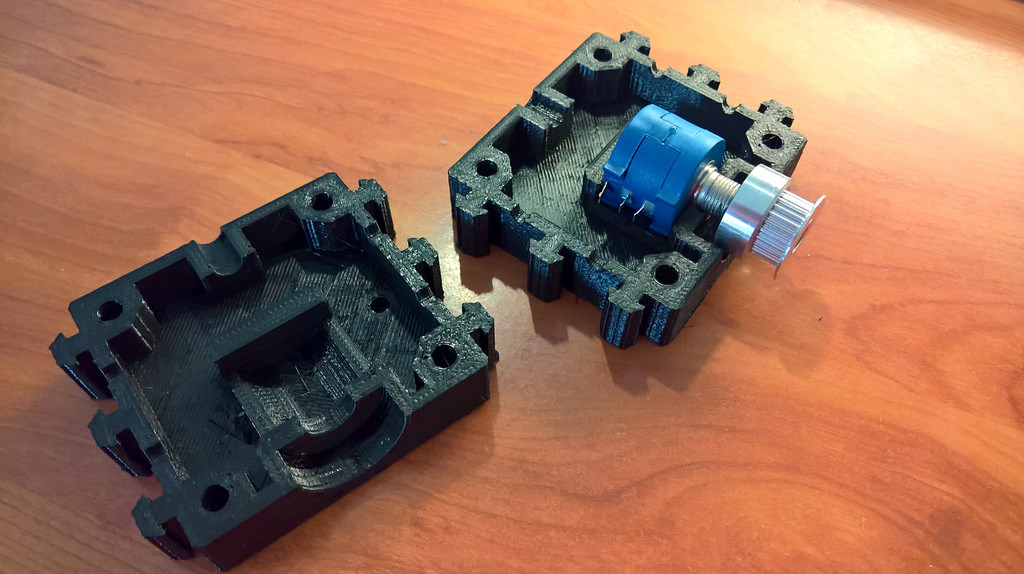

    PARTS SPECIFIC FOR POT POSITIONING VERSION
    Potentiometers (6x):
    Vishay 10K 10 turn
    Bought at Farnell (http://pt.farnell.com/vishay/536-1-1-103/wirewound-potentiometer-10kohm/dp/1386483?st=vishay pot)
    Specs: http://www.farnell.com/datasheets/2...MI_oTz8b3L2wIVhPdRCh08AQzXEAAYAiAAEgLrj_D_BwE
    Idler wheel for 6mm wide belt (6x):
    Bought from Motedis (http://www.motedis.com/shop/Dynamic...-6mm/Idler-wheel-for-6mm-wide-belt::4523.html)
    Specs: 6mm wide with 18mm outside diameter
    Aluminium pulley (6x):
    Bought on ebay (http://www.ebay.co.uk/itm/152084840946?_trksid=p2060353.m2749.l2649&var=451287689730&ssPageName=STRK:MEBIDX:IT)
    Specs: 24 teeth pulley for 6mm GT2 belt
    6mm GT2 belt (10m):
    Bought from Motedis (http://www.motedis.com/shop/Dynamic...mm/GT2-Open-Timing-Belt-6mm-1000mm::4251.html)
    Specs: 6mm GT2 belt

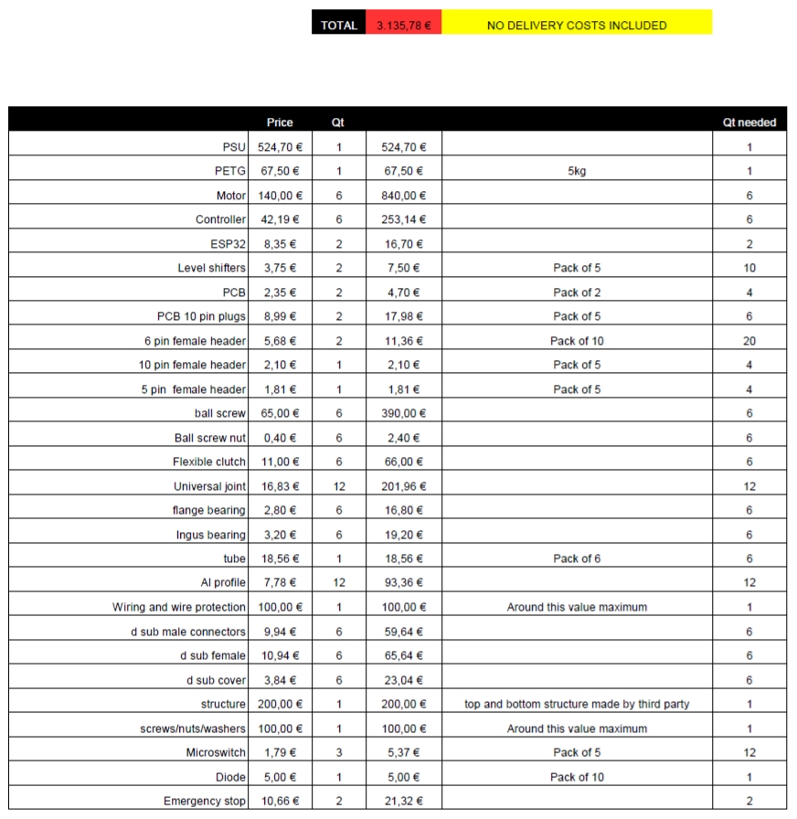

    Cost £££ $$$ €€€
    Cost for building this motion sim
    I thought of not making this, but here's a current look at the costs for the current version using hall sensors from the motors:
    Those costs are only for:
    -The hexapod, no chair or wheel support.
    -No delivery costs (depends on where you are)
    I spent more with errors I made and building a pot version of the actuators.
    Parts are from Farnell, Motedis and ebay. You can see the list in a post above.
    Could have bought a pack of motor and controller for 98,99€:
    BLDC 8015A + 57BLF03 (https://www.ebay.fr/itm/ACT-MOTOR-G...552331?hash=item3afed62d4b:g:ZU8AAOSw0hlZMXao)
    Motor is slower, but cost would come down to 2636,58€.

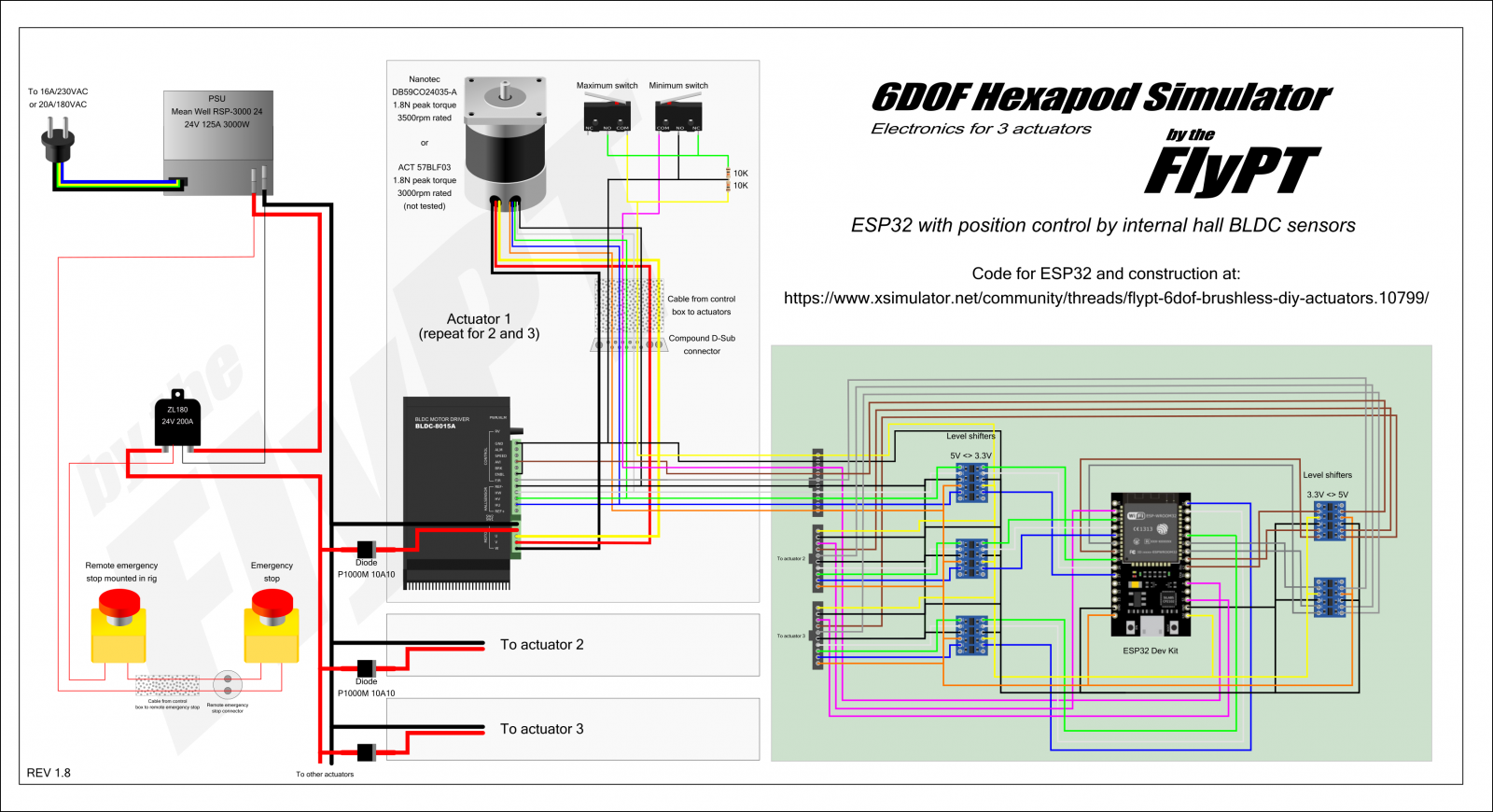

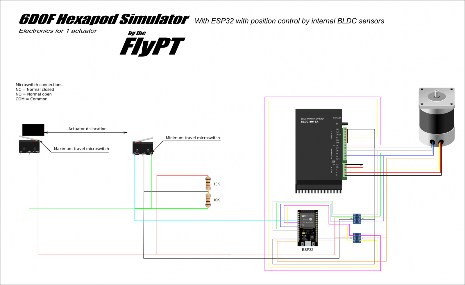

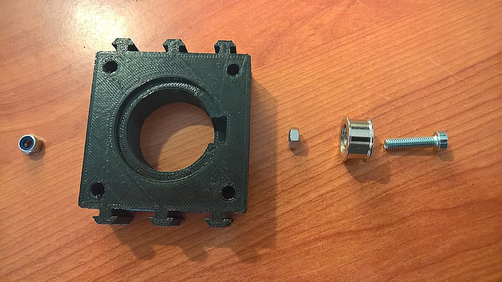

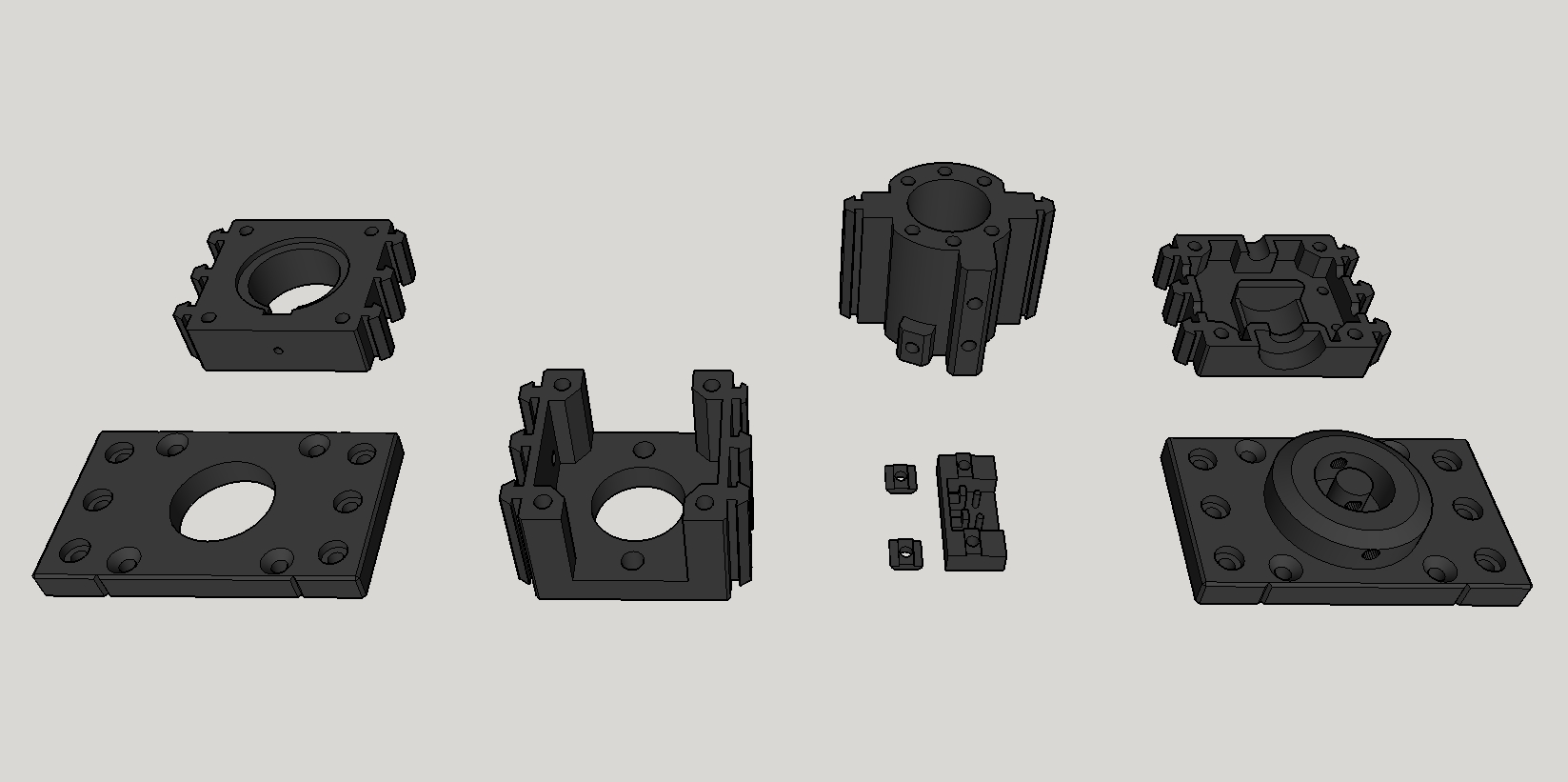

    Plans

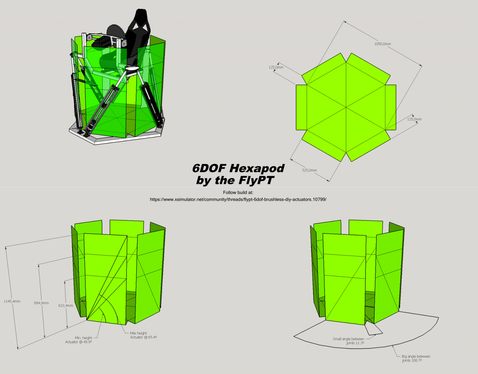

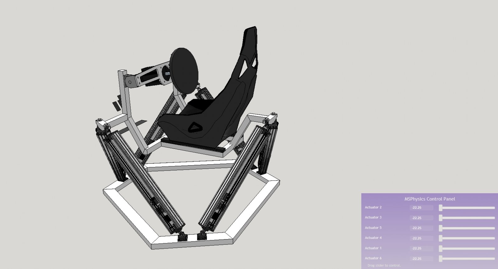

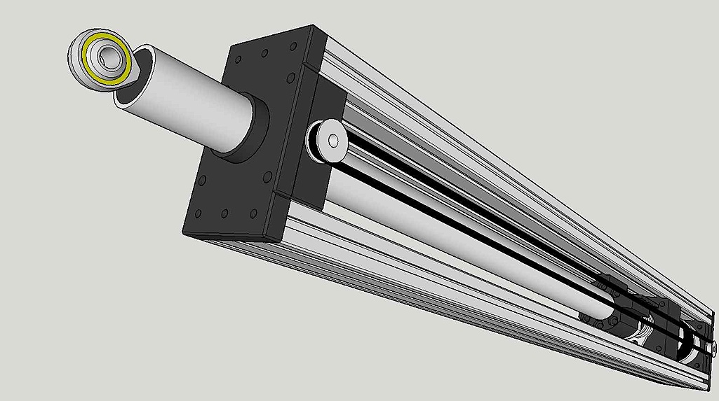

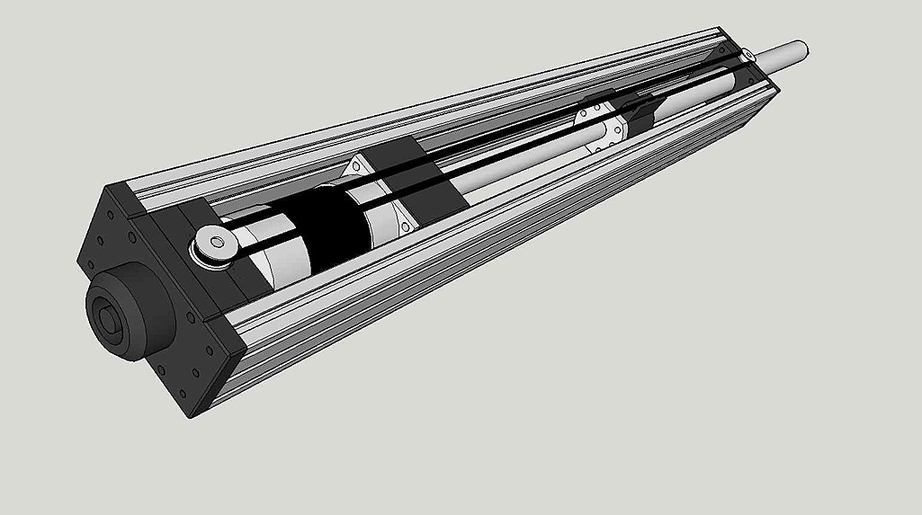

    Sketchup 3D model with MSPhysics integration (Version 4):
    https://3dwarehouse.sketchup.com/mo...eec50f0a92/6DOF-Motion-Sim-by-FlyPT-Version-4
    Dimensions of the hexapod (joints)
    Full resolution at: https://www.flickr.com/photos/128465277@N06/31328973698/sizes/o/

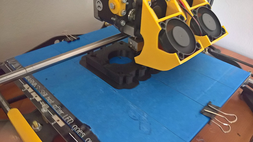

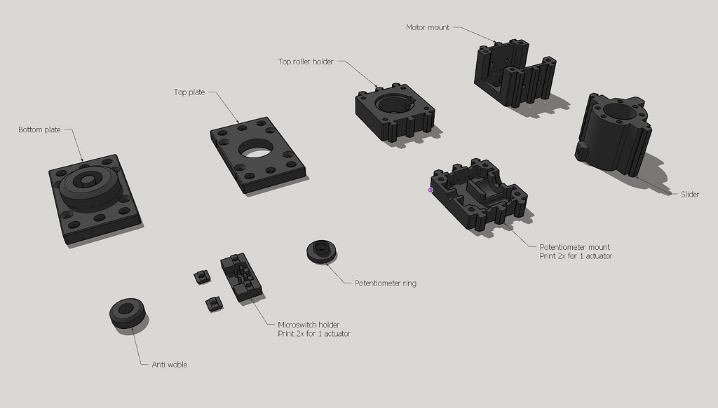

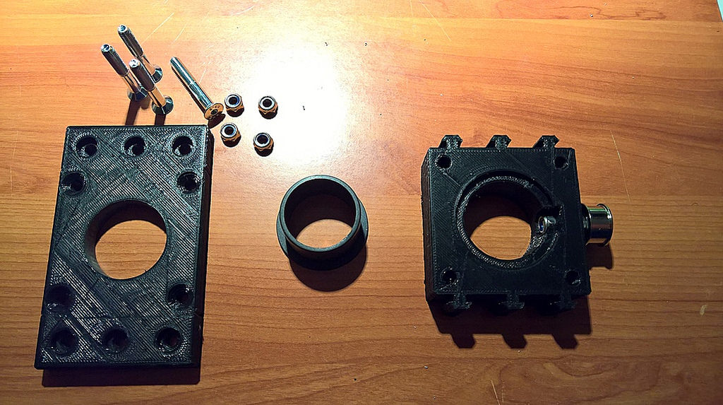

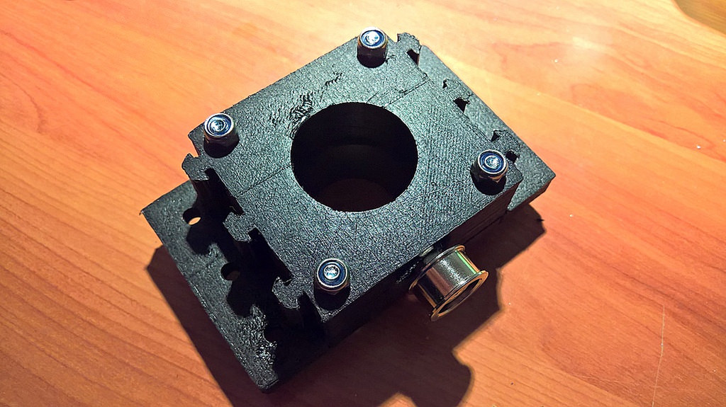

    Files with the 3D printed parts for actuators using pot positioning:
    File: https://drive.google.com/open?id=1VDiJsNzJmQrOuzEaqN5gCoLyDfJcxLRb
    Files with the 3D printed parts for actuators using internal hall sensor positioning:
    SOON!
    Files with the 3D printed parts for the bottom and upper structure of the Stewart platform:
    SOON!
    Warning!
    Those files are made for my printer. They work for me and they have the right tolerances to fit the aluminium profiles and parts I use.
    They might not work for you. So use them at your own risk.
    They are printed in solid PETG. I think they are strong enough. I like to put the rig to a good stress, and until now they did not break.
    How long they will hold? Don't know!

    Developed controller software (ESP32)
    Installed in the ESP32, this code performs:
    -Actuators calibration (calculates range and middle extension)
    -Receives data (speed and/or position) from FlyPT Mover
    -Sends current actuators position to FlyPT Mover
    -Commands the motor controllers
    -Interprets the readings from the internal hall sensors to determine the actuator position

    Electronics
    Schematics used for this project
    IMPORTANT! Look here: https://www.xsimulator.net/communit...hless-diy-actuators.10799/page-38#post-217746
    INTERNALL HALL SENSOR POSITIONING VERSION WITH ESP32 DEVKIT
    Still using a similar solution to the pot positioning to detect minimum and maximum switches.
    The pot was replace by two resistances (10k):
    (For full resolution: https://c2.staticflickr.com/2/1966/43113342910_bbfc75294e_o.png)
    So if minimum is pressed we get 0 in the ESP32.
    If maximum is pressed we get 4095 on the ESP32.
    None pressed we get around 2047.
    Now positioning is calculated from reading the hall sensors state.
    Lower resolution than the pot, but I think it's enough.
    For 6 actuators we need two ESP32 boards. They are connected the same way.
    Here's the current schematic in use:
    (For full resolution: https://www.flickr.com/photos/128465277@N06/30098511787/sizes/o/)
    And the board I made with the ESP32 DevKit, plugs and level shifters:
    Mounted in the controllers "box":
    POT POSITIONING VERSION WITH ARDUINO UNO
    I moved to the internal hall positioning solution, so this is no longer updated, but here for reference.
    Pot and controller connection for one actuator:
    (For full resolution: https://c1.staticflickr.com/5/4389/36059736774_07d10f6b53_o.png)
    The idea is to control all the actuators with one Arduino Uno.
    I get position feedback with pots and two limit switches.
    When the maximum switch is pressed, the pot value is immediately 1023 on the Arduino.
    The same for the minimum, we get 0 when the switch is enabled
    While no limit switch is activated, we get the value from the pot.
    The motor controller needs speed and direction information.
    Speed is fed with PWM and direction is on/off.
    So with this config I can fit everything in one Arduino Uno:
    (For full resolution: https://c1.staticflickr.com/5/4362/36059748064_4c644dc11d_o.jpg)

    I already have two actuators made.
    Built the first one as a prototype, looking for design problems.
    Built the second one, just to find new problems o_O
    So this is the current design (will update the above posts with link to Sketchup files):
    Some Sketchup drawings (those are still WIP):
    The parts to be printed in solid PETG:
    1: Join the screw with the slider and aluminium tube:
    Please ignore that bad print, it was already replaced.
    Aluminium tube is hold tight by two screws, one in each side of the PETG "slider".
    The two visible holes will get two screws to mount a GT2 belt
    2: Mount motor support
    Open threads in the aluminium profile:
    Slide the motor mount in place and put the screws:
    Mount the other side:
    3: Mount ball screw, slider and aluminium tube in the motor mount:
    • Like Like x 7

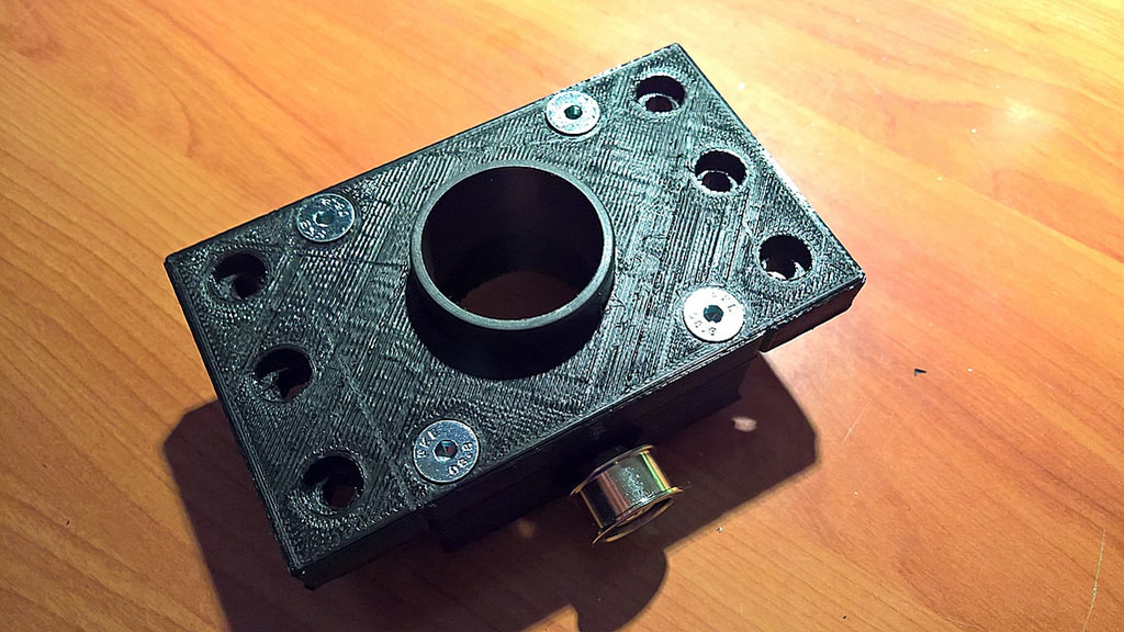

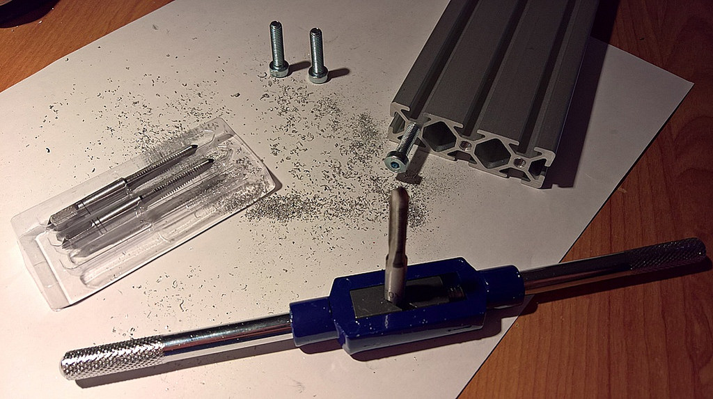

    3: Top end actuator plate.
    Here we have the wheel for the GT2 belt and an Ingus bearing:
    We need to open some M5 threads on the aluminium:
    Only made 4 or 5 by hand, next ones with WD40 and electric drill...
    Testing the mounting:
    • Like Like x 5

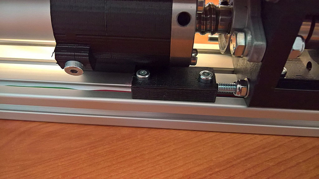

    4: Mounting wires and limit switches:
    Solder wires, pass them between aluminium profile and motor mount.
    (note: microswitch should be placed before top end or we can't mount the housings for the switches)
    Motor already mounted
    Insert micro switches in 3D printed housings and tight them to the aluminium profile:
    Here we can see the slider touching the switch
    Updated list of parts, software and added a video on the posts at the start of this thread.
    • Like Like x 6

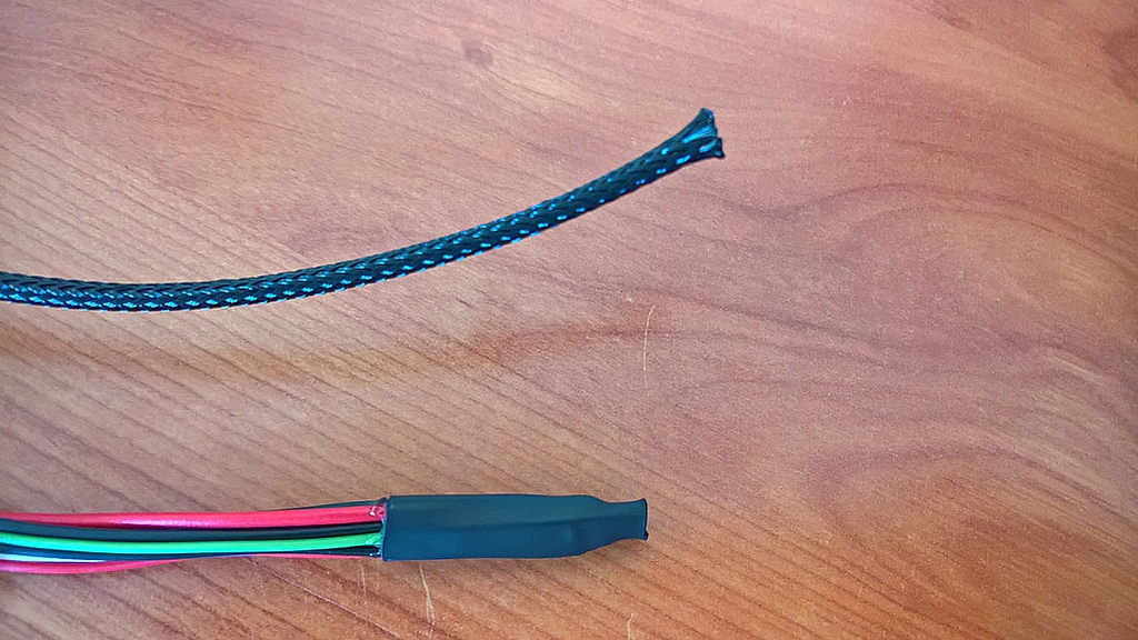

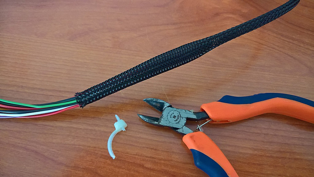

    5: Make cables that connect to the control box.
    In my idea, I want to build a box with all the power supply and controllers.
    When we have kids, just the actuator is already pretty dangerous, so electrics should be really safe and hidden, at least for cosmetic reasons.
    So, since I could not get the needed cables, I made my owns.
    Joined 6 packs of wires:
    With 11 wires, 3 for limit switches and pot 3 to power the motor and the rest for the hall sensor:
    Joined them at one end so I could put them inside a sleeve:
    And the result:
    • Like Like x 6

    6: Bottom plate
    This holds the pot and the UJoint. Must be strong!
    Printed two equal parts.
    They make a sandwich to hold the pot.
    All wires go inside and the go out in one cable, the one built in the above post:
    There's also a part to mount this on the aluminium profile and hold the UJoint:
    Mounting everything:
    This one with the belt already in place.
    • Like Like x 16
